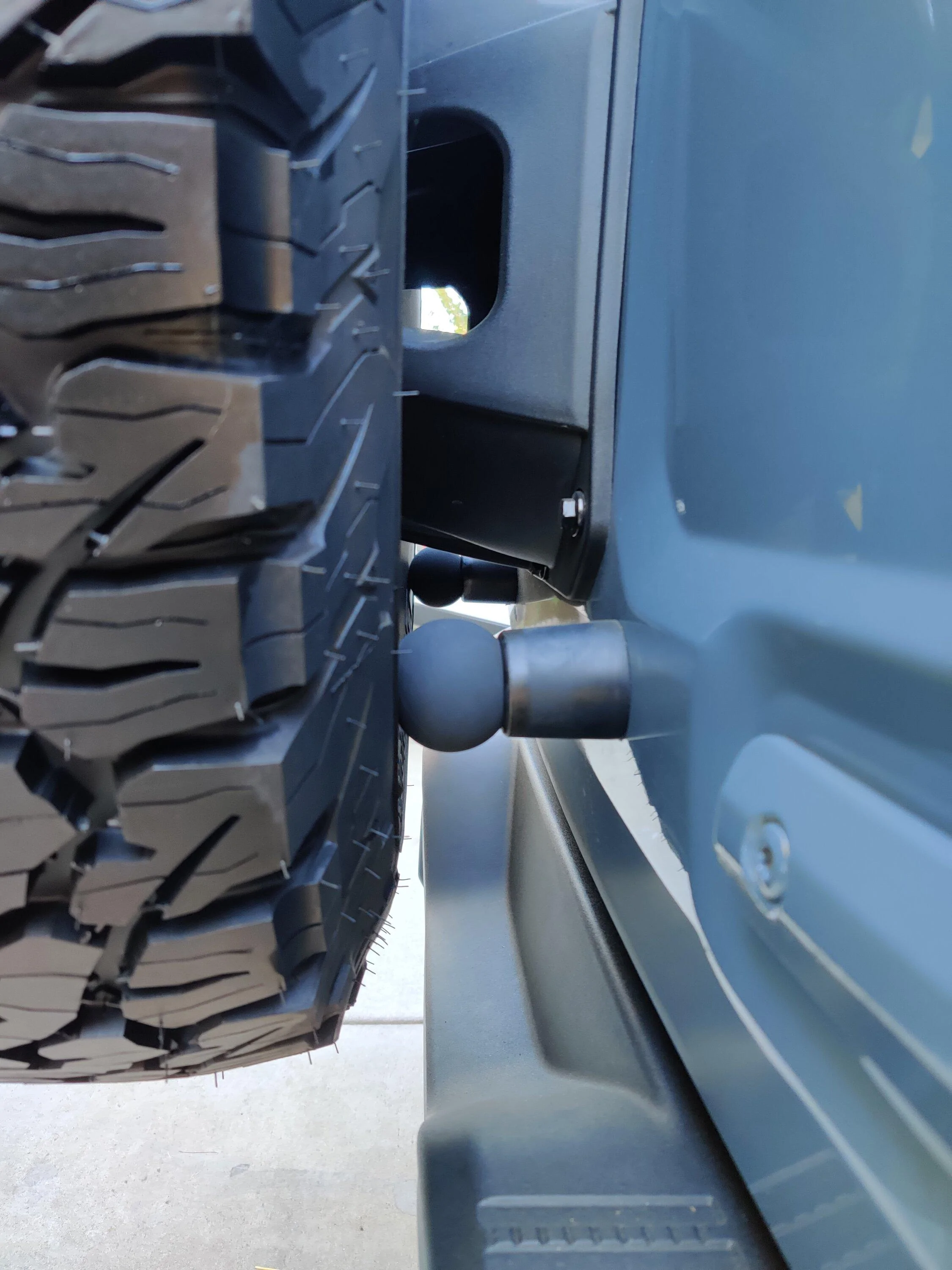

I have -25 offset spare wheels and racquet ball from Amazon works wonders.
Ford Bronco Best solution for spare tire bushing gap with high offset wheels? IMG_20220827_163355

Thank you. This is the route I'm going.
They're long enough for -30 at least if I had to guess. I trimmed off over half to fit for +18.

Flex/stress on tailgate. The bump stops are meant to absorb flex when the truck moves over surfaces that may cause vibration/tension. Think of it as an armrest for your wheels.

Did you end up getting these? How did it work out? I ordered 17x8.5 0 offset and looking to order something before they arrive. Thanks

Yes, and they are great. removes and supports any flex with tailgate in this location.
