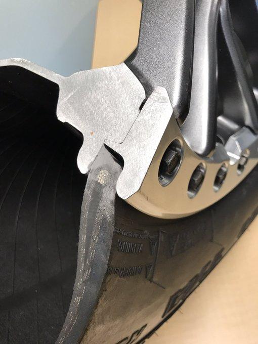

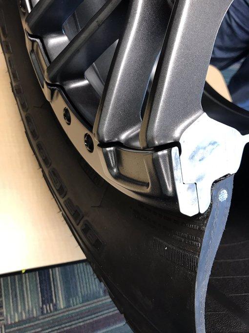

Looks like tire just goes outside the lip and you bolt the new rings on.
