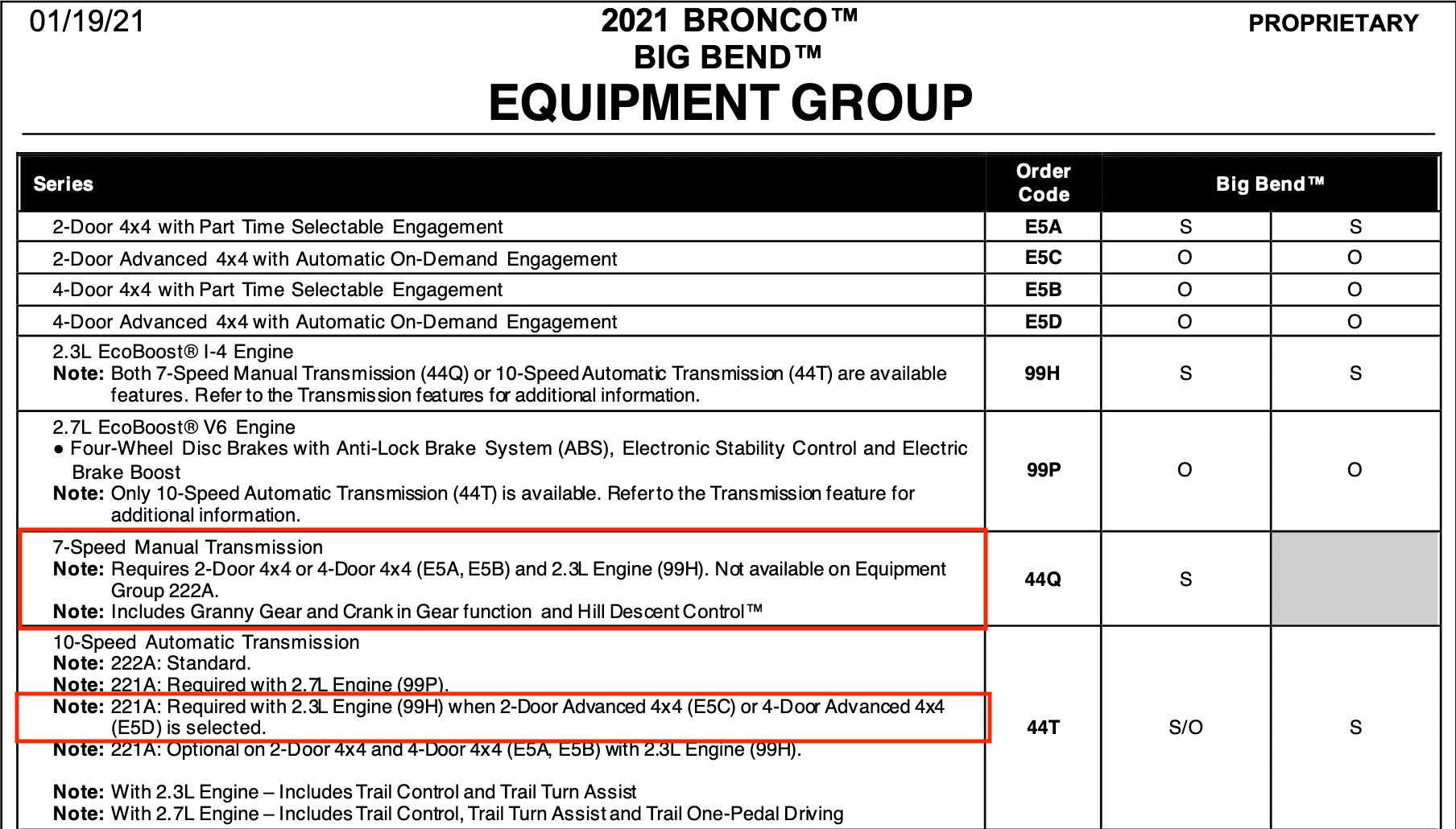

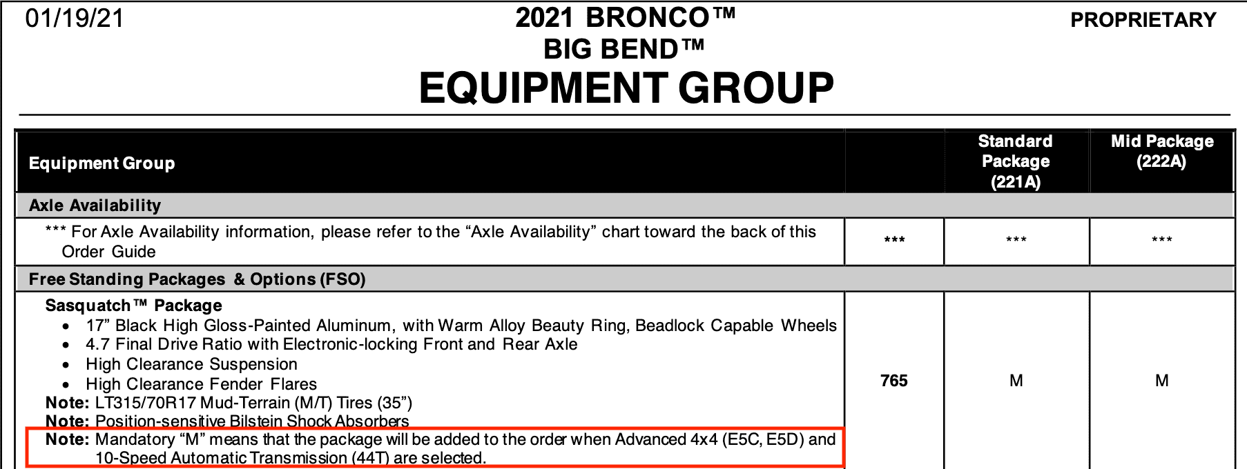

If you read the notes in the Order Guide for Big Bend, Sasquatch package and 10 speed auto transmission are required additions when the Advanced 4x4 system (E5C, E5D) is selected.
The 7 speed MT on the Big Bend is only available with the Part time 4x4 system (E5A, E5B). The 10 speed automatic is required with the 2.3L engine when E5C and E5D order codes are selected (the advanced 4x4 system order codes).

Sasquatch Package is mandatory when Advanced 4x4 (E5C, E5D) and 10 speed automatic are selected.

See below. You're only allowed advanced 4x4 with the 10A (not the 7M), but then they also say that you have to add Sasquatch when you have both advanced 4x4 and 10A together. So in the end they are forcing you into Sasquatch if you want the advanced 4x4.
