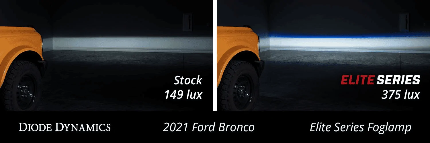

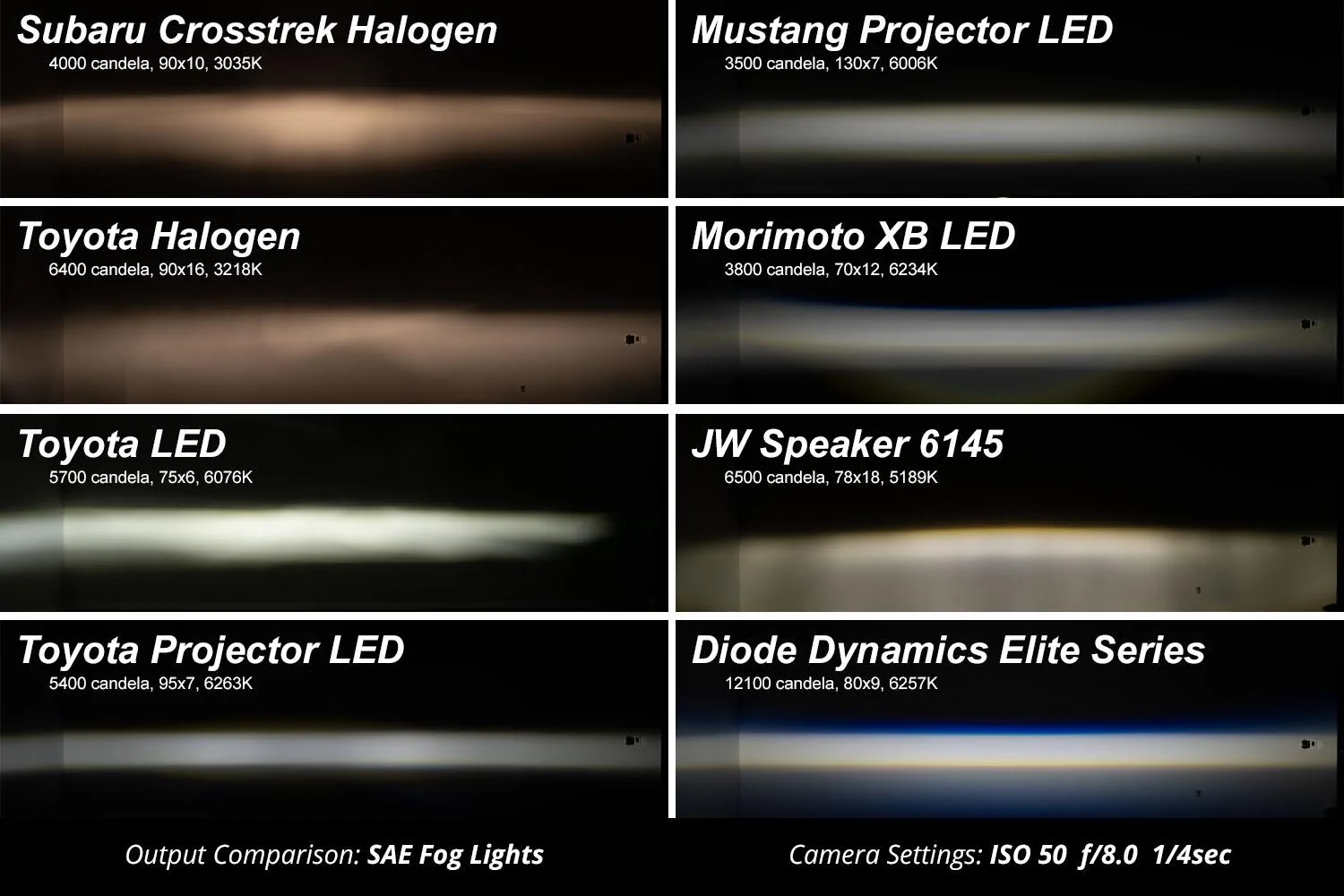

Our Elite Series Fog Lamps utilize a custom-engineered patent-pending optic that delivers an extremely sharp cut-off, wide beam pattern, and unique BMW-style color banding.
Ford Bronco Base bumper fog lights 1695143810759
Ford Bronco Base bumper fog lights Elite_Series_vs_Competitors_Collage - Whit

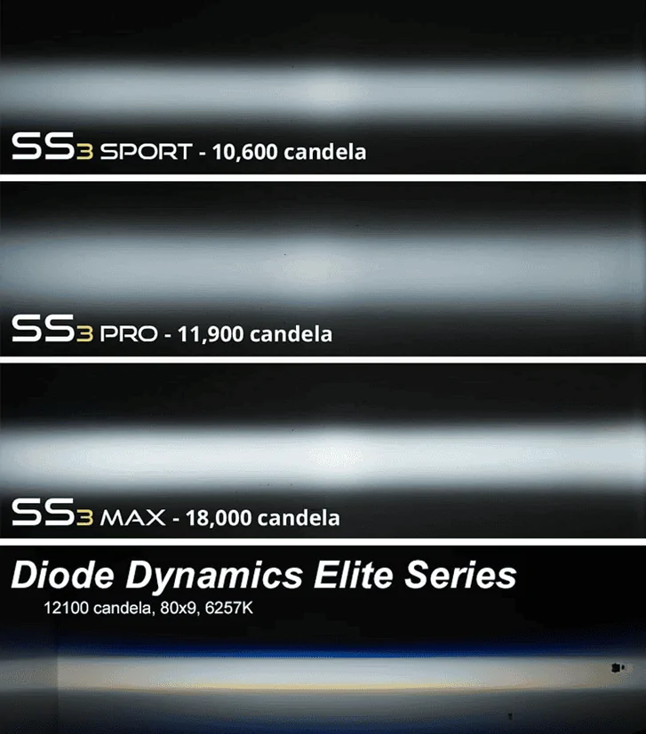

If you go with an SS3 fog light kit they feature higher output intensity than any other 3” light on the market, these LED pods have been designed for maximum functionality, with custom-engineered TIR optics shining in highly useful beam patterns, all in a durable package.
Ford Bronco Base bumper fog lights Elite_SS3_Collag

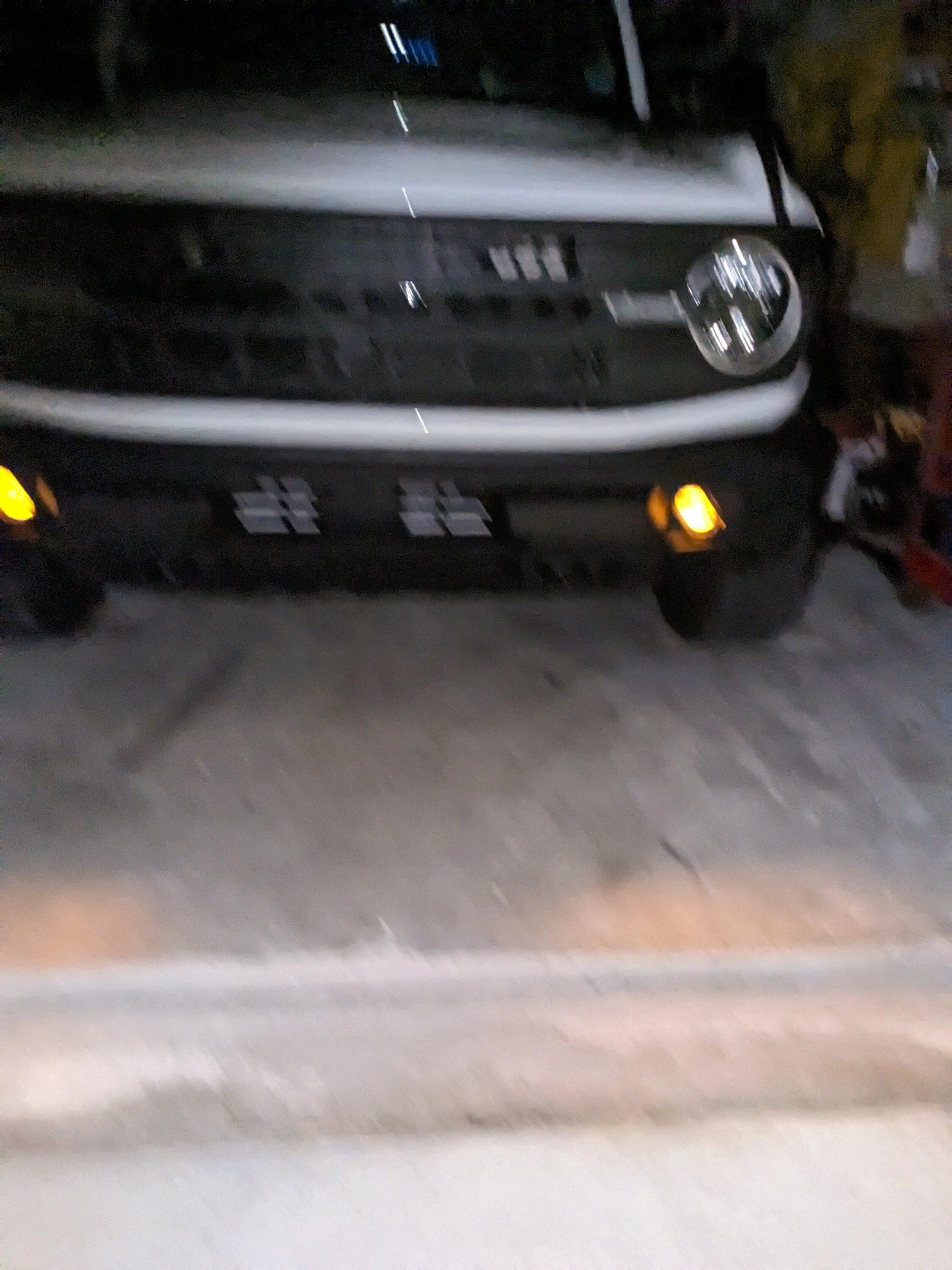

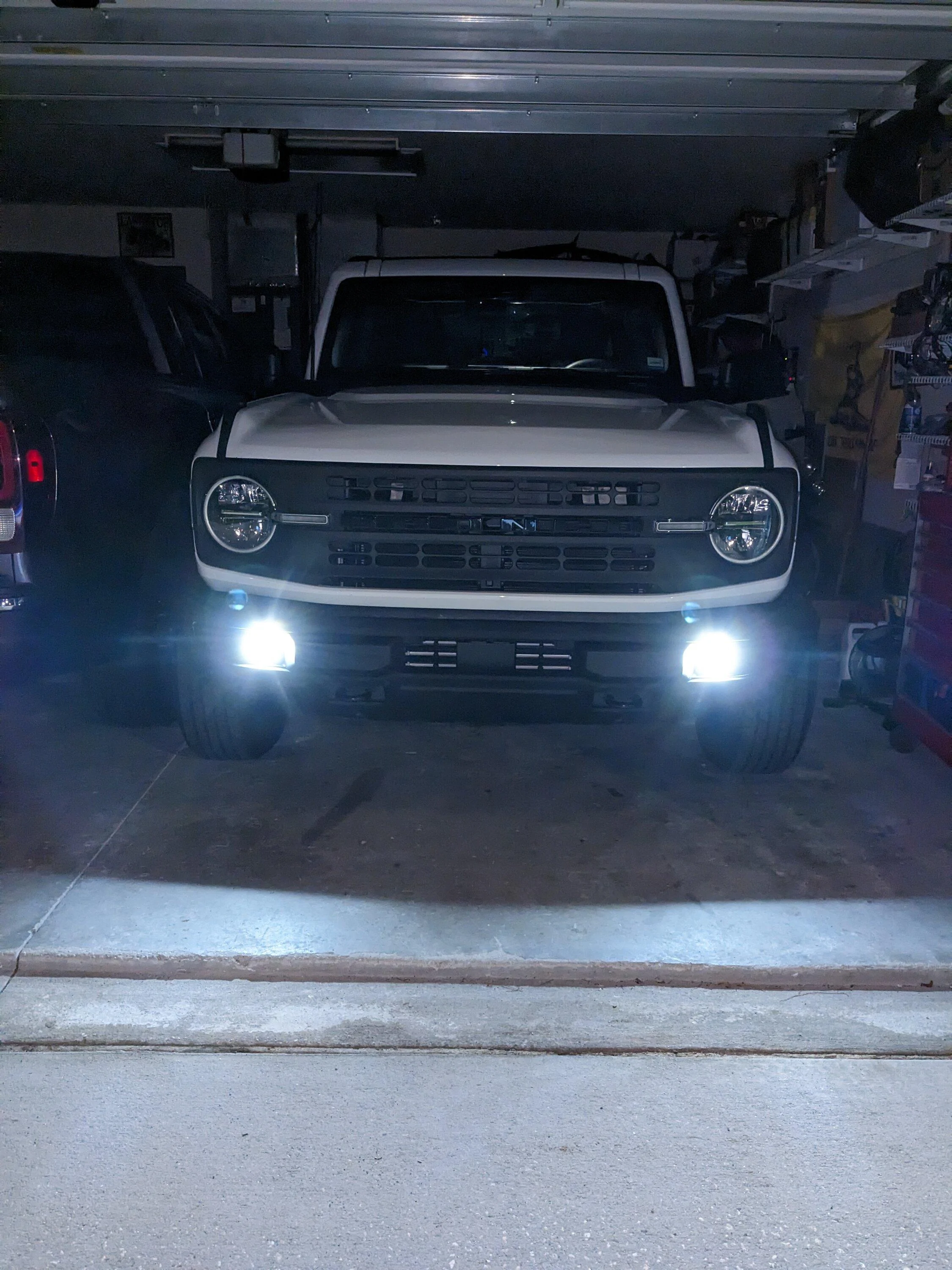

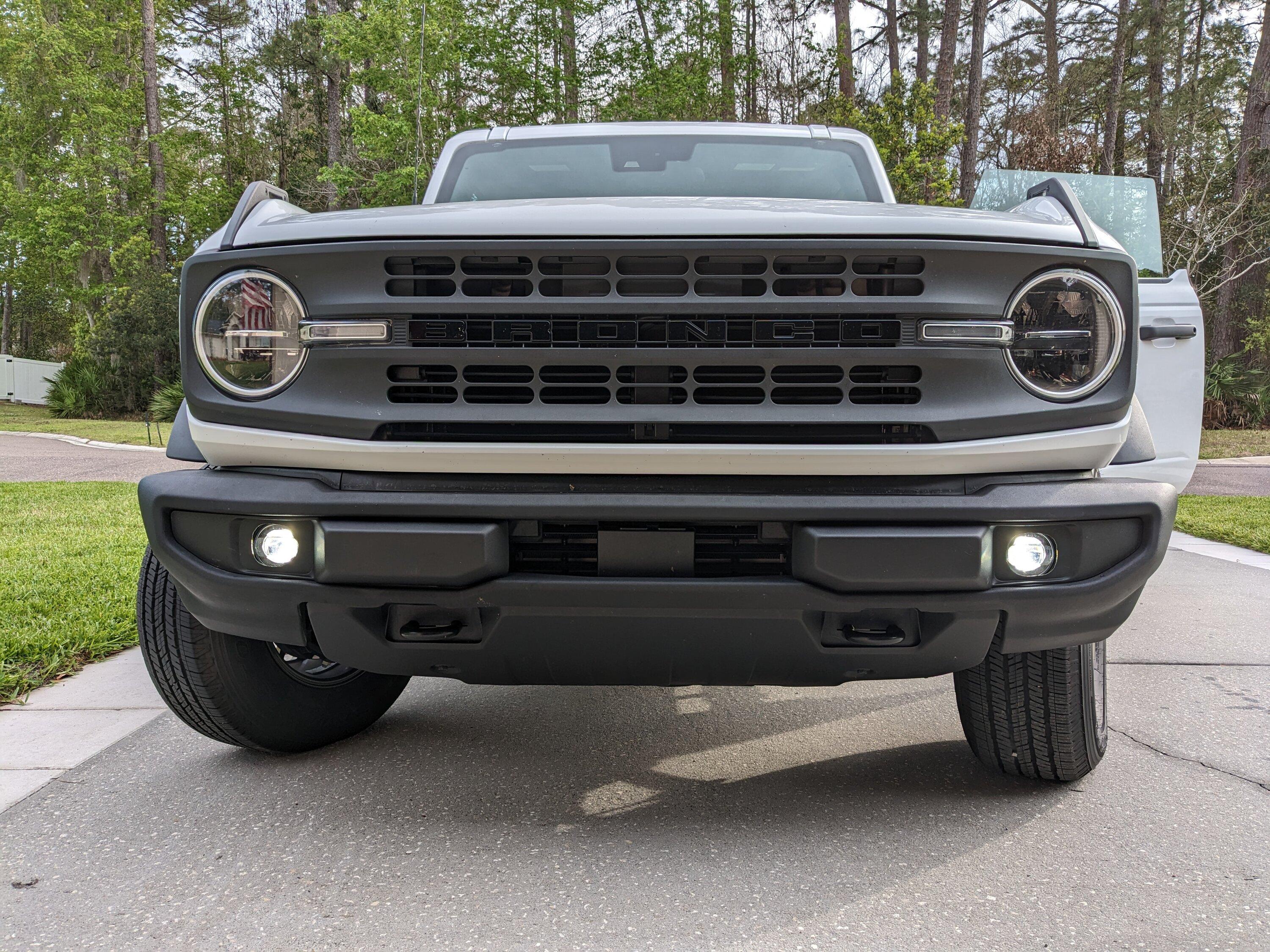

Ordered DIODE DYNAMICS TYPE A ELITE SERIES FOG LAMPS PAIR - WHITE
Part #: DD5128P from CJ Pony Parts and the Heavy Duty Dual Output 4-pin Wiring Harness
SKU: DD4093 from Diode Dynamics. The lights include a yellow back light and the white fog lights. Wired the yellow back light (mainly used for daytime when raining) to #5 Aux. switch and the fog lights to #6 Aux. switch-(colors for the Aux. switch wires can be found in the owners manual). Used I think, a #10 1 1/4-1 or 1/2 length sheet metal screw to mount the lights to the plastic bumper. There are four recessed areas for the mounting screws that line up with the mounting holes for the lights. They are solid so you either have to drill a pilot hole or start the screws with some pressure. I made sure I set the screw only once as I didn't want to strip the hole. Installed for 7 months and they remain solid and have not loosened up. I did not cut any wires that came with the lights. I ran the right light wire along the firewall to the passenger side and through the upper portion of the fender and tucked down and around the headlight to hide as much of the cable. The drivers side I wrapped a couple of times along the driver side fender access holes to also hide. The relay is tucked in front of the battery. Used a 3" hole saw to cut the face of the bumper covers. Should have used a 3 1/2" hole saw as I had some trimming to do (which is still not a perfect circle , a job for me when I've got nothing else to do). Covers with holes are available for about $50 bucks apiece. I think the passenger side adjustment screw was hard to access. I used a mini wrench and turned a little bit at a time until I was happy with the alignment.
Ford Bronco Base bumper fog lights yello
Ford Bronco Base bumper fog lights white-night
Ford Bronco Base bumper fog lights white-day
