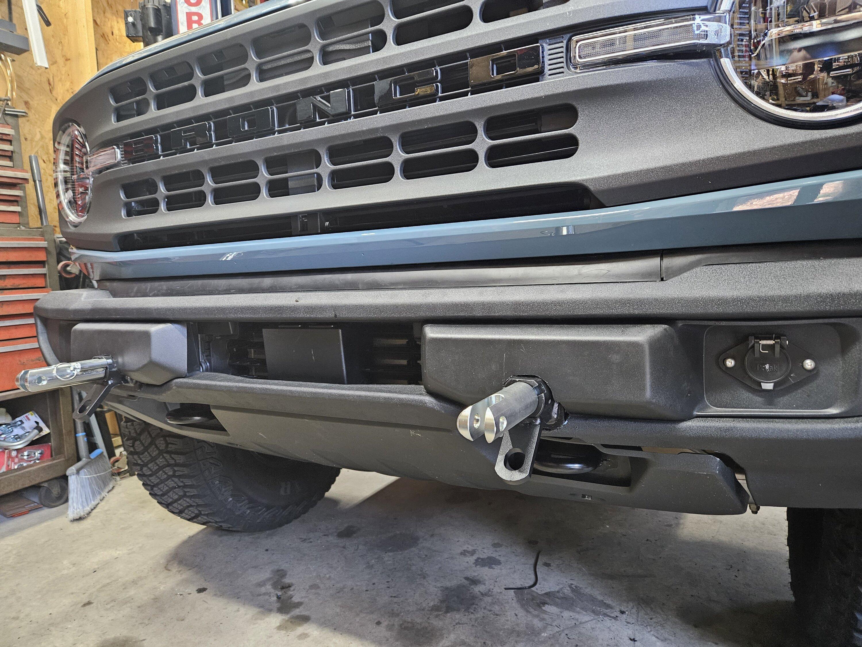

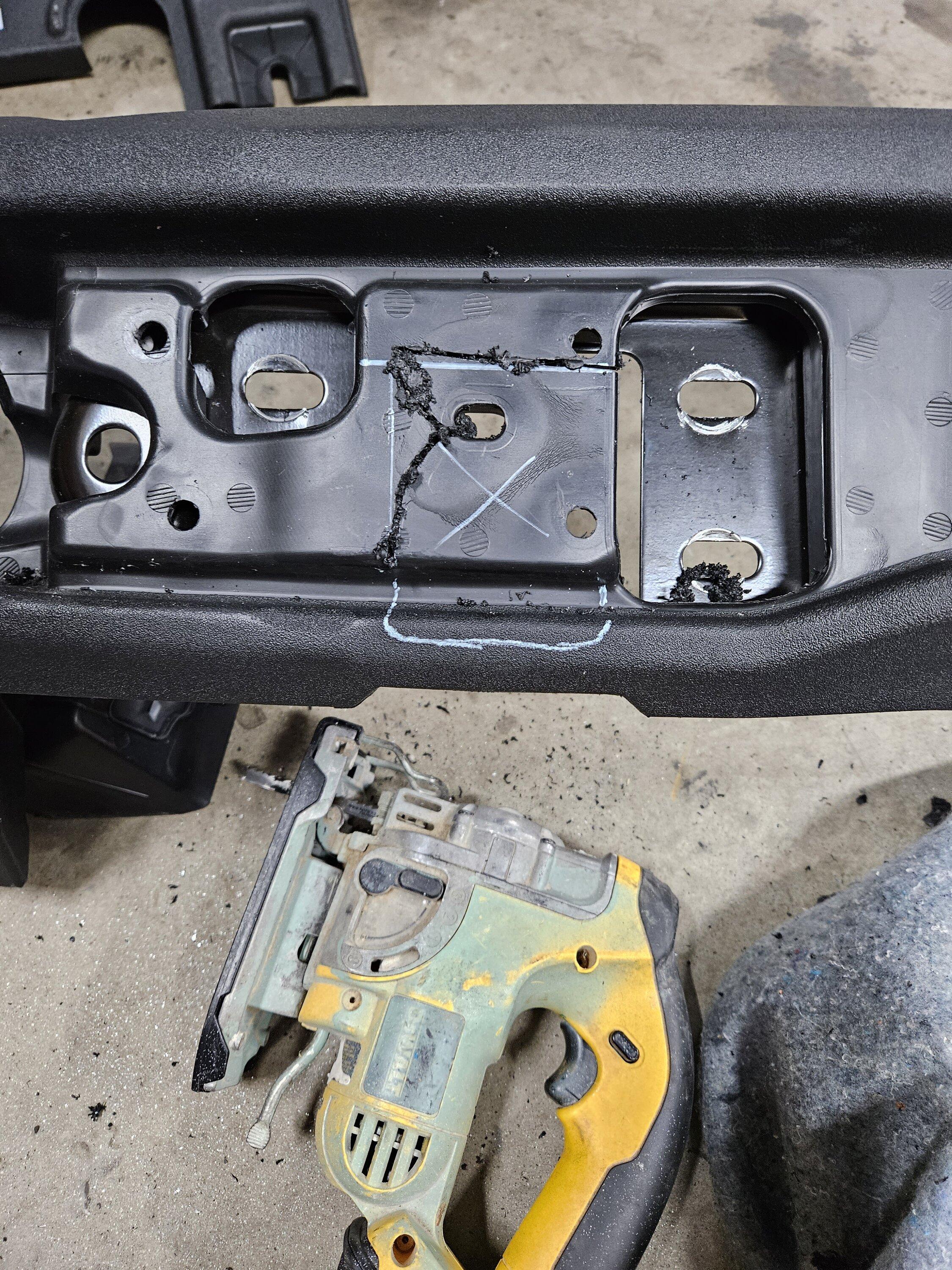

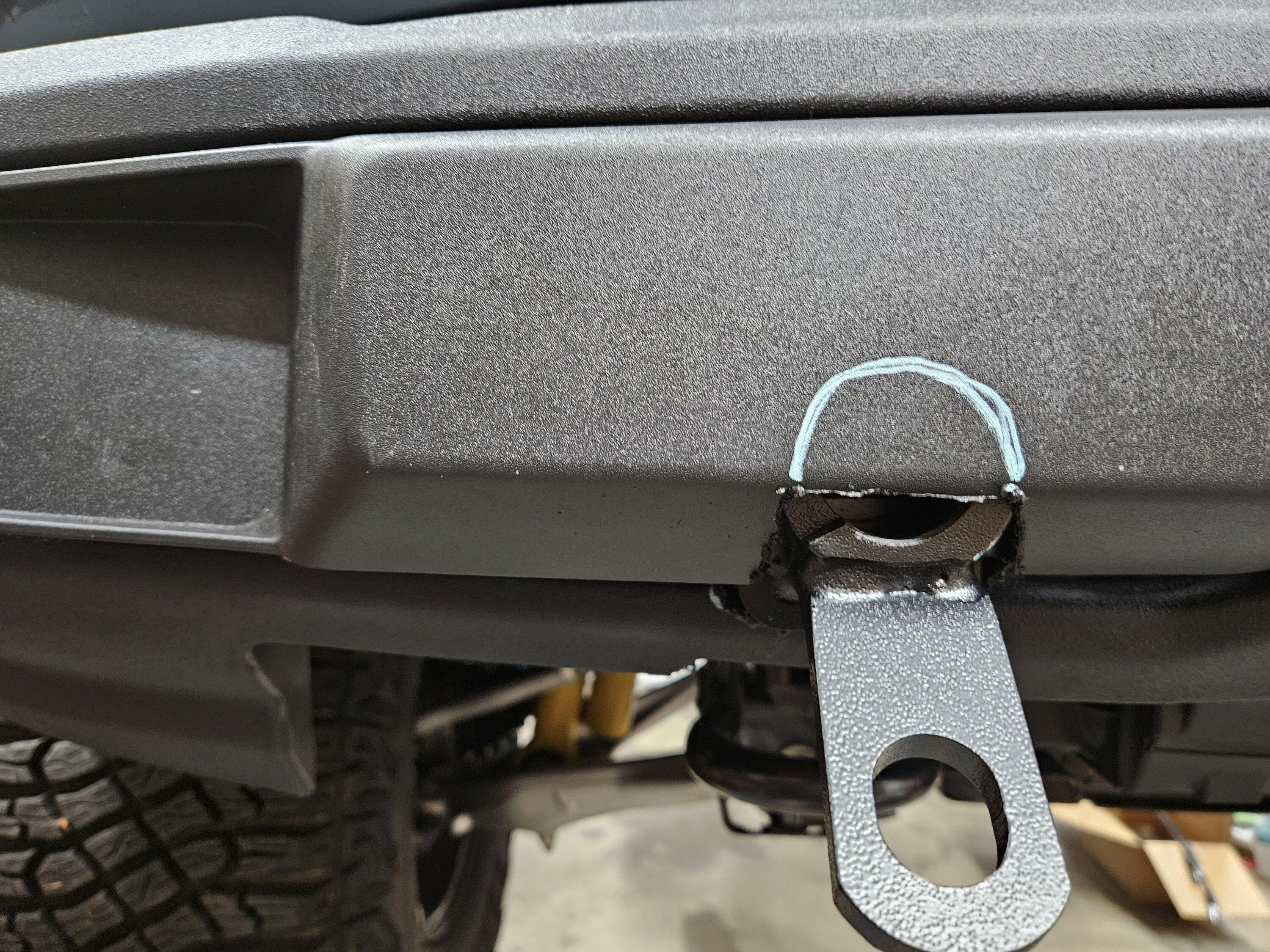

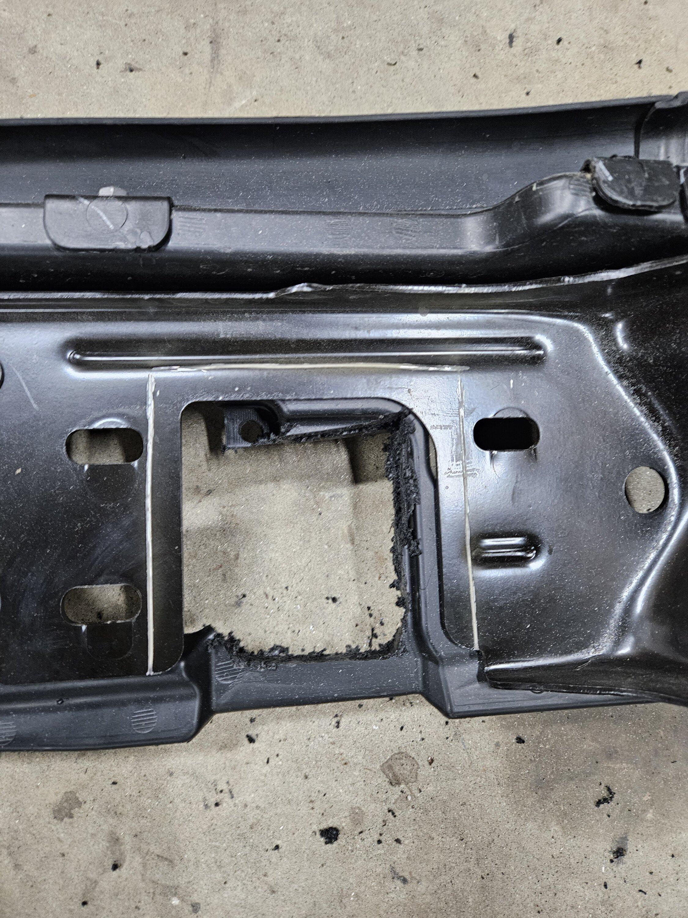

Like many of us I scrapped the modular bumper constaint to help get a build date. Being stuck with the base bumper I wanted the higher tow points (BX2692) for my future hidden winch install. Some slight modifications with the cutting wheel and a multi tool and it is done.
Honestly I like ths base bumper over the modular and capable.

Nicely done and modified! (y)

Looks good. Like the connector mount in the bumper. Had to use the bracket for mine with the modular bumper.

I have the same base plate set up on my capable bumper. I like it okay but it sucked losing the D-Rings. The other issue is how far the safety cable attachment points stick out (real knee bangers). If I had your mod, I’d cut the attachment points off and use the tow hooks for the safety cables. That would give you a nice, flush mounted set up. Definitely like your electrical connector mounting. Looks great.
