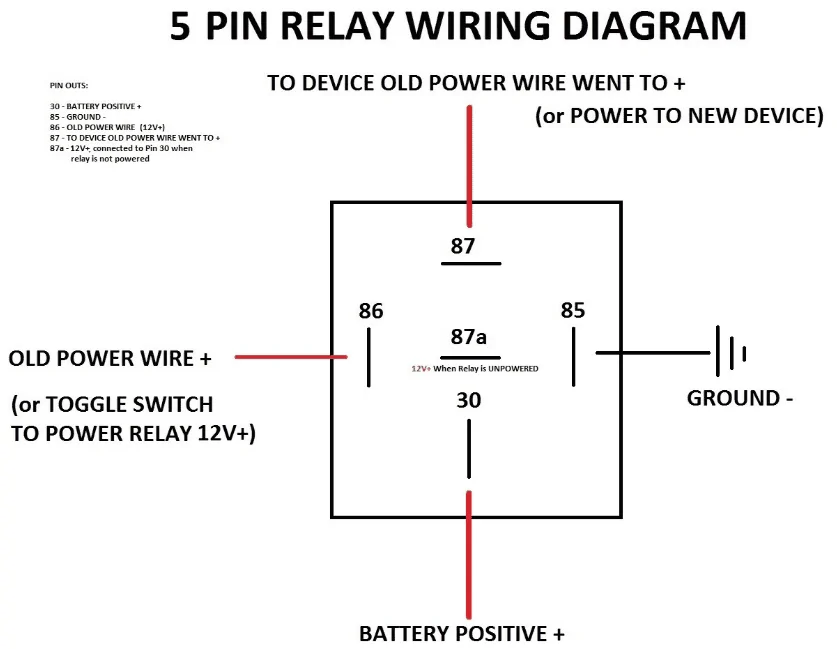

I’m sure that someone will chime in with a harness that you can buy…
but you can easily create your own wiring harness using two five pole relays!
Say Aux 1, Low beams. Aux 2 is High beams. The switch amperage is irrelevant now that we relay.
Ford Bronco Baja designs LP6 wiring IMG_9649
Hook up Aux 1 to Relay 1, as you normally would. Hook up Aux 2 to Relay 2, as you would.
On Relay 1, Take the relayed output (87) of and plumb it into the battery input (30) of Relay 2.
Now on Relay 2, you use hook the Normally Closed (87a) circuit to the Low Beam and the Normally Open/Relayed/Switched Circuit (87) to the High Beam.
When you trigger the the Aux 1, Low beams come on. When you trigger Aux 2, low beams immediately disconnect and high beams come on. The best part of this is that you can leave Aux 2 energized and nothing will happen till Aux 1 is switched - acting like a main circuit breaker and it retains the last known lighting level.
I would advise to place the relays in a dry area of the engine bay, coat them in dielectric/electrical silicone sealant to avoid corrosion or freeze up

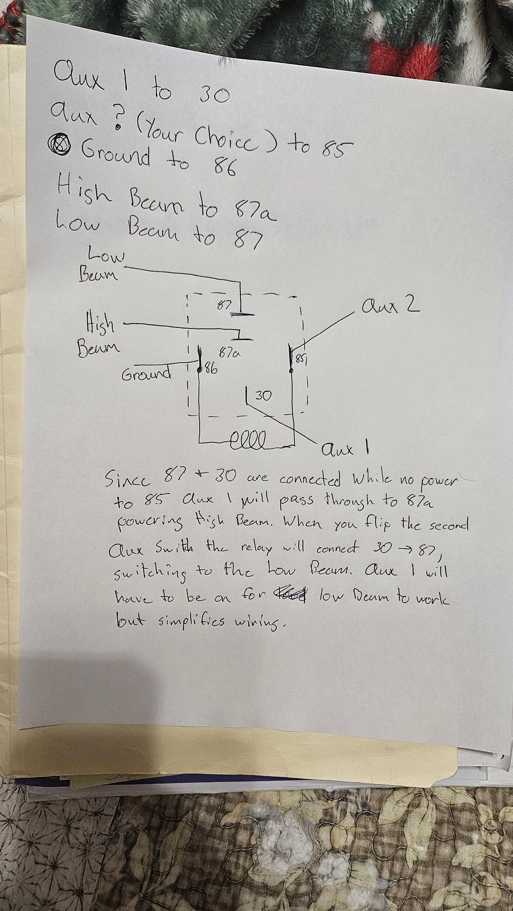

You could always use one relay and wire it like this:
Ford Bronco Baja designs LP6 wiring 20231210_060626
If wired up like this, Aux 1 is basically your main power. Flip Aux 1 and your Highs come on. If you want low beam, flip your other Aux Switch. Leave other aux switch flipped on, shut off Aux 1 and lights off. Flip Aux 1 back on, low beam on until other Aux is switched back off now back to high beam.
Aux 1 is power to lights
Other Aux switches between high and low.
Hopefully that all makes sense.
That does make sense. And I could swap low and high beam so that the lows come on with power and highs are the option, correct? I think I’d prefer the lows be the starting point so I could leave them on when needed and then bump power to the high beams.
Yep, definitely. And that's what I would do too!
