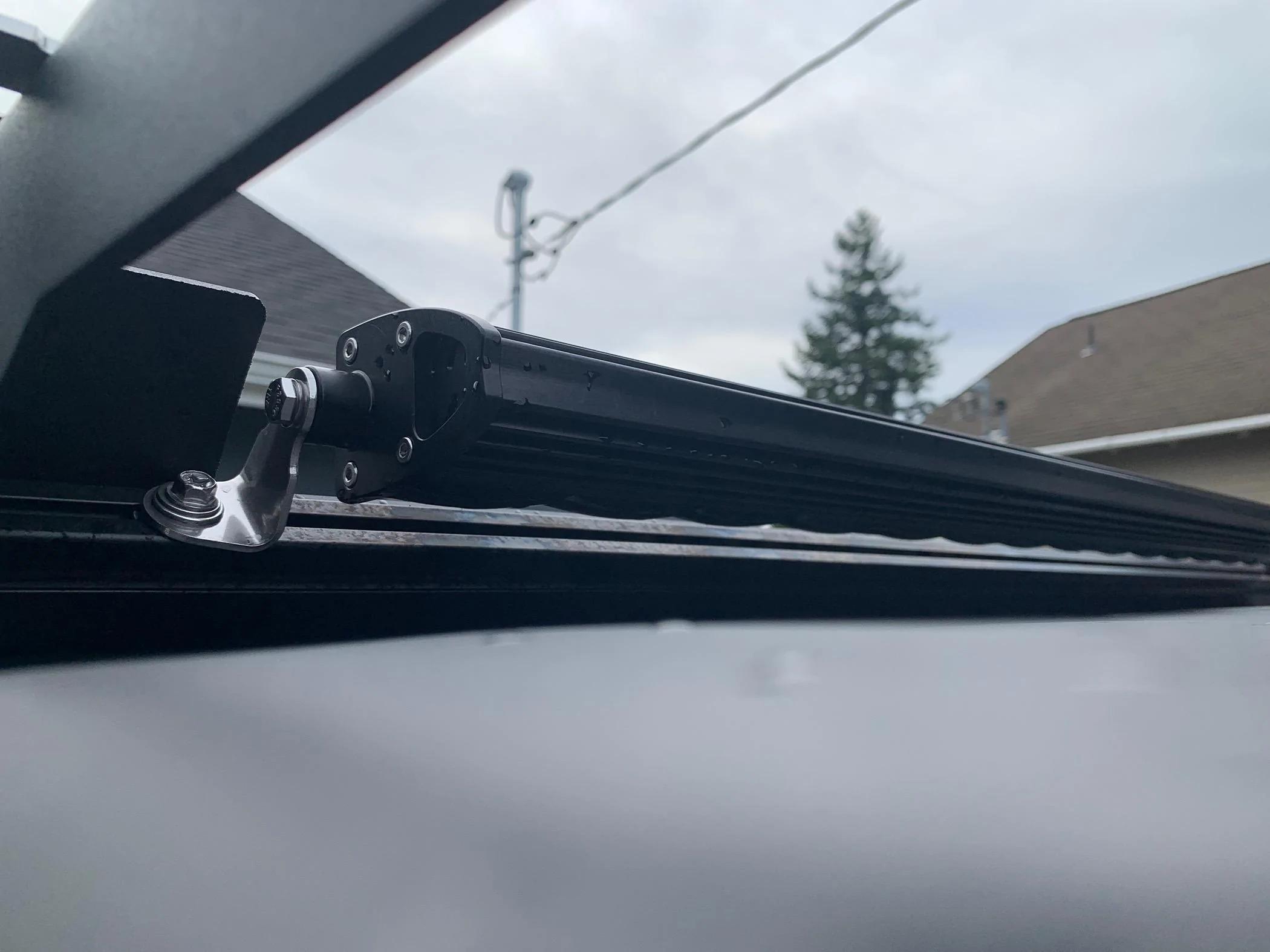

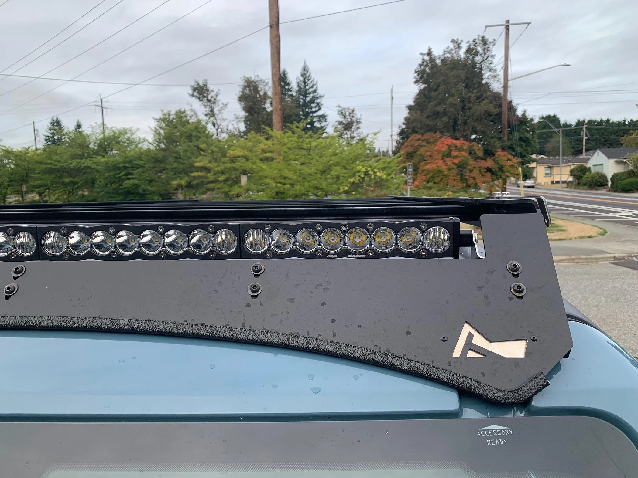

So now i'm confused lol. Trailrax said that their wind deflector mounts on the top. Are you just NOT using it in this photo to avoid glare? If you do have the wind deflector installed, does it cover up the channel that the S8 bar is hovering over?
That would prohibit Oly_Bronco from doing what he needs to do trying to mount some LP4 up there.

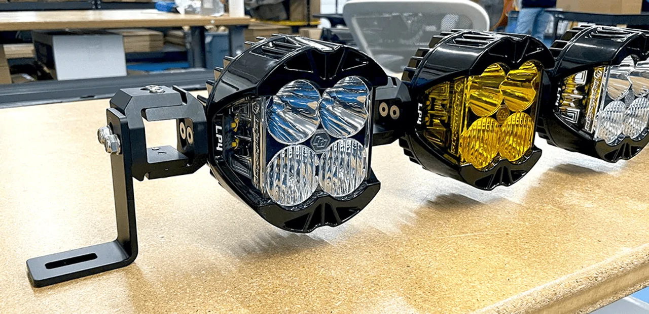

We DO make an LP4 bracket Oly_Bronco but im not sure if it will do what you NEED to do? It's a bracket that DOES sit higher then the regular LP4 bracket and WILL let you pivot it but im not sure if it will work.
So if you didn't install the wind deflector you might be able to achieve what you want
We use them for our LP4 Linkable System but you can certainly just install them as your regular mounting brackets
https://www.4x4truckleds.com/kr-off-road-brackets-for-baja-designs-lp4-lights-pair/
The regular LP4 bracket that comes with the LP4 is 3 1/2" from the bottom of the bracket to the top.
Our bracket is 4 3/64" tall. So you get a bit of extra height which might work for you, but we've never tested it nor was that it's intended purpose.
Shown here connected to the Linkable
That's what I mean, there's confusion around what's the top of the crossbar vs the front. Since that front crossbar is mounted at an angle, the wind deflector is mounted to the top/front and the lightbar is mounted to the top/rear. I'm pretty sure the Trailrax front wind deflector is mounted similar to how the Prinsu rack is set up.
Posting another picture as well as the one I posted earlier so you can see it from both angles:
Ford Bronco Baja Designs LP4 on Trailrax TRMR IMG_8626
Ford Bronco Baja Designs LP4 on Trailrax TRMR IMG_8625
Well okay then make we CAN mount stuff up there then... the instructions seem different then how the wind deflector actually sits... and you clearly have a wind deflector..
@TrailRax can you confirm if that aluminum bar's channel IS accessible with the wind deflector installed? That would allow people to install all sorts of lights, as long as they clear above it of course
