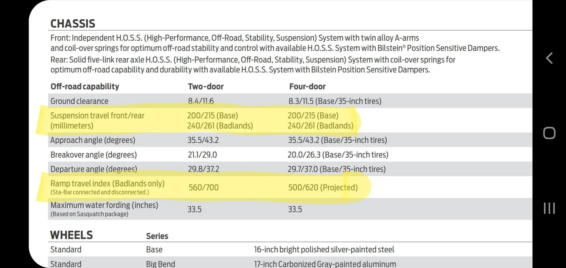

Does anyone actually know what the sway bar disconnect actually adds in terms of suspension travel? I thought I read 1.4 inches, but I can't find it. 1.4 inches does not seem like it's worth it to me... If someone has other data, I would love to hear it!!
Based off of the listed RTI numbers it looks like the disco will get you around 4.75" of additional travel for both the 2 Door and 4 Door. This is assuming they used a 20 degree ramp.
2 Door (100.4" Wheel Base): Connected = 560 (56.22"), Disco = 700 (70.28")
Difference = 14.06" increased travel up 20 degree ramp
sin(20)*14.06 = 4.8" vertical difference

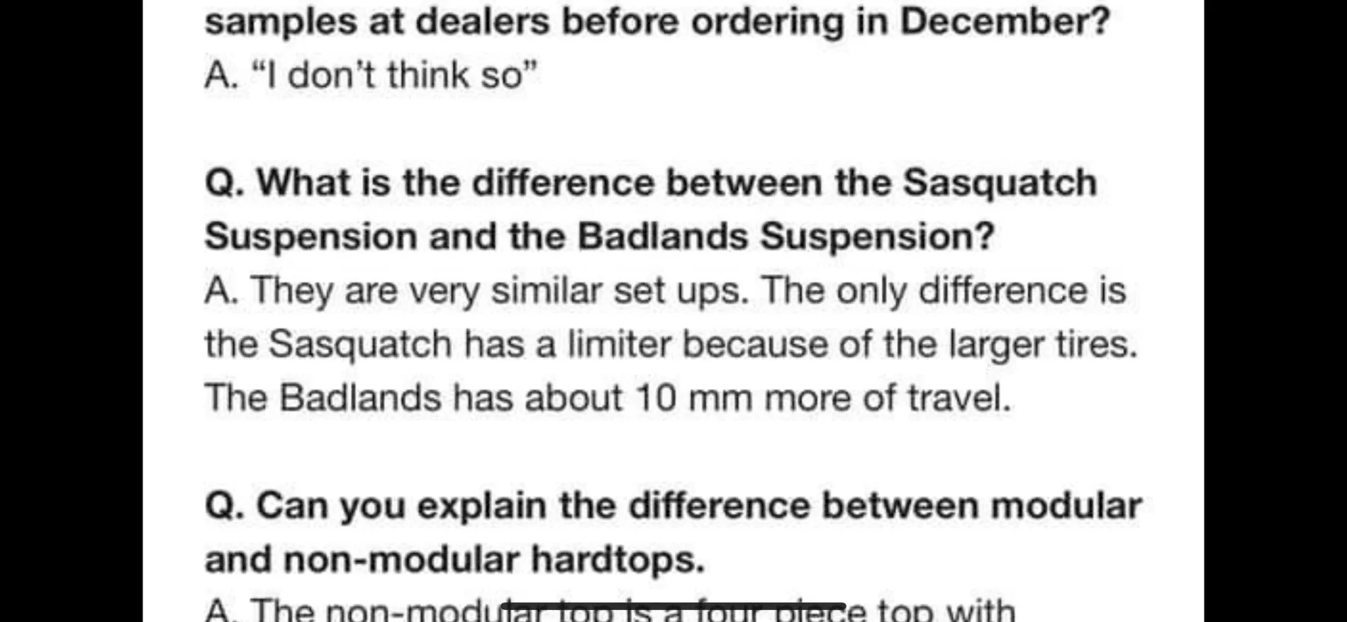

From the Q&A with Ford...10mm bump spacer is the only difference on the wildtrak/launch/squatch vs the badlands. The sway disconnect as well obviously. No ride height difference vs Sasquatch if you were to add 35s to the badlands.

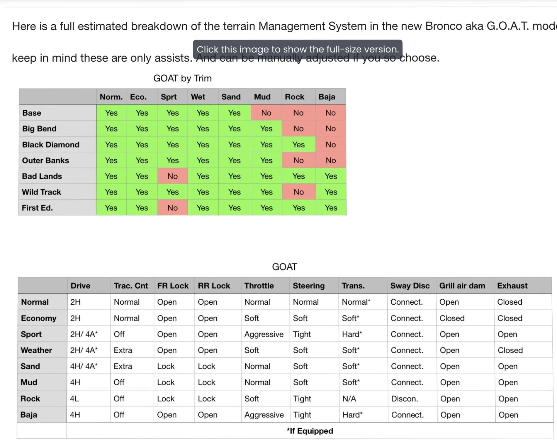

BillyGoat...sometimes I'm told I'm illiterate. I understood both have Baja...the difference in GOAT modes is Badlands has Rock Crawl and Wildtrak has Sport.
This is where I got schooled from First On Race Day:
Ford Bronco Badlands suspension vs Wildtrak 5CB09B9B-3BF1-4047-9F54-A6BFECE310A1

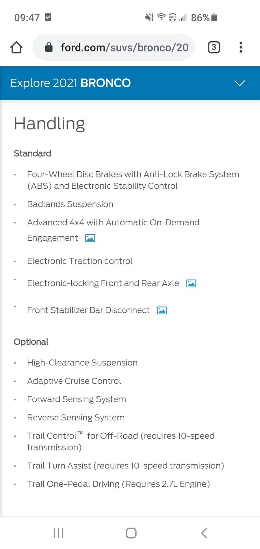

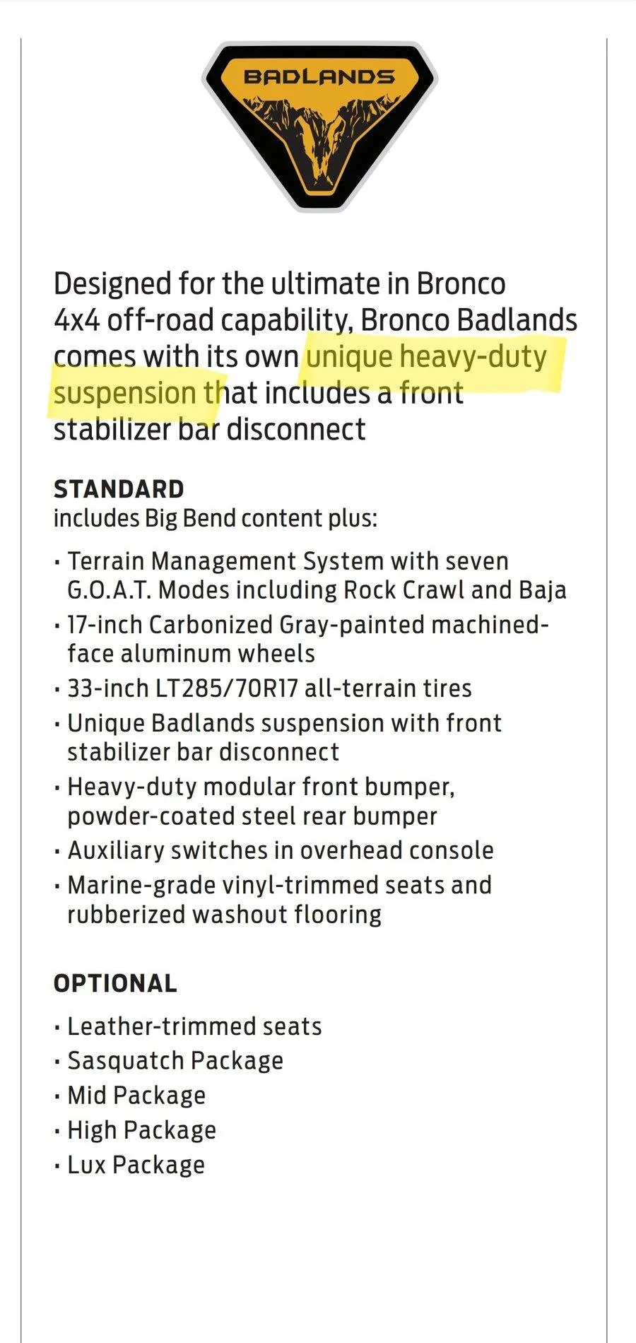

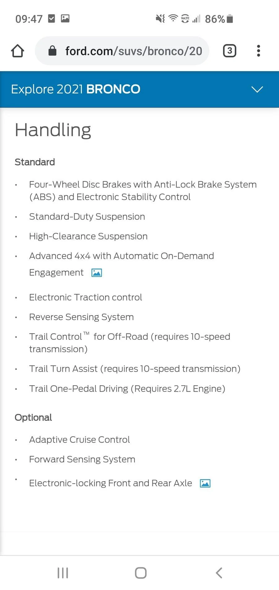

The Badlands and FE have a "unique heavy-duty suspension", aka "Badlands Suspension", while all other models have "Standard-Duty Suspension". The details have not been revealed yet, but it likely has to do with more than just the upgraded shocks and front axle (which are shared with Wildtrak and Sasquatch), and it is distinct from the "High-Clearance Suspension" and the stabilizer bar disconnect. Most likely, it includes stronger A-arms, links, and other suspension hardware that can handle higher stress and torsion.
Badlands:
Wildtrak:
Here are the suspension travel numbers:
Converted to inches:
Base front/rear: 7.87/8.46
Badlands front/rear: 9.45/10.28
Difference front/rear: 1.58/1.82
