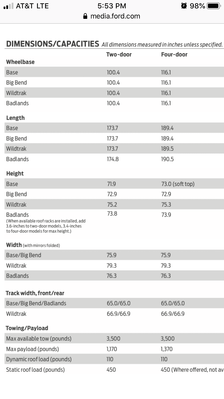

That coincides with the preliminary specs. It says the Wildtrak is 1.4” taller than the badlands. That could be 1” from the tires or a little over an inch from the bigger tires.
There may not be a lift on the Wildtrak after all. Or there could be like a 1/2” lift/spacer.
They have said that the Sasquatch will limit suspension travel. If they put a leveling coilover spacer kit all the way around that would bring the travel numbers down.

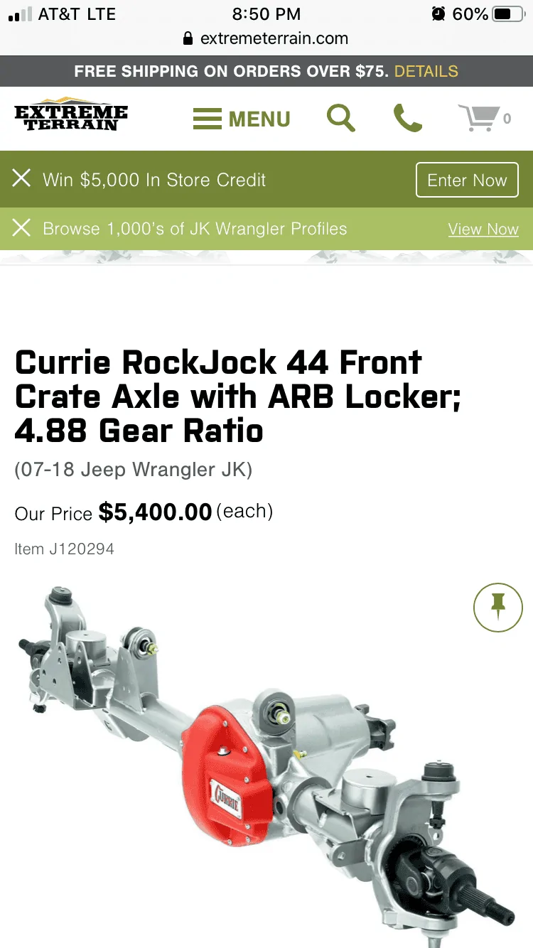

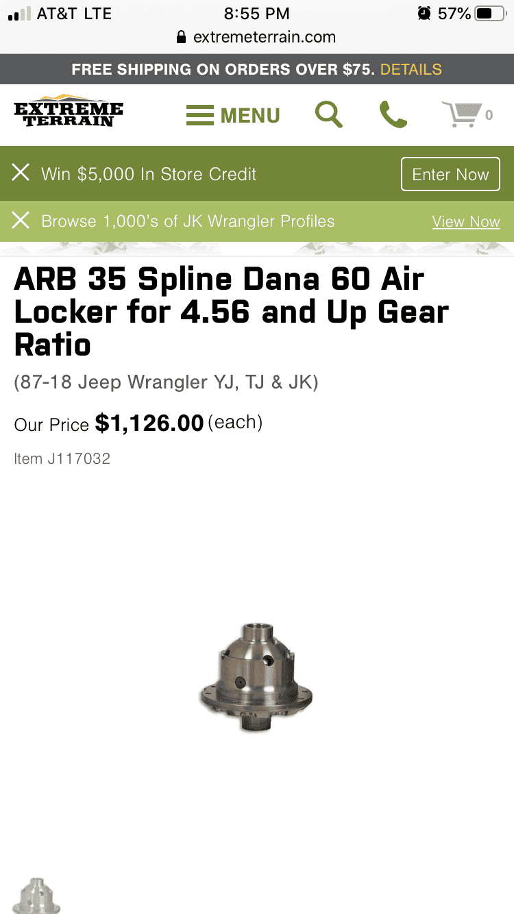

I know what you are saying but that $6k difference will probably be a lot more aftermarket if you wanted the same things. You also have to figure in labor on installing the parts is going to cost a couple grand
here are some Jeep parts to compare. An ARB air locker which also needs an onboard air compressor to be installed unlike the stock electronic locker. And some complete axle swaps with lockers.
