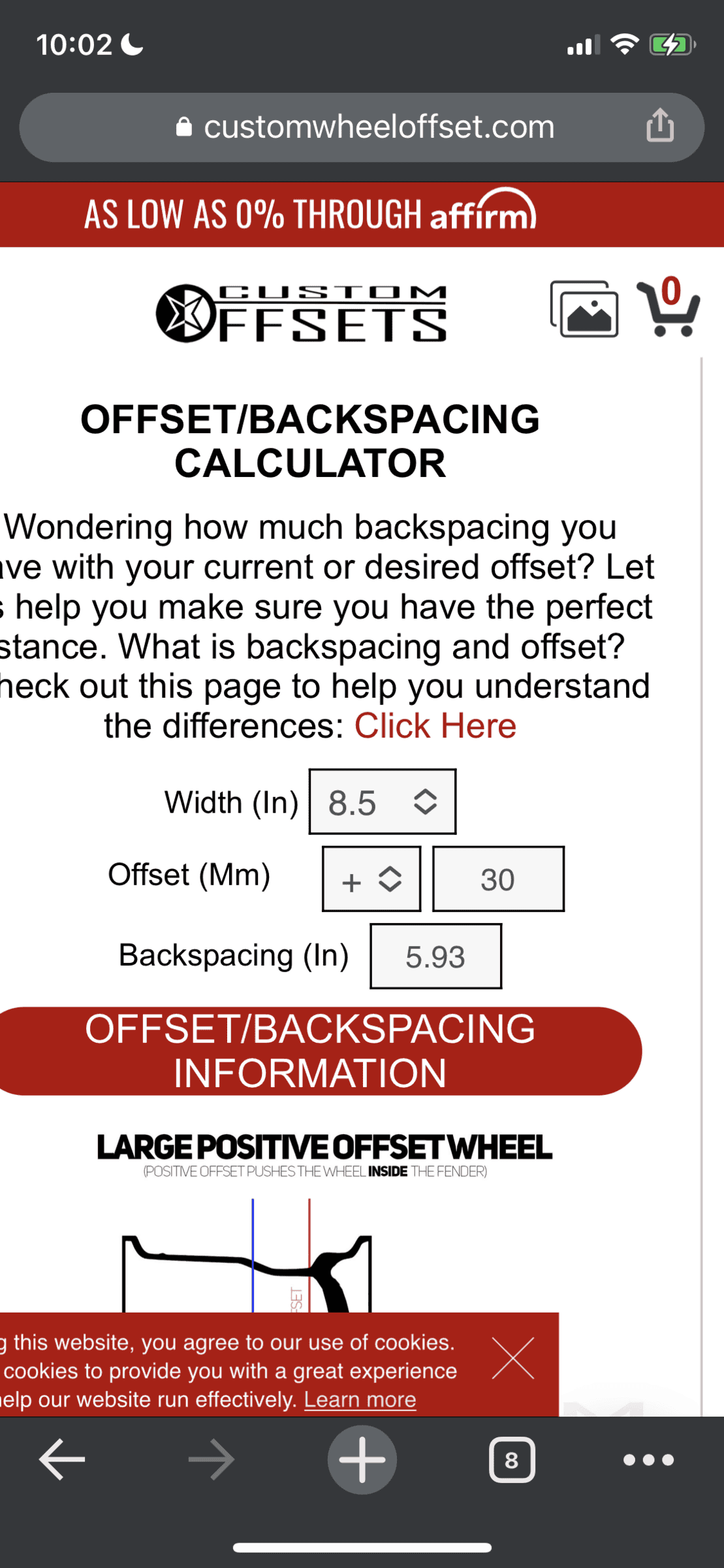

Does anyone know what the backspacing is for the Badlands wheel (SAS model). I have calculated it using the following:
Wheel width divided by 2, and then add the wheel offset, converted to inches (30mm= 1.18 inches)
8.5/2= 4.25 inches + 1.18 inches = 5.43 inches backspacing
Is this right and if not what is the correct backspacing number??

Ford Bronco Backspacing for Badlands Wheel 908EB448-1395-4377-8A48-6DEC022FA9A7
