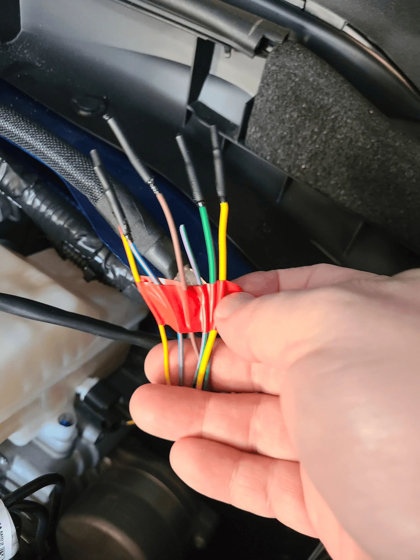

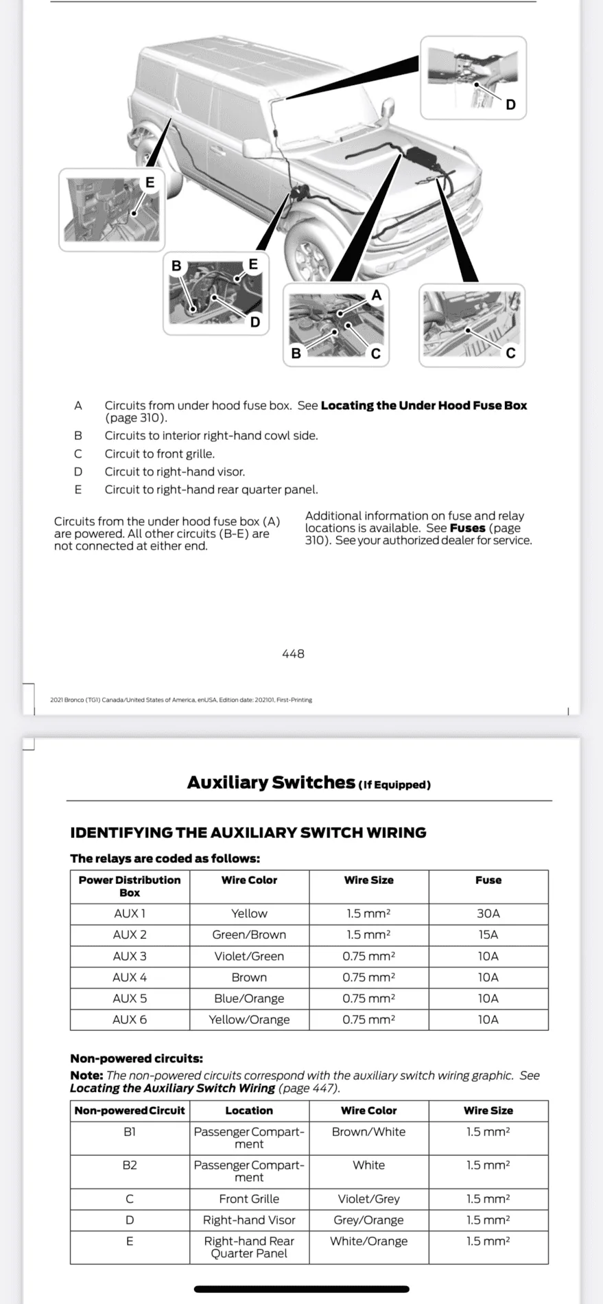

I'm assuming he used an app to post that caused all caps to be used and I suppose can give him the benefit of the doubt on it for now. Your description regarding how you connected the different sets of lights to the Aux switches is not entirely clear. It sounds like you connected them to only one of the Aux switch wires - purple (?), which almost sounds like the wire located at the front grill on top of the radiator. In any event, you need to connect each set of lights to the different uplifter feeds (color coded). Those wires come out of part of the wiring loom near driver's side fire wall in the engine compartment. Here are some diagrams and a pic of those wires from another thread that might be helpful, and a link to a tutorial on wiring the Aux switches https://thebronconation.com/how-to-use-the-auxiliary-switches-on-your-bronco/
And another thread doing something different but has info in it on location and hook up that might be helpful. https://www.bronco6g.com/forum/thre...ther-packs-and-4x4truckled-wiring-loom.26109/
Ford Bronco Aux switch question 1649423979636
Ford Bronco Aux switch question 1649424511316

I INSTALLED THE MARKER LIGHTS ON AUX 4 AND LETTERING ON 5. I RAN BOTH WIRES TO THE PURPLE WIRE WHICH SEEMS TO WORK BUT NOT INDIVIDUALLY
Those two sentences seem to contradict each other. You want both to act as individual circuits, yet you actually only tied them into a single circuit...?
