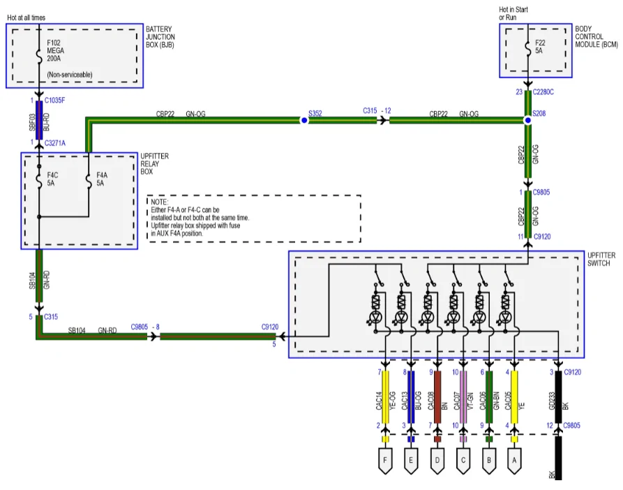

Below is a diagram of the power circuit, not the switches in the cab.
Is the "pod relay" you are referring to a relay you added to run the lights? If so, sounds like the added relay, when it shorted, took out the ford factory relay (that is operated by the in-cab switch).
In other words I think you may have to replace the ford factory relay and the "pod relay".
https://www.bronco6g.com/forum/thre...g-diagram-video-discussions.13485/post-593783
Thanks for the diagram
So to clarify, I installed the relay as part of the pod light kit to pull higher amps from the battery. This part is external to the vehicle electronics.
So some more info: I am using 3 of the aux lines 4,5,6 for pod and fog lights, which I believe corresponds to D,E,F. I have power on some of the switches so I assume the battery junction box is working. I do not read a voltage when connecting wire E to the negative battery terminal, but I do on the other switches. Also the AUX switch lights up amber when flipping them in the cab so there is power running up there...
Is wire E possible bad?
