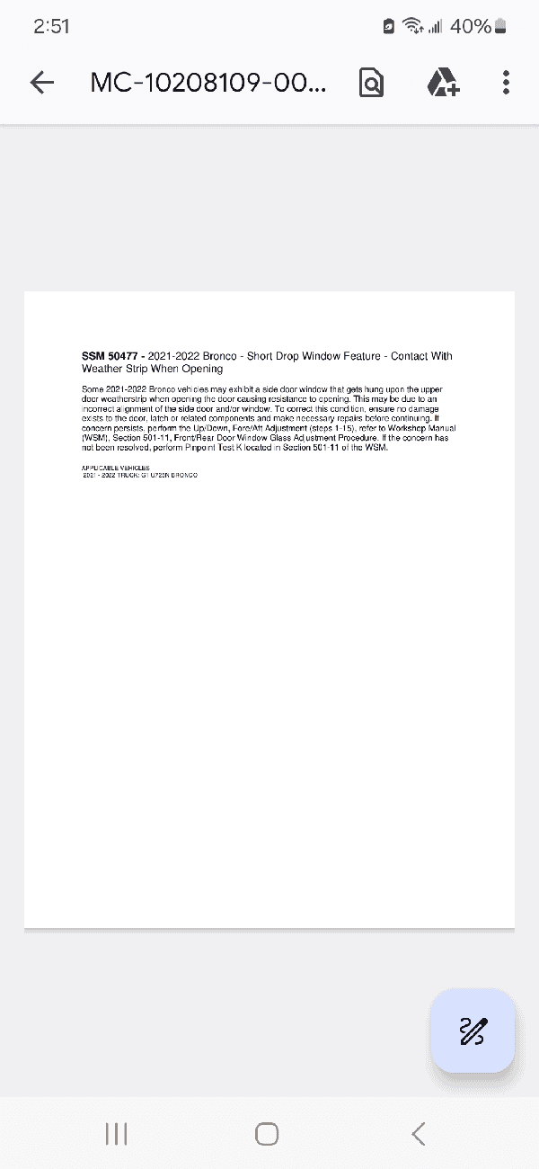

- the short drop window fix is something that we may have to fix on our own based on shop traffic
