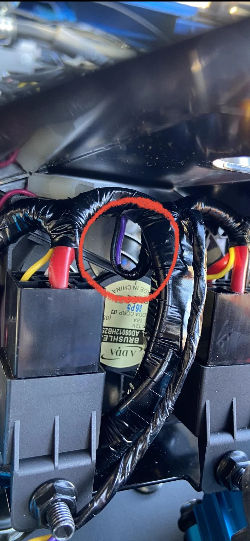

Finally got around to installing the ARB Twin Compressor in my engine bay. Got everything wired up, started the vehicle, and turned on the isolator switch...compressor turned on, but the fan doesn't turn. I can see the fan wanting to turn, but it never does. Bad fan? Wiring problem? Something else?

Removed the shroud to check the wire connections on the compressor and noticed this pair of wires (circled in red) were bent towards the fan and was blocking the fan from spinning. I tucked the wired up and over the bigger wire loom and all is good now. Whew!
