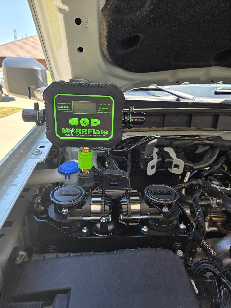

Well....another install weekend. This time an ARB dual onboard compressor with the Grimm Offroad vertical mount.
Ford Bronco ARB / Grimm Offroad compressor install. 20250720_122249
The install was pretty strait forward, with ALMOST no surprises. The mounting position allows for my Morrflate automatic 4 tire inflator to just plug in the top instead of having to hang it from the hood latch during use. A nice addition to any rig. You can hook up all 4 tires, set the pressure you want, turn on the compressor and it'll stop when the pre set pressure is reached.

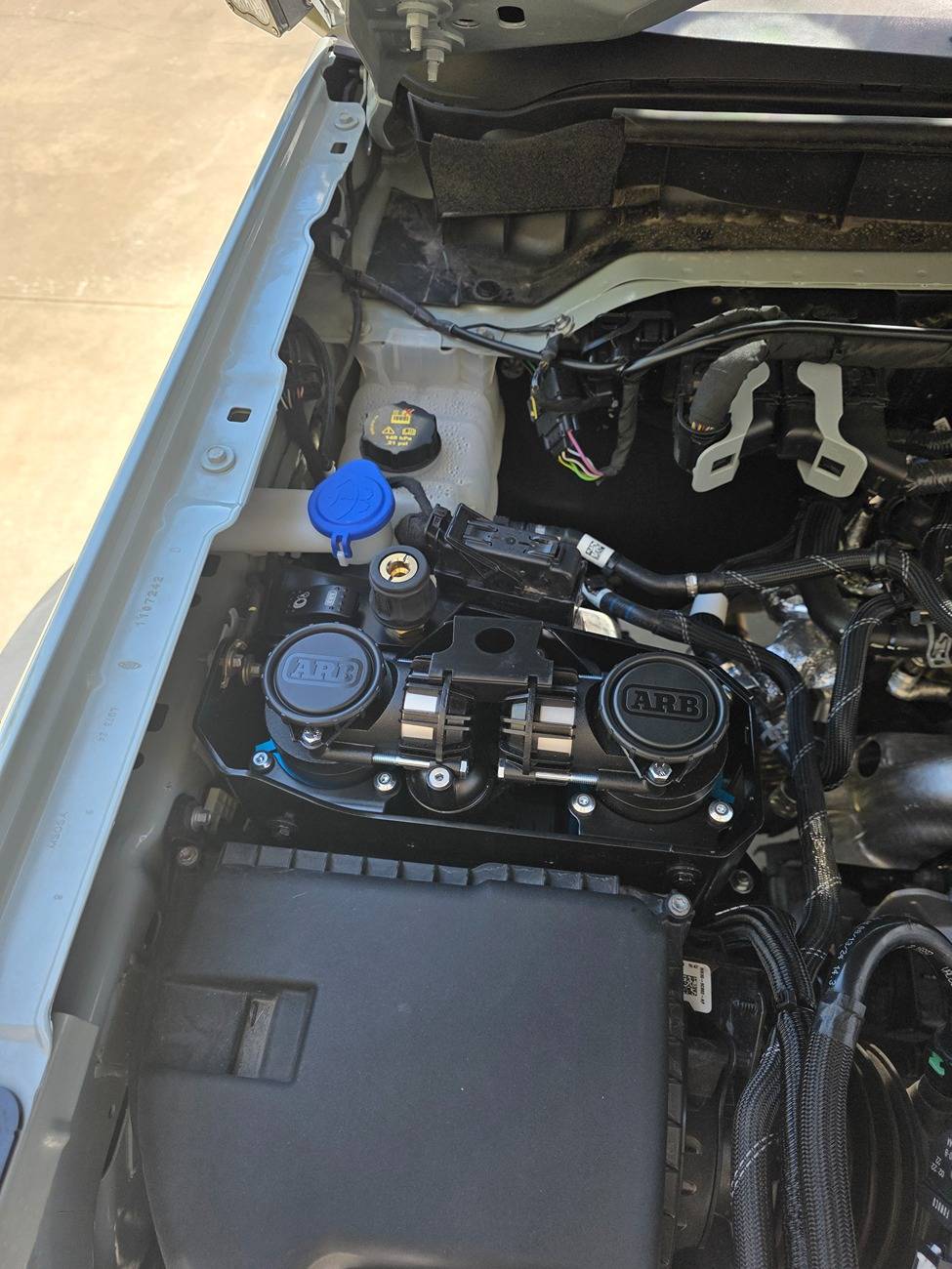

Ford Bronco ARB / Grimm Offroad compressor install. 20250720_122358
It has an "OEM" look to the entire system IMO, if you spend a little time to clean up the wiring and attach them in OEM spots.

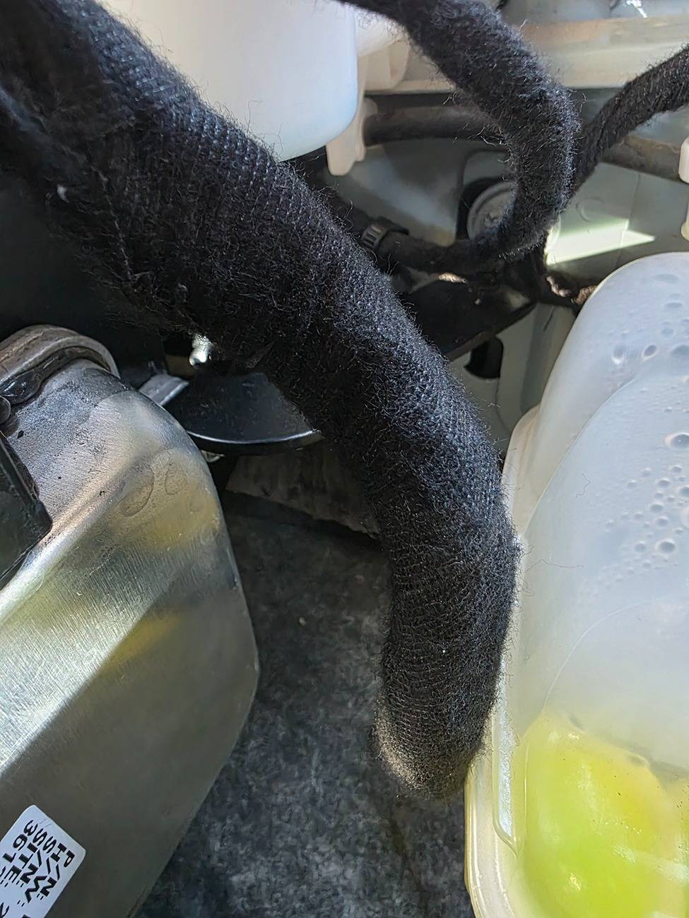

Only 2 minor issues during the install, one of which I solved by thinking ahead a little.
The first was the bracket location that is placed under the washer fluid refill spout. I'd recommend loosely installing this on the ECU prior to setting in the compressor and mount due to the lack of space to get your hands under there.

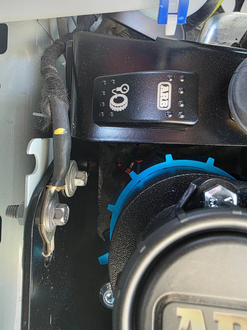

The second issue was one of the original ECU bolts that are re-used to mount the Grimm mount left the chat early and decided to go hang out with all my missing socks and 10mm sockets! 😂
I'd recommend tying a fishing line to those bolts while getting them started, then breaking off the line before tightening them up.
I dont think ill replace it though, as the ground bolt also doubles as another mounting point through the ground and Grimm mounting bracket.
