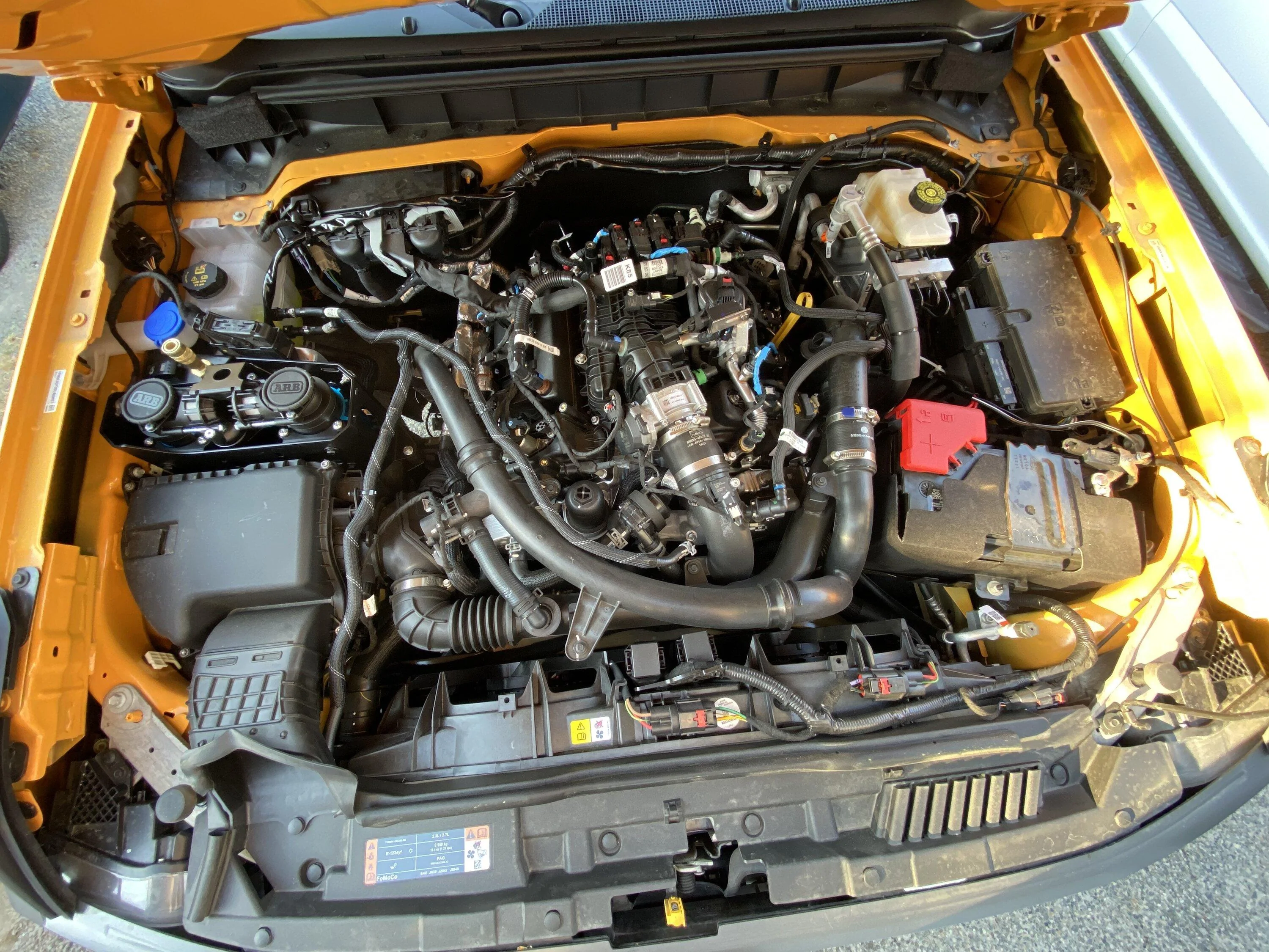

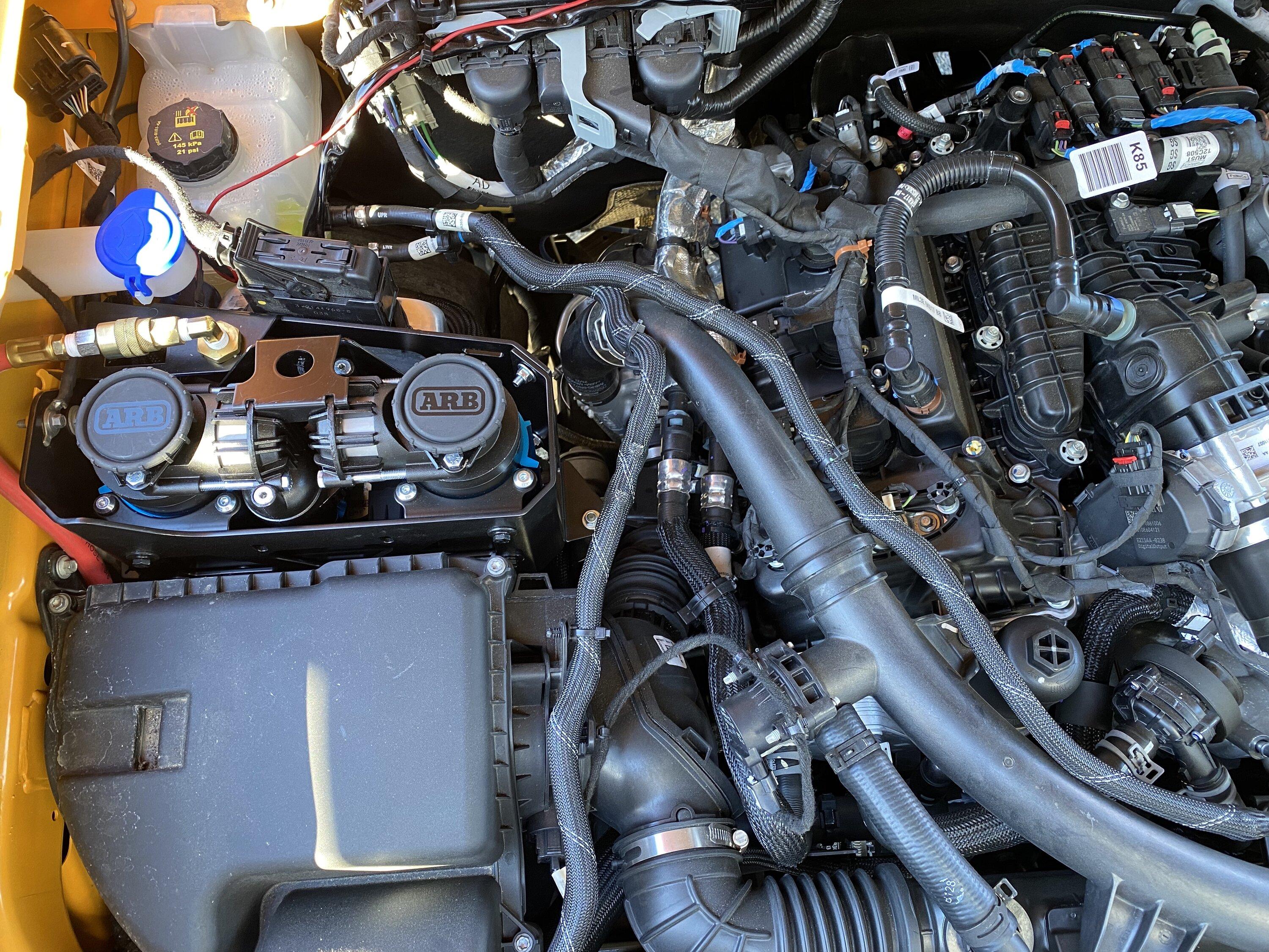

Got my ARB compressor mounted with the Grimm mount last week. I got it on Labor Day sale with free shipping from Northridge4x4 (@Tech Tim ).
The kit was packaged very well and includes a wire harness and jumper hose with a bulkhead fitting. The mount itself is very high quality and well thought out. It makes the compressor look like it was there from the factory. Exactly what I've been waiting for.
As for the install, 3/4 of my time was spent on that one bolt! Other than that, easy peasy.
The standard air coupler clears the hood, but is a little too close for comfort. It's only temporary as I'll be plumbing in an air tank, front and rear couplers, and wiring to an accessory switch.

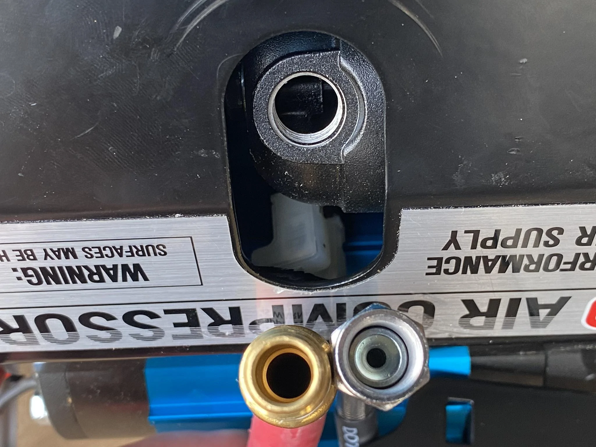

I was a little surprised how much the JIC-4 line chokes down. I'm very curious if it is reducing flow. I will be doing some testing at some point, but not excited about removing the compressor to get at the line. :cry:
Wow, that's a pretty surprising restriction. It might reduce flow if you're airing up all four tires at once, or maybe if you're plumbed into an air tank and using air tools. How much it would reduce it is anyone's guess and probably would require some actual testing to find out whether it's even going to impact what you'd use the compressor for. If you're just airing up a single tire at a time, I don't think it'll be a problem at all as the valve stem is going to be the bottleneck in that situation.
