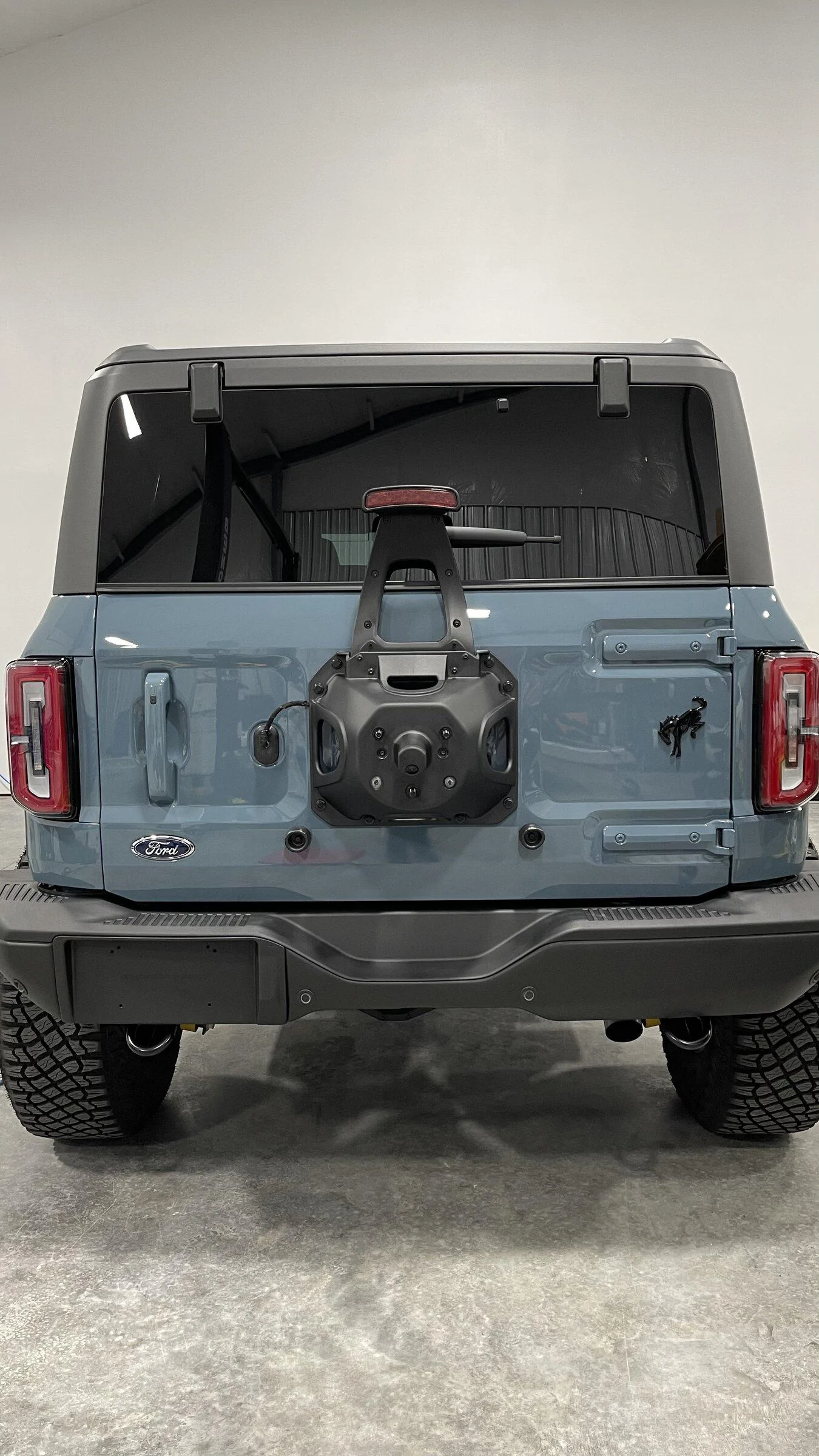

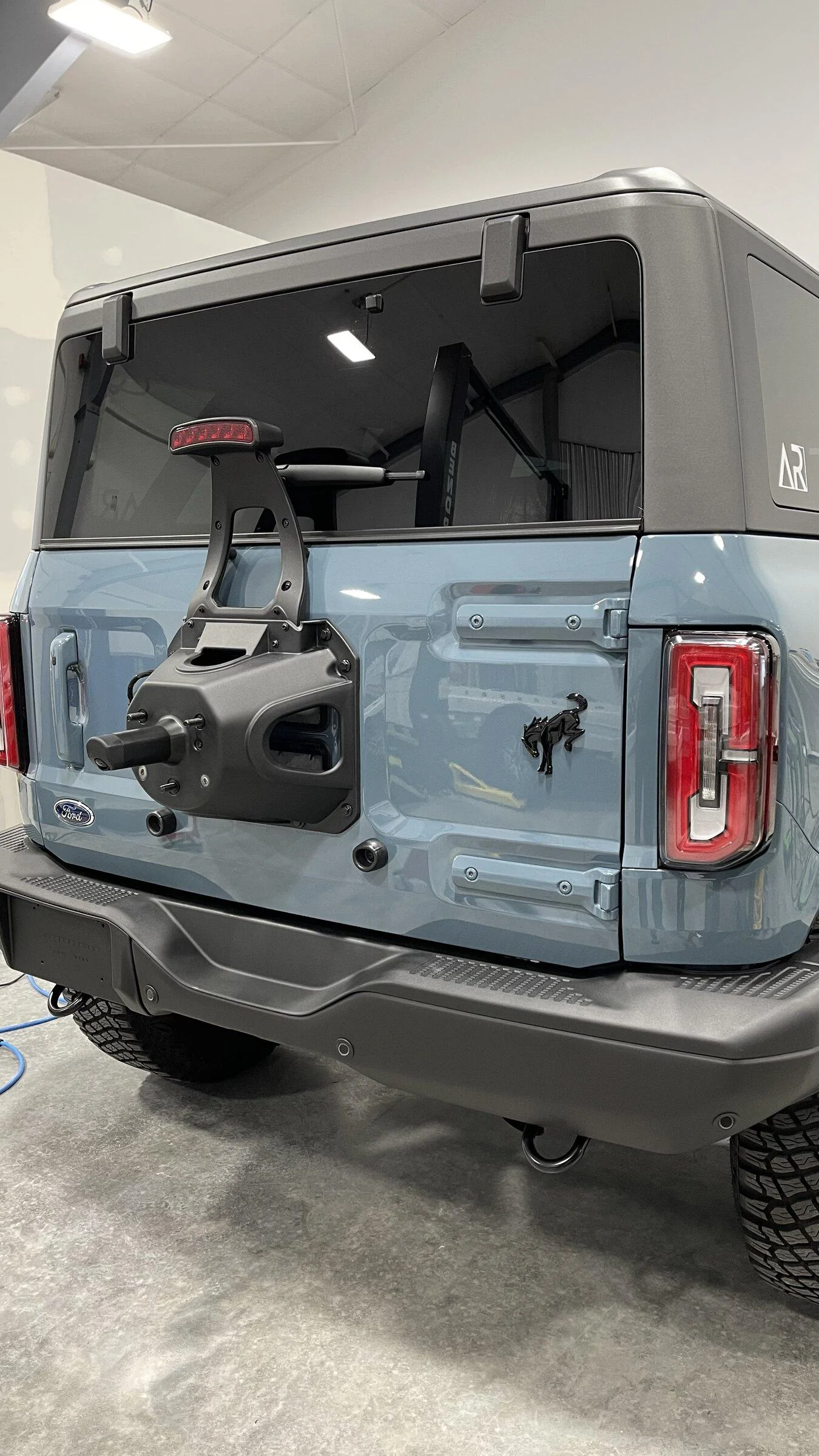

AR | SADDLEBAG Tailgate Modular Mount

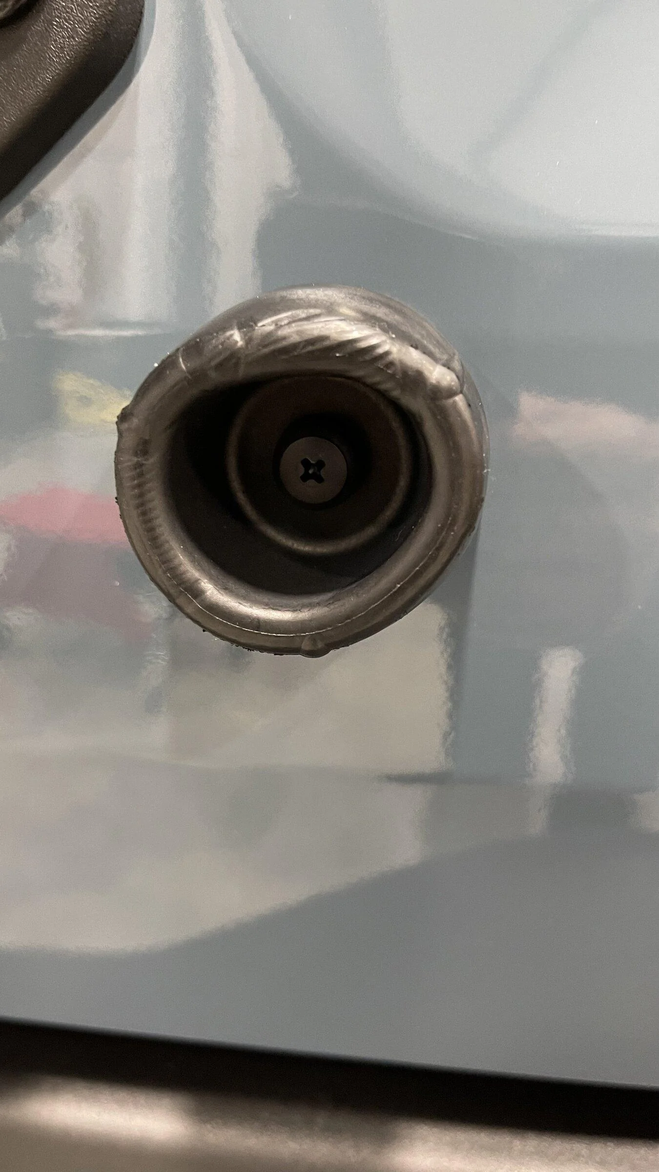

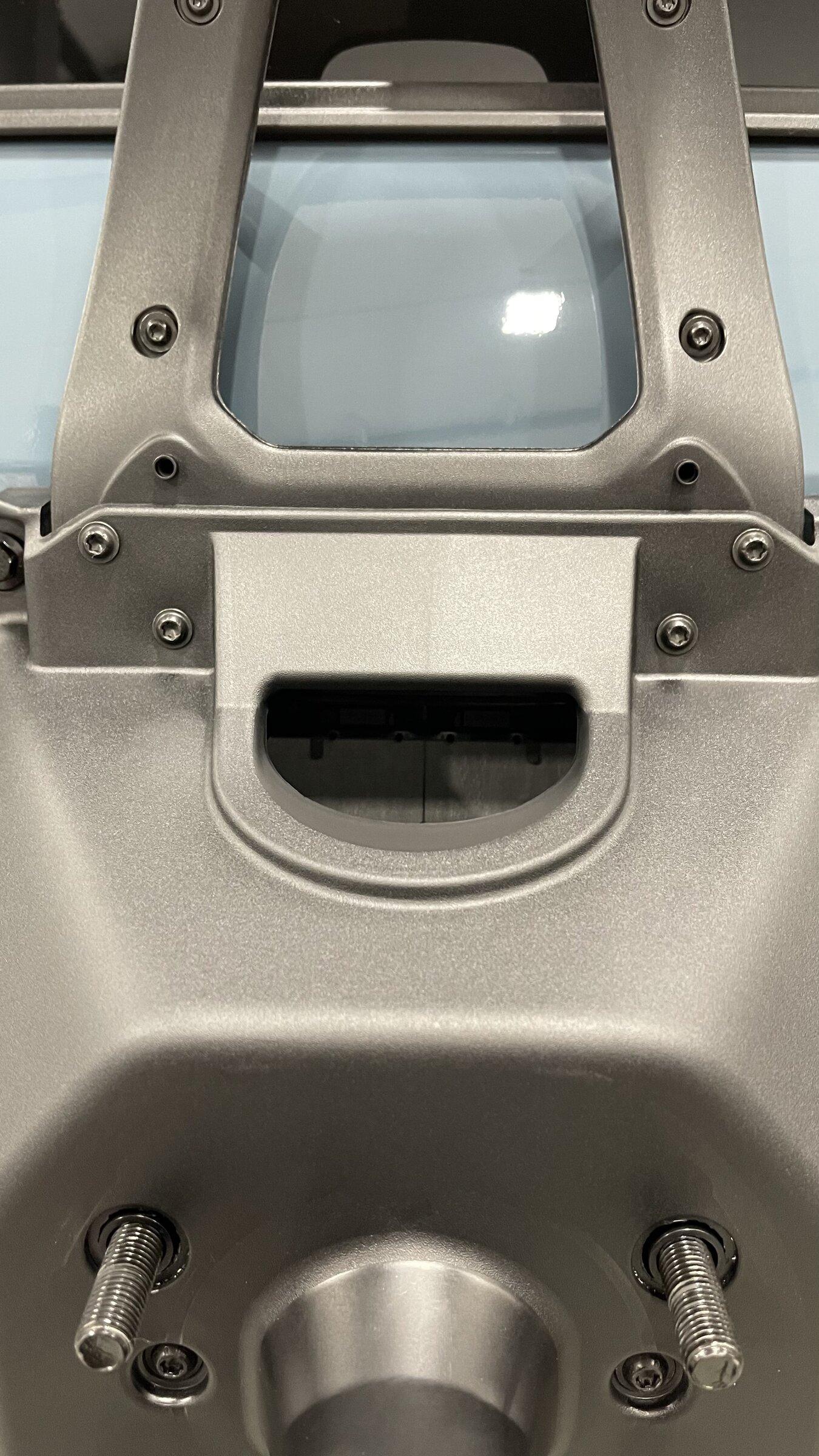

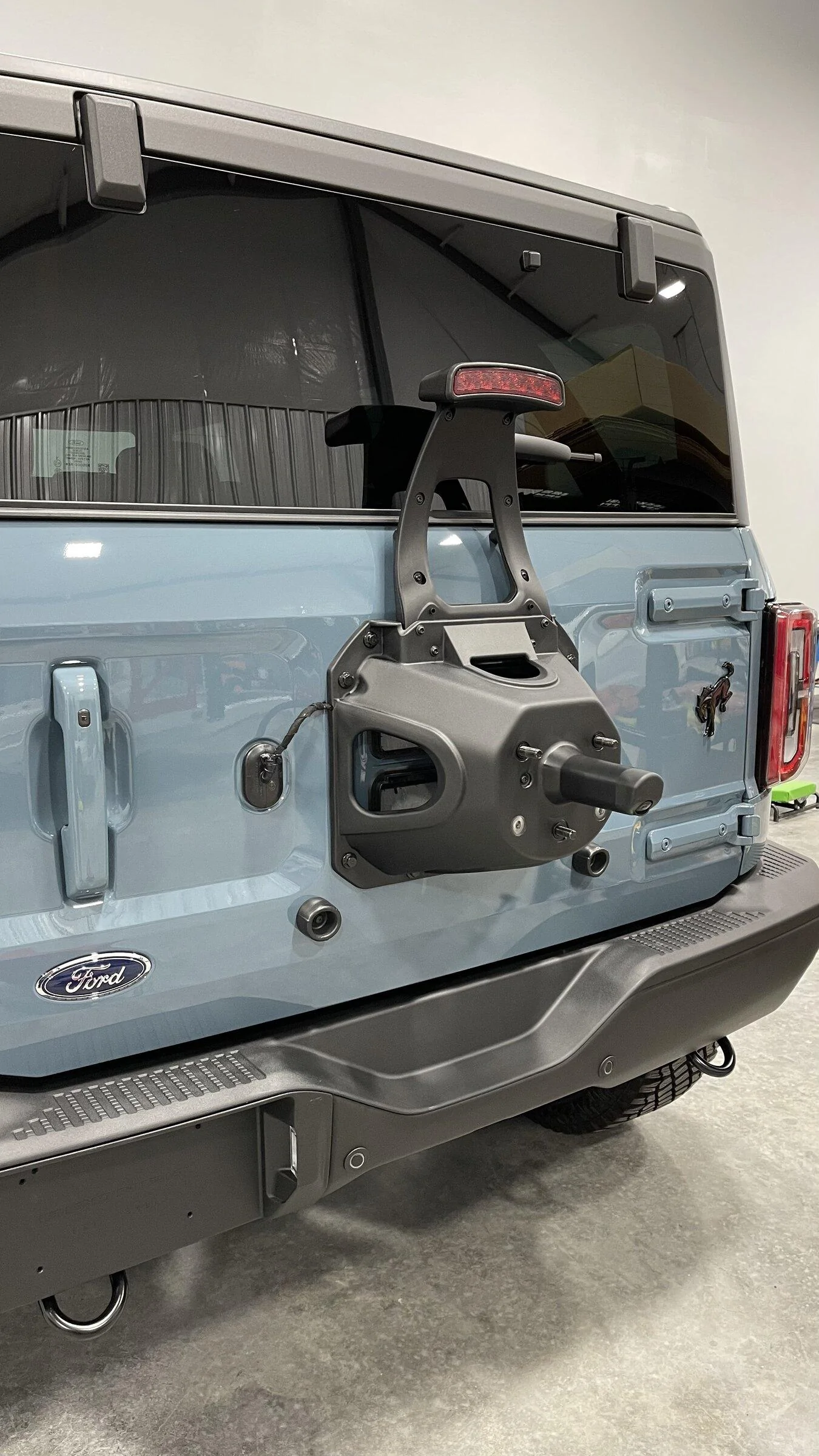

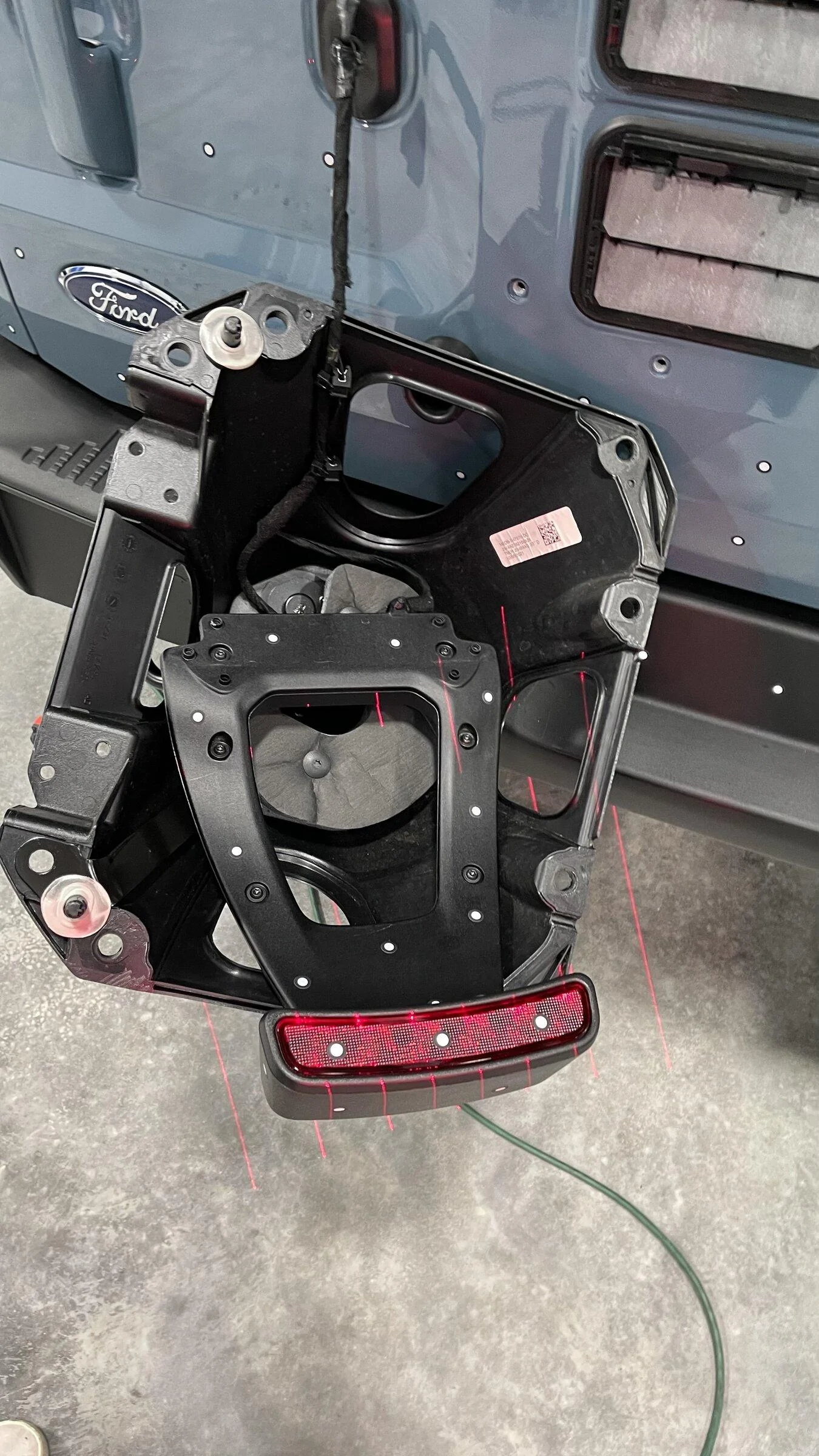

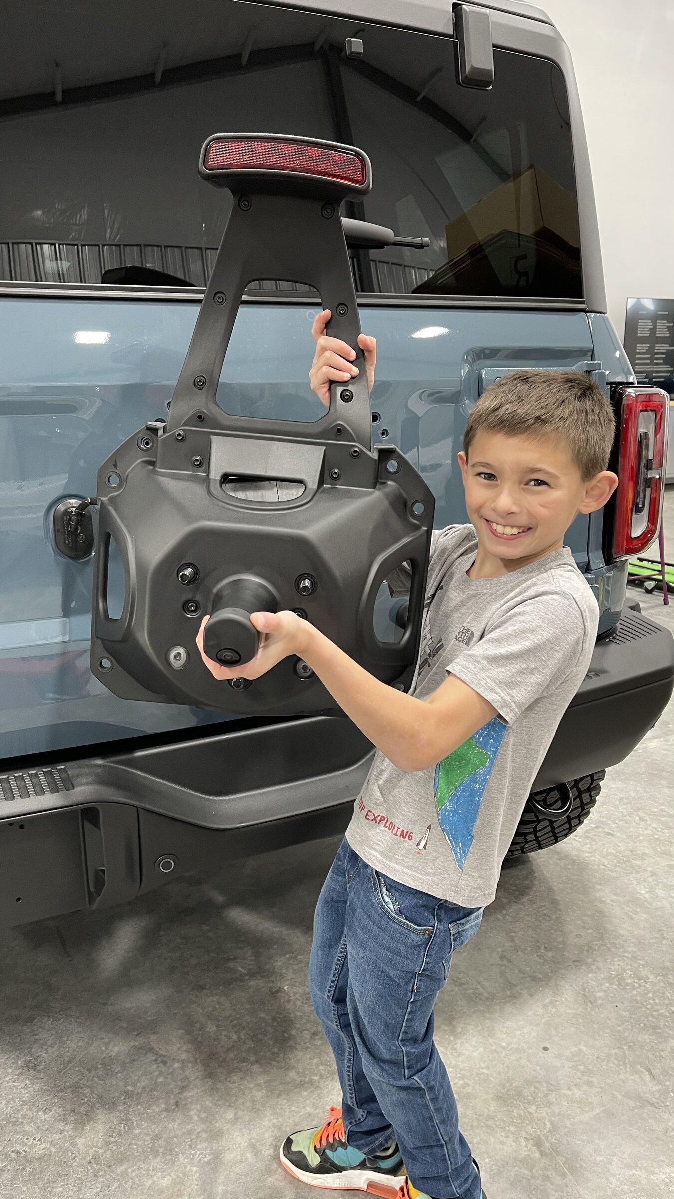

In my time detailing and paint correcting our Bronco, I pulled off the spare tire to compound and polish behind it. Three lug nuts and the spare comes off. Humm... Since that's off, let's go ahead and pull the mount bracket for the spare. Eight bolts and that comes off. I ask my sons Rocco and Broderick to hold onto it as I remove the last couple bolts. I'm expecting it to be this plastic covered chunky piece of metal...
It's basically all plastic.
We've had SADDLEBAG on our design board for a while. I didn't think it would come toward the upper part of the list so quickly. I LOVE modular designs, and this, like the Roof Rack, we'll be throwing the kitchen sink at. The most basic form of the SADDLEBAG will be a spare tire mount delete. From there, brackets can be added that join the tailgate hinges with the modular base plate. You can also add back a stronger/better billet spare tire mount. Due to the size of the items, MaxTrax on the driver side of the spare and Rotopax or a NATO Jerry Can on the passenger side. We can also go HiLift jack on the driver side. Really we just need to clear the door handle on one side and not block the tail light on the other.

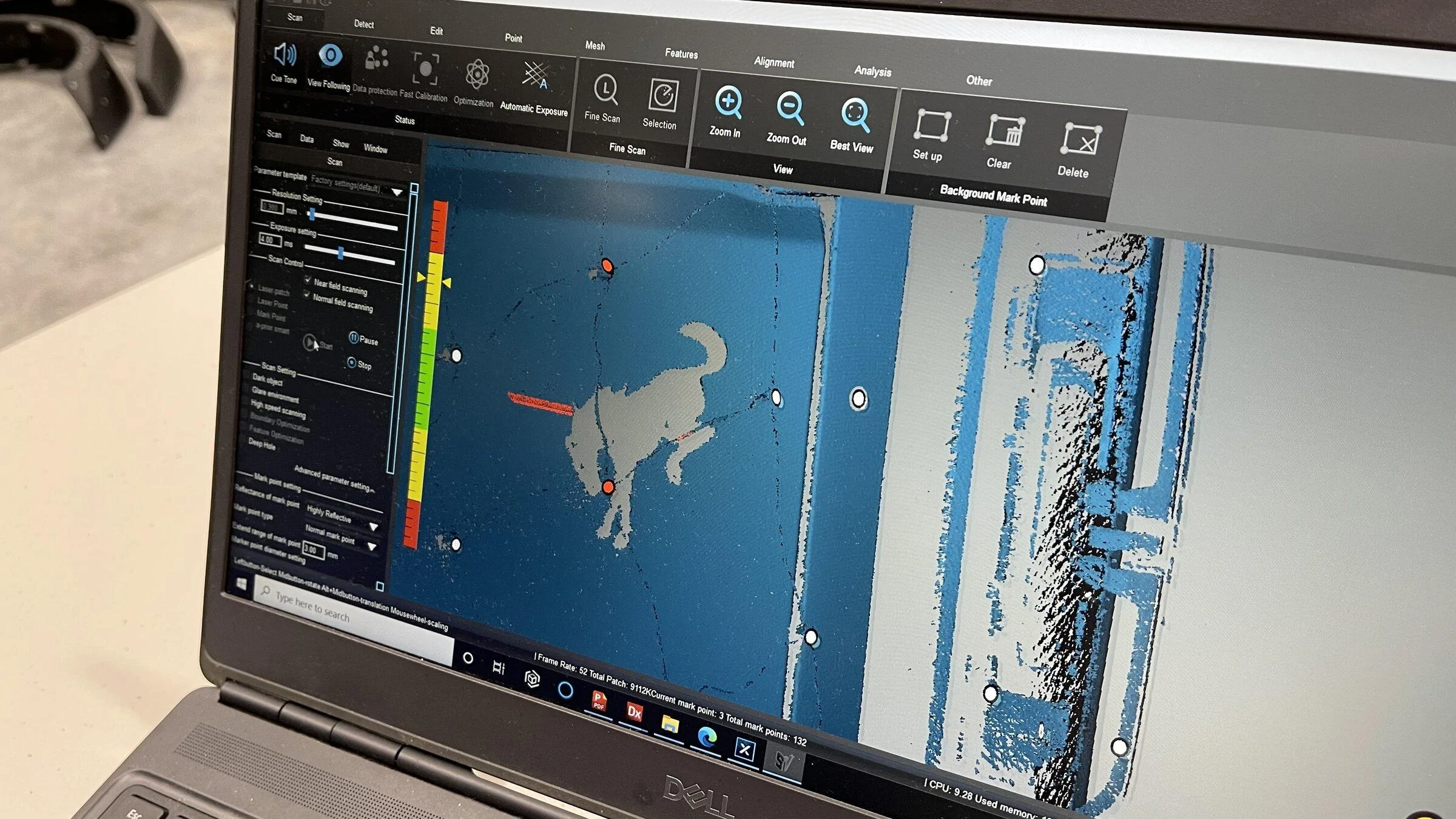

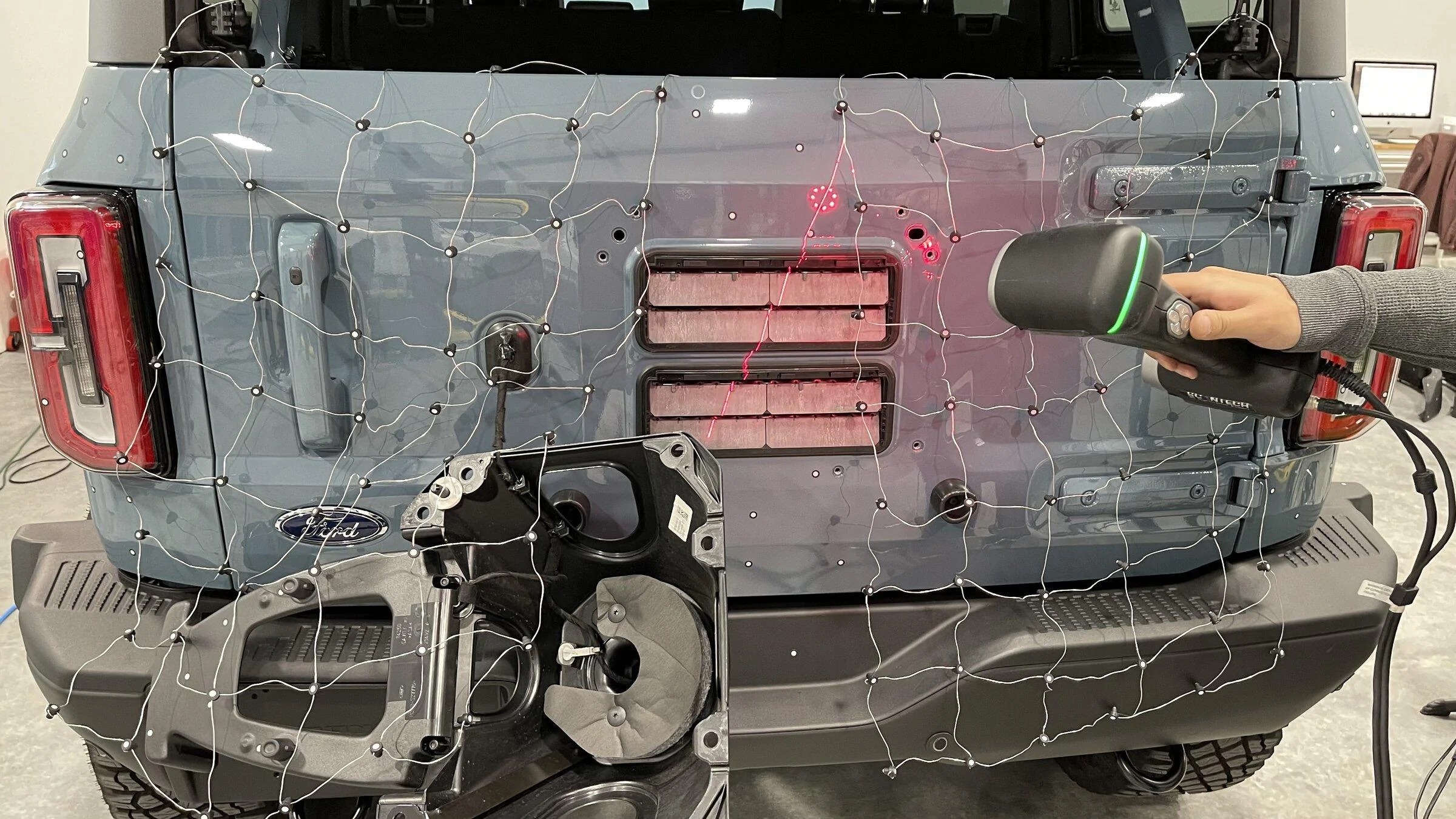

With the modular base plate, we'll be able to continuously evolve what mounts where and how it mounts. I would expect renders in a couple weeks of the initial designs. The stripped down tailgate is getting 3D scanned tomorrow for further R&D and modeling. Let me know what your thoughts are and what you'd want to see incorporated. Like the other projects, the community's input is welcome.

3rd brake light height adjustability
That thing, by itself is hideous...
Figuring out a solution for it is definitely on the list.

Will since the spare tire mount is off can you make a heavy duty one to hold the weight of 37's.;)
