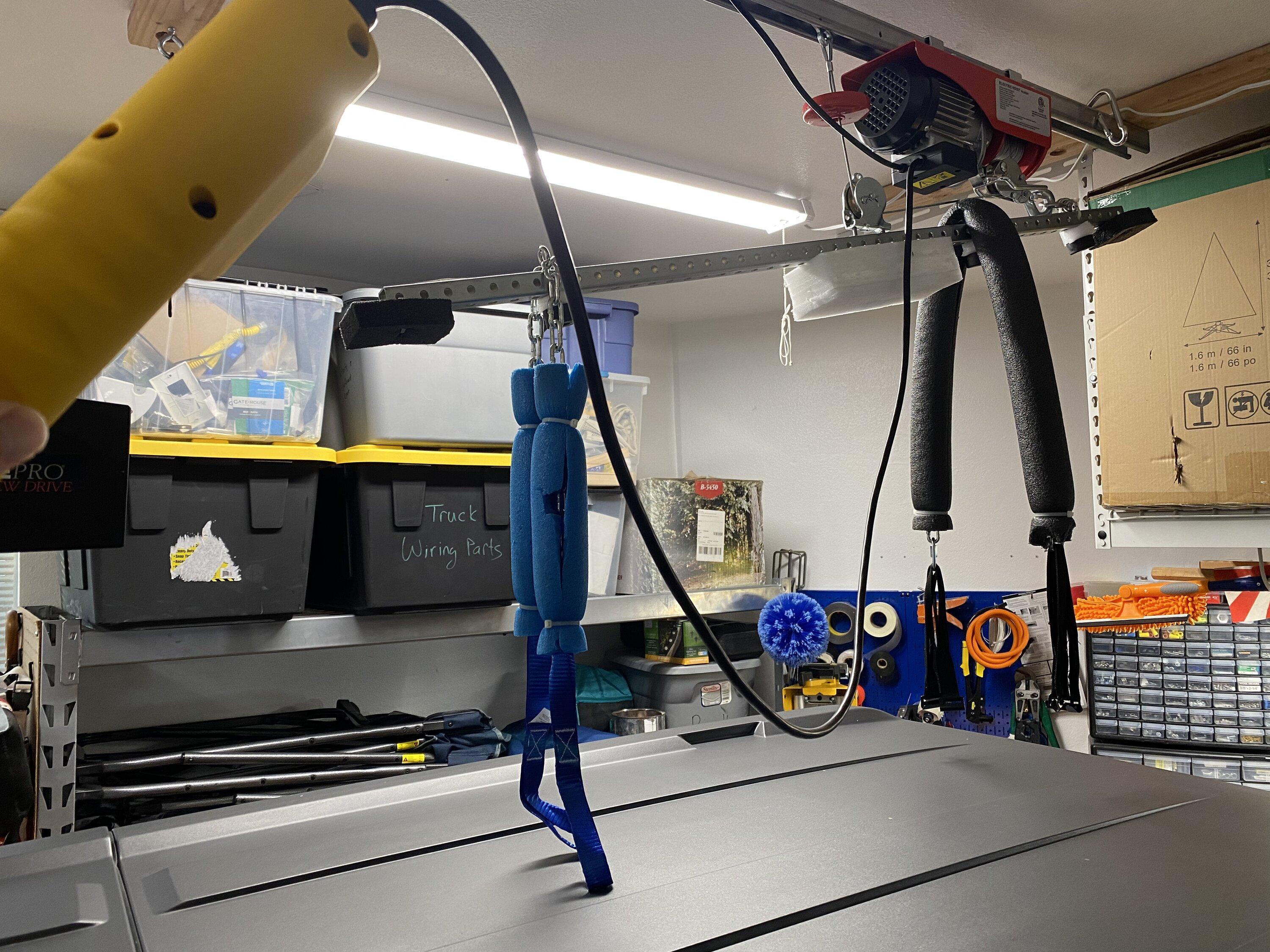

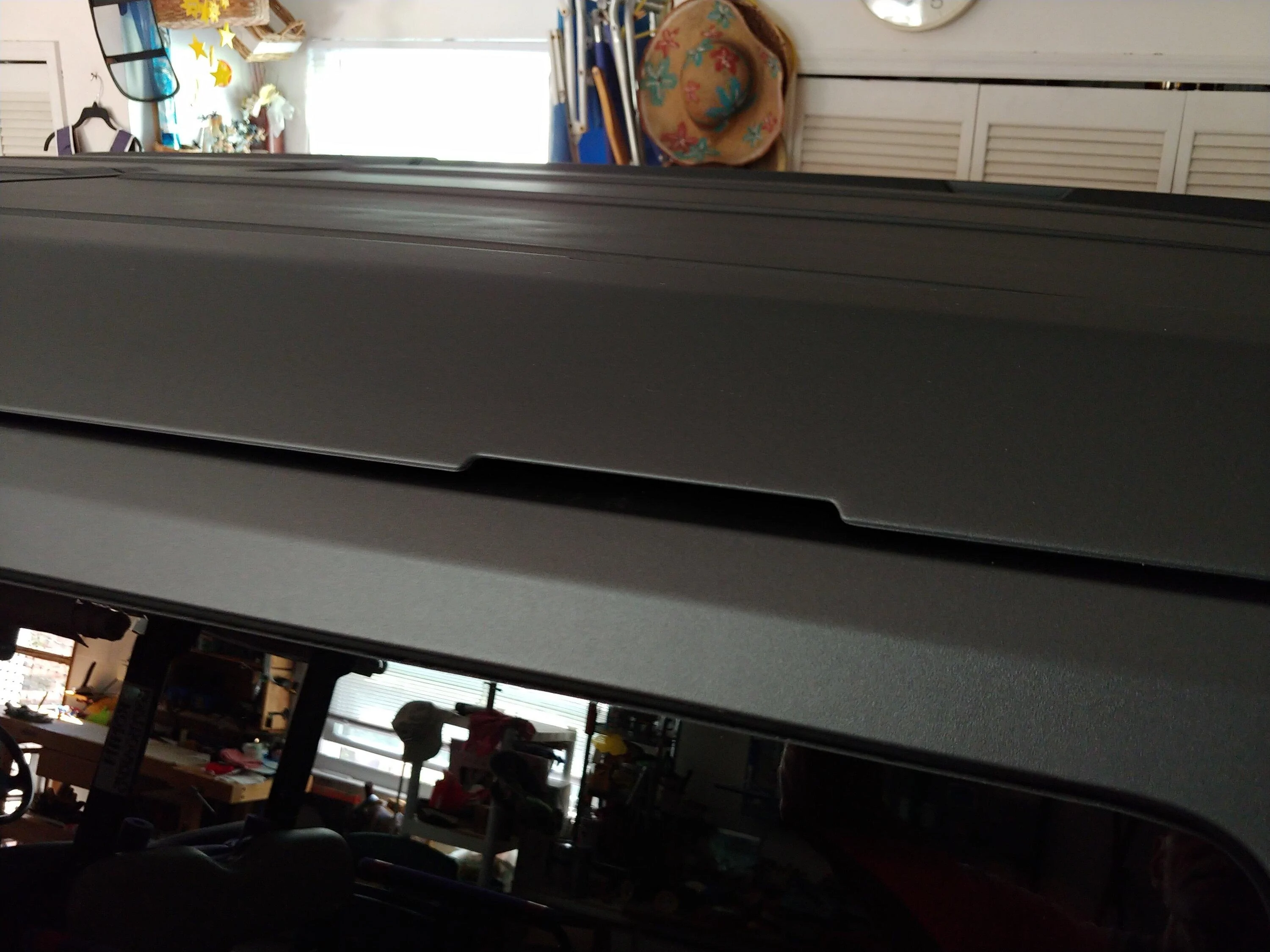

Trying to figure out a simple lift system using the custom lift points on my 2dr. I'm thinking if I could get a bracket like the one in the Lange lift system, all I might need to do is to attach a few lift straps to a motorized lift system. Anyone seen a lift bracket that would simply hook into the lift point on the hard top, and then attach to a lift strap? The front lift could simply be a hook. Would that work?

Did you get it to work? I agree we just need something like below that is rubber coated and fits well.
Called US Cargo Control and they are checking it out. Stay tuned.

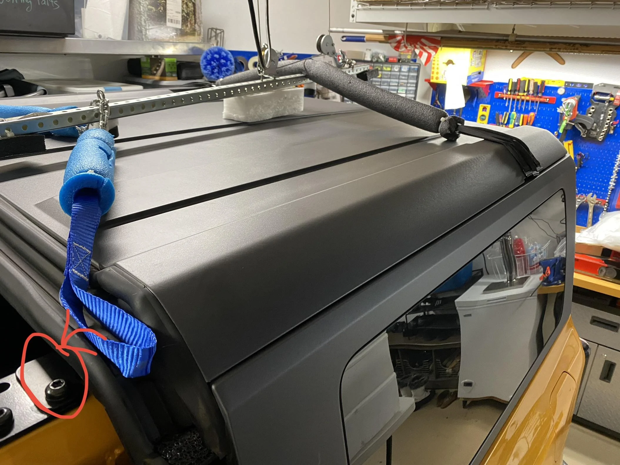

Soft Loop Tie Down Straps - 1,500... https://www.amazon.com/dp/B01N1NV536?ref=ppx_pop_mob_ap_share
HEYTRIP 6 Pack Cargo Tie-Down... https://www.amazon.com/dp/B08KZWJD5X?ref=ppx_pop_mob_ap_share
These are what I used. Took a little effort to find the center of gravity and keep the top from tilting back.
Hey Morgan, do you attach the cargo clips into the cargo rail slot on the side of the top or do you use the clips under the weatherstripping under the rear glass?
MorganF
Morgan
Nov 11, 2020
Carlsbad CA
2013 Ford F150 FX4
I attach it to the cargo rail slot.
