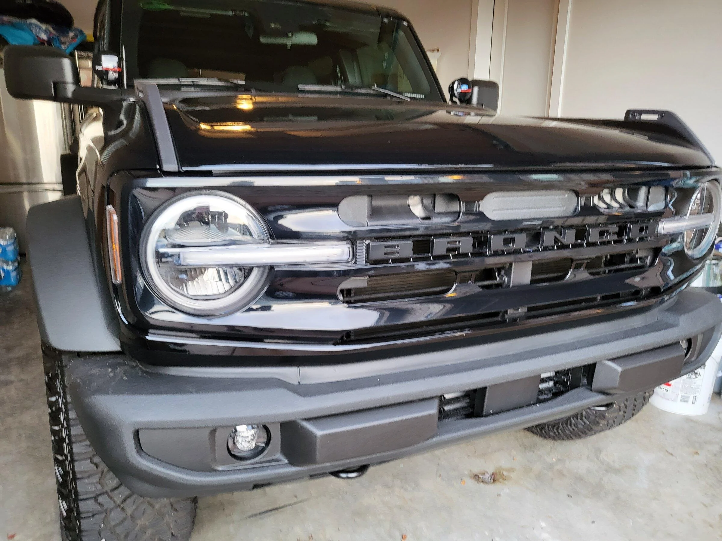

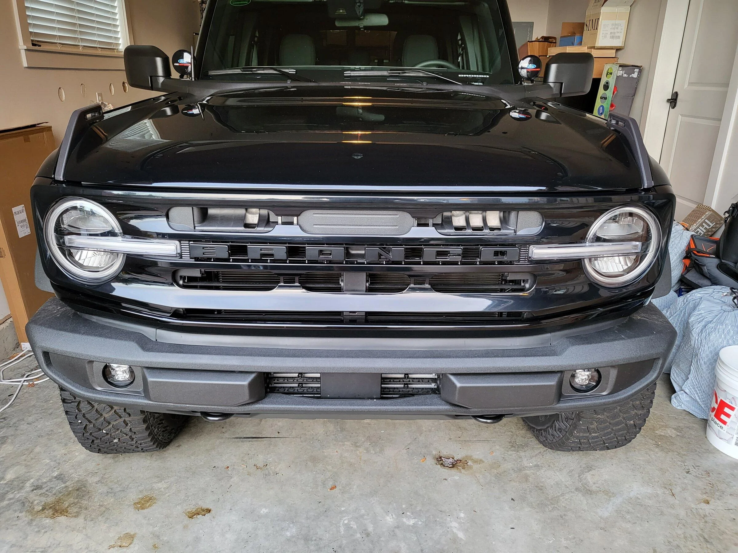

I had mine done at a paint shop for $400. I wanted to match the shadow black body color and did matte black on the letters. I still have to take off the gray filler plastic pieces and paint those black with some plastic paint because I don't like the gray showing through. I think that is where a front camera can go. I think I will also have it wrapped in Xpel self healing for $300 so it lasts and doesn't show every chip with the black paint.
Ford Bronco Anyone paint their own grille? 20220103_154937
Ford Bronco Anyone paint their own grille? 20220103_154914

i'm assuming that painting the adaptive cruise adapter would jack with it's function? would be cool if you could make that blacker too. looks great

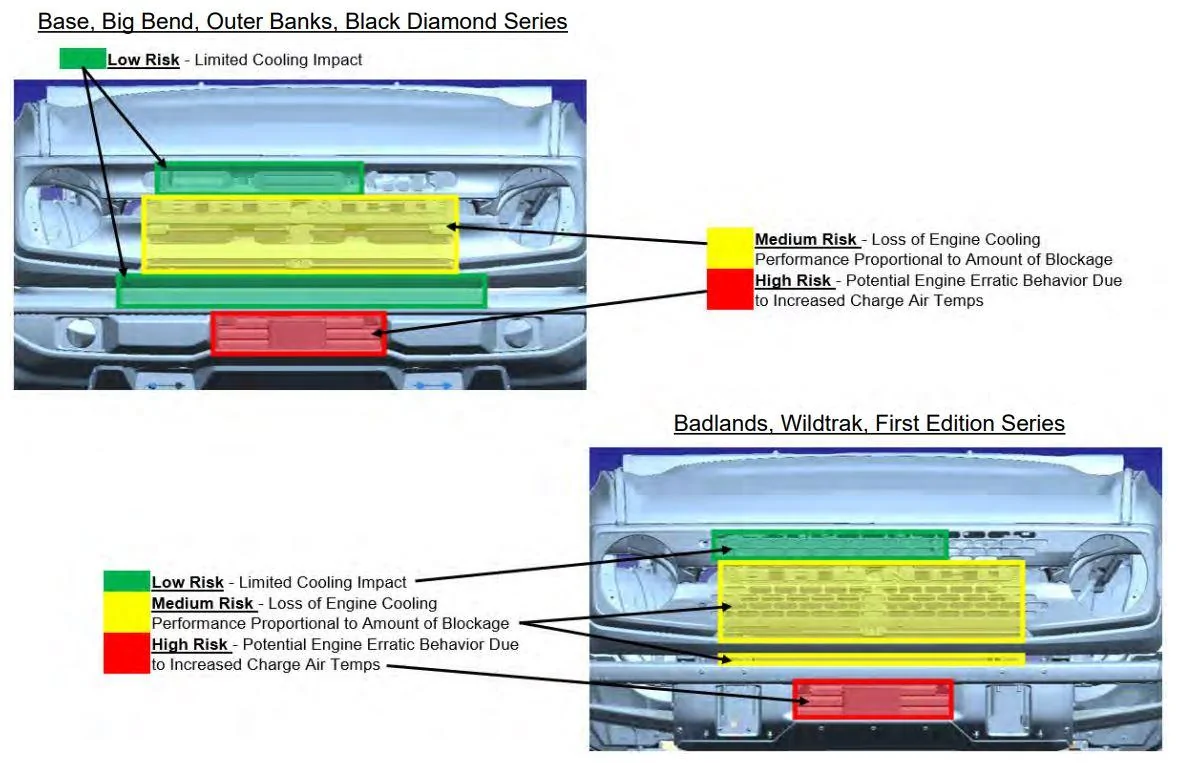

Will adding extra lights to the grill adversely affect/restrict airflow?

I wondered that. I haven't definitively decided to do that. If I did do one IN the grill I was considering the thin Baja Designs S8. I'm guessing I probably won't because I don't want to mess up the current look. I'm CERTAIN there will be aftermarket grilles soon with integrated light bars. I don't even know if I want one. I have the JCR pre-runner on modular bumper now and pocket lights. I live on edge of a West Texas town and am often on rural roads. I don't NEED a light bar (I don't think anyone does). But I think they are fun.

Also note per the question on impacting cooling, Ford did publish this doc and from it here is the part of interest:
Ford Bronco Anyone paint their own grille? Cooling impact zones
