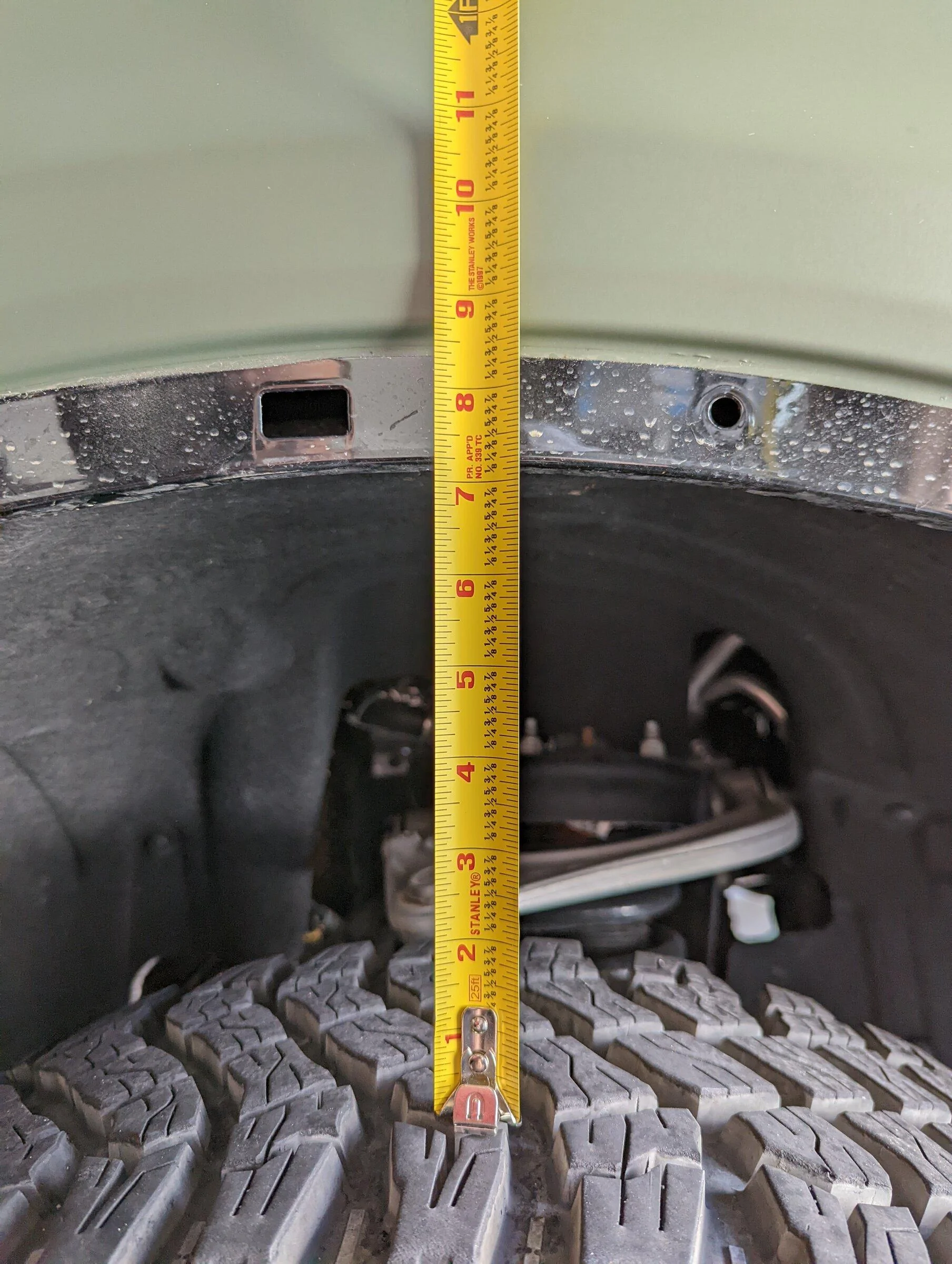

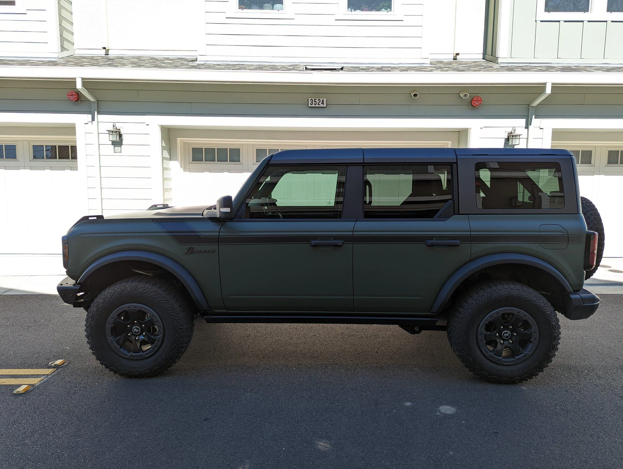

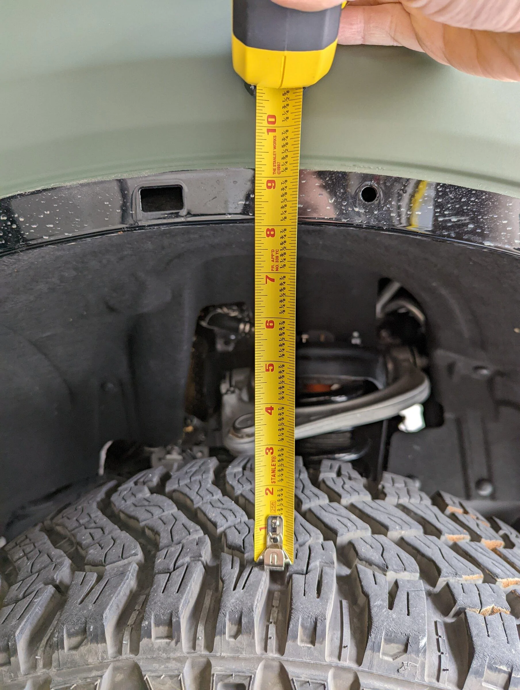

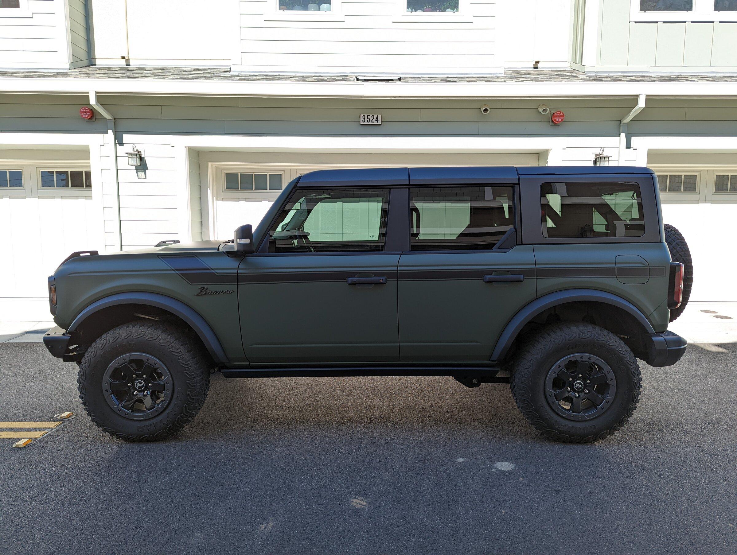

Here are some before and after pics for the 1" RC leveling kit for my badlands. Hard to get the vehicle in the same spot with same camera angle but from the measurements it was 7.25" from the wheel to the fender and is now at just shy of 8.25".
First time installing a level myself. Ran into some challenge every step of the way figuring stuff out on the first side then the second side only took an hour or so.
It looks so good. Mine is going on tomorrow, hoping for the same results. Not sure why it wouldn't be though.
The change is subtle but looks a lot better. Good looking rig there.

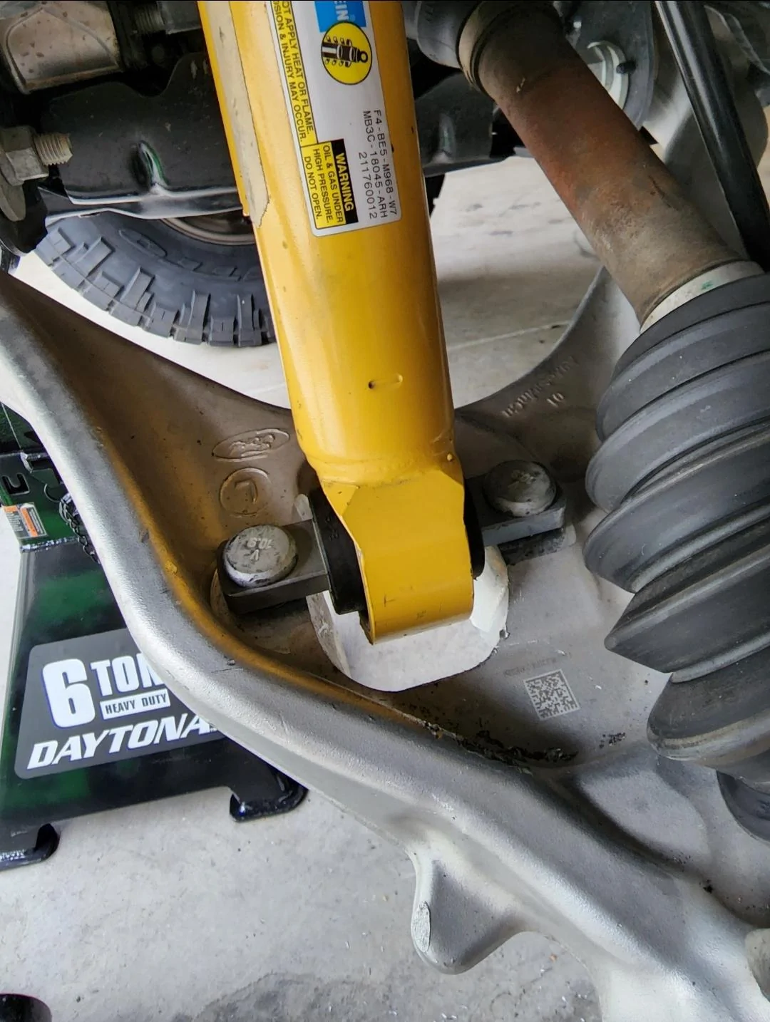

Awesome and thank you! I had the RC 1" level on while I had 35s and they were great but I have since installed the 2.25" front / 1.25" rear Wild Horses 4x4 perch collars w/ 37s.
I actually didn't feel like my front was as level as the perch collar kit should have made it (perhaps with the added winch weight in the front) but luckily I still had the RC spacers and used the lower ones to add just enough to level out the front.

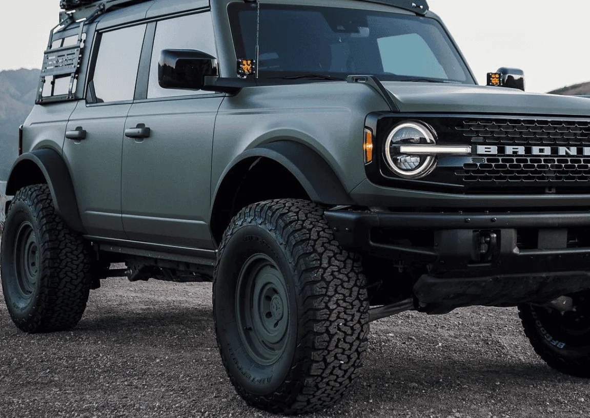

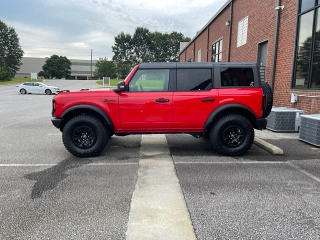

The color combo on the green and gold is killer. CJC Off Road did a Ram with a Carli lift and the same color combination that I was in love with.

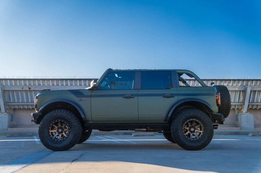

My plan is to put the GRT Off Road perch lift on mine in a year or so. I driver 40-50 miles a day right now and just assume put some miles on it as is before doing that. I will end up getting a little Ranger to drive back and forth to work and that's when I will pull that trigger.
I am going to go with the Fifteen 52 wheels and 37 Ko2 I think.
Basically this but Race Red and black wheels.

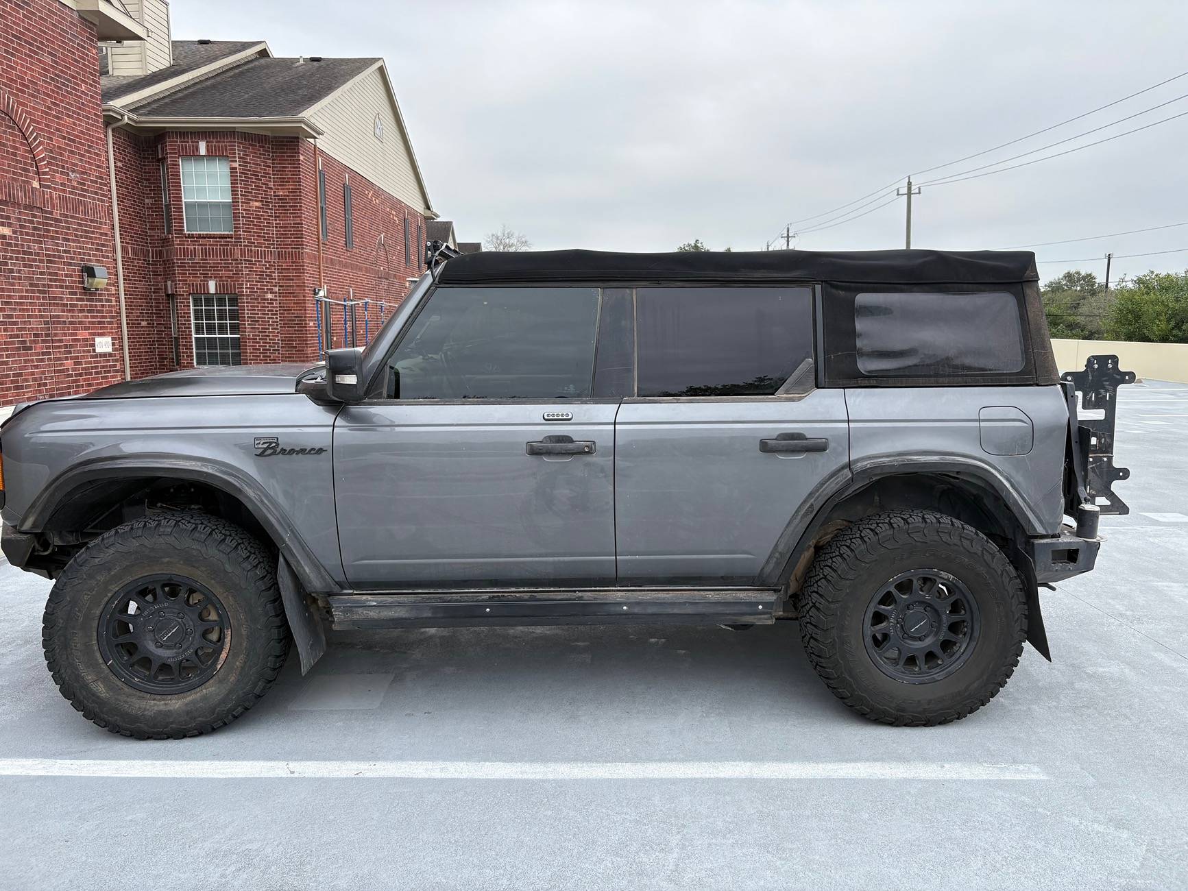

With 1.5” perch collars and 1“ RC front level kit, and a winch plus heavy armor. I’m now adding 1” or 2” RC top hat spacer to rear to do what you are referring to -restore rake and get a little lift for loading up gear.

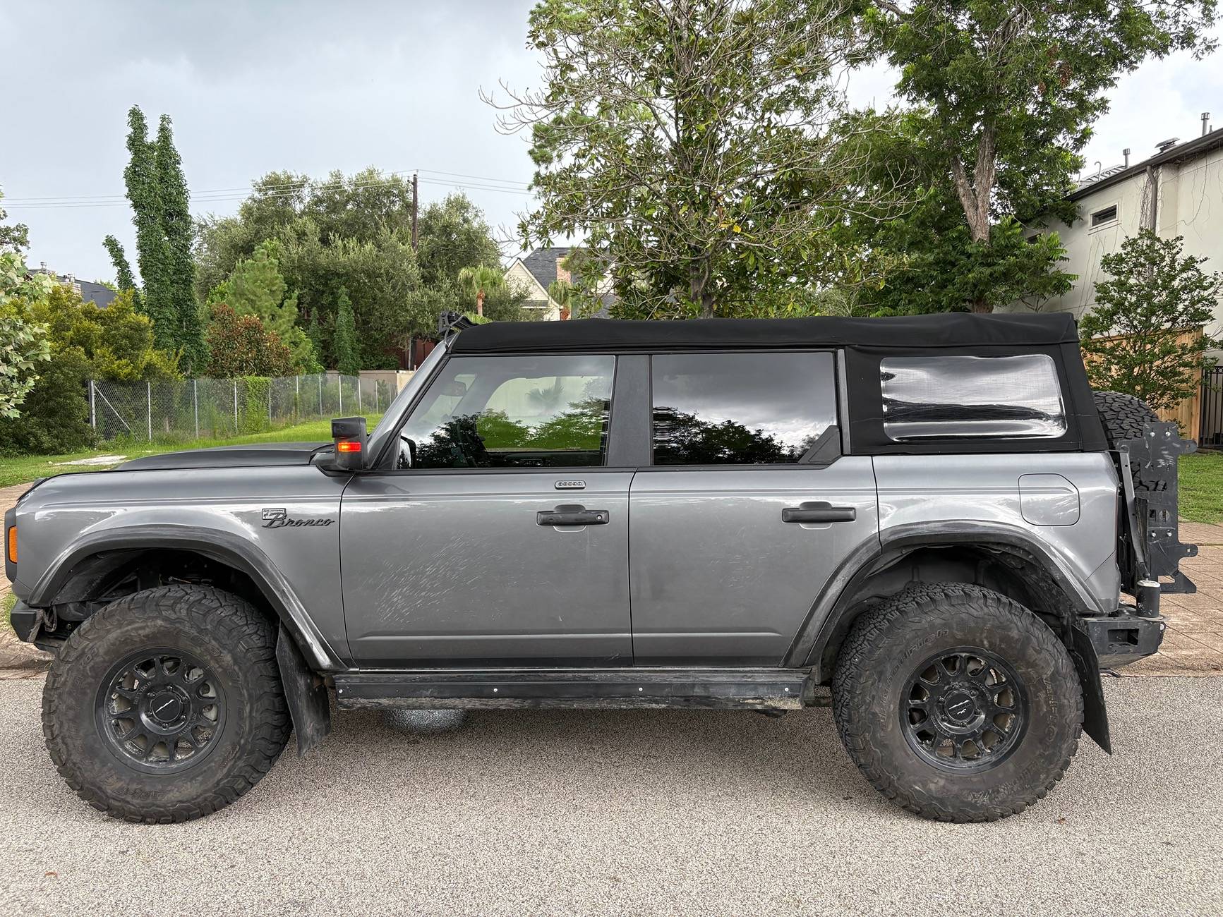

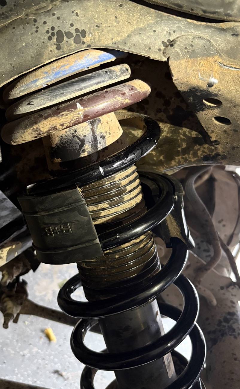

As a test run before putting the perch hardware on, I’m trying a spring spacer.
Ford Bronco Anyone installed Rough Country 1" leveling kit? IMG_1240
Durashock B+ size, about 1.75”. A cheapo way to test what top hats will do and get better everyday ride/look. Looks better to me and rides more planted on turns. Not made for a loaded-out road trip though. So when I get my next big project done at the 4x4 shop before my next adventure, I’ll have them put in the 2” top hats have waiting.
