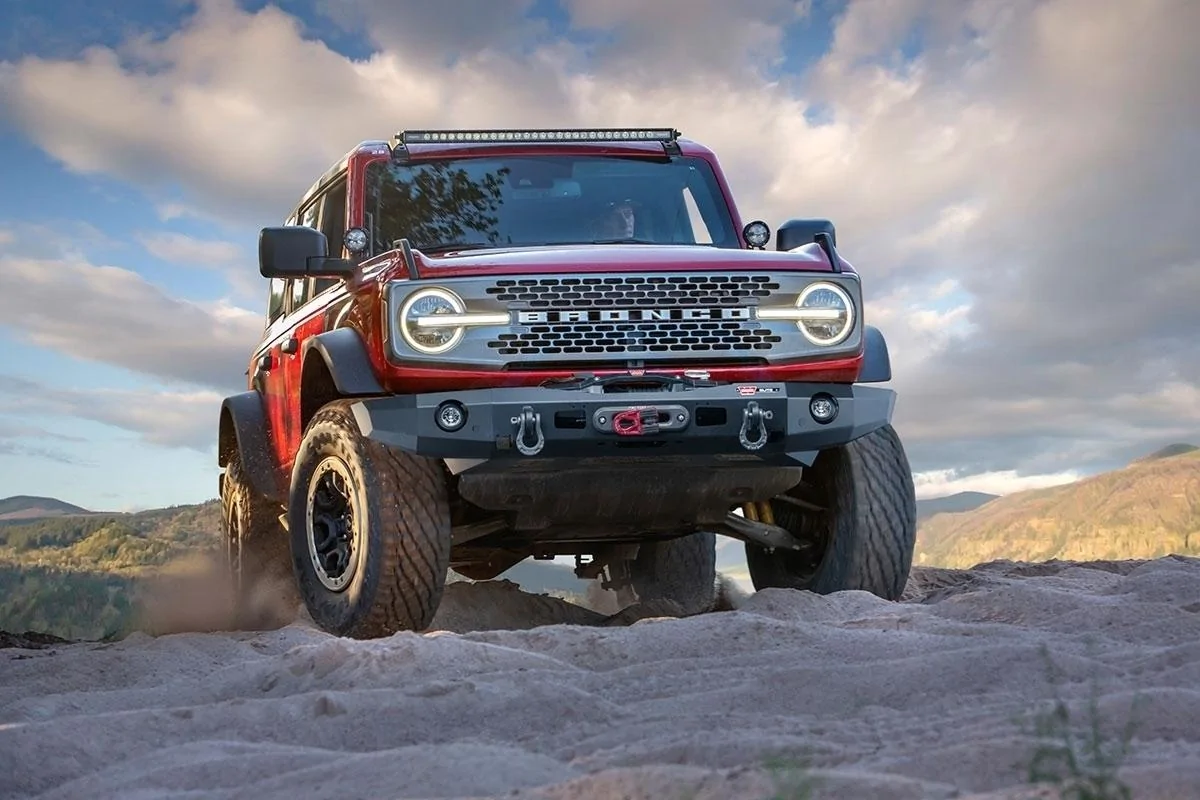

Ford Bronco Anyone install - Warn Elite Winch Bumper e-series-front-bumper-2021-2024-ford-bronco-107870
Has anyone installed the Warn Elite winch bumper, if so how do you like it?
I've been looking at the options out there and the Warn seems to place the winch low enough to avoid interference with the camera, but they do not show a camera view.
Also, one review said that Warn could not provide replacement brackets / installation hardware any idea who actually manufactures this and if they offer parts support?
I was hoping that somebody would manufacture something vehicle width, rather than the width of the vehicle plus fender flares- just seems too wide to me. Very few pictures seem to be available outside of the Warn sales photos.

Looks great. I can't decide between is and the ADD rockfighter. This one is definitely more low profile.

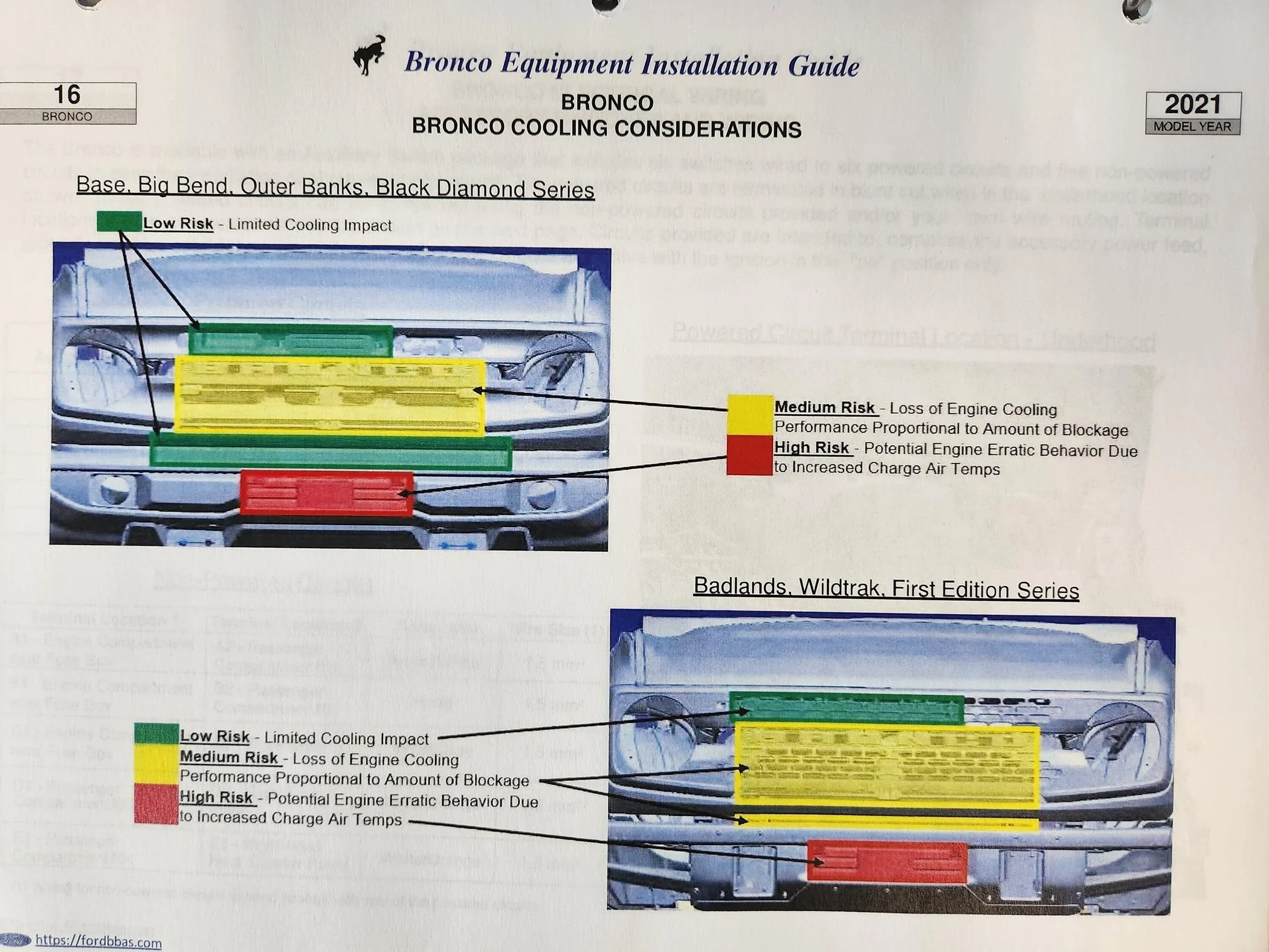

I like it, but ruled it out because of this:
Ford Bronco Anyone install - Warn Elite Winch Bumper bronco intercooler
