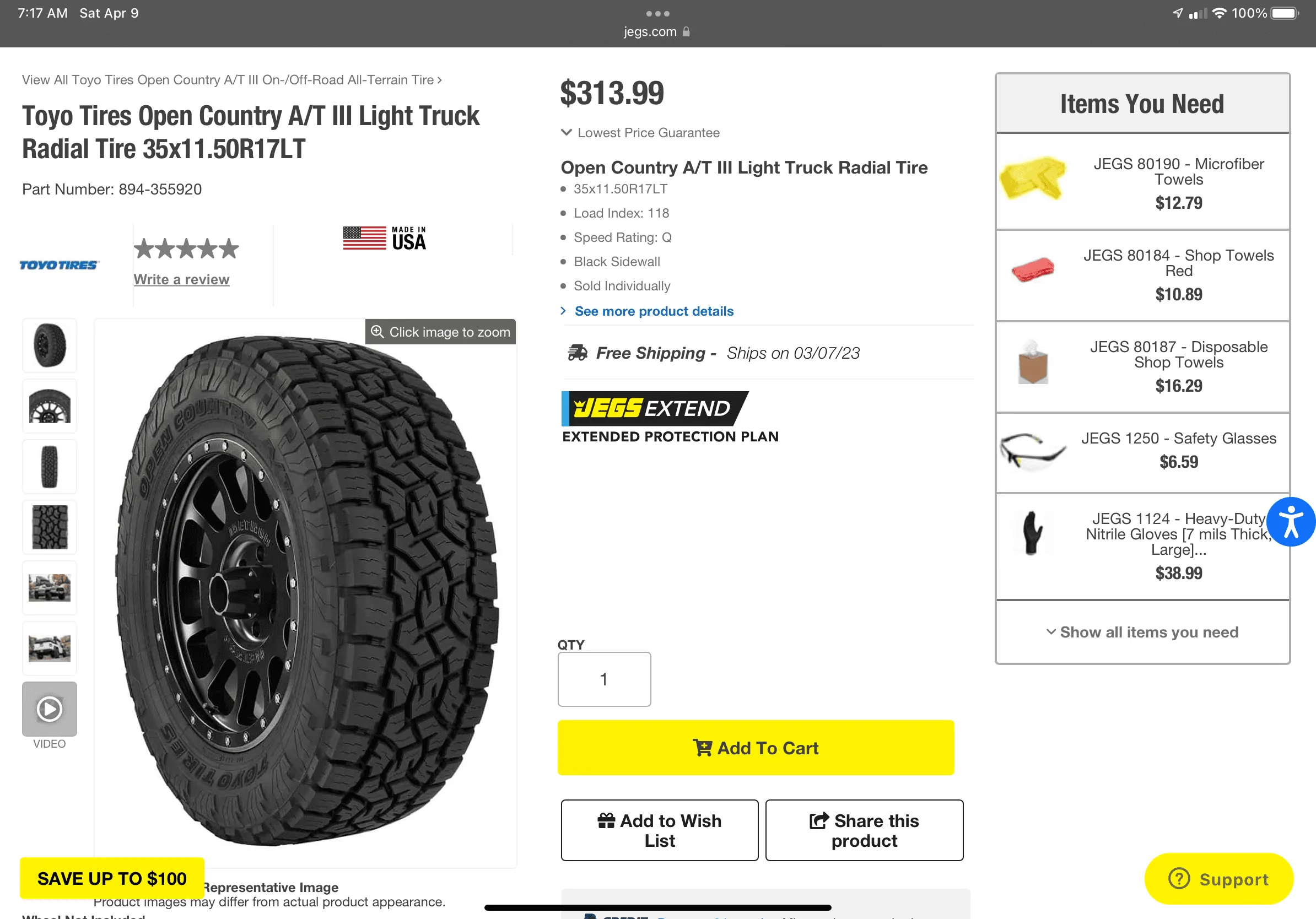

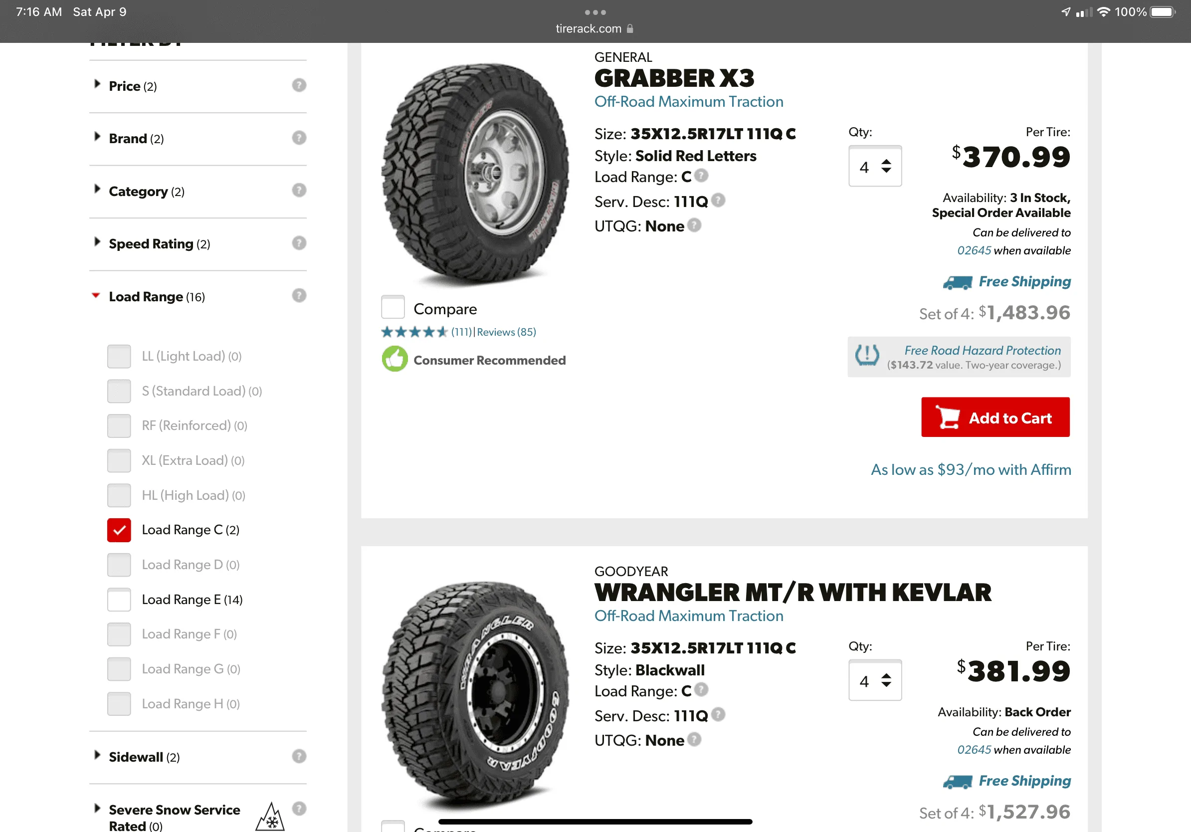

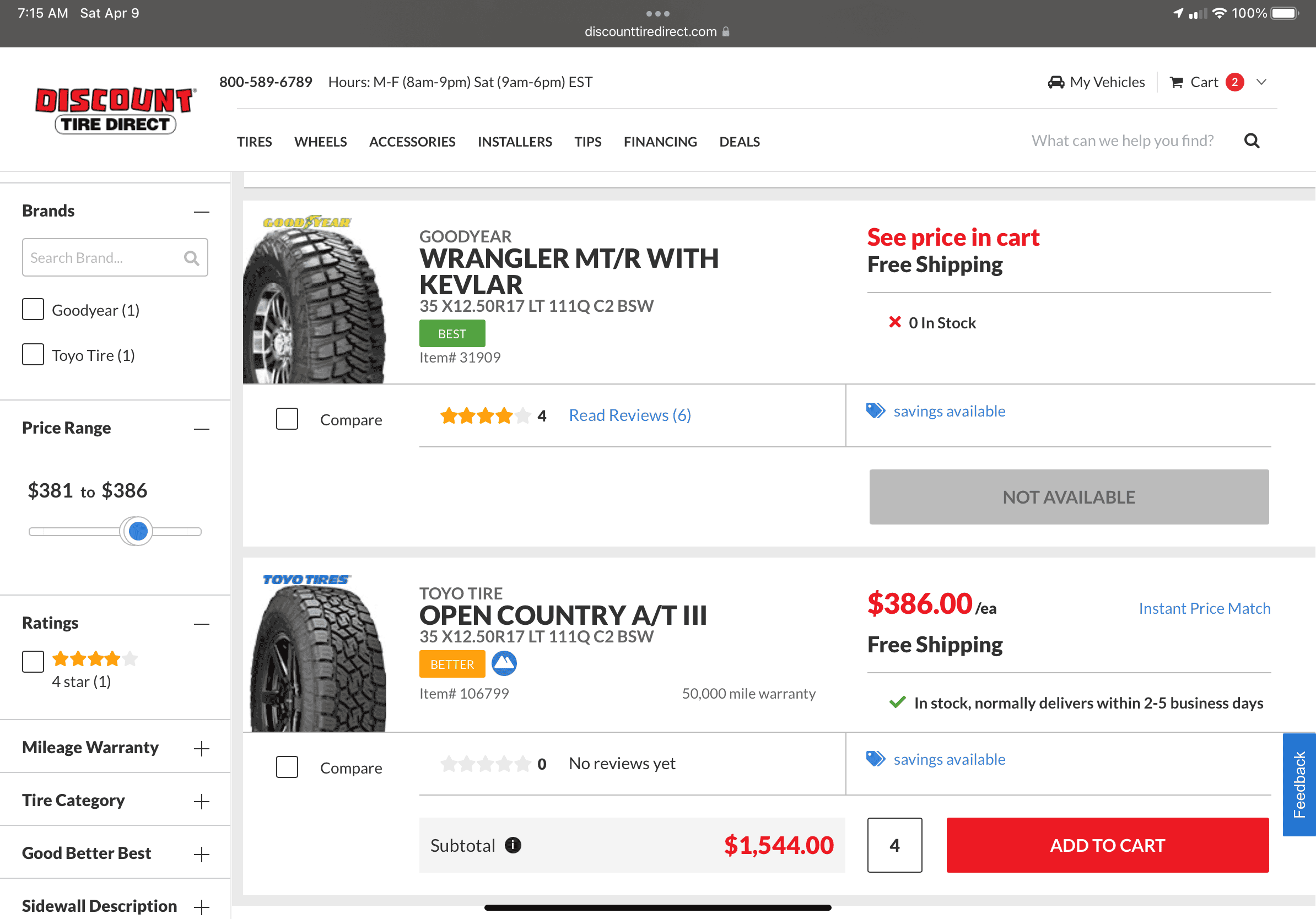

Many here will say that their E rated tires are great at the right pressure, and I’m glad they are happy with them. Personally I won’t run E rated on something under a 3/4 ton truck. My 87 Bronco weighed 5500# in full kit. Through the years I went from all C rated tires in 32x11.50R15 to 33x12.50R17 to 35x12.50R15 to 315/70R17 then to D rated 35x12.50R17. The D rated tires with the stiffer sidewalls and harder compound didn’t hook up in the rocks and rode poorly at 32 PSI on the street. I went back to a C rated 35x12.50R17 and all was well again. I had a similar experience with my 2005 Nissan Titan, swapping to an E rated 285/65R18 BFG KO2 spoiled the ride and handling. I ended up dropping to a D rated 285/70R17 and it mostly solved the problem. I also lost 3 mpg on the Titan with the 1” taller and heavier tires.
There are a few C rated 35x12.50R17 out there, and Toyo makes a 35x11.5R17 that would probably be great for a daily driver.
