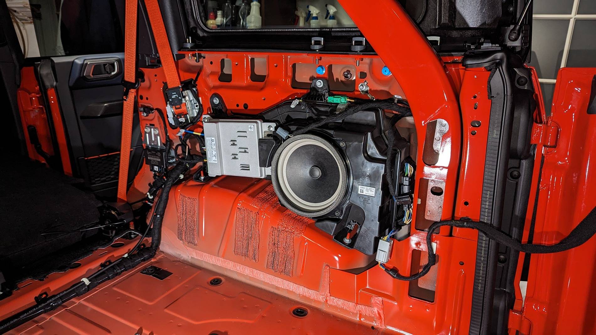

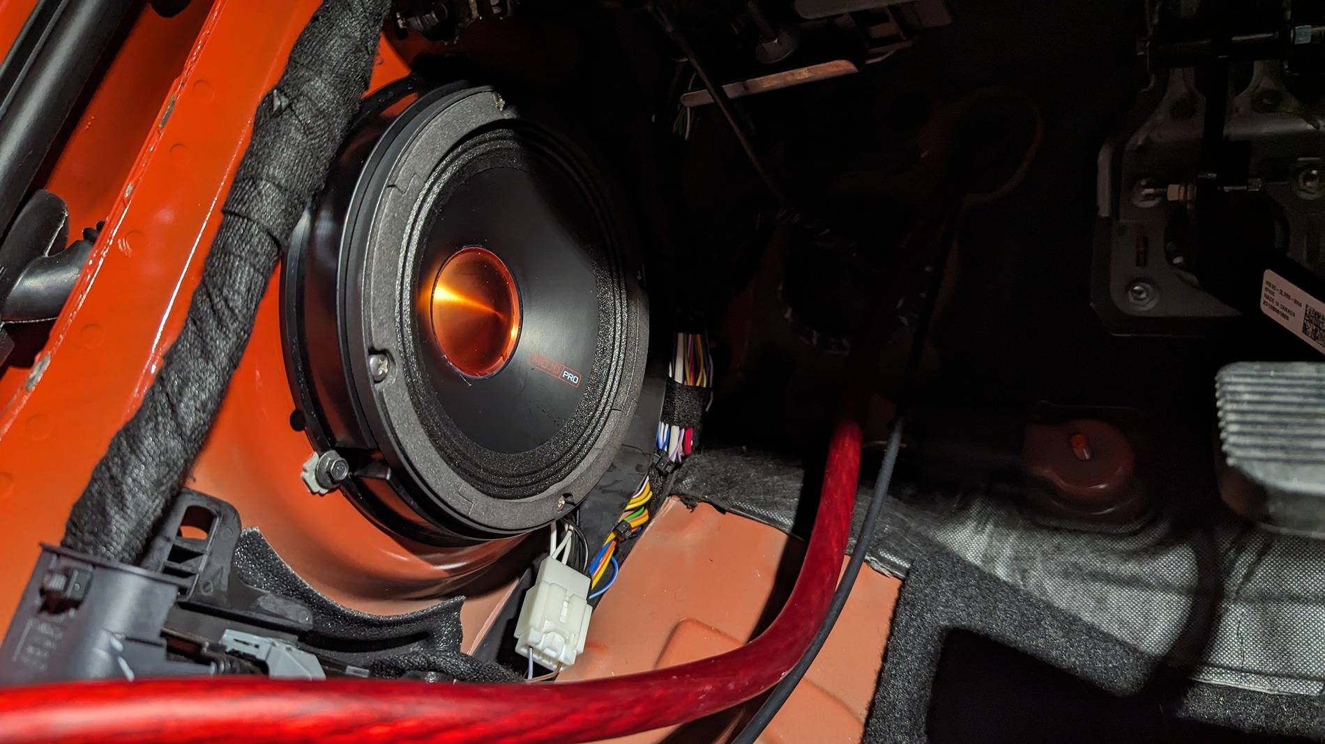

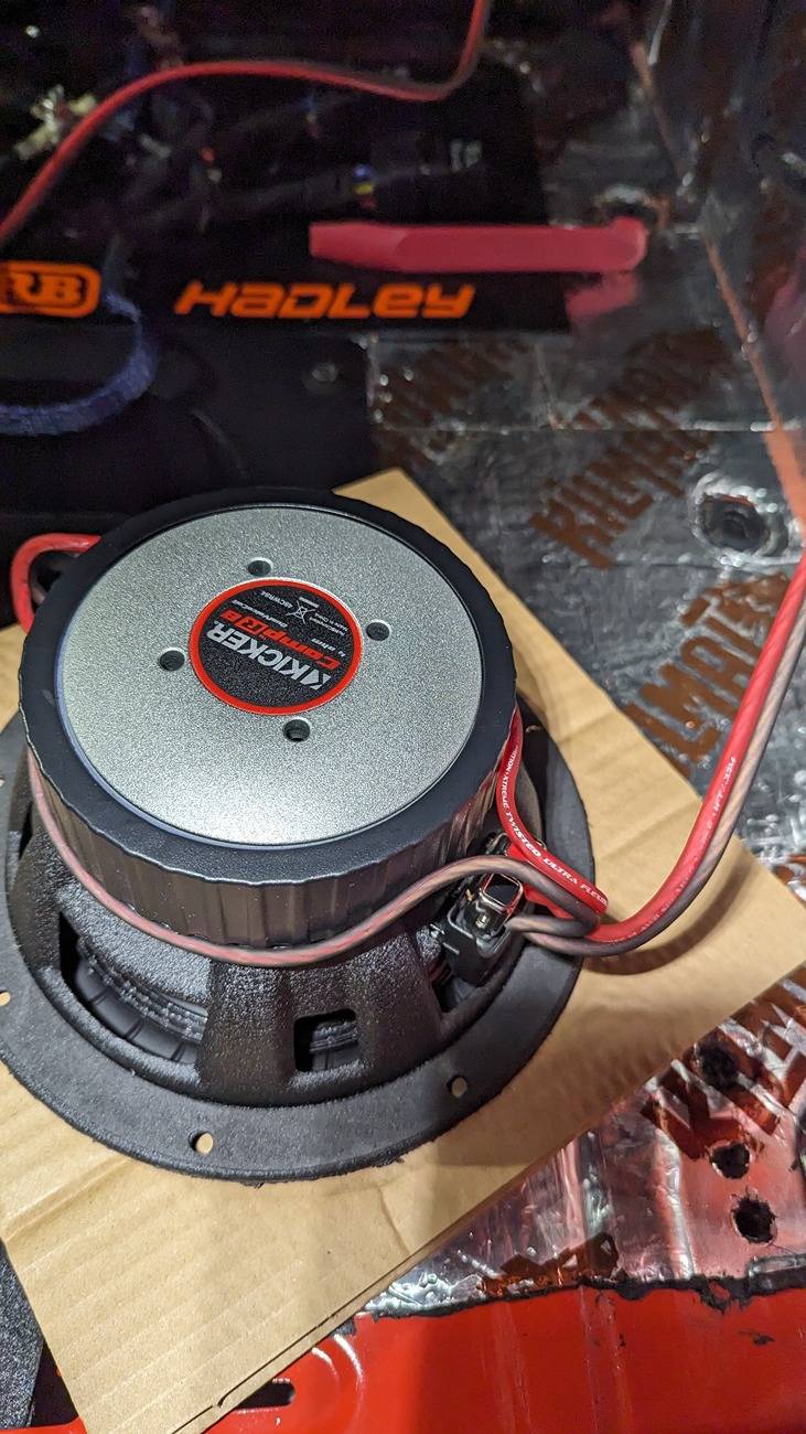

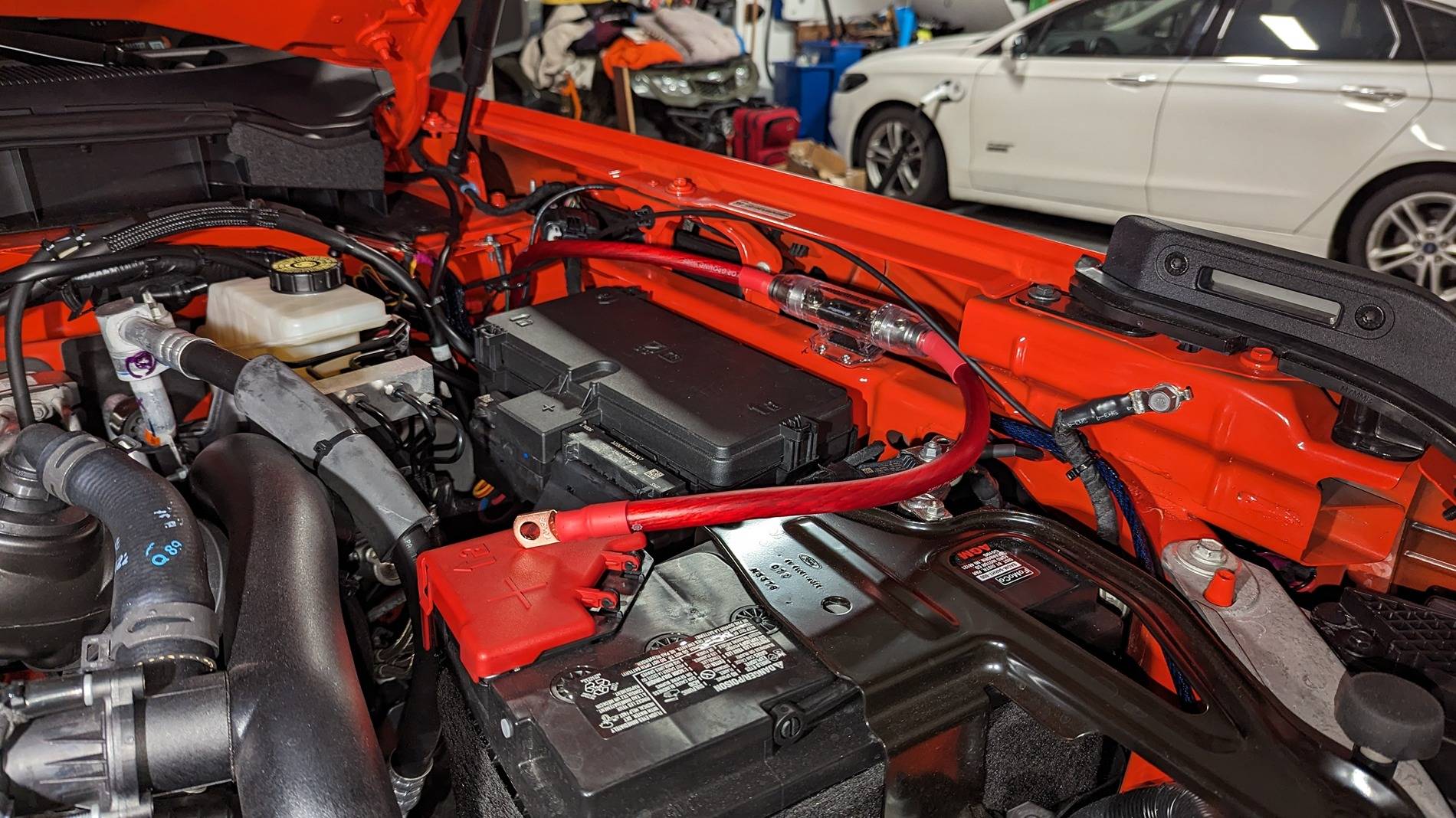

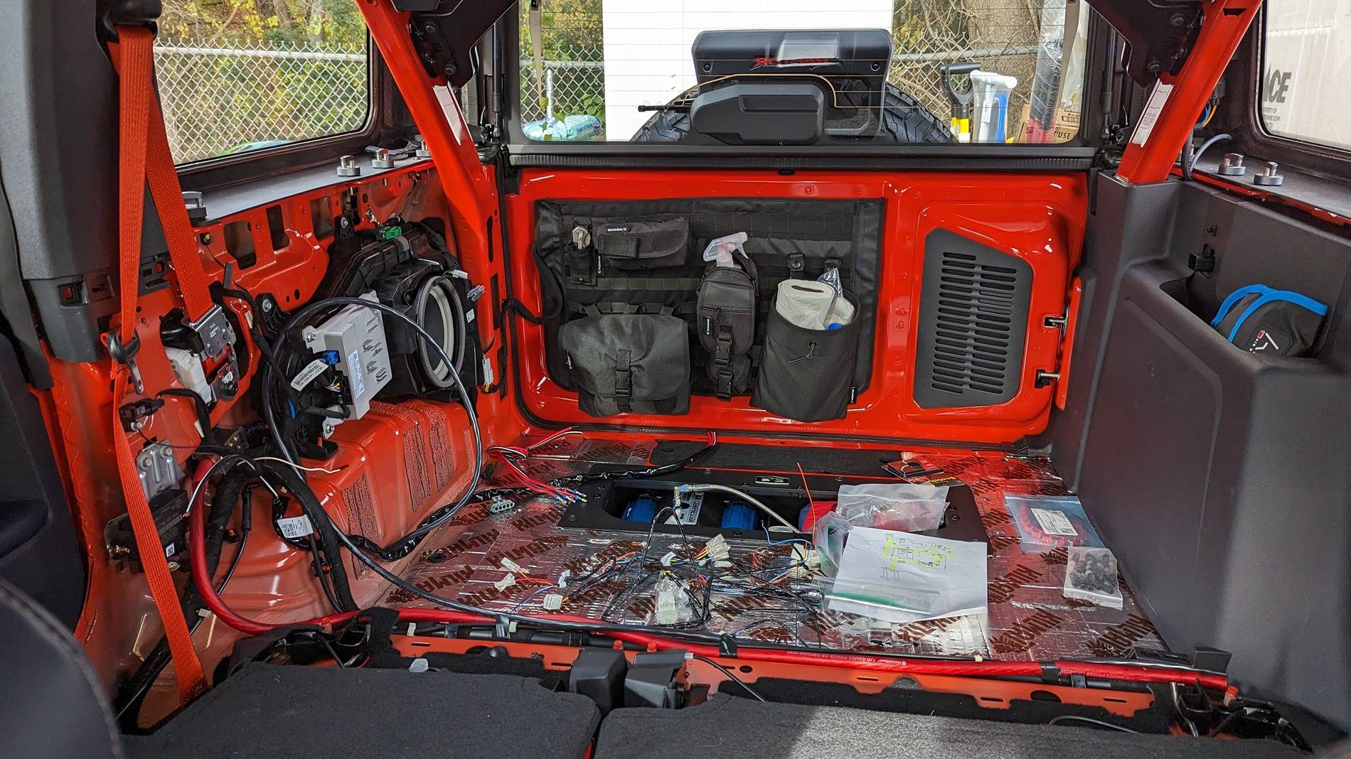

I did full speaker swap and swapped sub for a Kicker Comp R 8 mated to a Kicker key 500.1. Did the install myself all for less than $2k - including wiring, poly fill and kilmat. The kick panels were a little more difficult because of how Ford did the wire harness and the adapters you need to use but still not difficult. The rear panel that the sub sits behind is a pain because there are so many clips on back you can't see - you will break a few.
The 5 cabin speakers were so easy I literally forgot to take pics. I used Infinity Ref 407 in the 5 main speakers, Memphis MOJO Pro 6 in the kicks and the Comp R 8 4 ohm Dual Voice Coil wired in Parallel to take it to 2 ohm. Very happy with the sound now.
