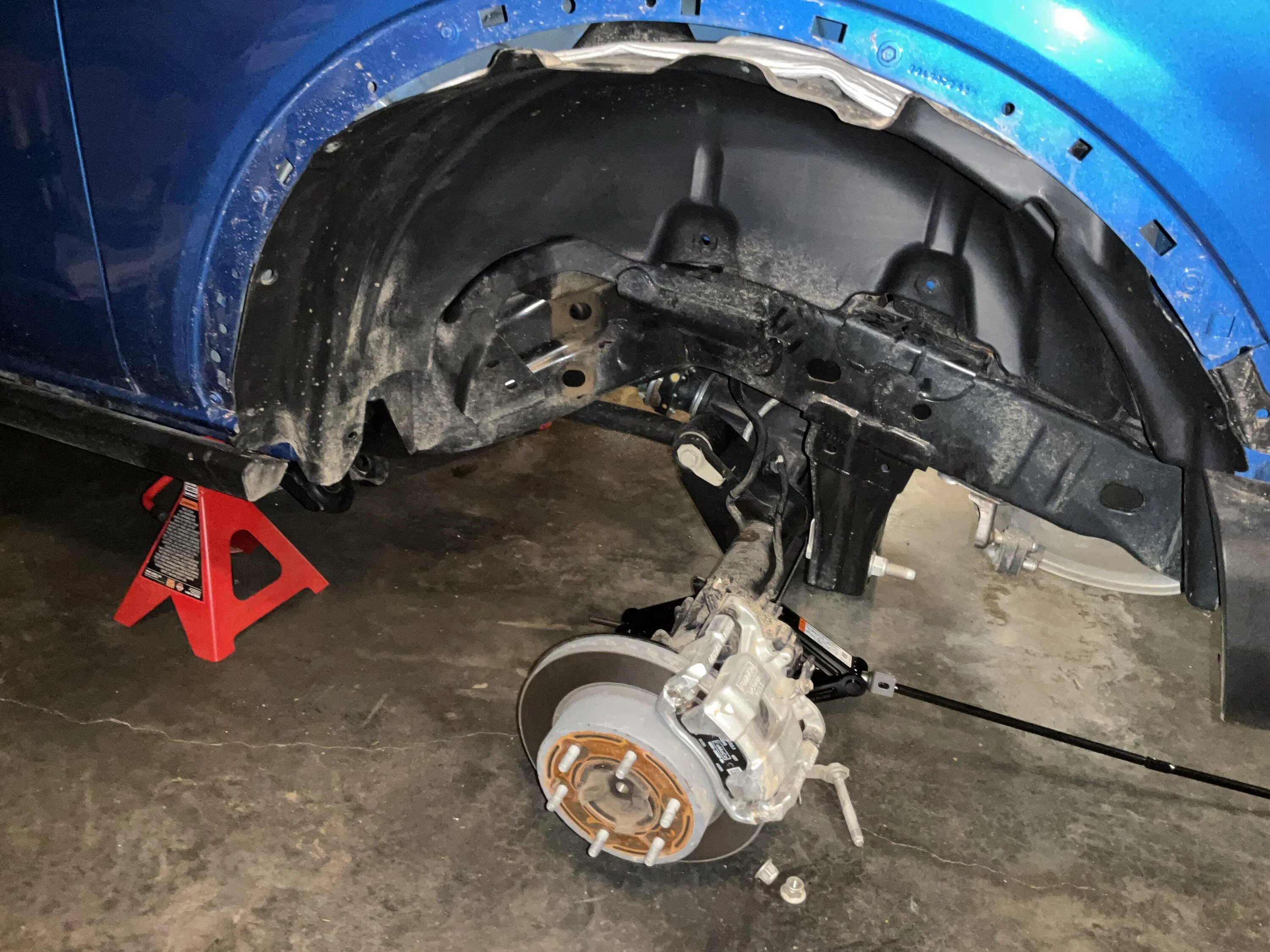

Yeah, do one at a time. It's really pretty easy. This is with the lower trailing arm removed as well, but it's quick and easy. Just get a 3 foot breaker bar for the lower shock mounts.

you can do
One wheel at a time
Perfect! Thanks for responding to the question asked. After reading the first response I was worried this would turn into a shit-post. 😂
Complete disassembly of the rear suspension seemed like overkill, so I'm glad I won't have to, nor will I have to buy anything else.
