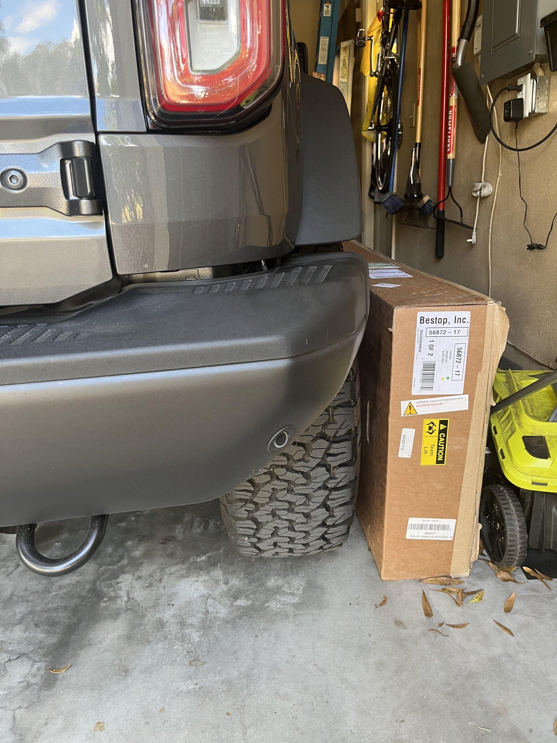

Ok I broke down and bought the full bestop roof.
Ford Bronco Any 2dr Bestop owners? Looking for feedback 01CB67A3-3C59-4A24-B1F0-E518A60BE22C
two VERY HEAVY boxes arrived yesterday for my two door. Now, to remove the roof rack, find a place to store my MIC, and get cracking. I ordered twill. Should be good for FL gulf coast.

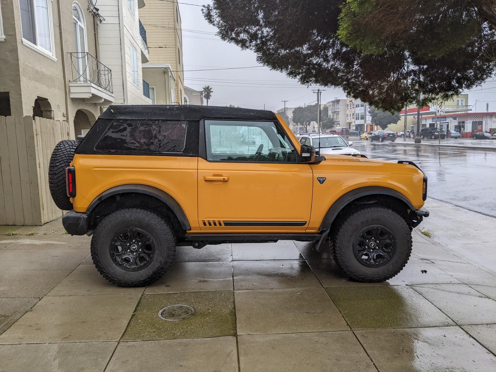

You are gonna LOVE it!! Mine has been fantastic so far! Heavy rain, crazy blizzard, 85mph on the freeway, its great in all of them. the trickiest par of the install was the rear corner brackets, you have to pry open the panel in the cargo area, my panel never did re-seat itself, but not a big deal.

Nice bronco BTW

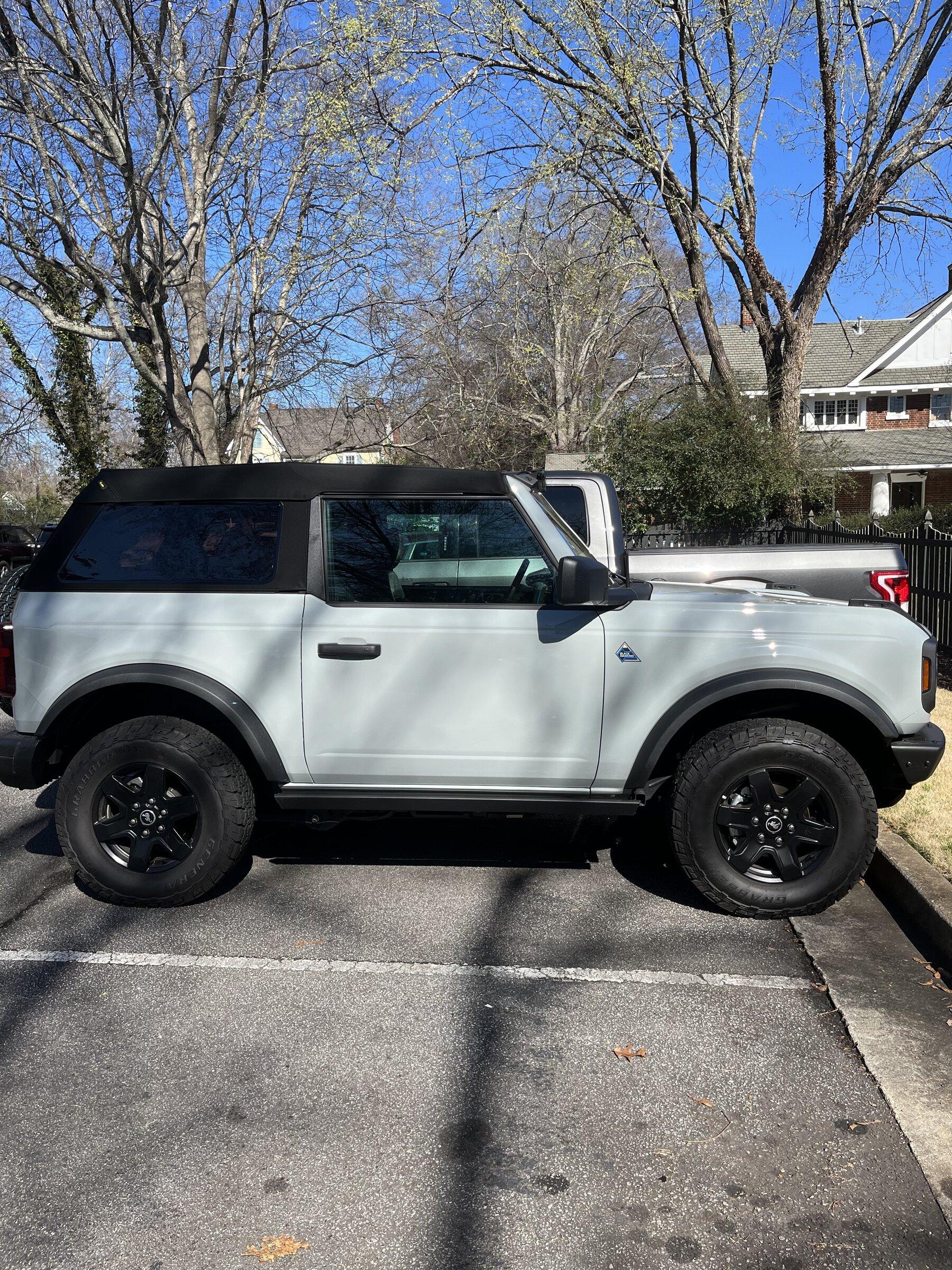

Just installed my Trektop Saturday. A bit more time consuming than I expected, lots of hardware (not good for easily switching back to MIC top in the winter) but install video was very helpful. Most bolts are torx, and I have torx sockets, but one set of bolts are hex (5mm?) instead of torx. Get a good hex socket for those. My little allen wrench didn't cut it. The paint on the bolts and hardware makes some bolts tough to get started/spin. A little WD-40 helped.
Very happy with fit and look. Tight, no droopy windows. But that tightness comes with a price. My daughter (the Bronco is her's) will have to build muscles to re-attach side and rear panels if she ever wants to take them off. Hopefully the fabric on the panels will stretch out a bit over time. I also didn't understand that the rear window isn't easy to lift up. Makes access to the rear a pain. Others have commented on that.
But my BIG problem is flapping, noisy roof and rear panels on the highway. Anything over 50mph. LOUD!! That said, I don't get the impression flapping panels is a common problem or more people would be complaining (I cant believe people wouldn't be...mine is terrible!) Note in the picture that my Bronco has a light bar on the top of the windshield. I'm 95% certain that is my problem. I complained previously on this forum about that light bar's whistle noise when the MIC top was on the Bronco. But I fixed that issue by blocking the wind going under the bar. We were very happy. But now I think the light bar disturbs the airflow going over the bar (and hence over the soft top itself) so much that it causes flapping / shuddering of the roof and rear window. UGH. Now I have to come up with a solution for that or take the darn light bar off. Another weekend project. Its always something!! o_O

An update so no one is concerned about flapping and Besttop....I took off the light bar and now the top is super quiet. No flapping. The lightbar might have been ok if the brackets that came with mine raised up the bar several inches. Ford performance's light bar comes with special brackets for soft top installation that do just that. But mine didn't and I grew tired of screwing with it so I just took it off. $280 for the light bar down the drain, but the top is great!
