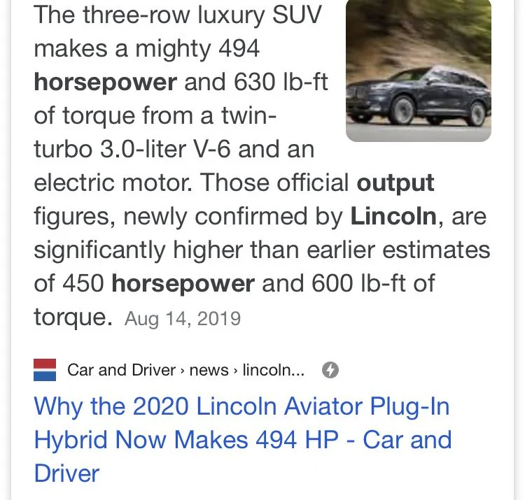

because the Lincoln Aviator, a similarly sized vehicle, has one. It’s a V6 hybrid I believe and has like 400hp/450ftlb or something crazy like that.

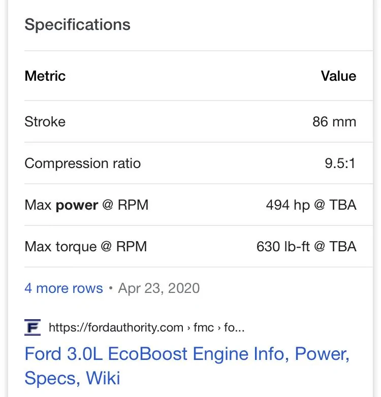

Damn.... I guessed way under... is this the right one y’all?
Ford Bronco Another V6 option? 328B656D-2860-44FC-8EC0-A26DB4A535DA
edit2:
it’s the right one.

A Bronco Hybrid was confirmed in 2019. So the Aviator's 3.0 Hybrid powertrain is one option Ford could pull from. There's also an NA 3.3L Hybrid from the Explorer that's rated at 318hp/322tq.

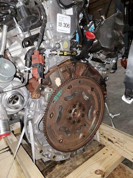

The 3.0 EcoBoost is a bored and stroked version of the 2.7. Anything that a 2.7 fits in, the 3.0 will also fit into. The 3.0 is used in the MKZ, the Continental, the new Explorer, and the new Aviator. It's usually rated around 400hp/400tq.
There's a lot of confusion online about this 3.0 engine. There's a Car and Driver review that claims the Lincoln's 3.0 is all-aluminum. Wikipedia cites this article. It is wrong.
Here's a 2.7 from a Fusion Sport. Note that the cylinder heads are aluminum as is the block skirt, but the inner structure is CGI (rusty iron).
Ford Bronco Another V6 option? fusion27-1-800x450

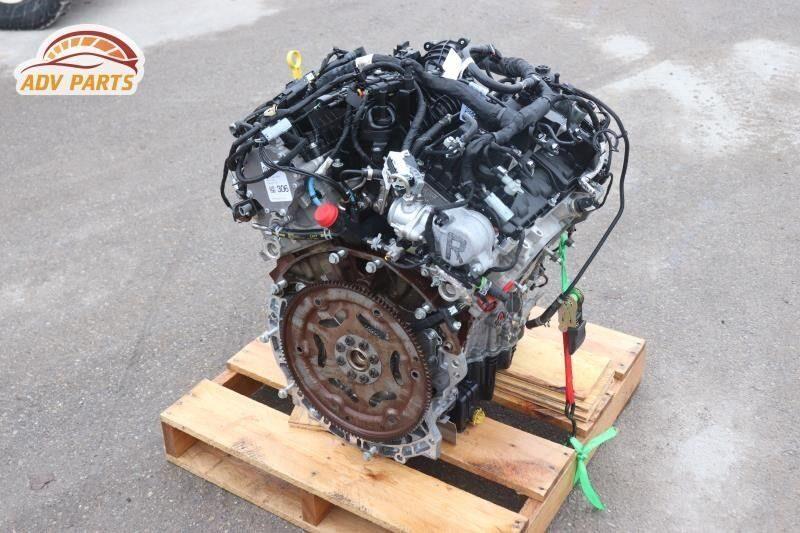

Here's a 3.0 from an MKZ, one that the article claims should be all-aluminum. Same rusty inner structure:
Ford Bronco Another V6 option? fusion30-1-450x600

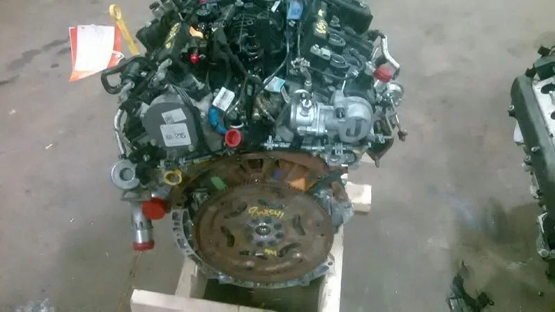

And another 3.0 from a Continental, still rusty:
Ford Bronco Another V6 option? continental30-1-800x533
This Ford Authority article also incorrectly claims the 3.0 is all-aluminum.
Ford's spec page for the 2020 Explorer ST claims the 3.0 block is "cast aluminum." The same page for the Edge ST calls the 2.7 "Compacted graphite iron."
No one has wrecked a 2020 yet and had the engine show up on car-part, so I don't have any good pictures.
So the internet thinks there are two versions of the 3.0 - the one used since 2017 in various Lincolns is CGI and aluminum, same as the 2.7. The one that debuted in the 2020 Explorer/Aviator appears to be all aluminum.
Edit: FirstOnRaceDay posted dealer info calling the Explorer engine CGI, so until I see a picture of an all-aluminum 3.0, it's just an internet myth.

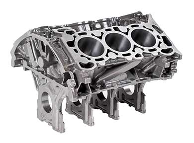

It´s a misunderstanding from an unknown source that´s claiming there´s two different 3-liter EcoBoost with the same bore, one in aluminium and in the superior and much stronger CGI. This is completly wrong and I have tried to change the Wikipedias misleading information which they say have an origin from caranddriver.com from Oct 2016. Wrong information also at the Fordauthority.com.
The aluminium block can´t stand these pressures from a bored 2,7 l V6 .
Ford Bronco Another V6 option? ford-2
Ford 2.7 and 3.0 Litre V6 Petrol - Ford and Lincoln
from https://www.sintercast.com/market/sintercast-passenger-vehicles/
North7
Feb 21, 2020
113
7,316
25,750
North Texas
SUV
Please explain further, 11,000hp top fuel drag race engine blocks are milled billet aluminum with steel cylinder sleeves. Why can't a 2.7 aluminum block handle the pressures?

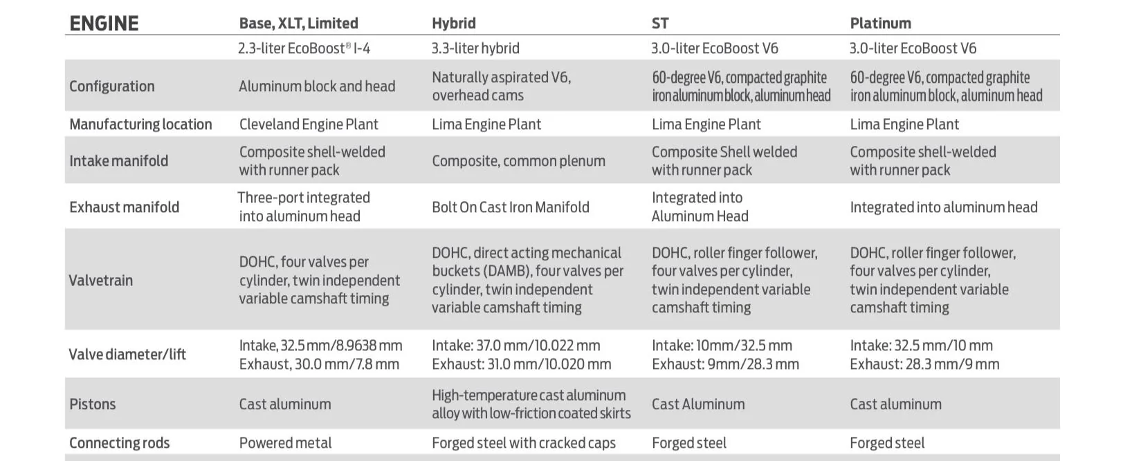

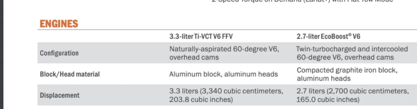

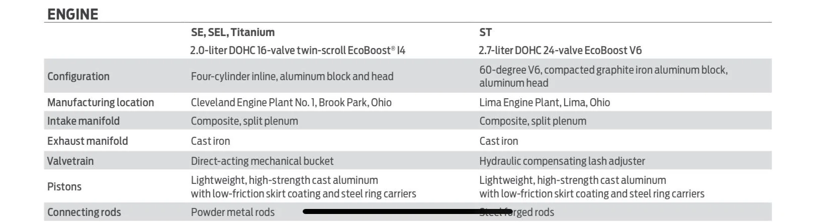

THEY ARE ALL CGI!
the Block ^^^^ Seen above is Compressed Graphite Iron
heads And bottom end are aluminum. Pistons Aluminum. steel Rods. But are identical in build excluding bore and stroke obviously
straight from Ford.com
2020 Explorer
Ford Bronco Another V6 option? E90A589F-9754-4BD2-8C7A-9F043B113D00
2021 F150
Ford Bronco Another V6 option? 03322A23-DD2E-4722-BD5F-6A9ECD1206AC
2020 Ford Edge
Ford Bronco Another V6 option? 12D56D73-8026-41F2-88D1-EA0B588F29B8
I couldn’t find info on the Hybrid Aviator because Lincoln didn’t provide Block info only heads and pistons (same as 2.7)

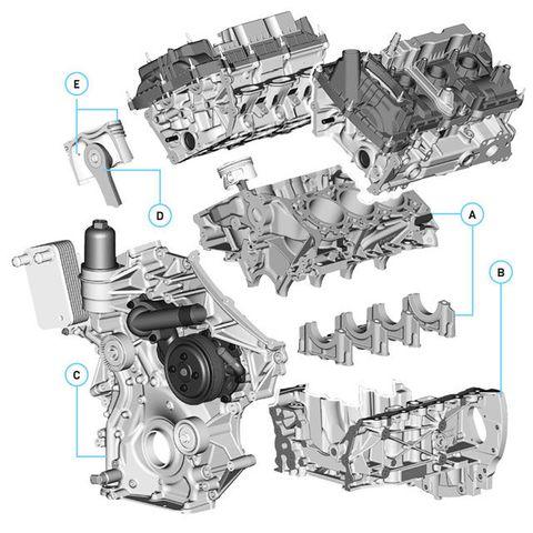

fords official Specifications on the motor are “COMPACTED GRAPHITE IRON ALUMINUM BLOCK”
meaning the inner “core” of the block (piston sleeves, and crank shaft housing) is iron.
Ford Bronco Another V6 option? EA6D0DC4-5EB7-475A-A753-F605E6CD5CEA
Figure A (Block) - Iron
Figure B (bottom end/ oil pan) - Aluminum
Figure C (timing cover) - Aluminum
Figure D (connecting rod) - Steel
Figure E (Piston) - Aluminum
Figure F (Heads) - Aluminum
ANY Questions?
ANY Questions?
Yes, it still is not clear for Figure A, is it new technology CGI or old technology Cast Iron?
