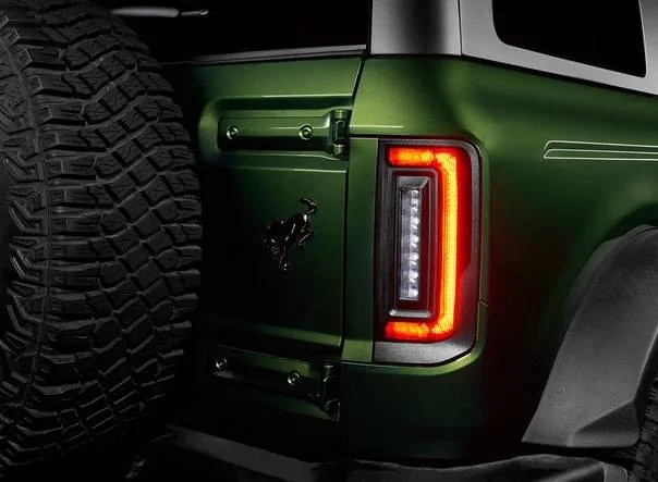

Not sure that I would want to mix and match tail-lights. unless with the exact same brand. It just would never match and could wreak havoc with the on-board computer system. Take a look at the ORACLE Lighting Flush Mount Taillights. These provide a super clean look and incredibly bright reverse lights. You may need to program after install.

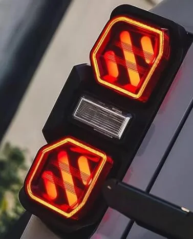

I recently grabbed these https://www.amazon.com/dp/B0DJ4KRT5P and they look well built and decent, but I have not installed them as that I was in the process of selling my current Bronco in anticipation of the next one. When it arrives, I will throw them on and see how they are.

I purchased the same tail lights back around Christmas, installed them a week after. As of now they are working pretty good, but I will tell you this, check your connections before closing everything up. The wire that connects the 2 tail lights to the 3rd brake light was my problem. On the passenger side it was loose, so when I hit the brakes, the yellow (turn signal) would light up and not the brake light. Took a few minutes of troubleshooting before I found that out. Other then that, like I said, they've been pretty good and not as basic looking as the stock halogen tails.
