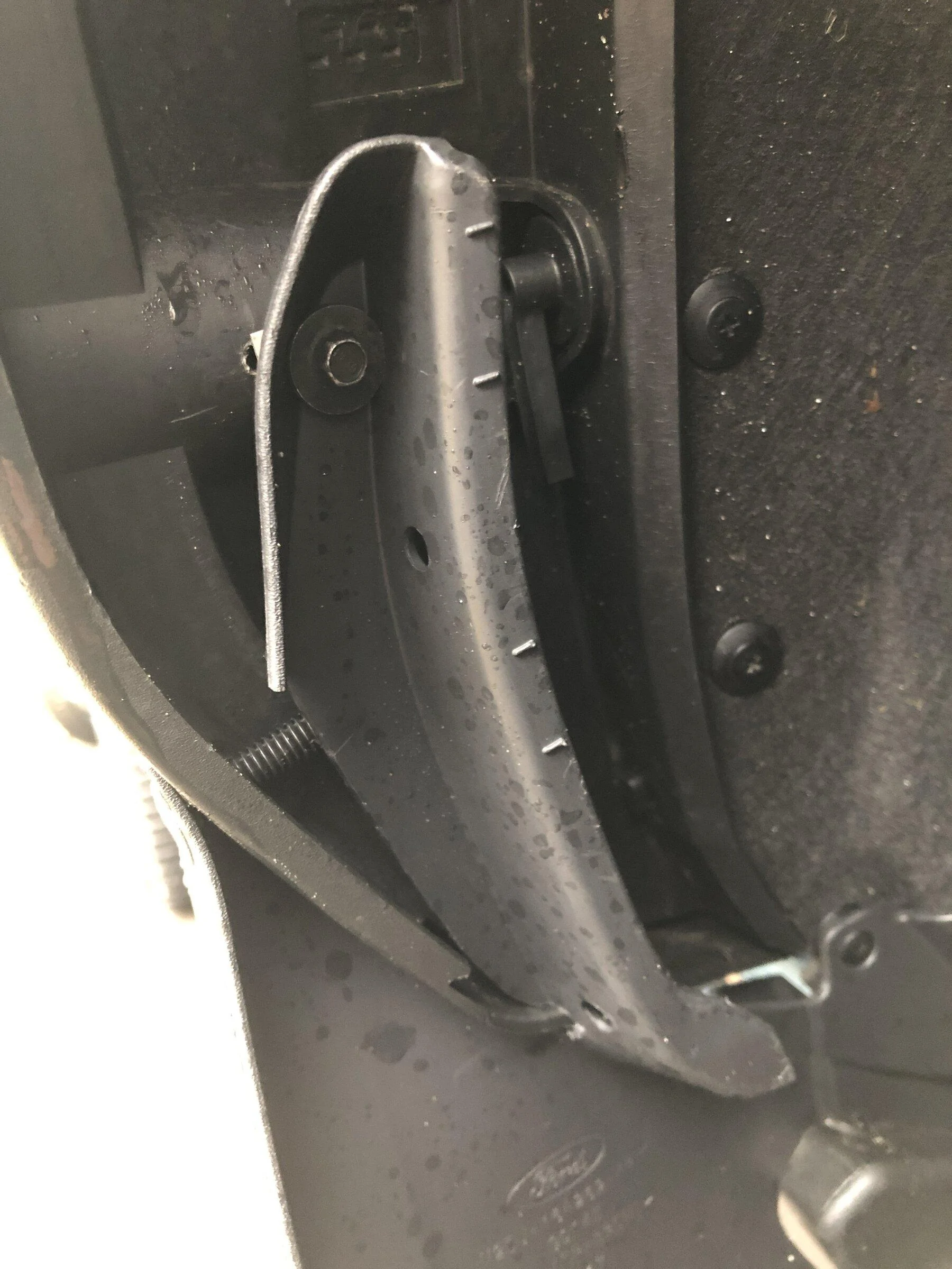

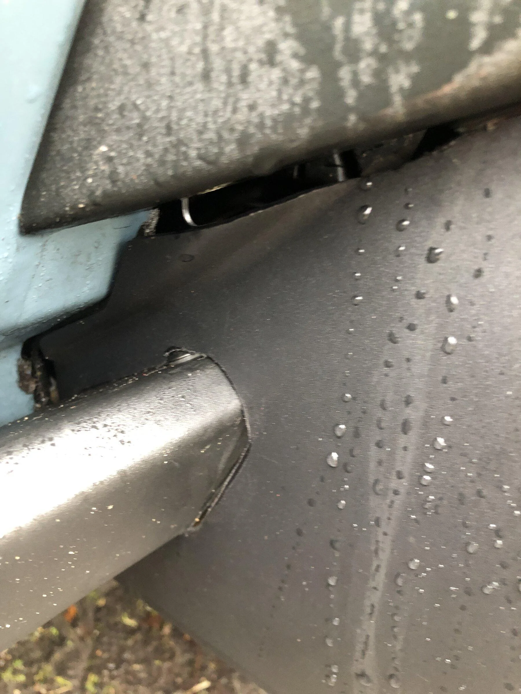

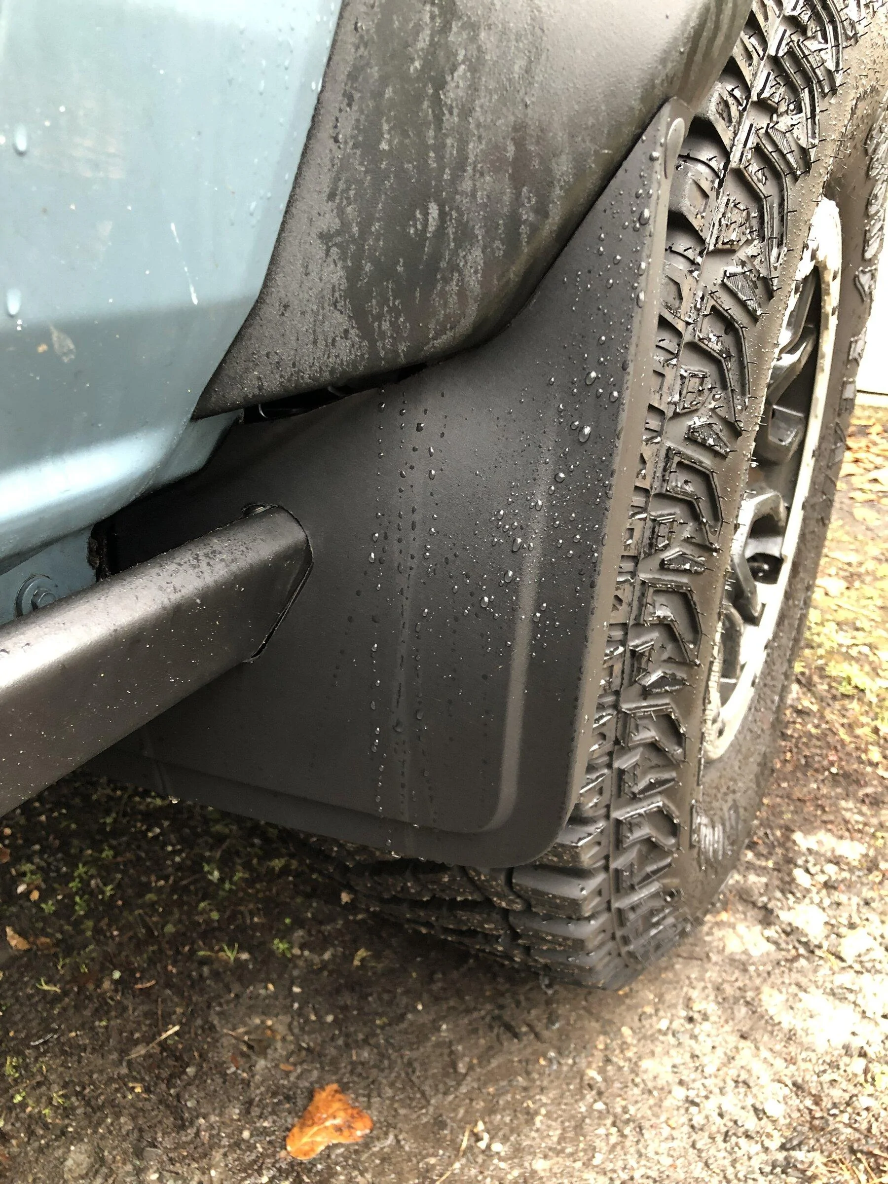

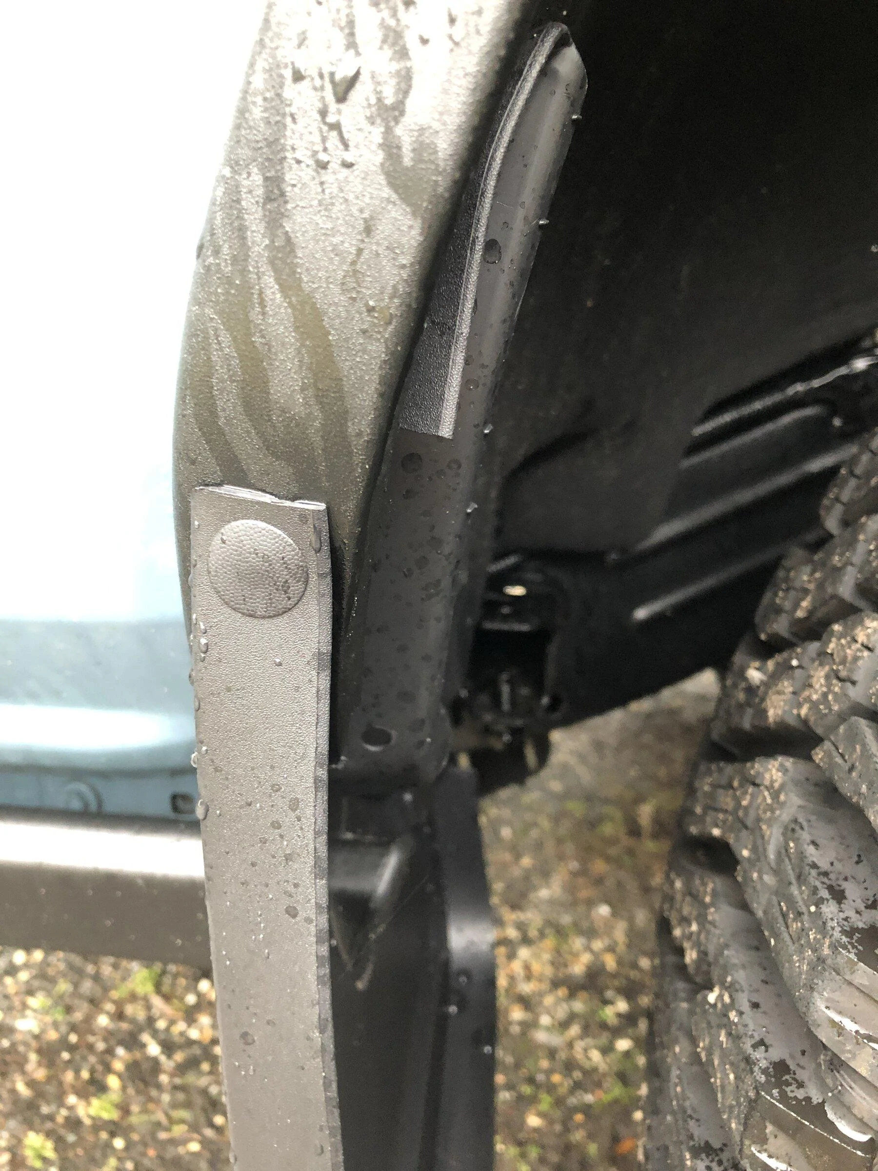

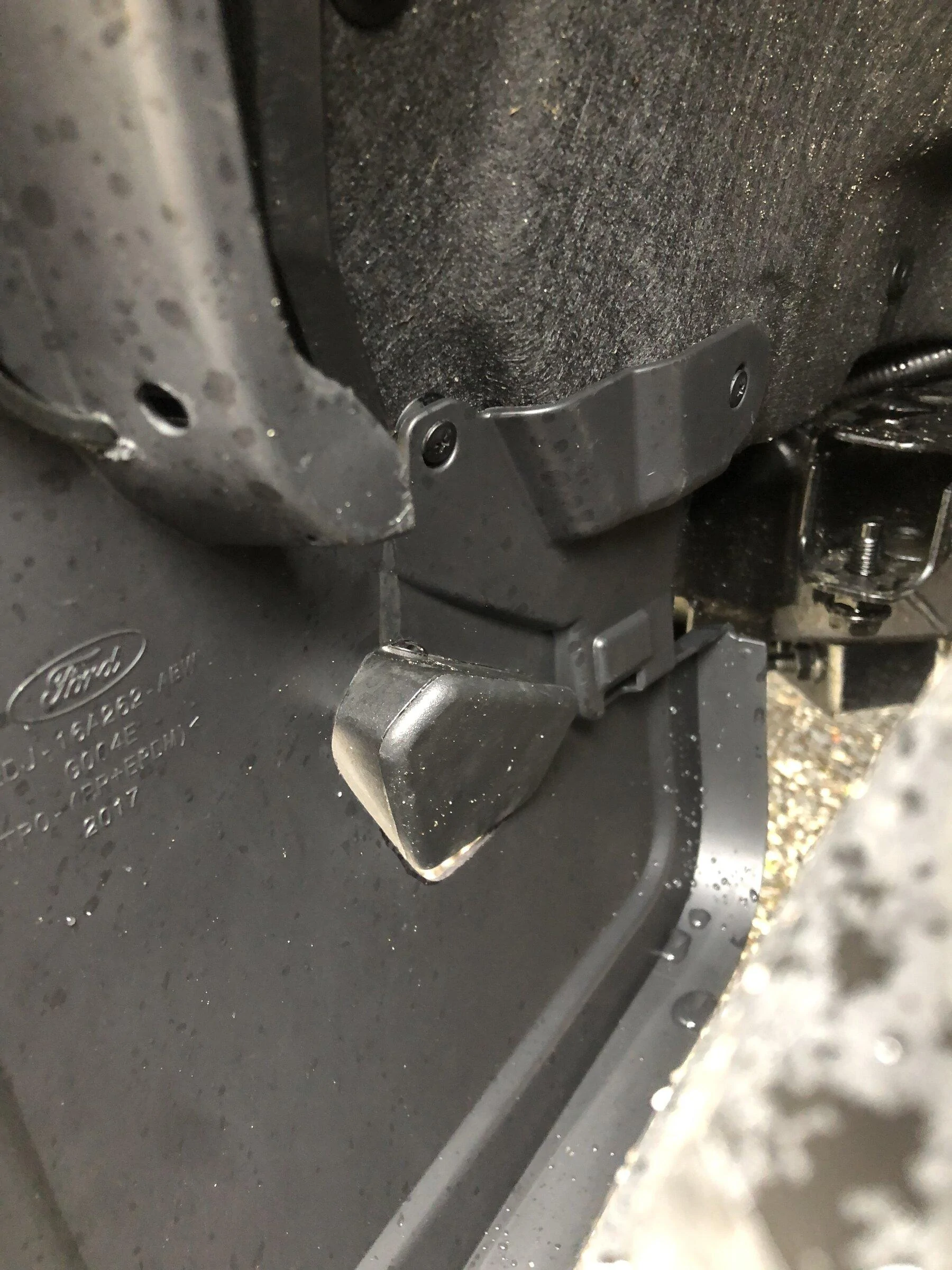

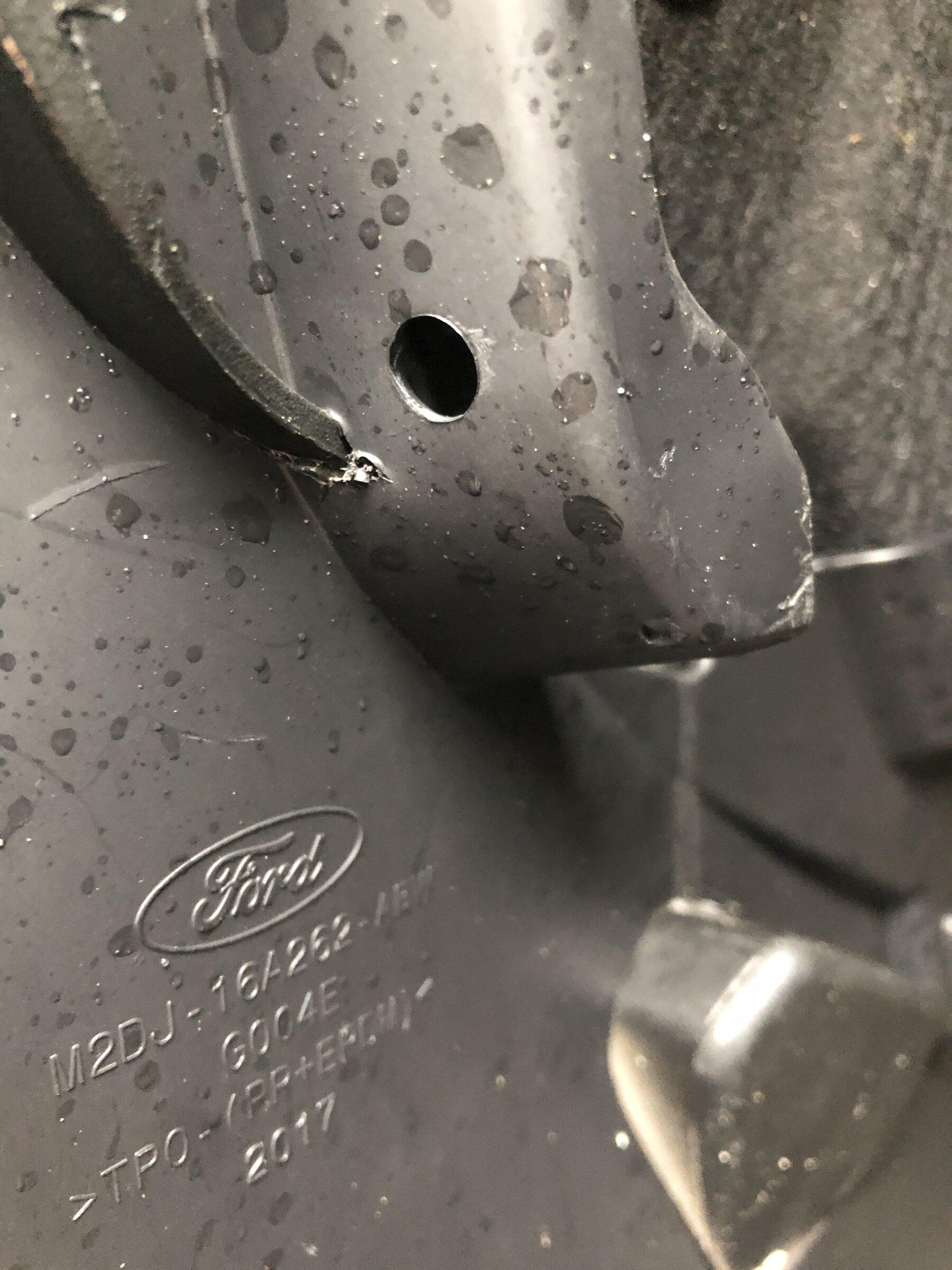

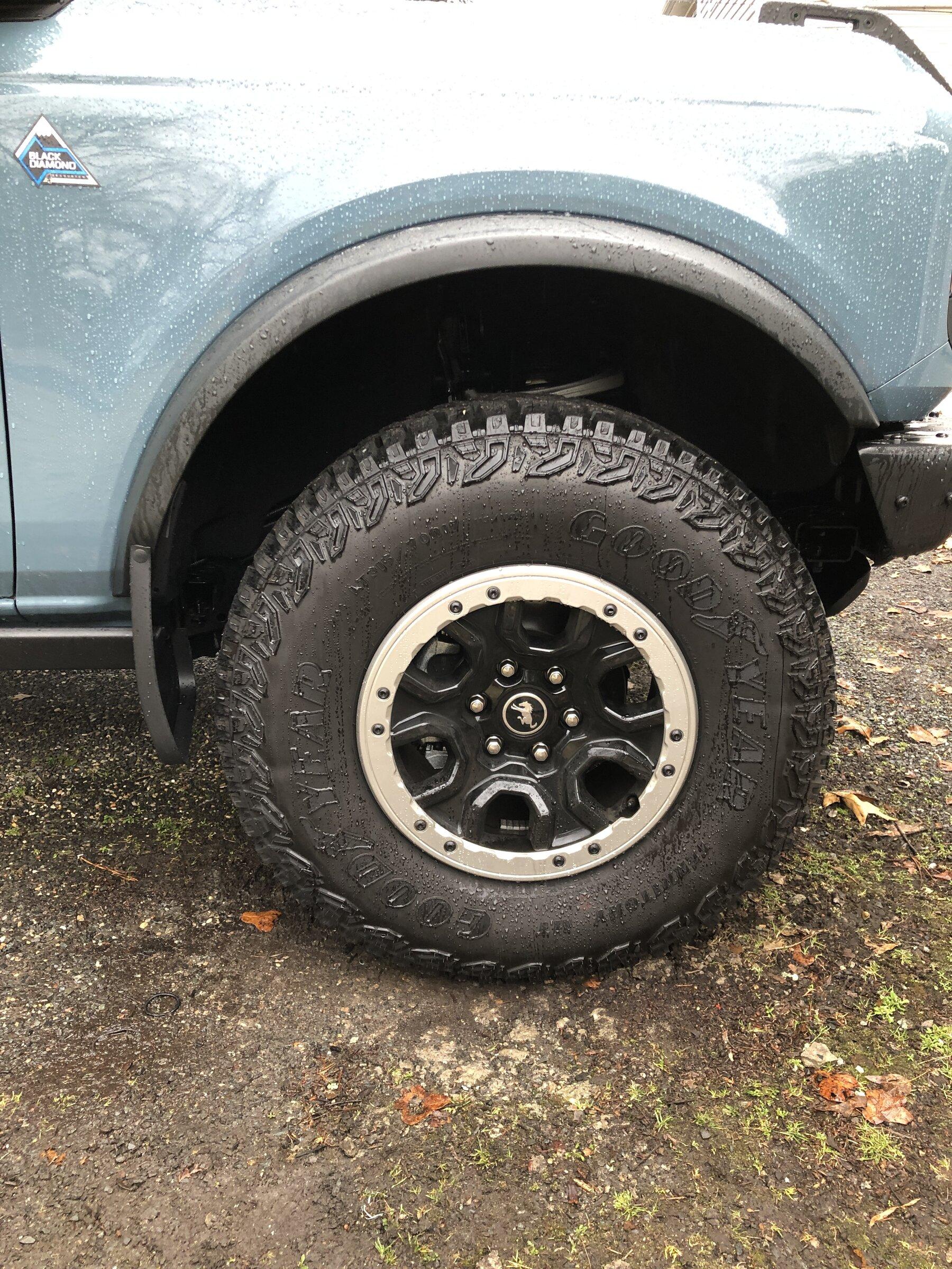

I bought and modified the $50 ford mudflaps to fit https://accessories.ford.com/products/bronco-2021-gatorback-molded-front-splash-guard-pair-1

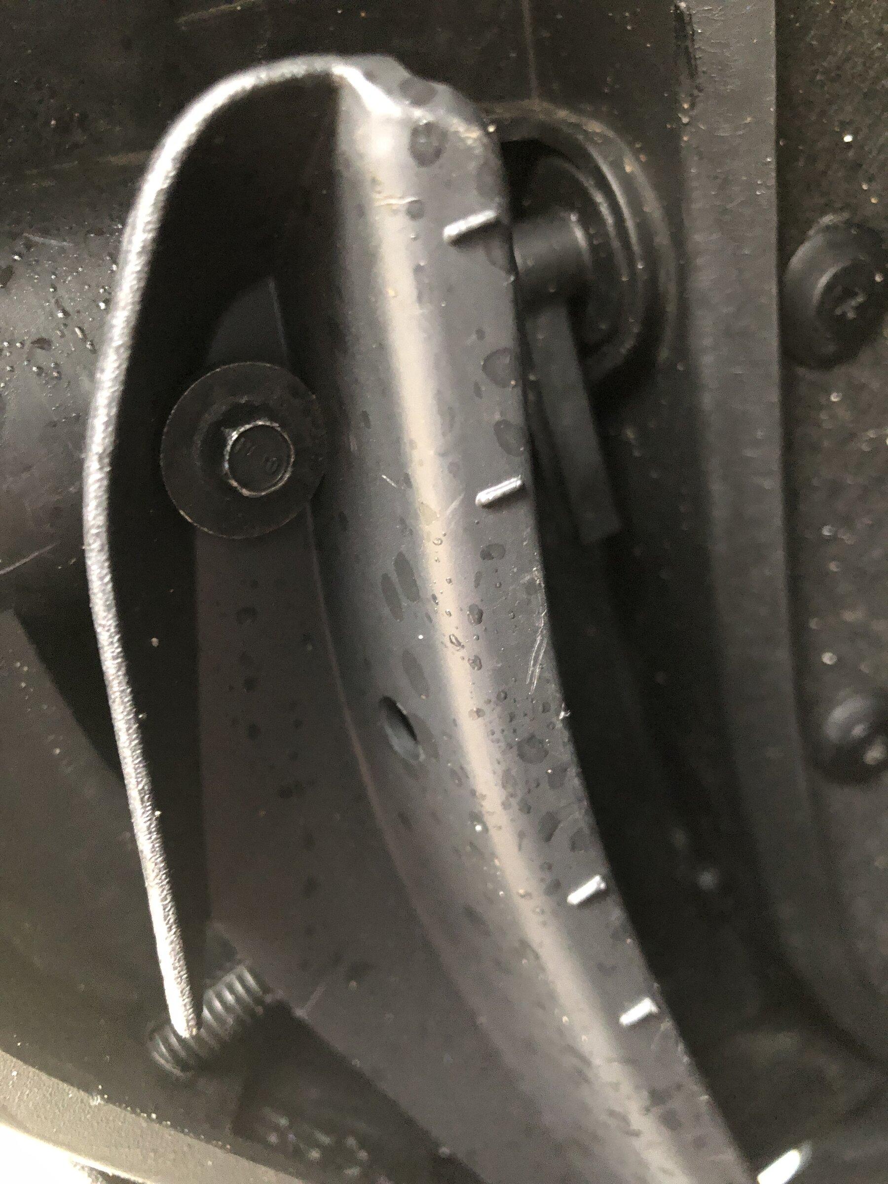

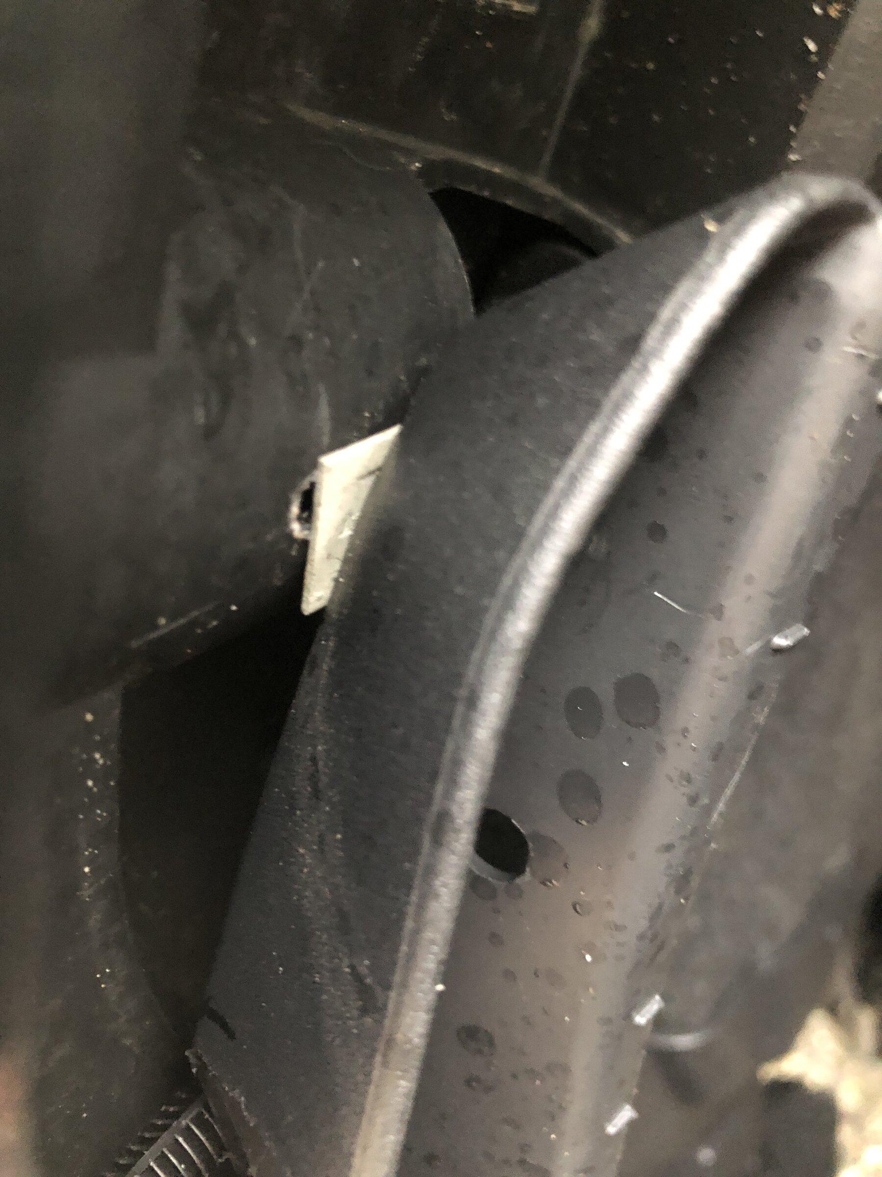

I saw other posts showing mods with angle brackets and bolts. I only used a sharpie, a box cutter and the parts from the mud flaps (one tiny bolt with washer and a quick nut drilled into the barrel on the MIC fenders). Used a Christmas tree plug from the hardware pack to tack the top of the mudflap to the flare. When trying to line up and trace the rock rail, go 3/16" higher than you think. I cut a slit to accept the flare and bent the piece of mud flap to use for attachment. First one I wound up with a bigger gap than I wanted. Second side came out perfect with the adjustment.
