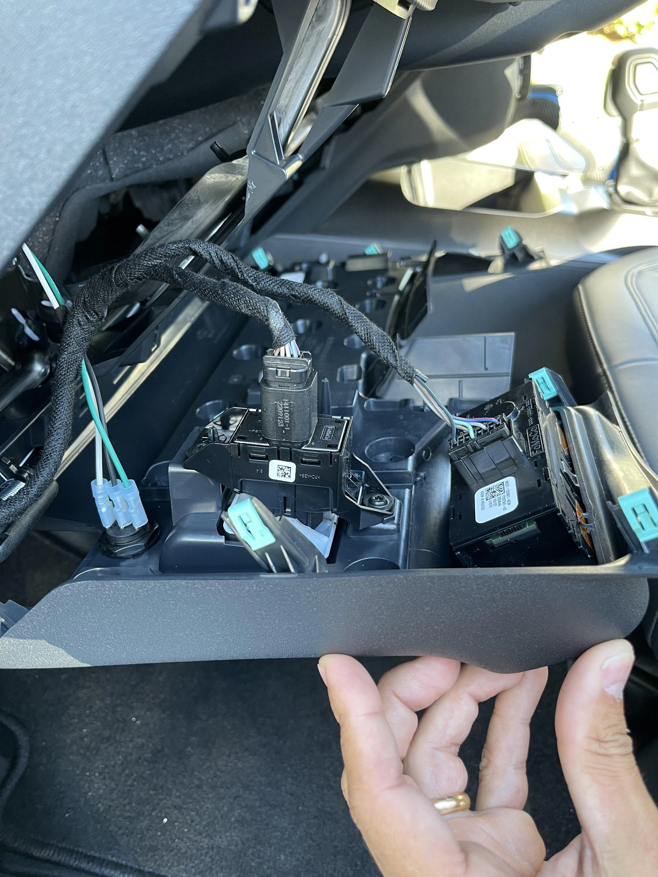

6. Tapping the 2-wires under the dash is nightmare level difficult. I'm not a small guy, but you have to be a contortionist to reach the harness. The included Posi-Taps are tiny, and I'd highly recommend ordering a few extras before the install because you are going to 100% end up dropping one of the tap pieces behind the kickpanel where it will be lost forever. Best to just have backups so you don't do what I did which is attempt to use a crimp tap, accidentally cut the wire, cause 2 blind/cross traffic fault codes and your steps won't work before you figure out what you did and end up splicing the tiny stump of wire left coming out of the factory harness = +2hrs of cussing. Happy ending, but man I don't ever want to have to do that part again.

Agree it was a nightmare to tap into the wires. It was a little easier to unplug the harness and then tap into the wires. Still, not an easy task. However, I would still go with tapping into the harness vs the magnets from other suppliers.
