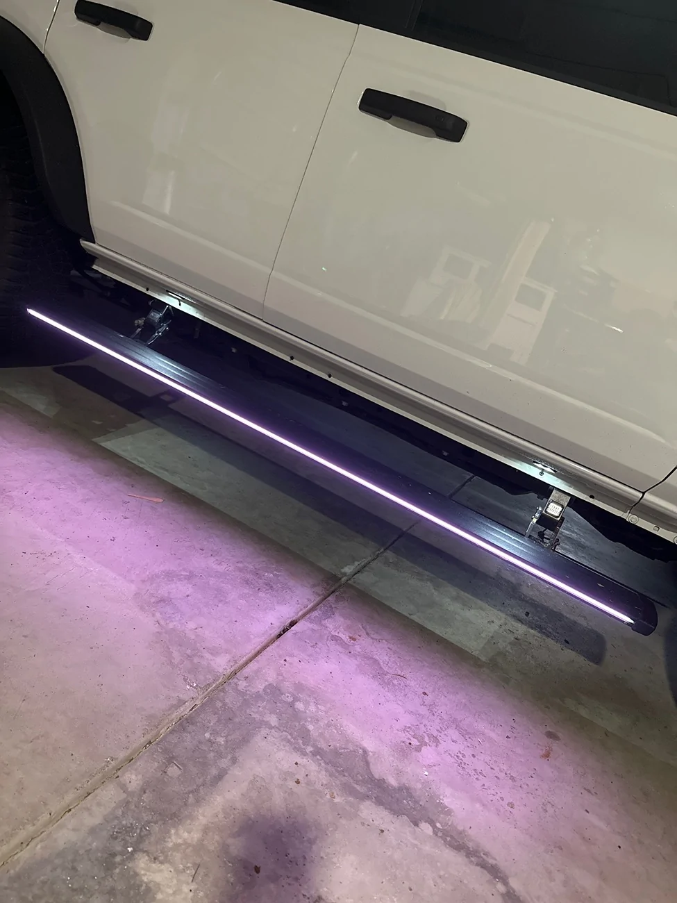

Does anyone have pictures of these power boards with the light strip installed on your Bronco?
