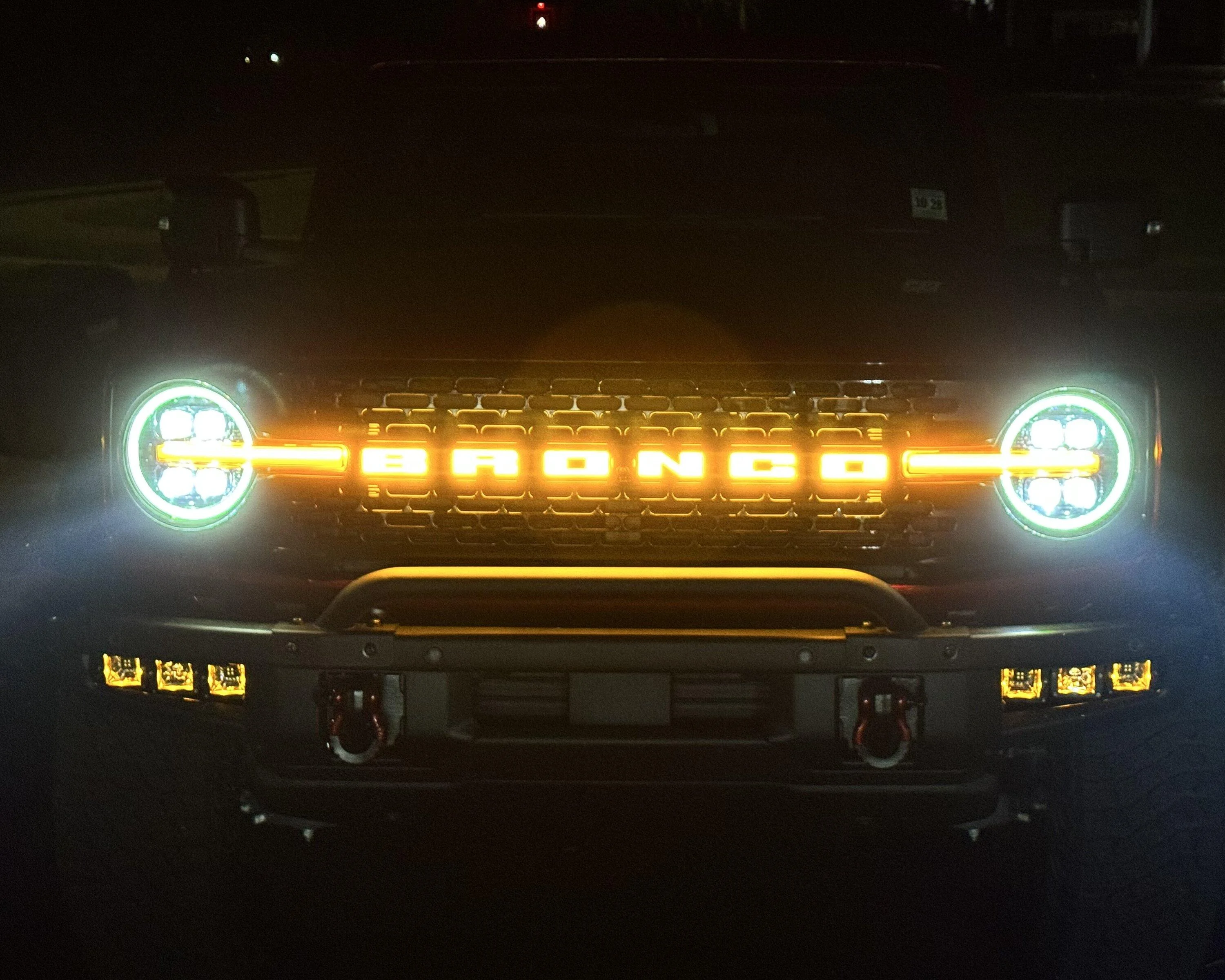

Has anyone successfully tapped the DRL and used for other lighting in conjunction with the AlphaRex headlights?
Asking because when I tried today, the DRL halo on the AlphaRex headlight that I tapped from wouldn't light up. I'm thinking the AlphaRex draw more power than the stock headlights.

wow thanks for the response John, that makes a lot of sense. I tried it again today because I thought maybe I had an extra ground somewhere. Today it seemed to work right off the bat!
Now, there were several times as I was tying back the wiring that the halo on the drivers side light would not go on, when I unlock the truck. I found though that if I cycle the DRL off and then back on inside the truck it seems to work fine from then on.
I’ll keep an eye on it for a bit and if it’s problematic I’ll add this relay (unless you recommend I just do that anyway!
