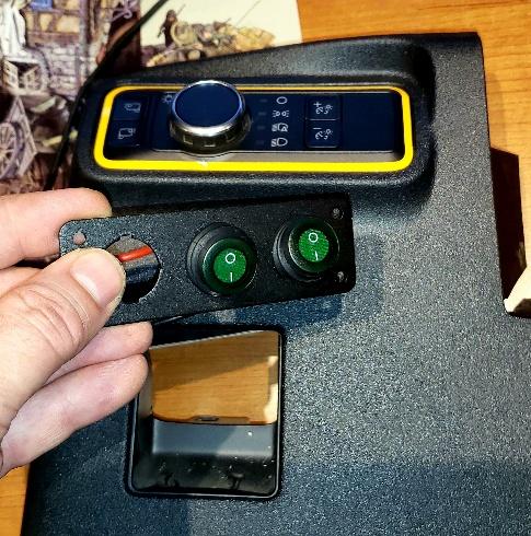

Shot below is me lining it up/planning. The idea was to center this below the light switch panel (with SickerFab's Cyber Orange border).

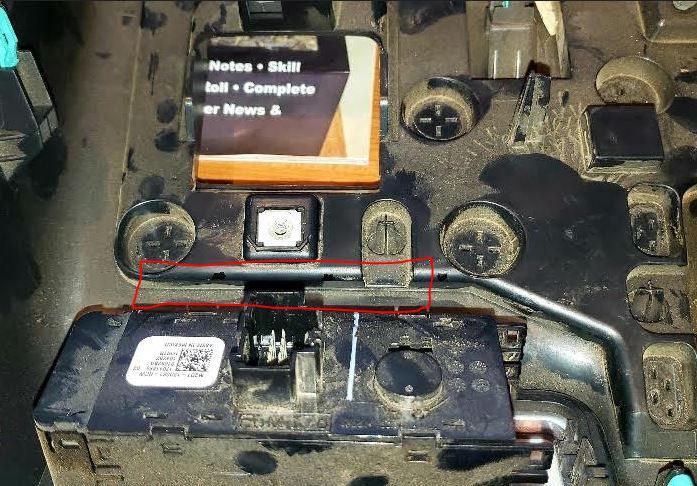

This is what it looks like on the back of the panel. Top side is down in this pic (as it would look if you opened it down to get to the fuse box). The red line is the approximate location of the rectangular switch box will be on the other side. I lined up two of the 20mm openings on either side of the parking brake screw.

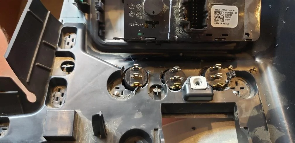

Similar to above but after I drilled the three 20mm holes. Headlight switch is now at the top. Had to use a dremel tool to help cut around the location where the upper parking brake housing screws into the back. I later added some JB Weld Epoxy Glue where I had to cut out some of the plastic. This will help re-strengthen any weak points. It is very tight there but not impossible.

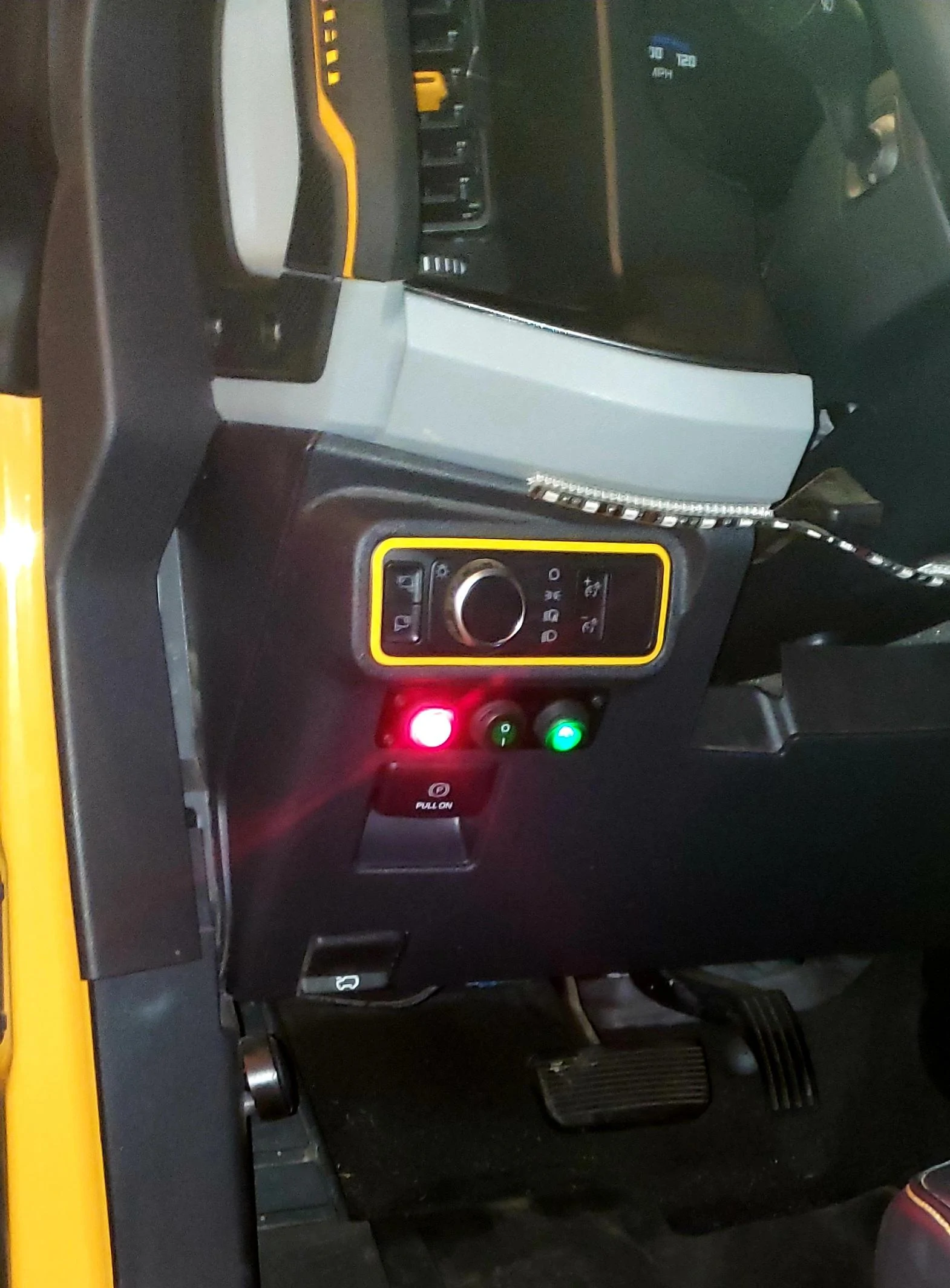

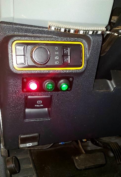

Finish project. The upper pic makes it look like its drops lower to the right but that is due to the camera angle. I made sure each end is equal distance below the headlight switch. The Red button illuminates the entire time the power steps are turned on. This is how Rockslide designed it. I am ok with that but I can see how others are not. The illuminated green switches actually light up green when I manually override the power steps and deploy them or they deploy automatically when I open the door. Nice to have those lights to show what they are doing since you cant see them well from driver seat.
