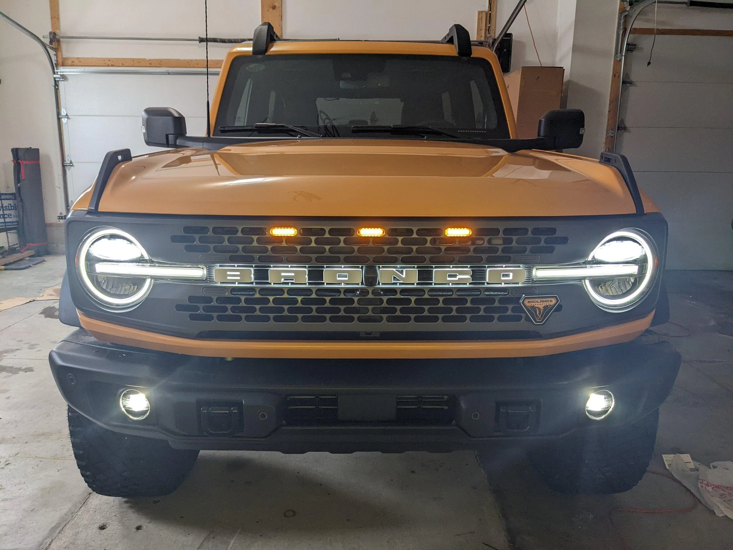

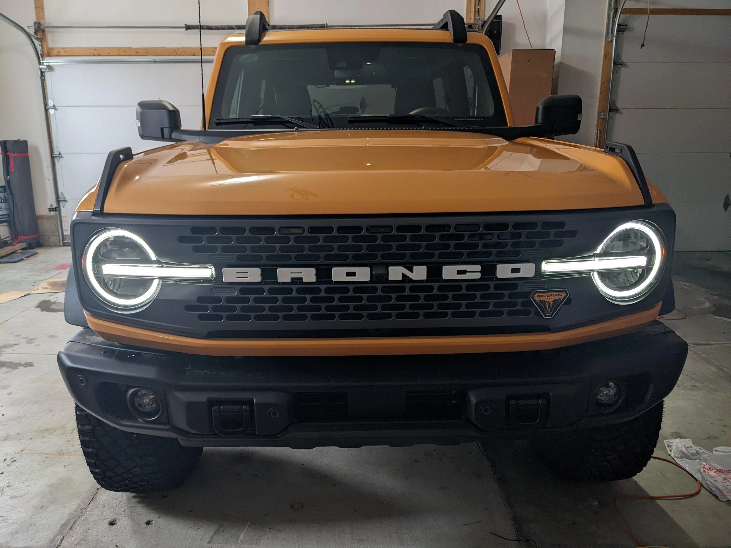

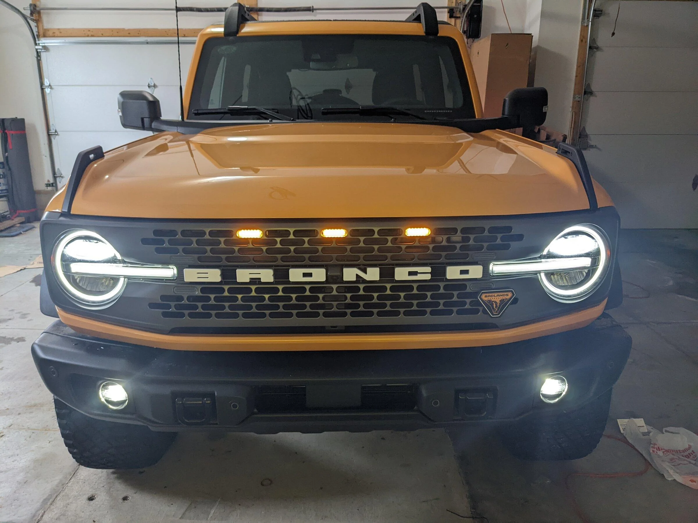

Installed the Oracle BRONCO lights and 3 cheap amber lights from Amazon. Happy with both.

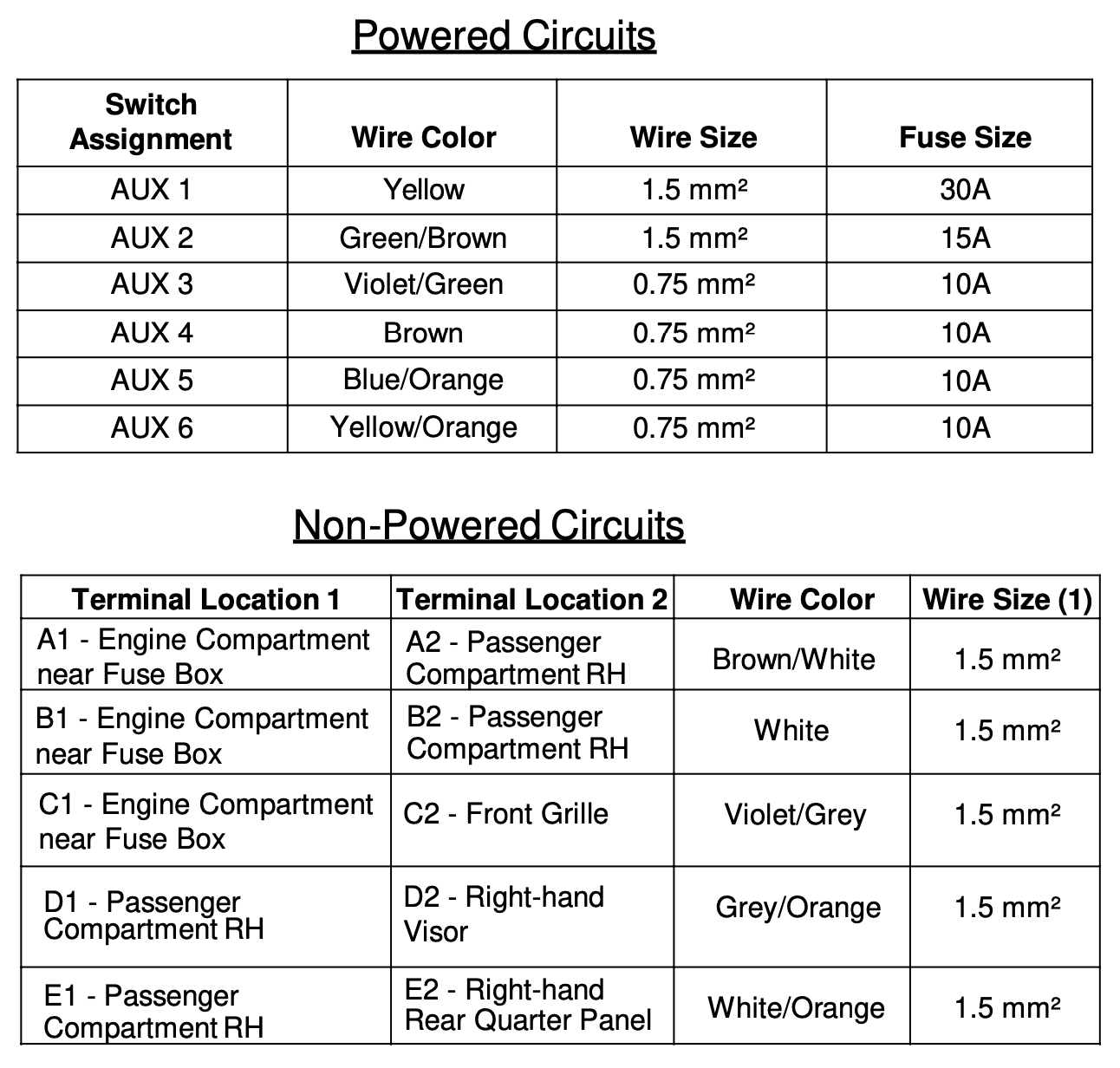

Need to get my letters installed! Looks sweet! what did you wire the letters to?
I put the letters to Aux6 and the ambers to Aux5
Both are 5 amp switched
I believe those are the original ratings. At some point Ford upgraded them to 10A.
Ford Bronco Added some grill lights Upfitter Switch Circuits
Good to know. I wonder when Ford changed it...

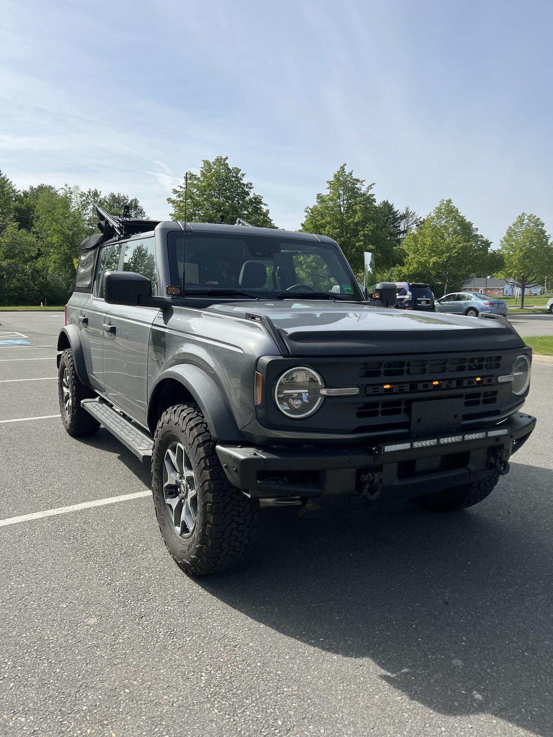

has anyone done this on a base or black diamond grille?
ATbronco
Dec 30, 2021
57
50
maine
Explorer
Base, less base-y now though haha
Ford Bronco Added some grill lights 0AADCF55-409D-47D6-9109-EBF6A3CAC7C9
Added BL wheels and tires
4x4 for all light needs, Diode dynamics 30 combo light bar, DD SS2 In the a pillar with amber backlight, just ordered the S1 in yellow SAE for fogs with amber backlight (will corner mount them on mod bumper) 4x4 is also the fastest shipping around, I’m talking like Amazon 5 years ago fast. All backlight and raptor amber lights are wired together into aux 6.
also did the kicker 200.4 amp upgrade with kicker 4” speakers in the front. Nice improvement over stock most notable with top off
