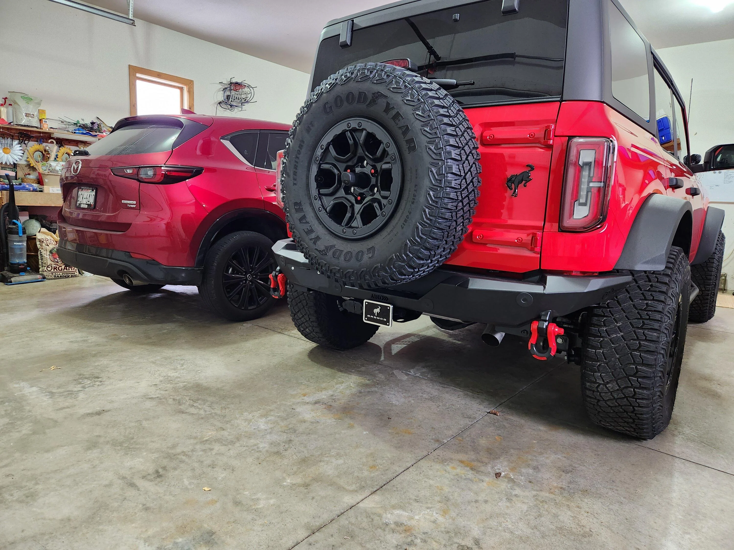

Looks great! Any particular dislikes?
Haven't even had it out of the garage with it yet, but at this point, No. Beautifully done! I like that all sensors fit perfectly, and license plate is in factory spot. Like it a lot!🙂
One caviat being, I went out and specifically bought a metric set of hex 3/8 sockets for the number 8 that is supposed to work on the two button head screws and it is too big and a 7 is too small!🤬 I did also raise the bumper about 1/2" since the pictures. Back to the store tomorrow for the correct hex bit.

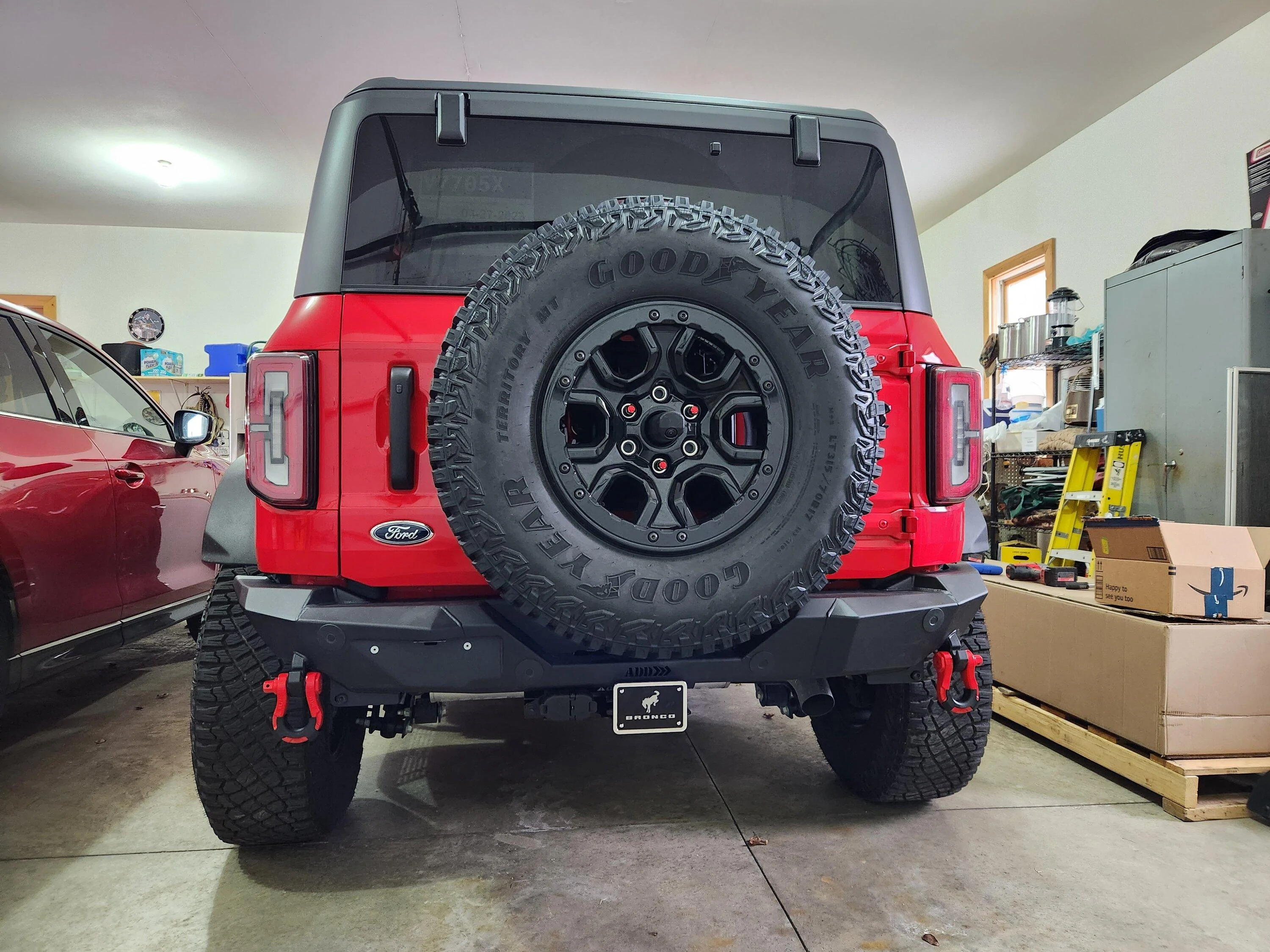

Ended up being a 5/16 hex for the two button head bolts. And now that I've taken it out for a drive for some reason my backup sensors go off every time I'm in reverse even though there's nothing behind me don't know what the hell that's all about. 🫤

When I got home, I backed up several times in the driveway and it seems to be working fine.🤔 When I was out and stopped at a few places, every time I put it in reverse the damn sensors would beep with nothing behind me. I made sure they were clean, but didn't help. I will have to see what happens next. 🫤

Sensors are still Wonky. Sometimes seem to be working fine, next time , they go off with nothing around. Frustrating. Can't bring to dealership. They will say I F'd it up with the new bumper.🫤

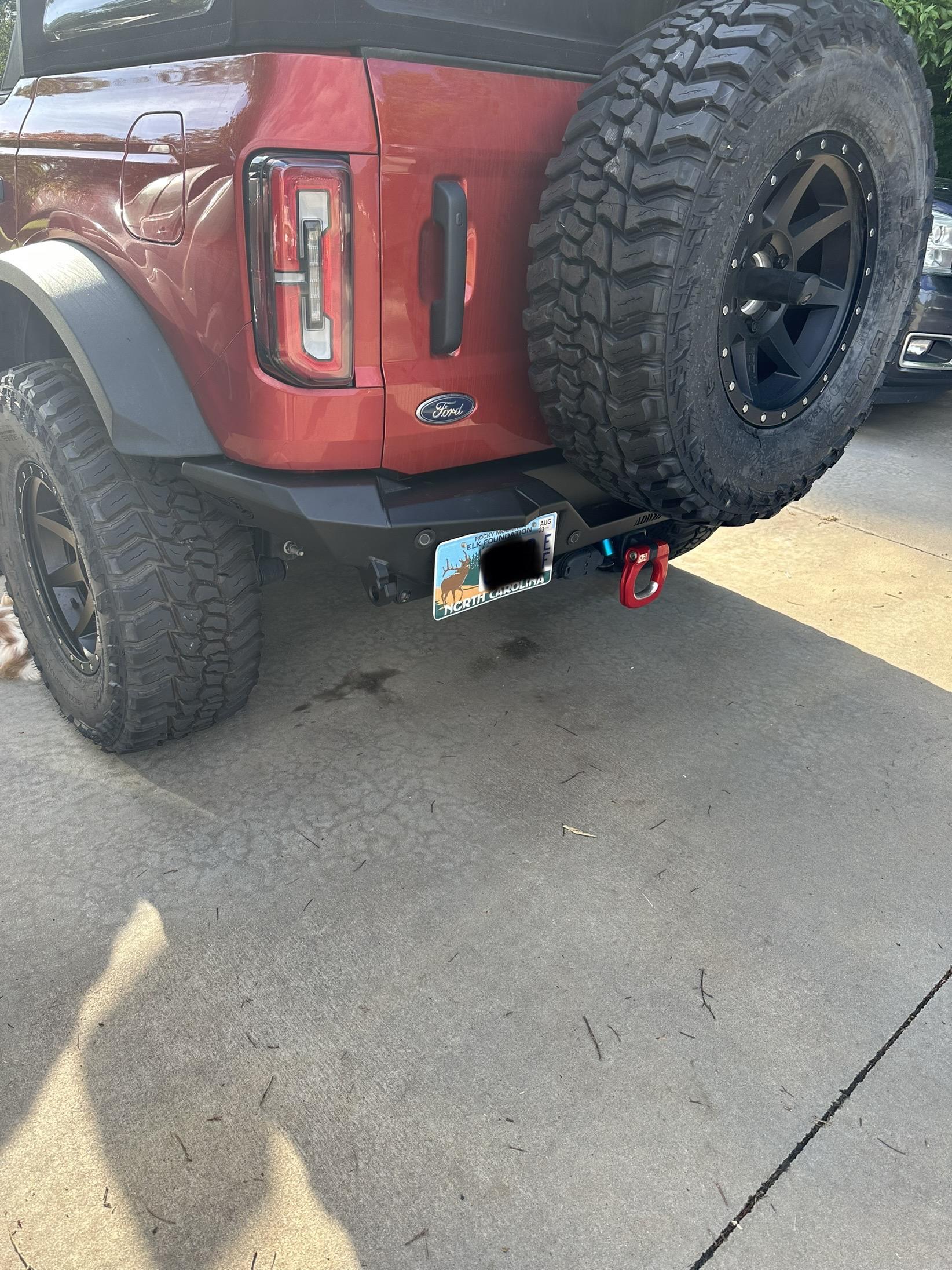

i just installed mine and it was a pain with the lux badland sensors.
At first, I thought I had labeled them wrong. I finally just decided I’ll have to make them work. I had to trim a few of the tabs so they would fit flush and then epoxy. Those white locking brackets on the end sensors would not work at all.
At first I had nothing, I went back and messed with the connections on both sides. I had the hardest time getting both to seat and lock.
I’m going to have to go back and see if I can get a few of them back flush. Putting it on, I got a few poking our some. Everything seems to be working fine now.

🤔 I didn't see to have a big problem installing the sensors, but since I did the install, sometimes the back up sensors go off when in reverse when nothing is there. Doesn't happen all the time. Can't figure out why. Frustrating.🫤
