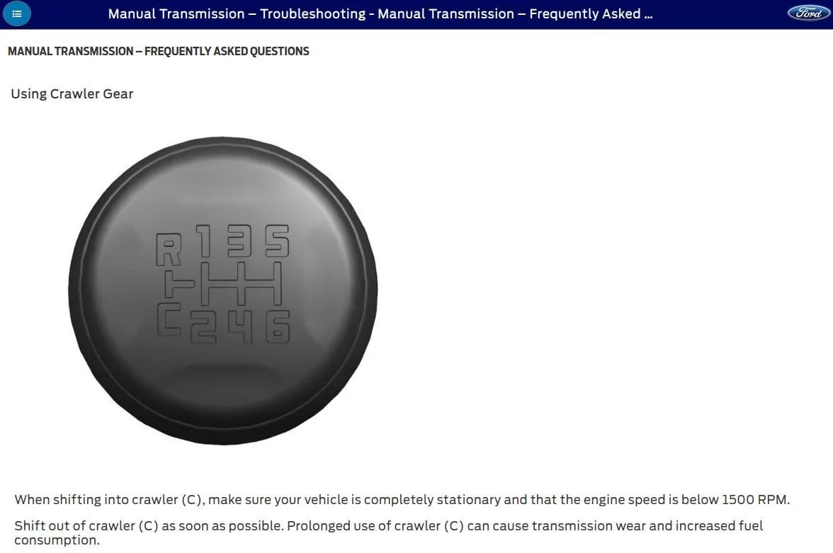

Hi All - Just took delivery of my big bend this week and loving it! Does anyone know if C gear is synchro'd?
I slightly grinded mine this morning coming down into my underground parking garage. The weird thing was that I had the clutch disengaged (rolling down the downward sloped driveway) and got the noise. Stopped immediately, got out of C & re-shifted into C and the grind went away.
Is this because I didn't fully engage the gear, or a lack of a synchro type deal? Rookie with the MT here. Thanks!

It is synchronized, and you can go from C -> 1st.
If it continues to happen, take it in.
