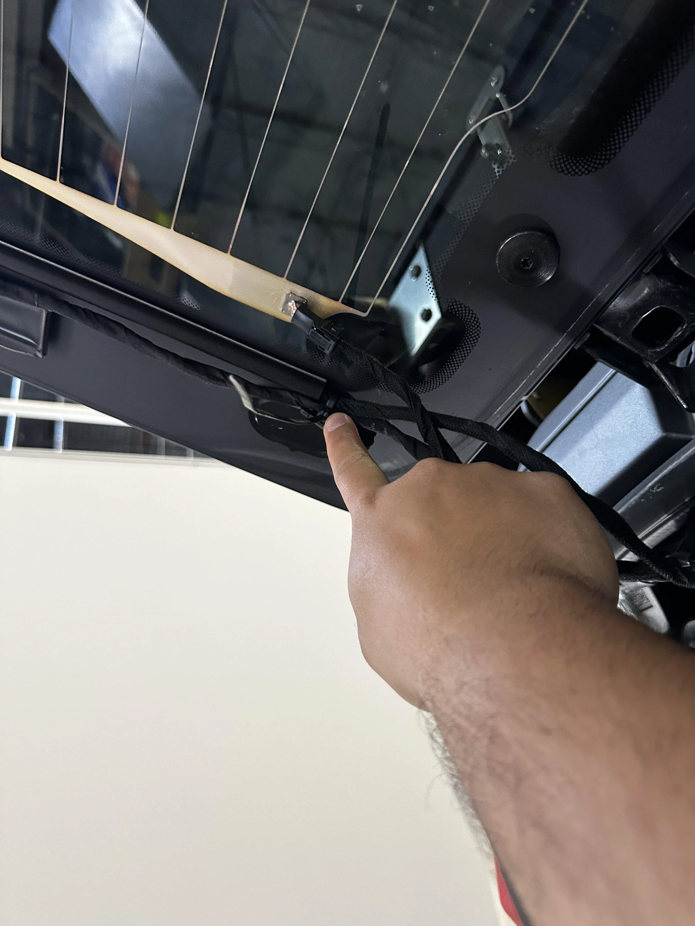

First, you want to get the Dome light mounted onto this plastic housing. It is just snapped in with plastic clips so carefully remove the housing, drill 2 holes per dome light, use some small hardware to mount to the plastic housing. Once that is done, get the housing back onto the window. If you have the chance, drill a bigger hole between the two to route the wires under and out the factory cut out location.
Second, get your wiring connected to factory tails from the dome light, we wrapped ours in this protecting electrical tape. we added zip-ties to some spots connecting to the wires of the wiper motor. We will follow that to the inside of the bronco.

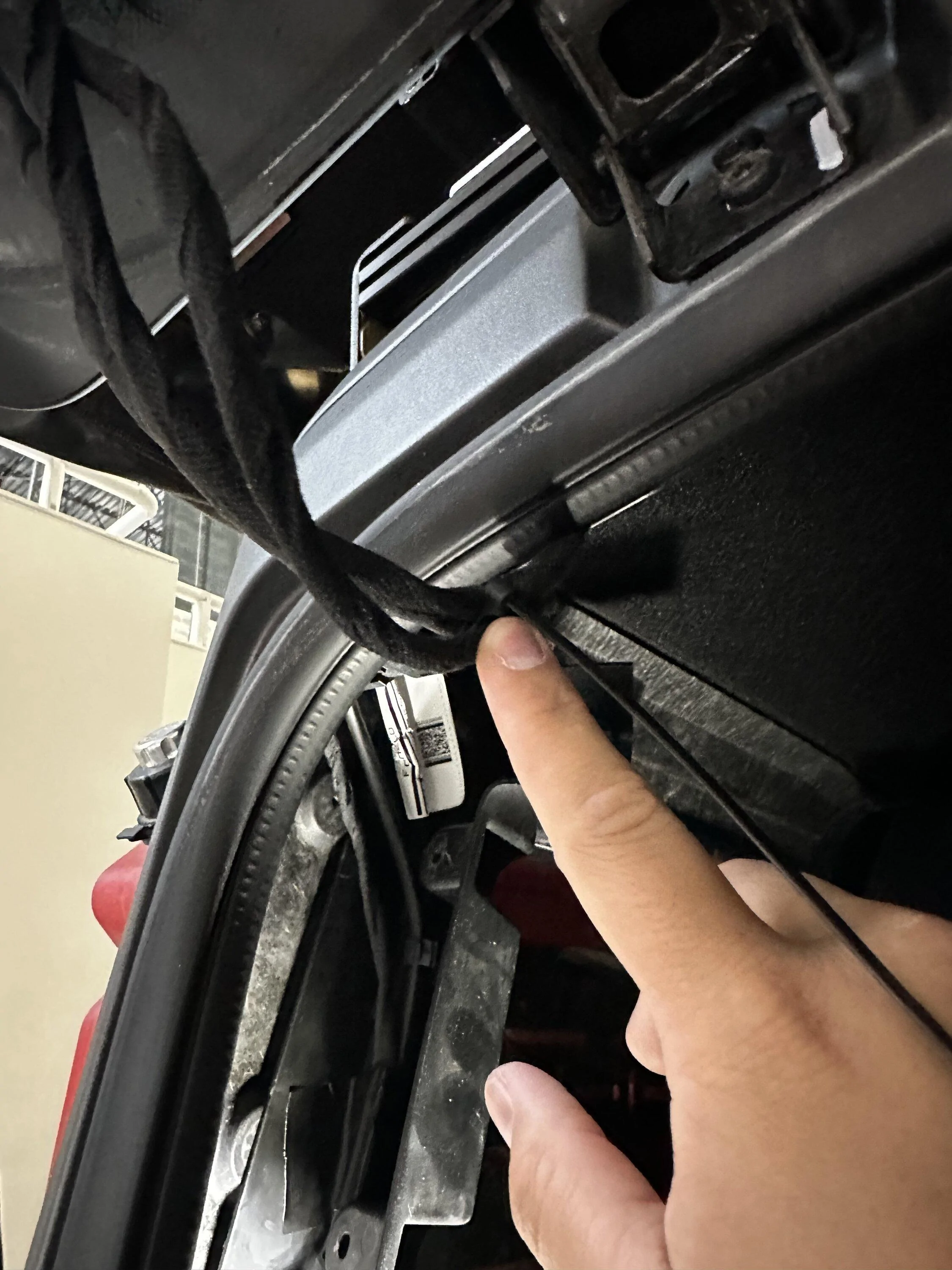

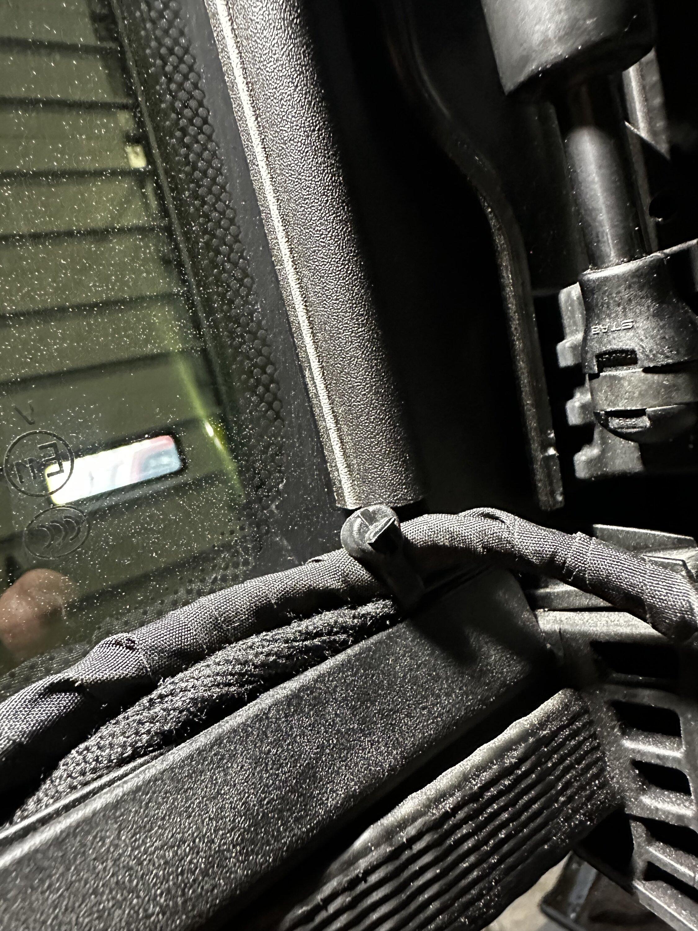

Third, same idea, keep following the factory wiper motor wire all the way to the inside of the cab, we zip-tied some spots to keep it high and tight.

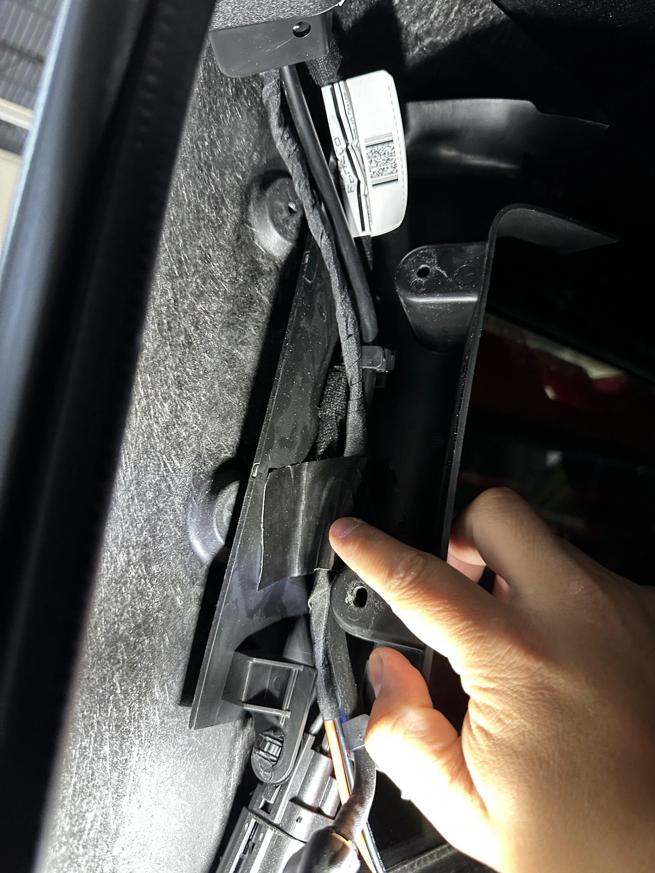

Fourth, unbolt the plastic cover for the wiper motor wire and washer fluid hose, hide your wires through there and drop it down to the tub of the Bronco. There was this factory duct tape that was holding the wires in the housing, we peeled it up, added our wire in, and put it back. Bolt the housing back up. After this, right where the disconnecting parts of the wires and washer hose are, we added our male and female connectors, this way you can disconnect all 3 parts when you want to remove the hardtop. While our Bronco will never see the hardtop removed, this is a good add for those who do take their hardtop off.

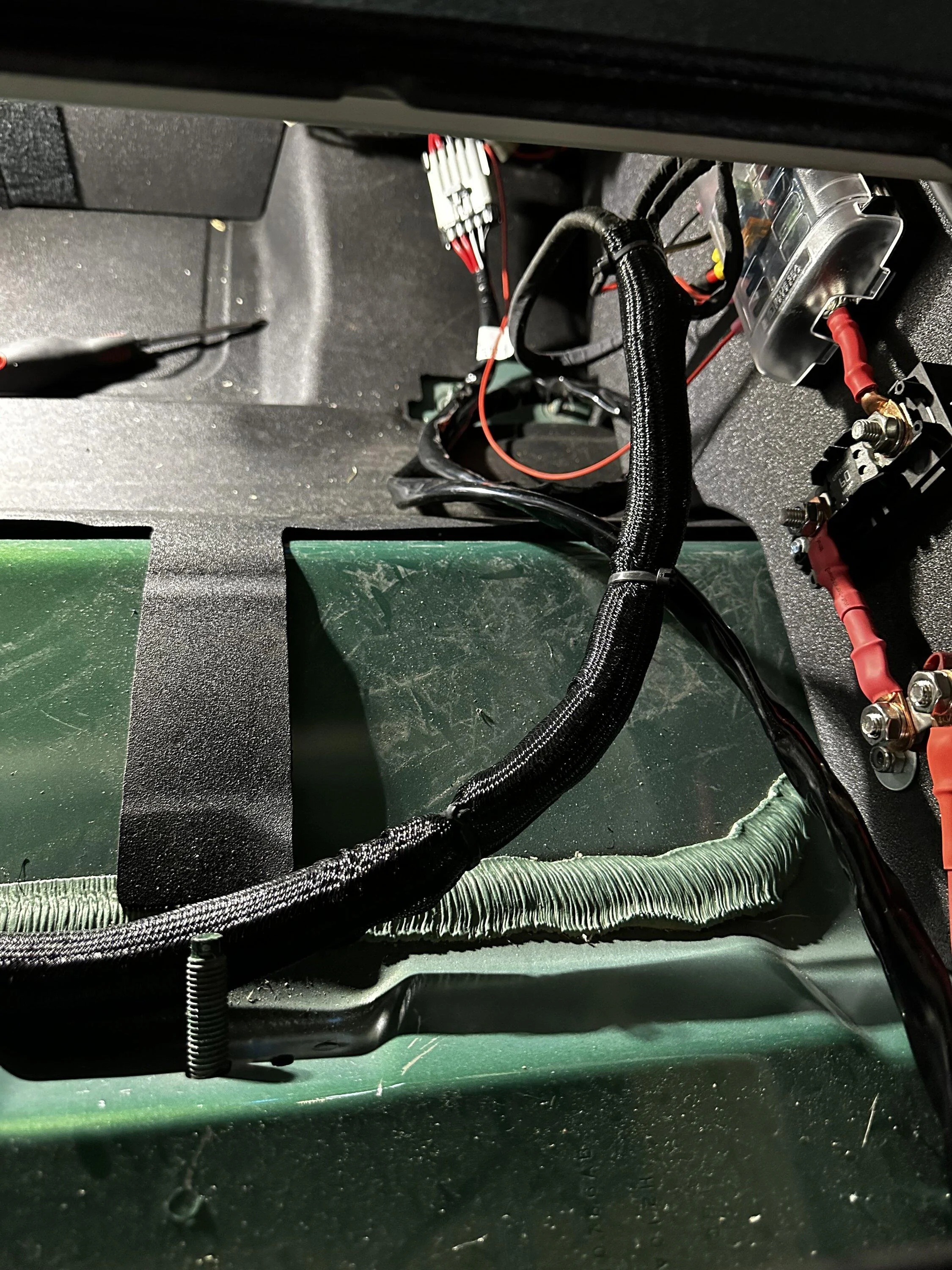

Fifth, This is where we routed our wire down to our Goose Gear seat delete (60% side) this houses our ARB twin air compressor, Blue sea terminal powered by our Dakota lithium and REDARC charger. Once you have it connected to power, test it before putting everything back together.
