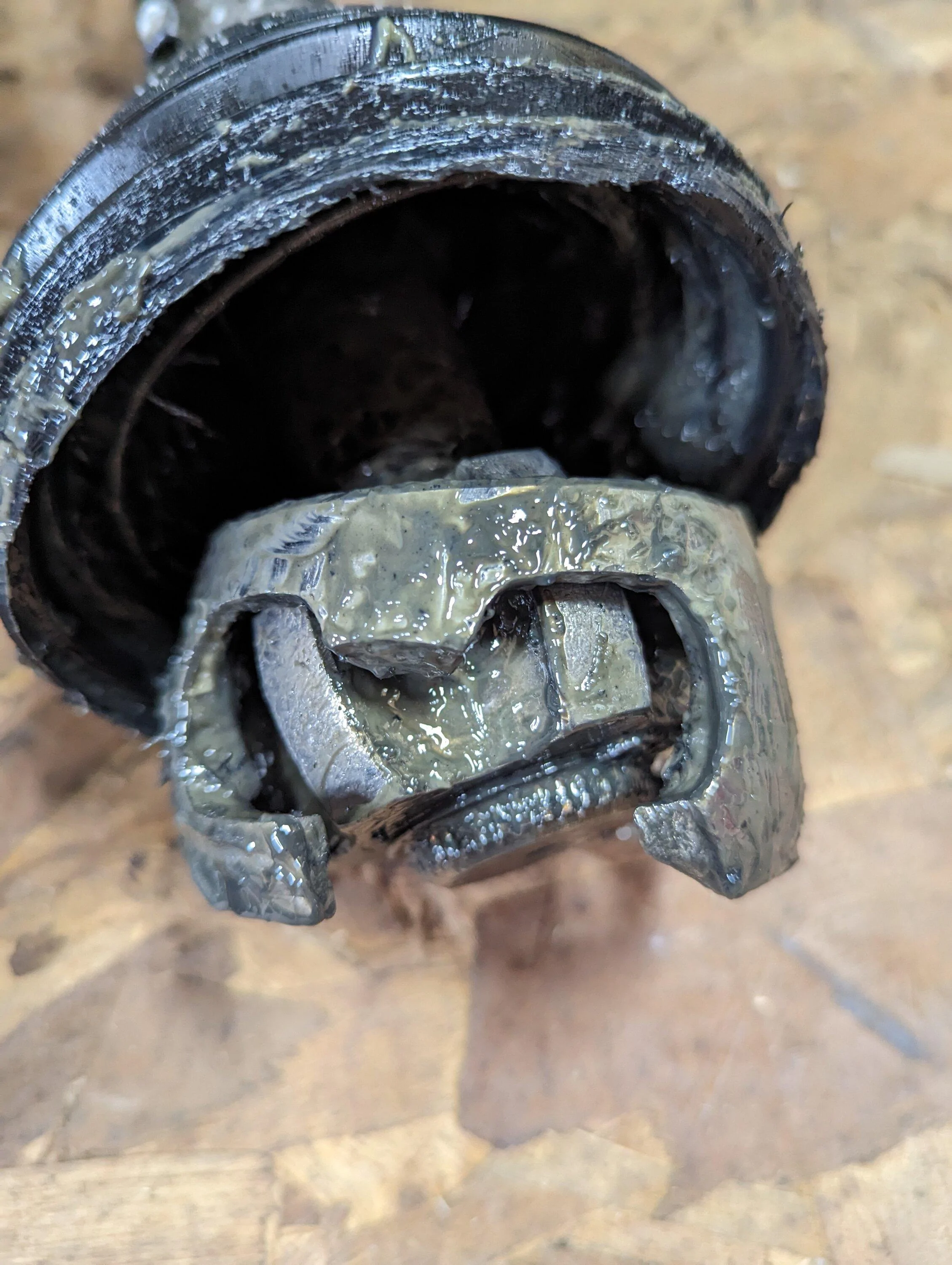

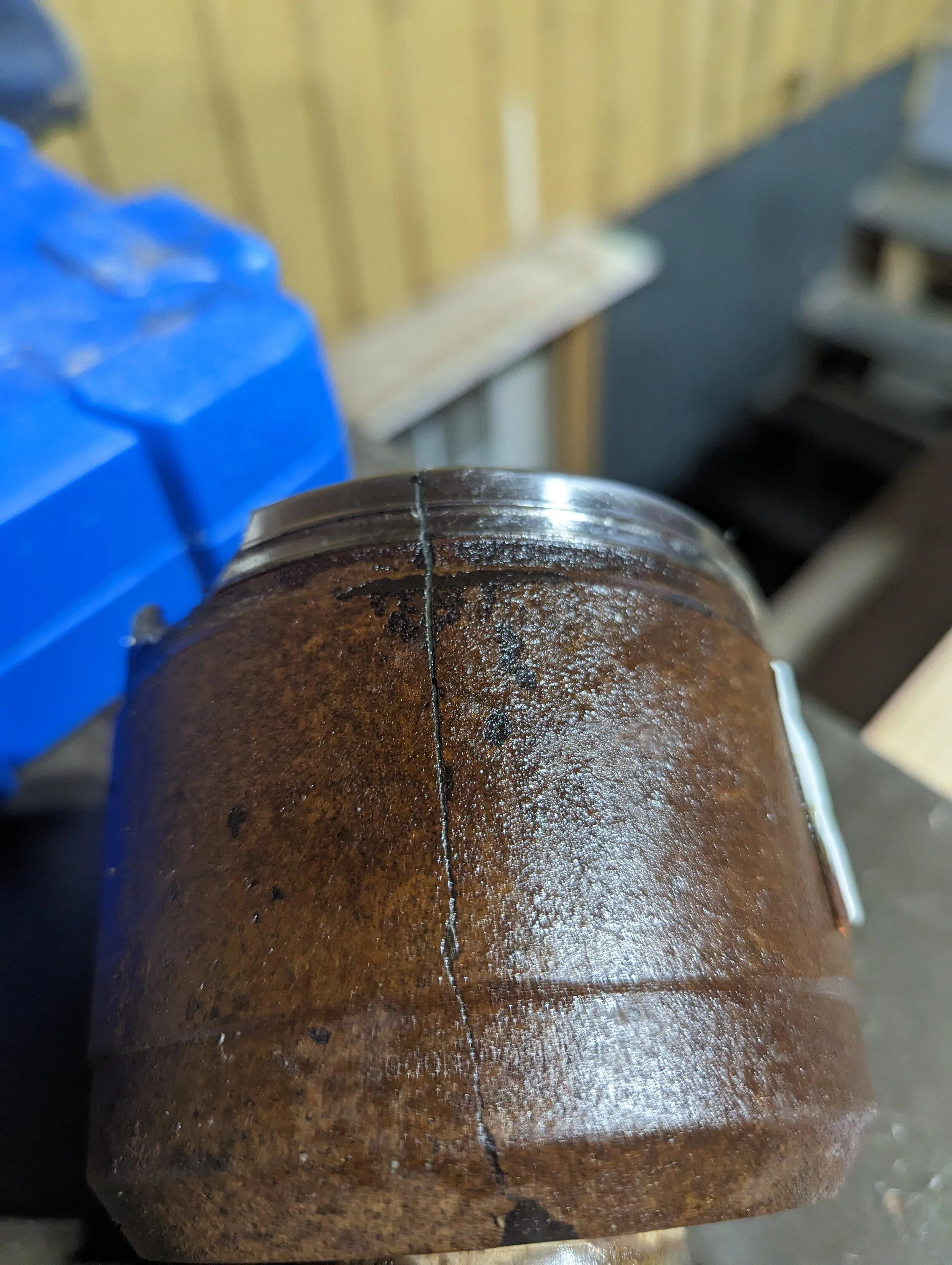

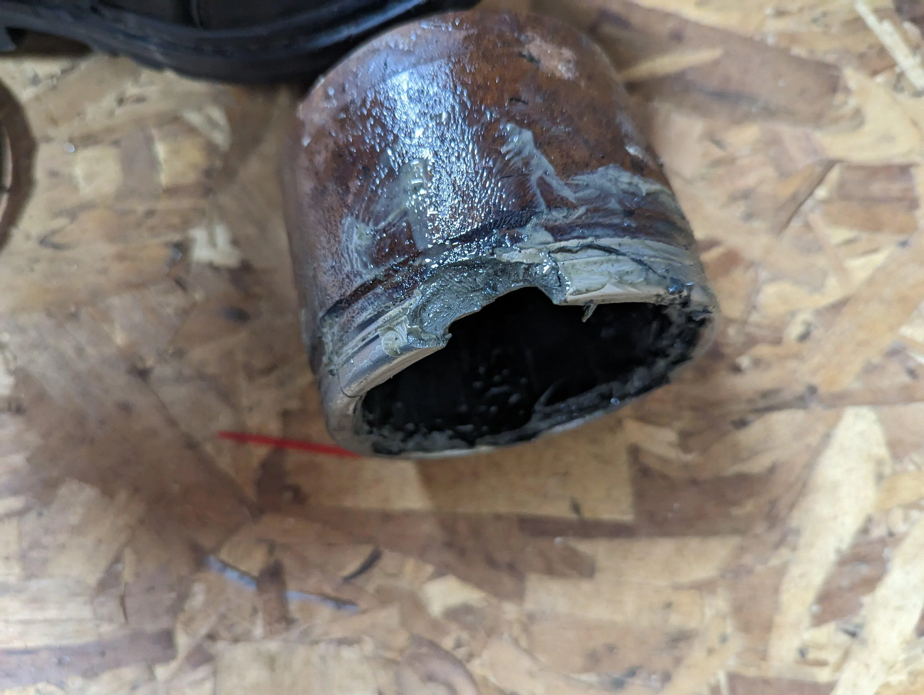

If you haven't seen my broken axle yet, here it is. Changed it out last weekend, wasn't too bad. Was my first time doing a job like this.

I don't follow the channel. How did you break it? Could this have happened due to the after market lift and oversized tires?
Tires probably didn't help. But if had my wheels fully cut to one side, thought they were straight. Then front locker and winched forward, putting all the pressure on that one axle. Pop Pop. There she went.

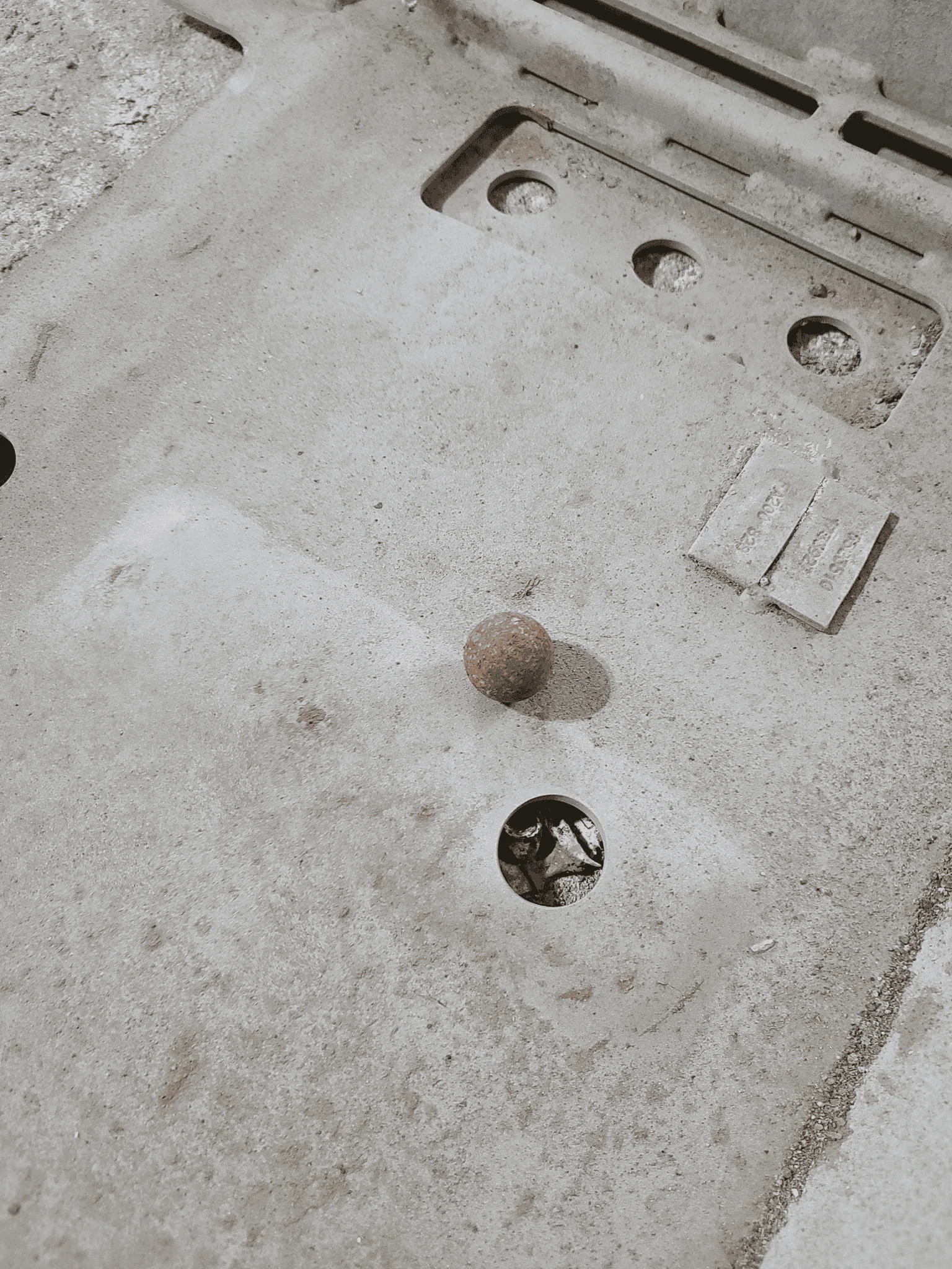

Now to see where the CV joint balls turn up :) I found one in my skid plate7 months later.
