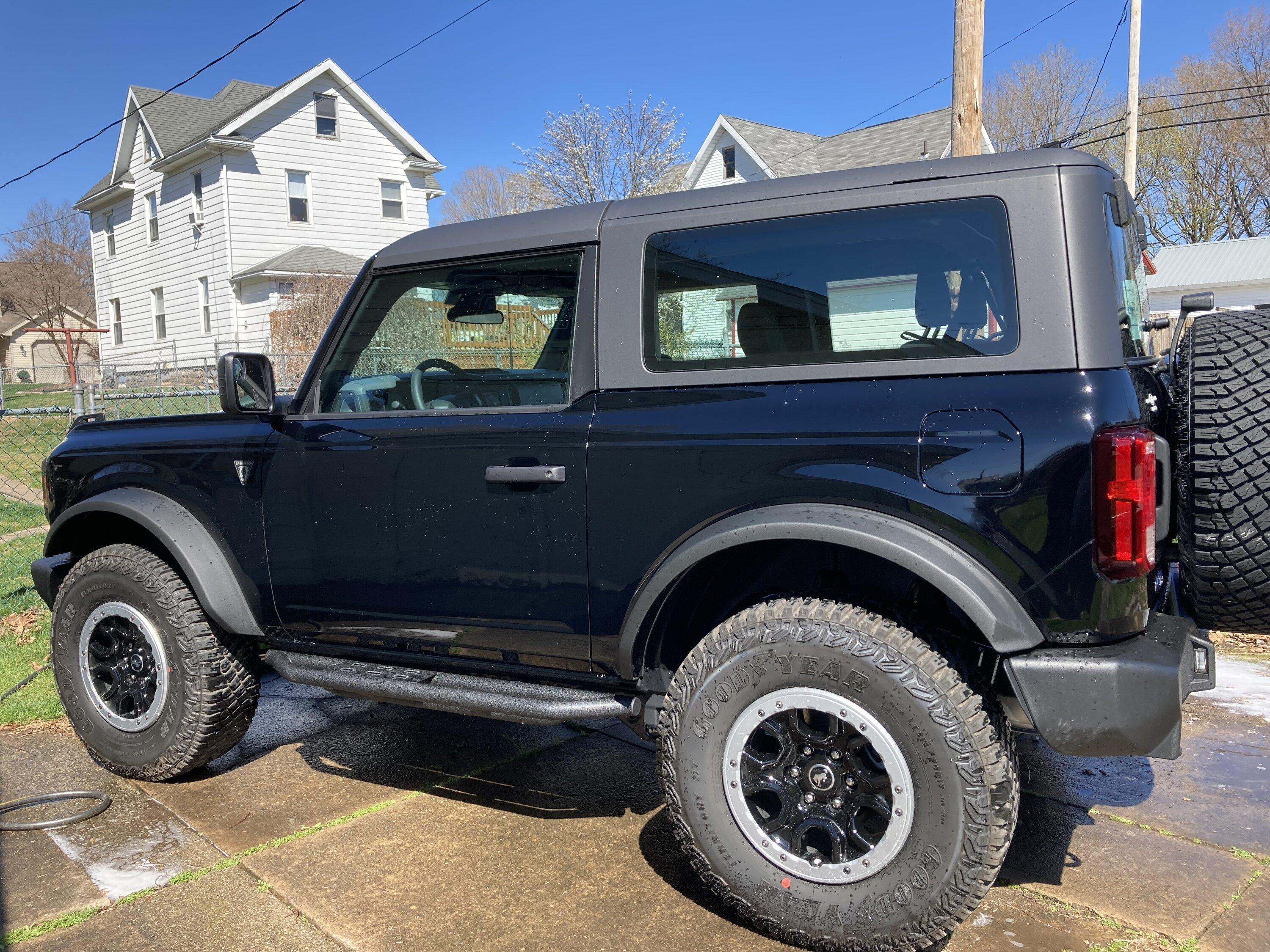

Boy, I really needed to get this going, packages just keep arriving. :LOL: It has been a long (Aug of 2020 res) time coming but the Bronc has finally arrived !!!!!! 2DR 2.7 Base Squatch in Shadow Black. Or as I like to term a "Basetrak". All the thrills with none of the frills !!!!! Those "frills" I can add. ;)
Ford Bronco The "Baus" Bronc IMG_0329
I will try to keep it short because I can ramble on, just ask @KillerPenz ;) . I will try and chime people in here in case they would like to see my progress, I will forget some, and others will come later but they are not in any particular order just as I can remember. @MadMan4BamaNATL gave me the idea and thought I would "roll" with it. 😁 But for those that know, you know, but for those that don't here it is. The "BAUS" is part of my last name and it is pronounced "boss". hence the "boss" Bronc. Not a young buck here, just an old timer that loves wheelin' and racin'. Got wind of the new Bronc back in late '19 when we saw the first body lines of the 6G. Joined B6G in Jan of 20 to get insight into how to get one ASAP!!!!
Ford Bronco The "Baus" Bronc 1680737217122
Guess you know what I will be doing with my "BRONCO" letters. ;) Then the whole thing fell apart from 2DR floor pans being damaged in shipping, then the MIC debacle, then 2.7s giving up their guts, making me ditch my beloved AMB :confused: , going through a COVP program for 22 and still not built, and on and on. Then watching as orders that were placed after my re-reorder and getting built I was beginning to wonder if it was ever going to happen. Then out of the blue when all hope was lost. I got the e-mail. 😳 Build date of Mar 6th. Didn't get pushed. Built on Mar 7th. Then the delivery date kept changing, dealer would tell me any day now. Then that magical day. I just got home from work and my phone rang..... I got a package just off the truck. It was only about a half an hour till they closed but I could not resist.

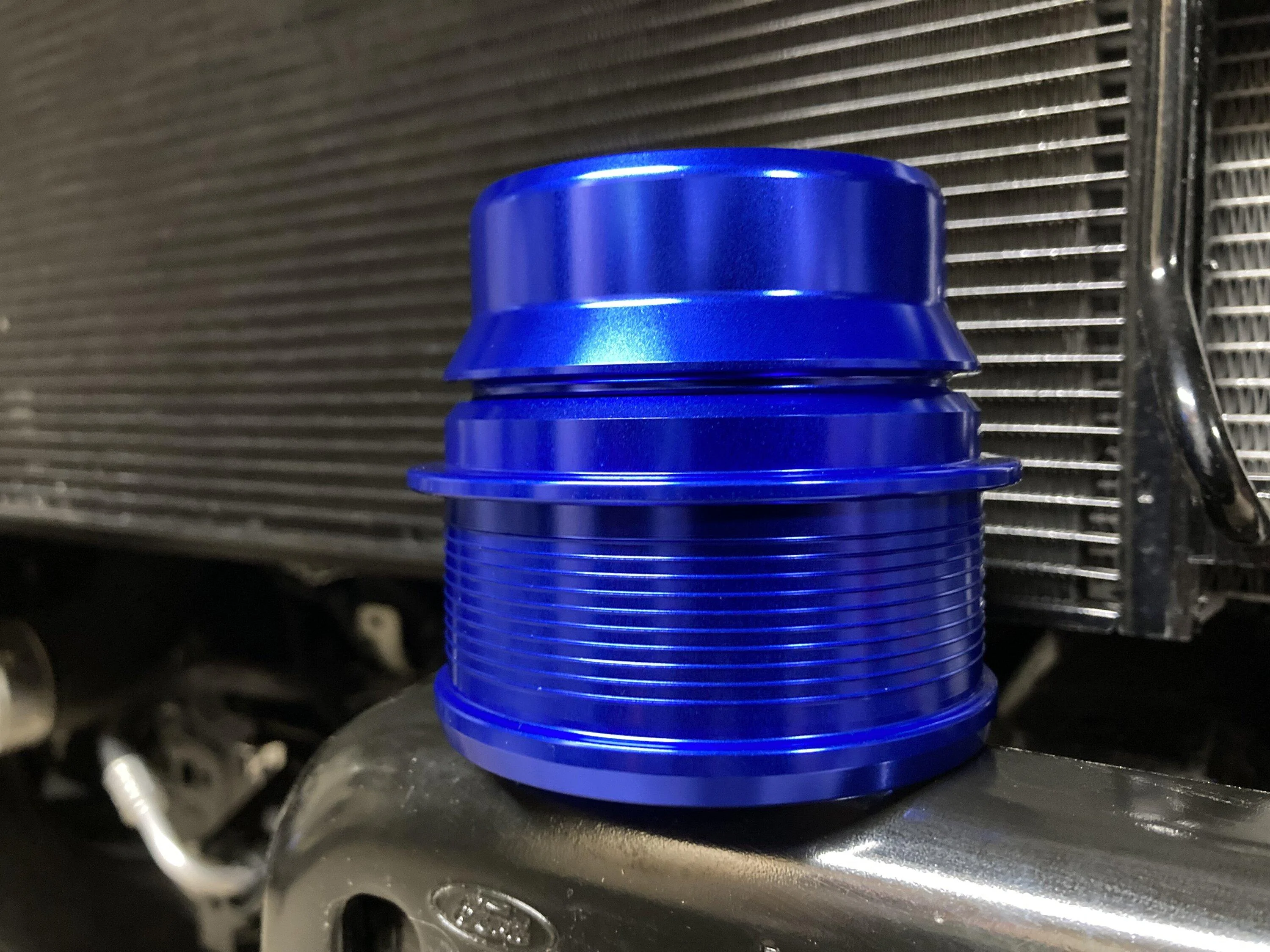

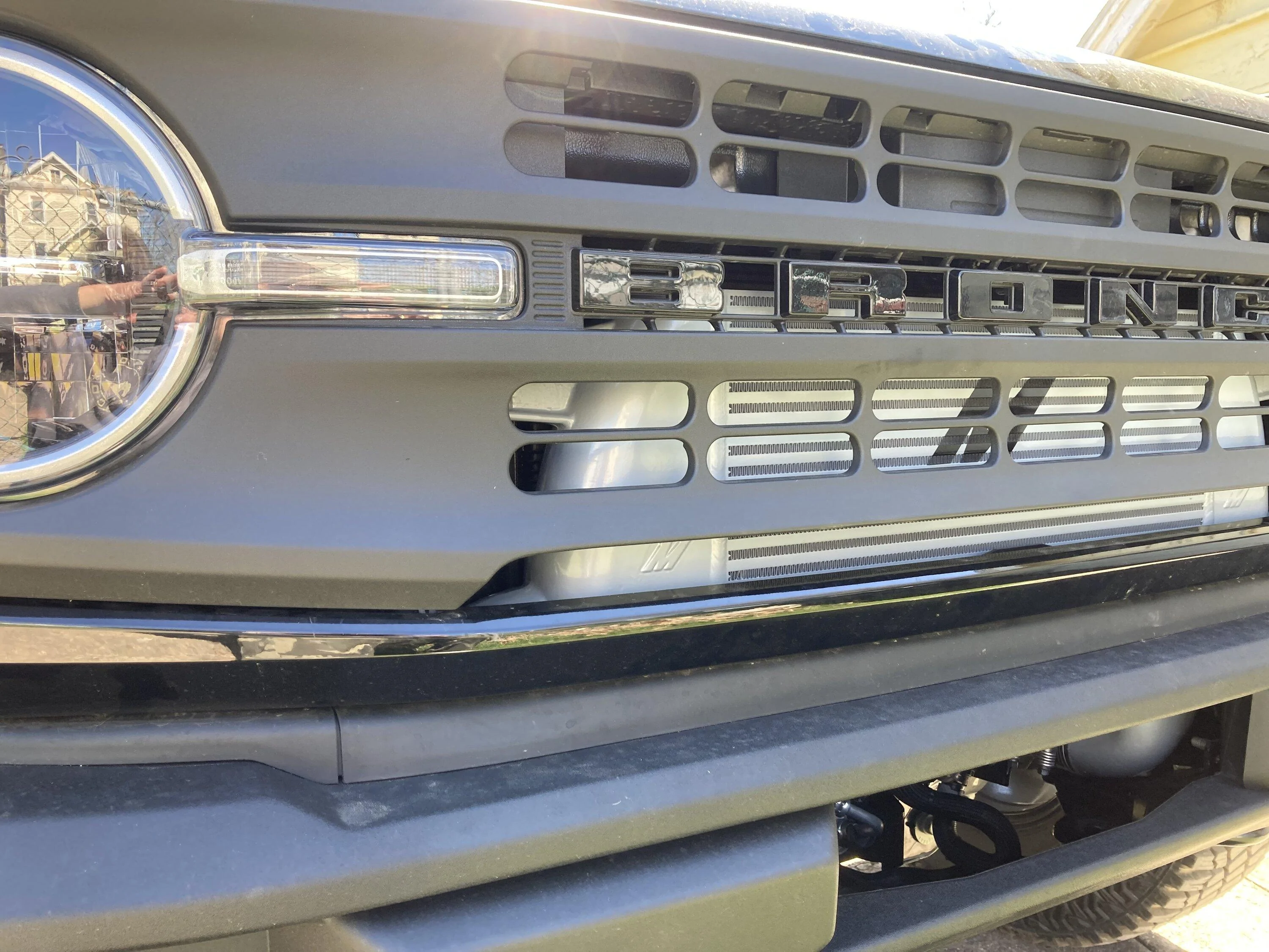

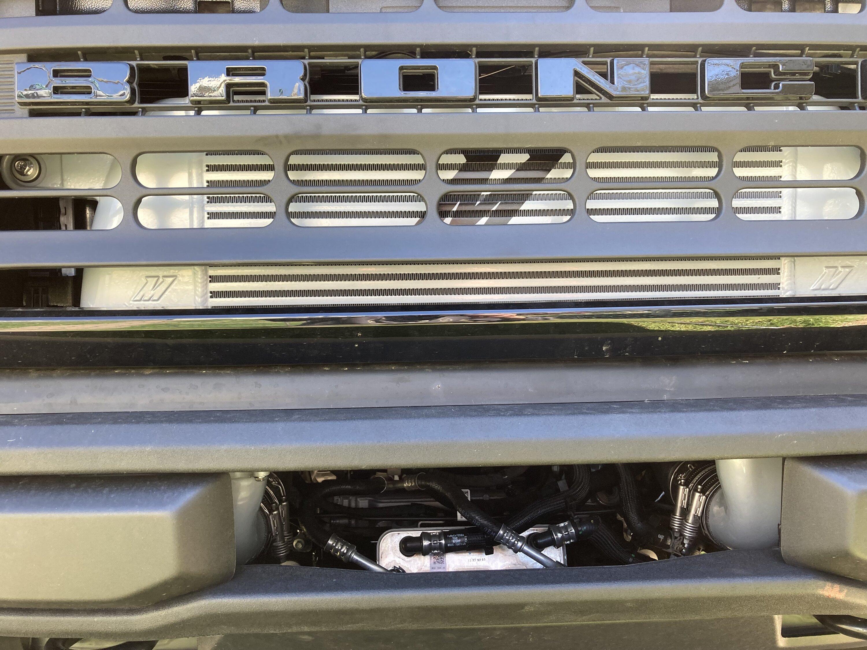

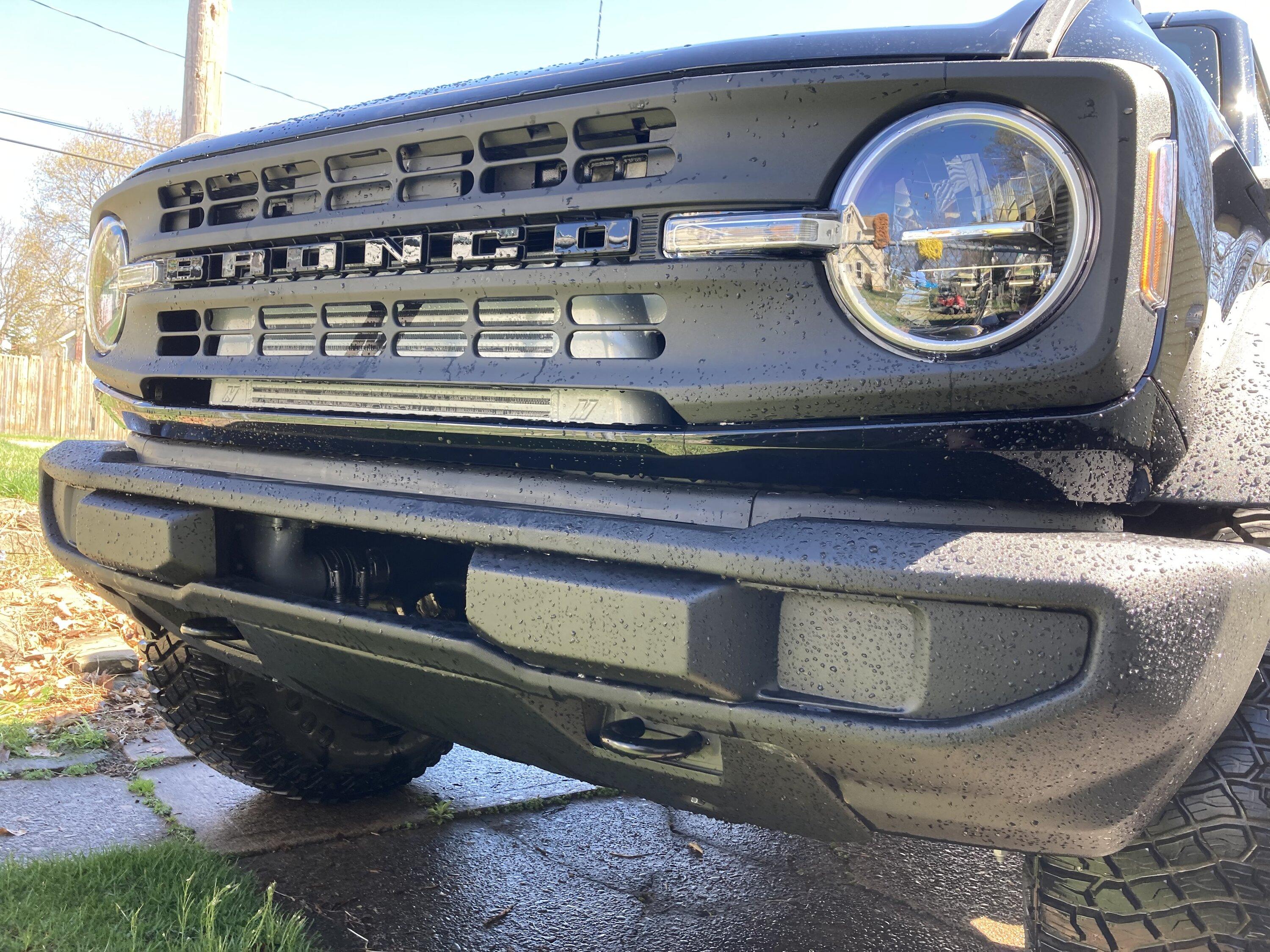

Well here it is .......................... Mishimoto's High Road Intercooler, sometimes I refer to it as "the high mount".

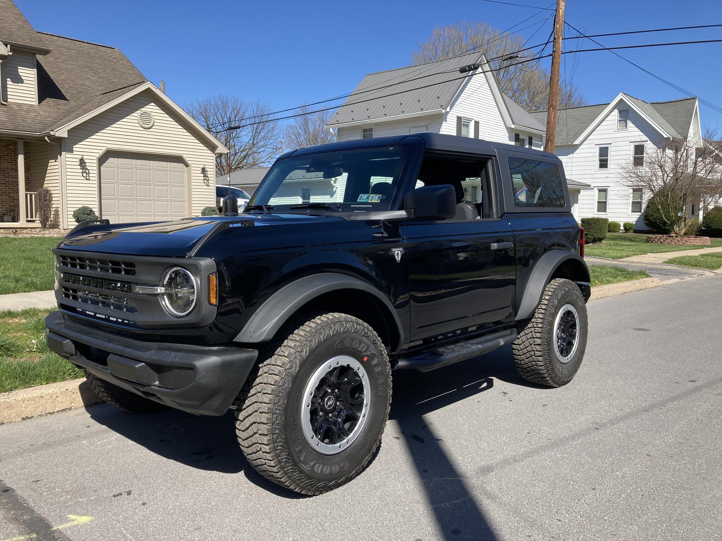

First a bit of a back story. I work a second job now on Saturday mornings, so my "wrenching" would have to wait a bit. So as a last hurrah for being "stock" I dove it to work. Not 200 miles on the clock.
Ford Bronco The "Baus" Bronc IMG_0456
Ford Bronco The "Baus" Bronc IMG_E0455

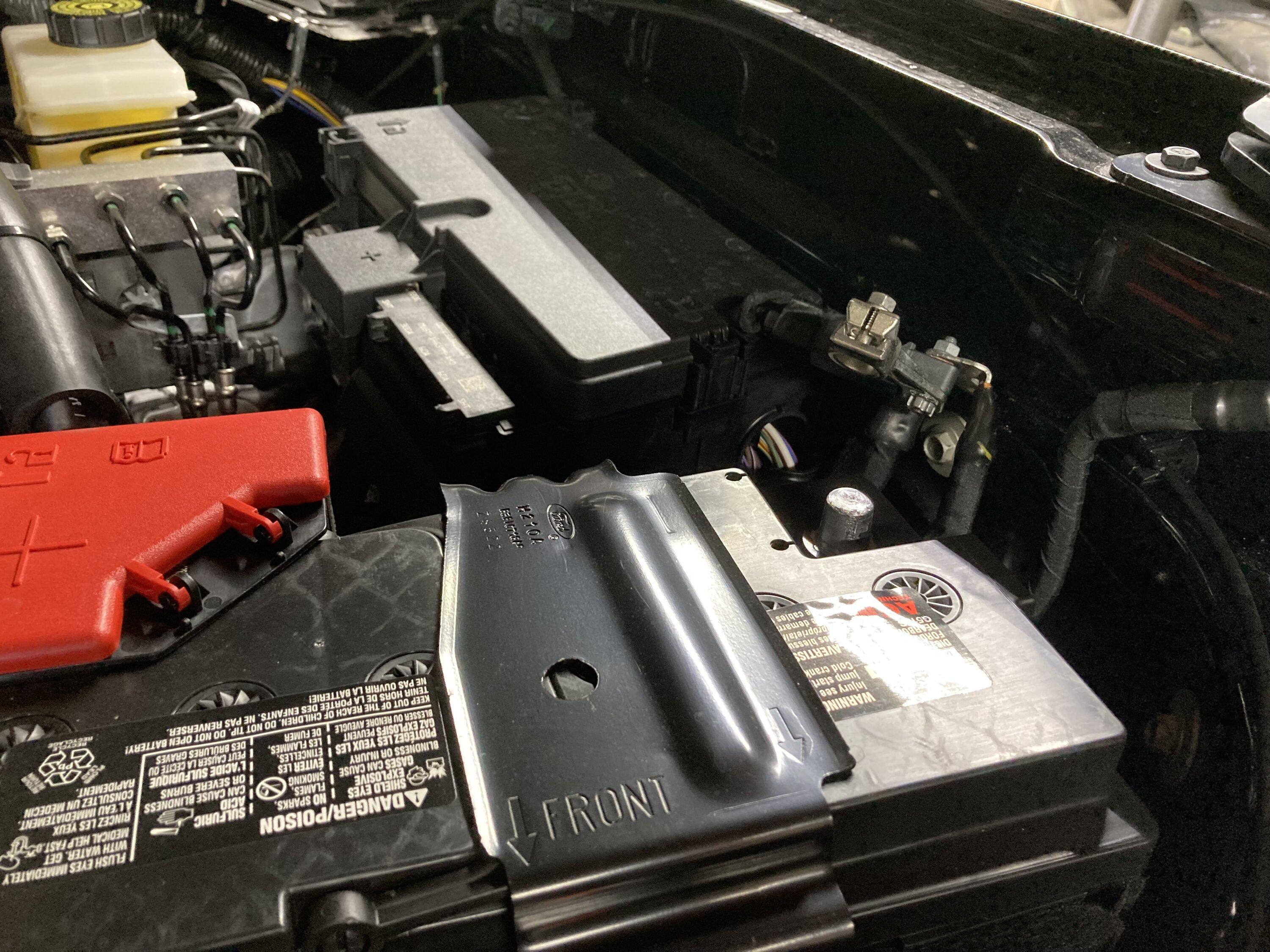

Step one. I tell people this all the time. ANY time you touch a plug on a vehicle you need to disconnect the negative battery terminal. Just had a new guy at my new job and he did not do it on a 19 Duramax when installing a computer upgrade and he is now looking for new employment. ;)

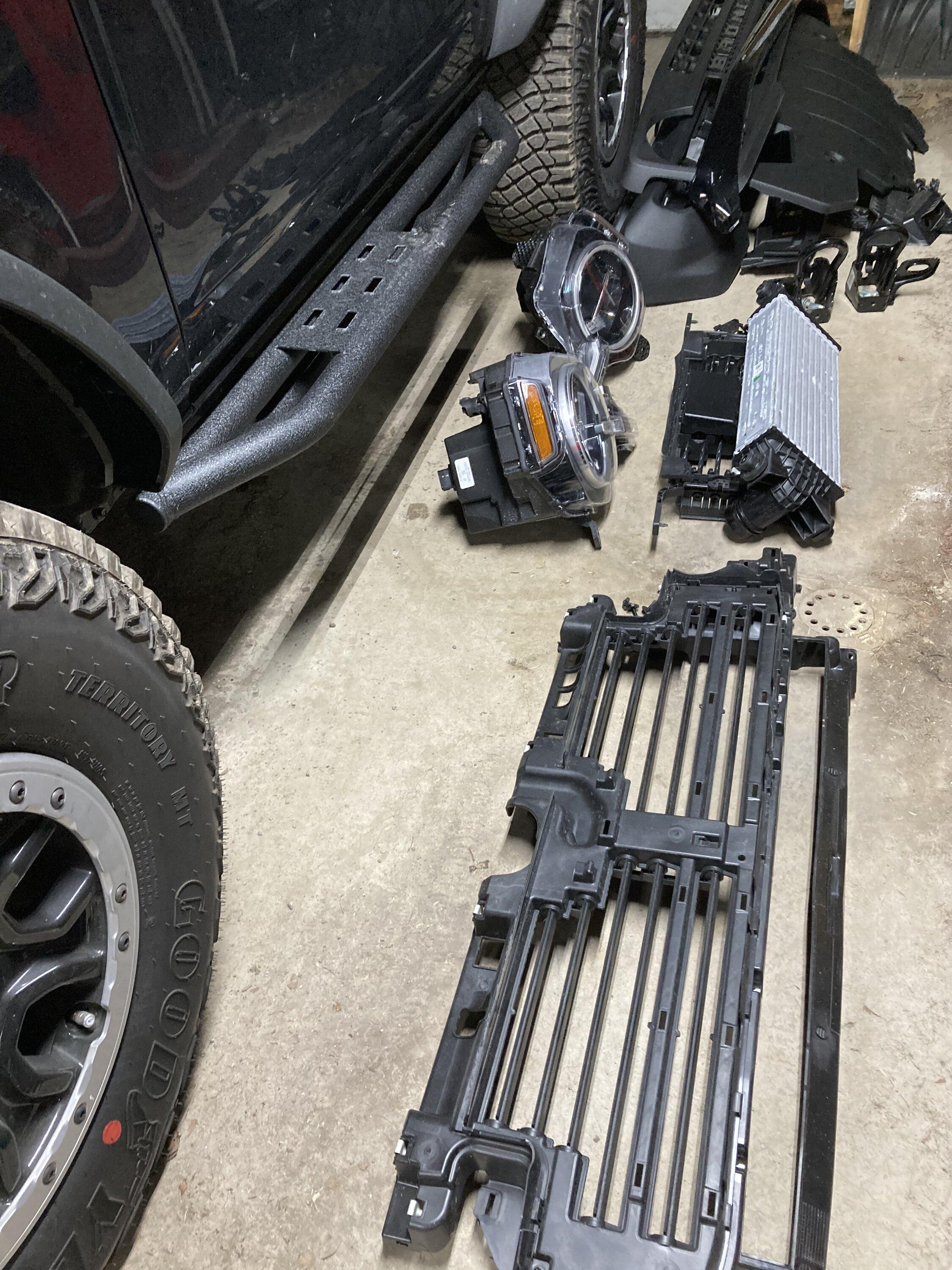

I could fill three pages of pics and I think most that will see this already knows how the new Broncs are to work on. I will spare you every step. 😁

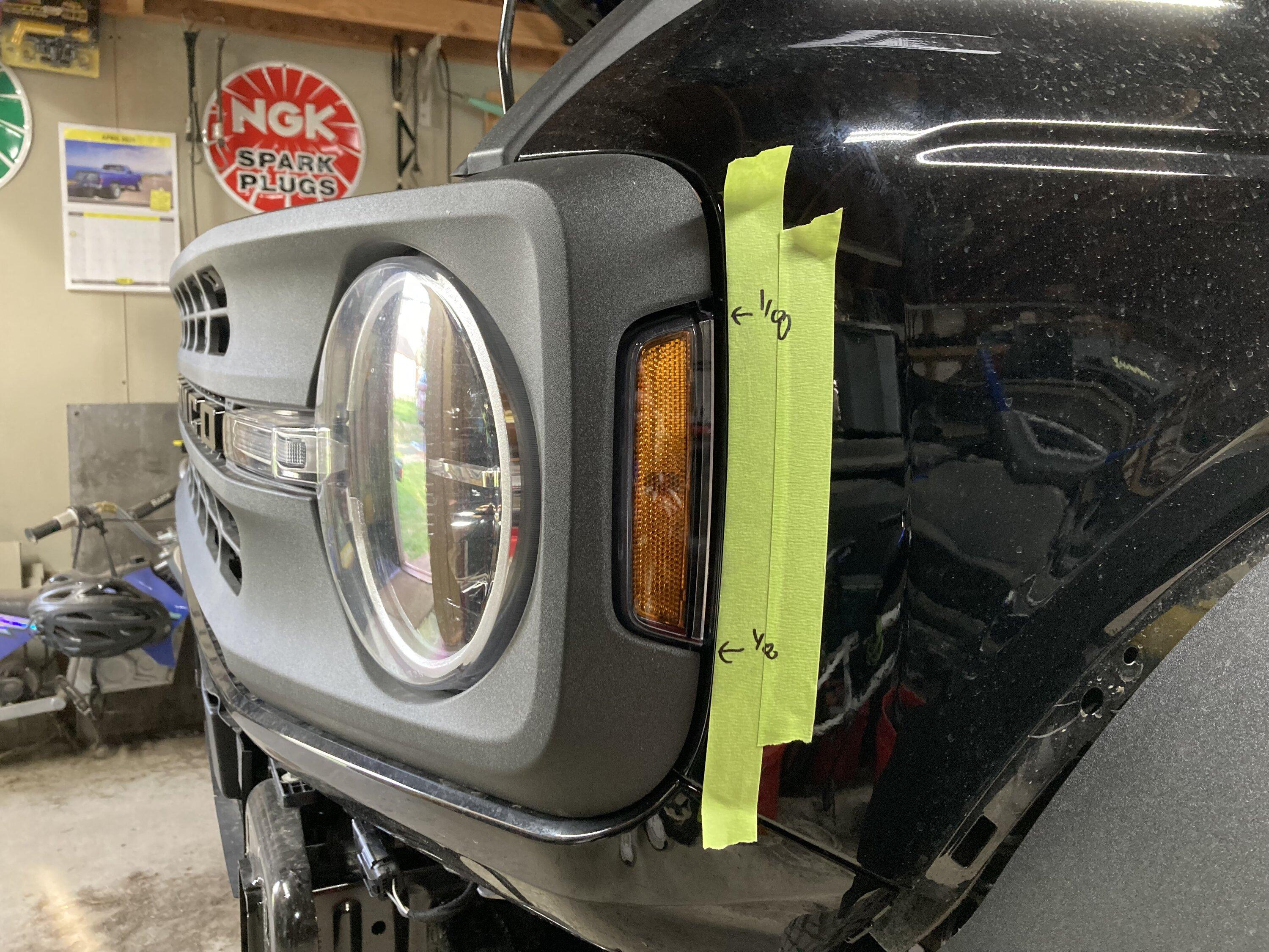

Get your side markers, marked, so when you reinstall the headlights you can get them in the right spot so it lines up with the grille.

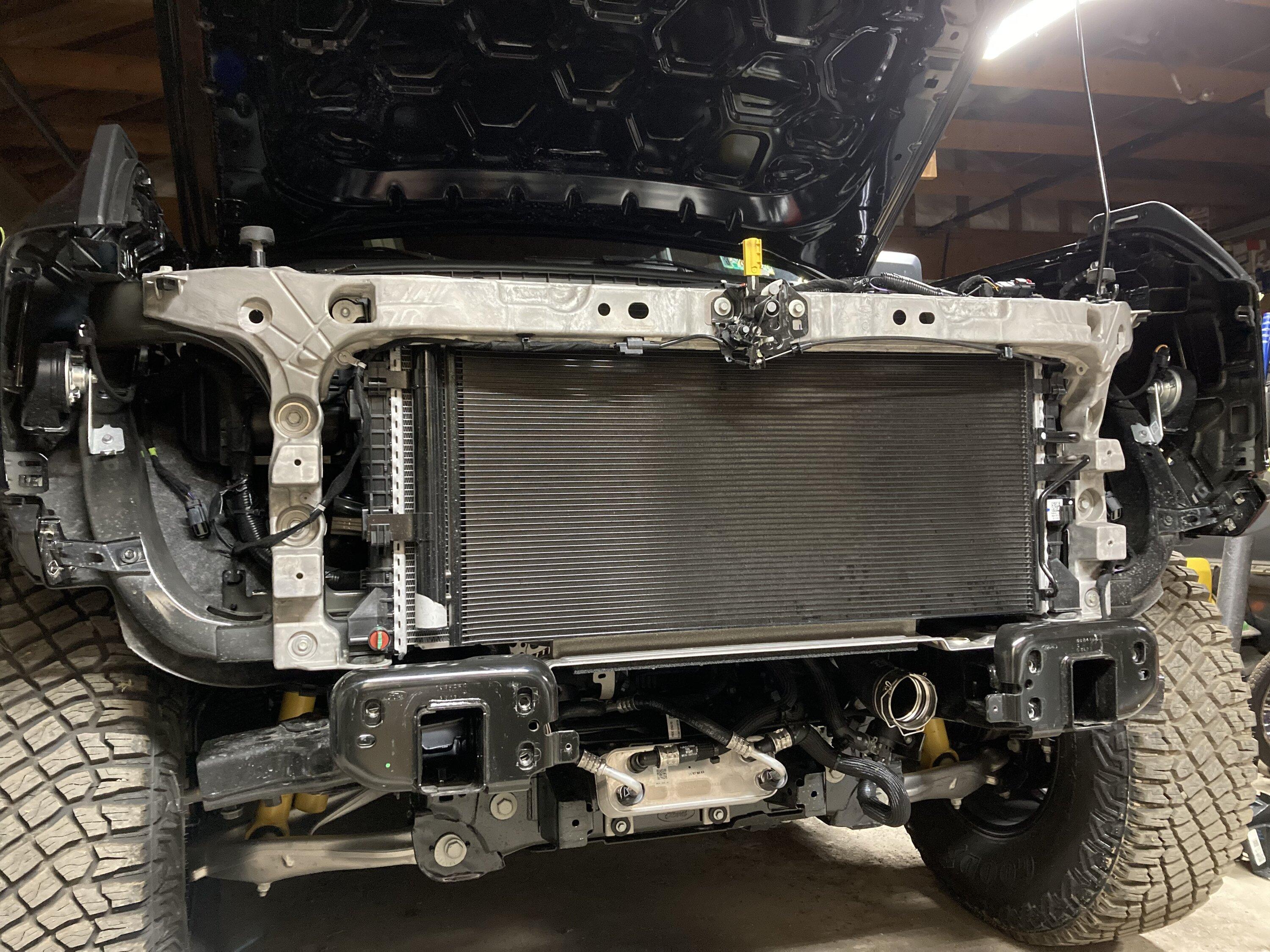

Its not long and you can have it naked.
BIG pile of plastic by the time your done. :ROFLMAO:

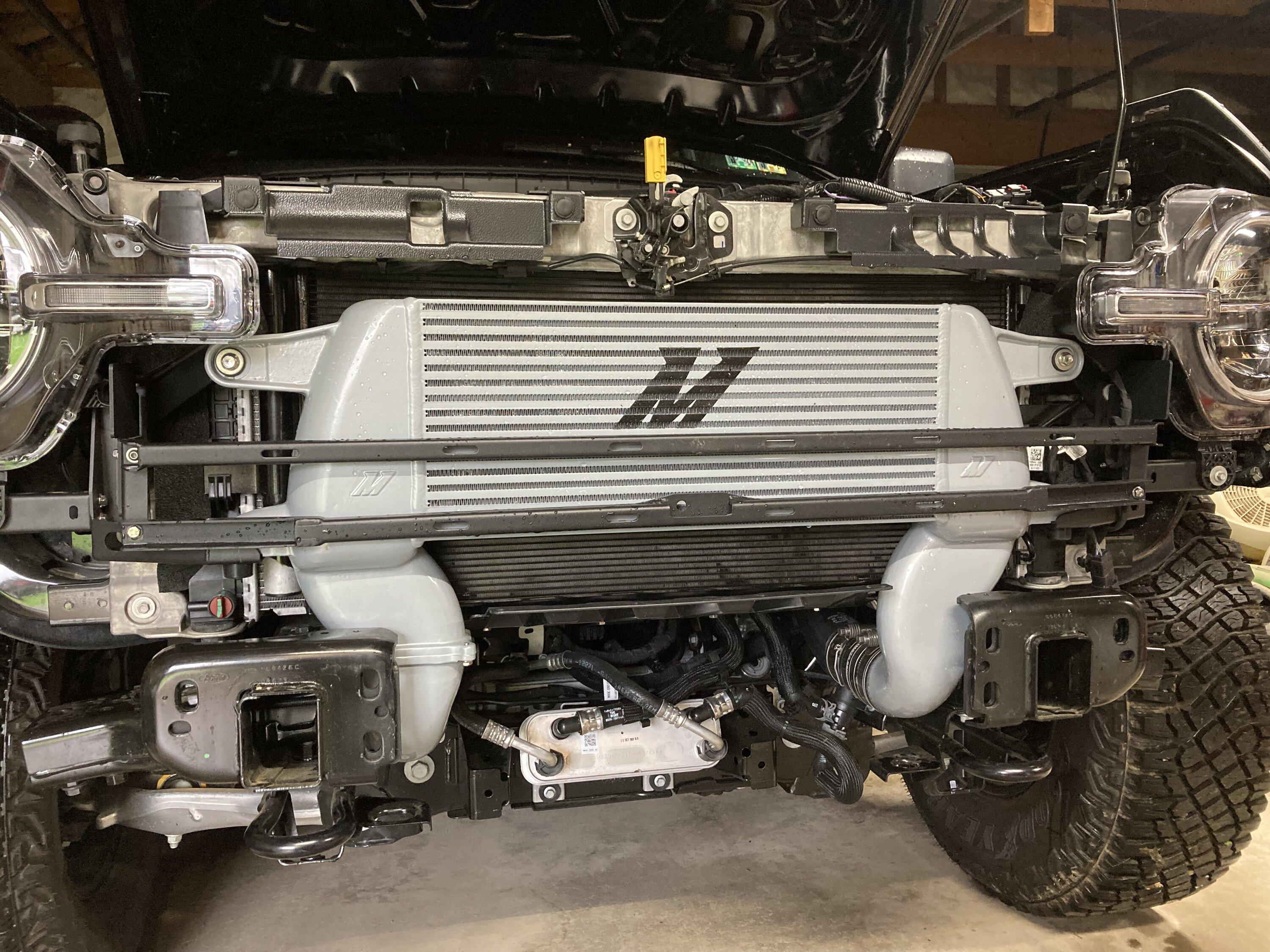

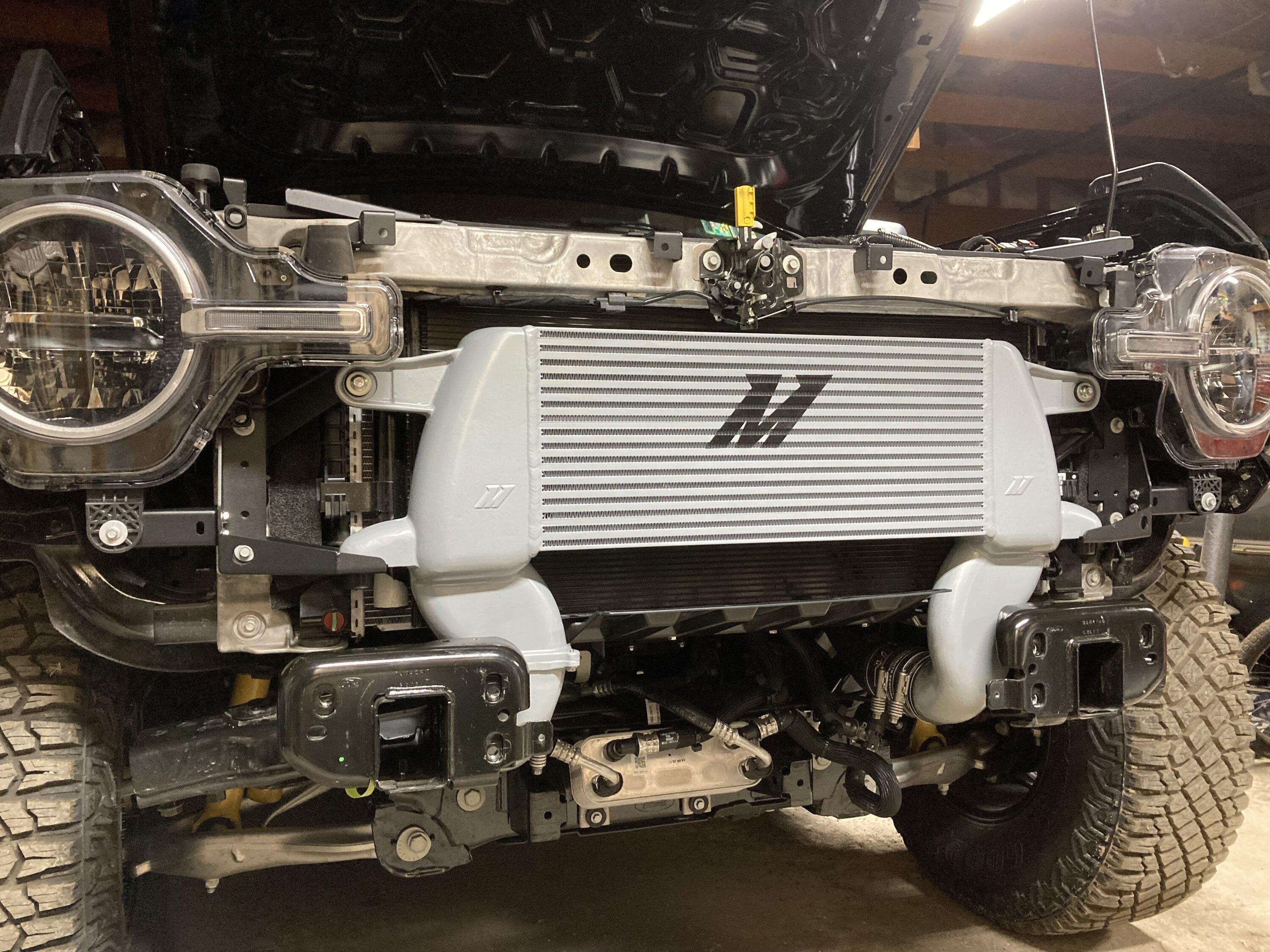

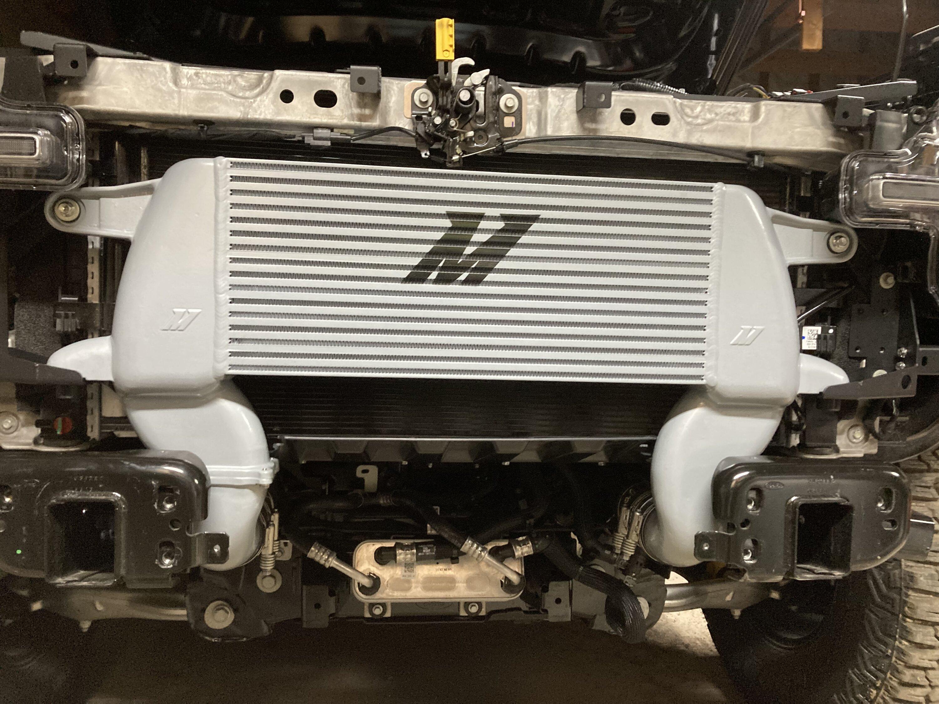

Once naked reassembly is all that is left.
Getting the brackets correct and getting the headlights in the right spot is the hardest but not difficult. Attention to detail is your friend.

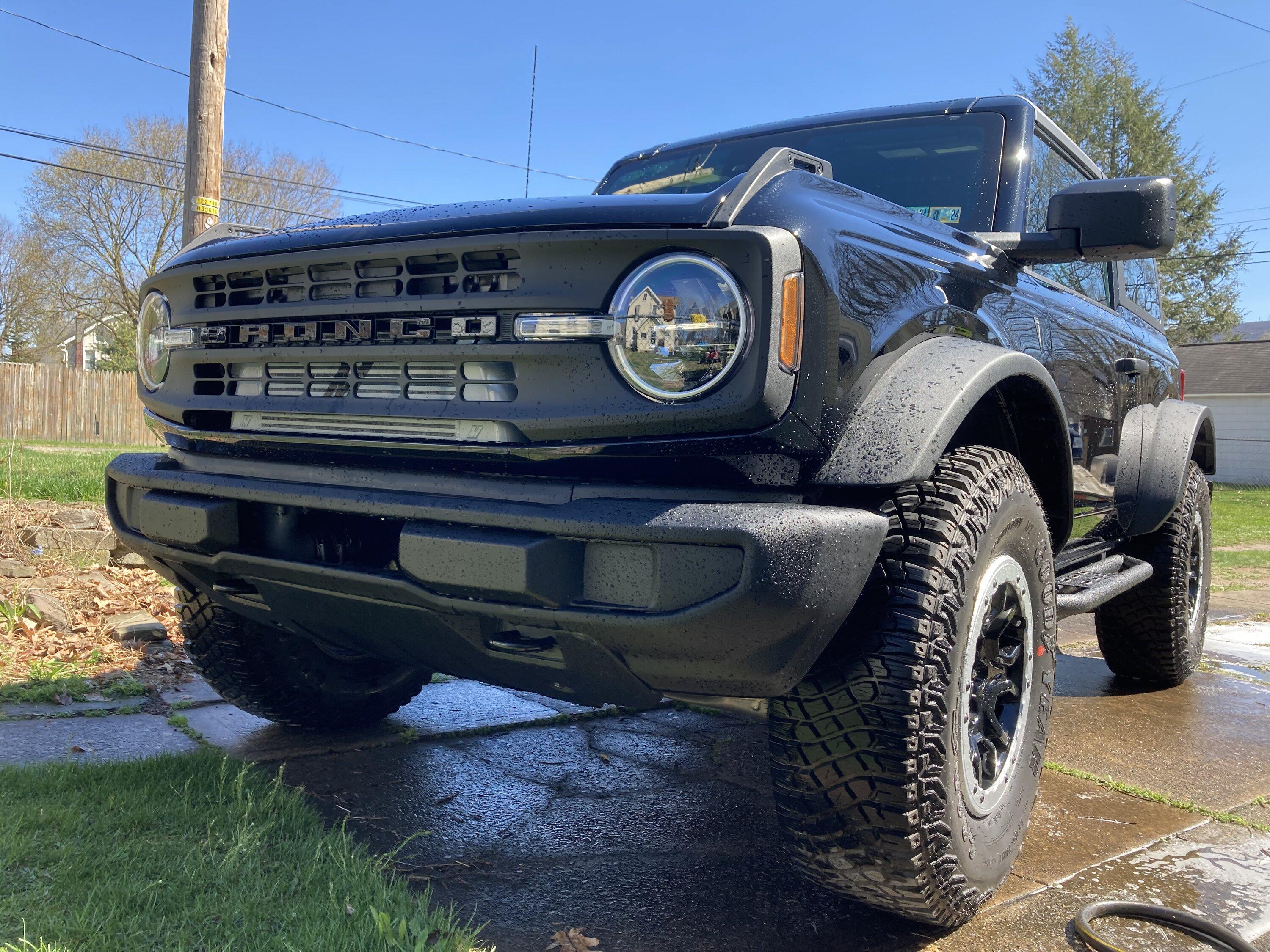

Had enough time left to give a good bath.........

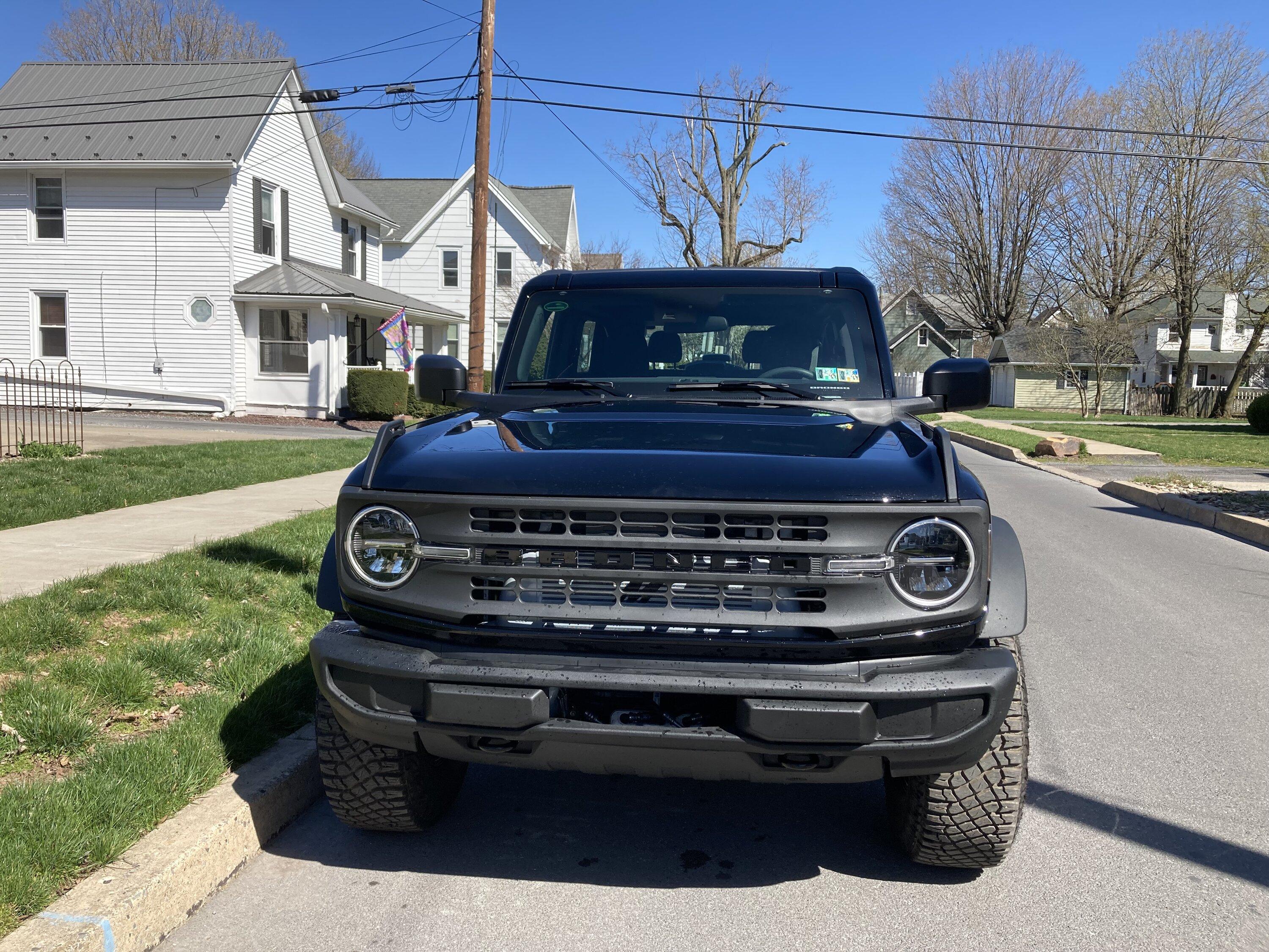

..........Off to Easter dinner......
..........................Still not 200 miles. NO check engine light. Runs like a champ !!! ;)
Ford Bronco The "Baus" Bronc IMG_0504
The only drawback was I did not get a chance to cut off the IC's shutter tabs to check the winch but from what I did see it will come together nicely. Next couple of days I will update with some pics of the winch and bumper mocked up, just ran out of time today. :(

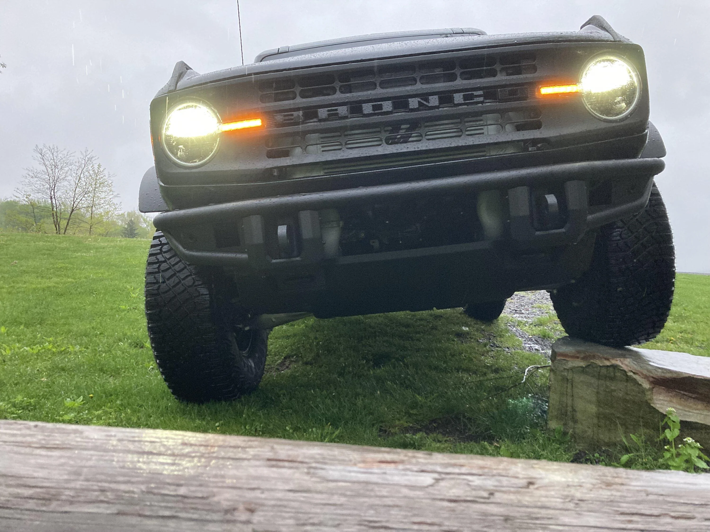

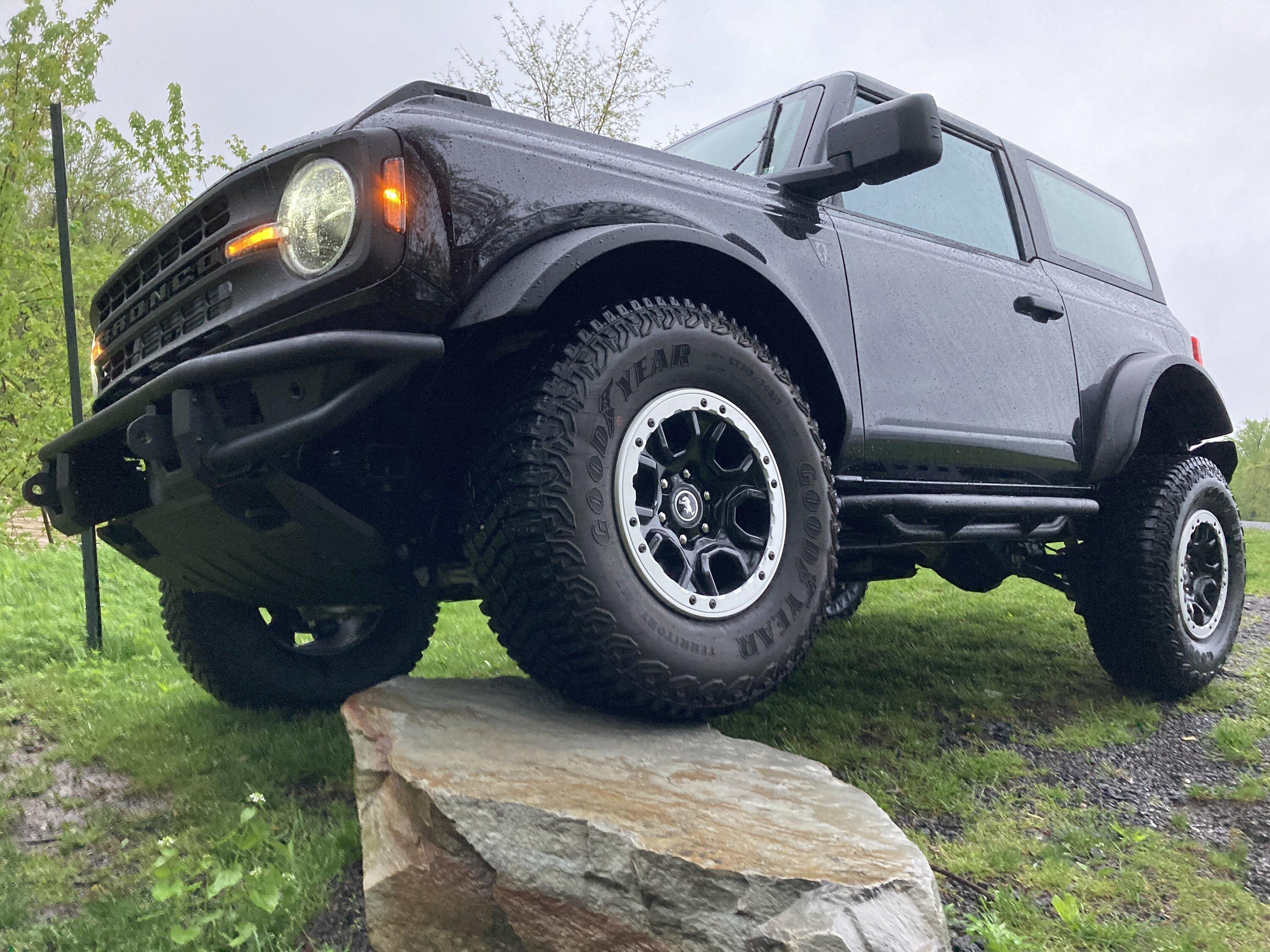

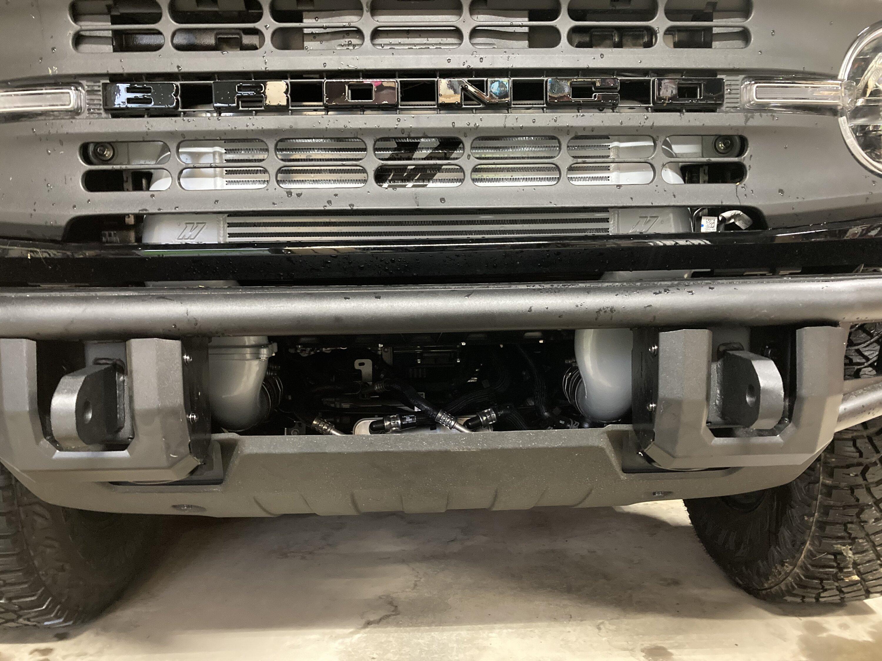

Hard to believe it has been a month since my IC install. 🤪 I thought I would have the winch mounted by now but I don't get much time to work on the Bronc.

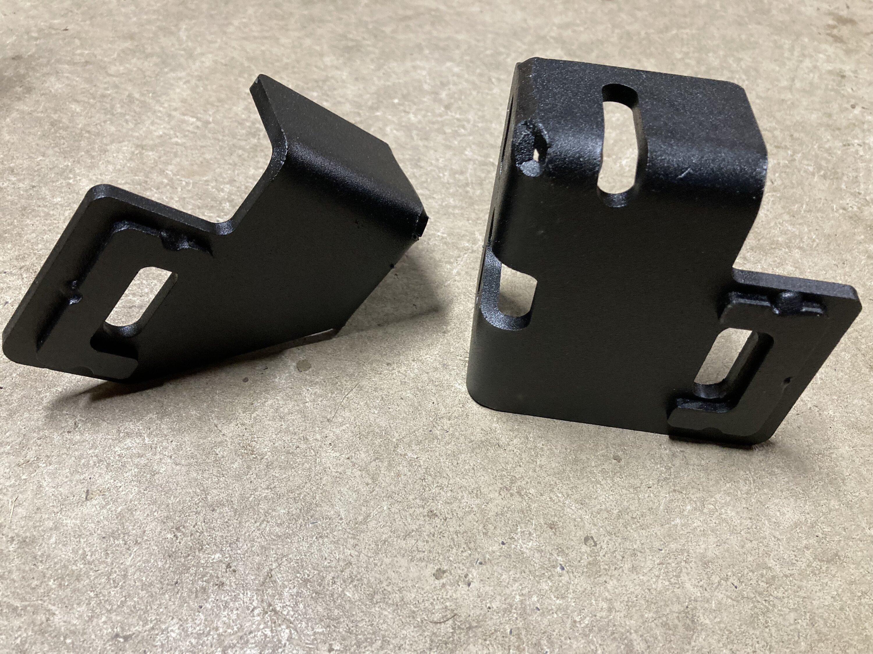

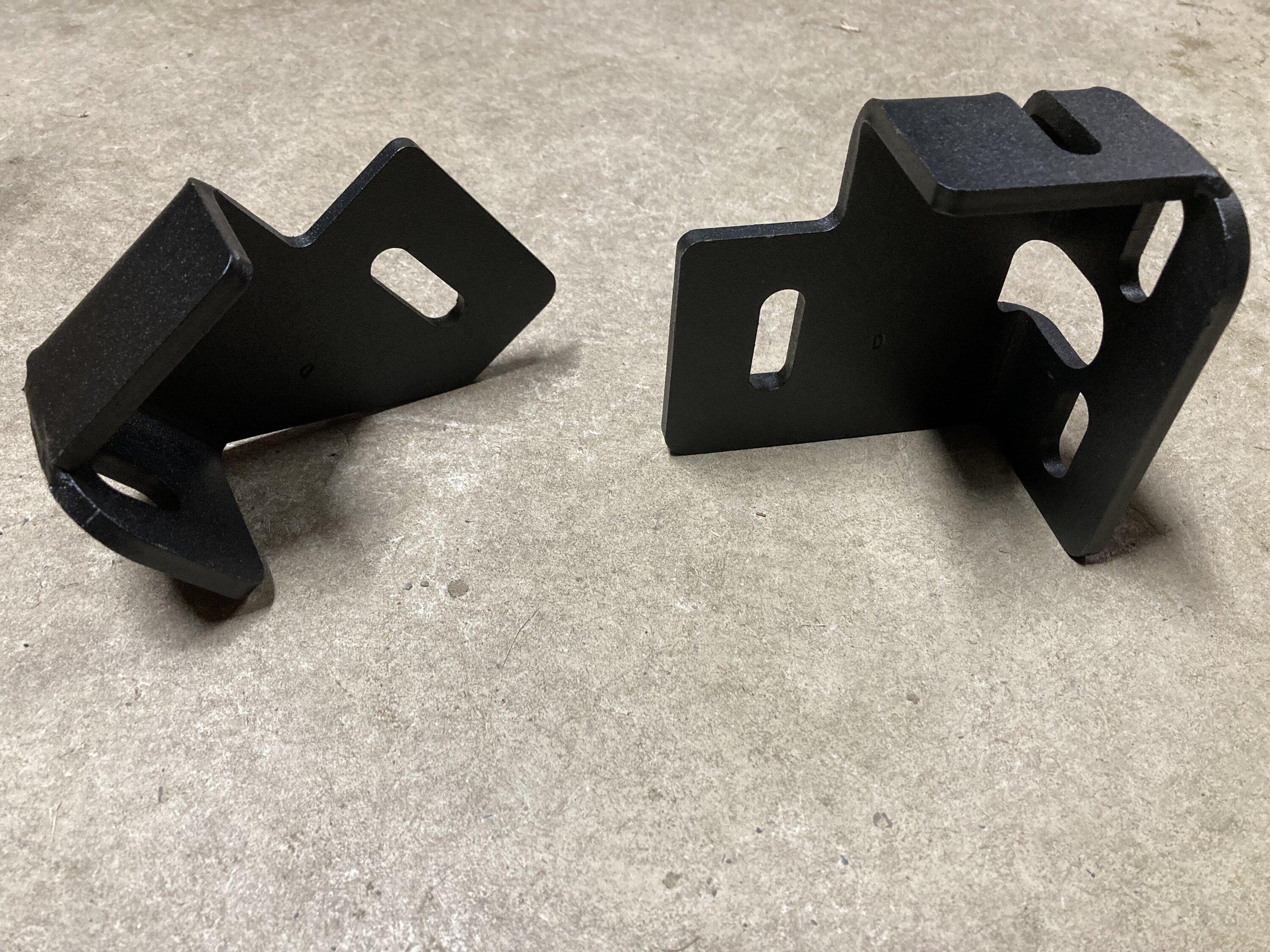

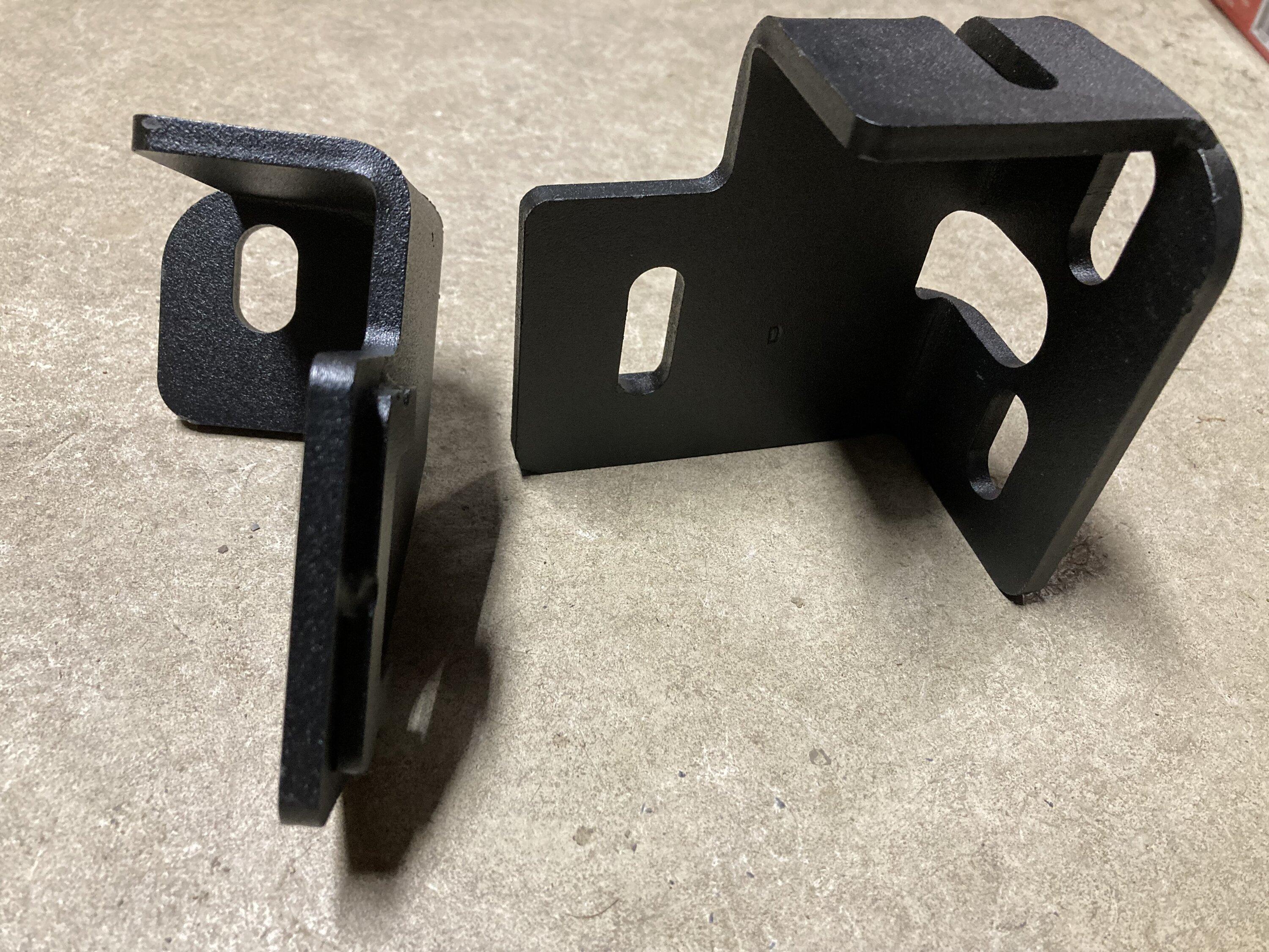

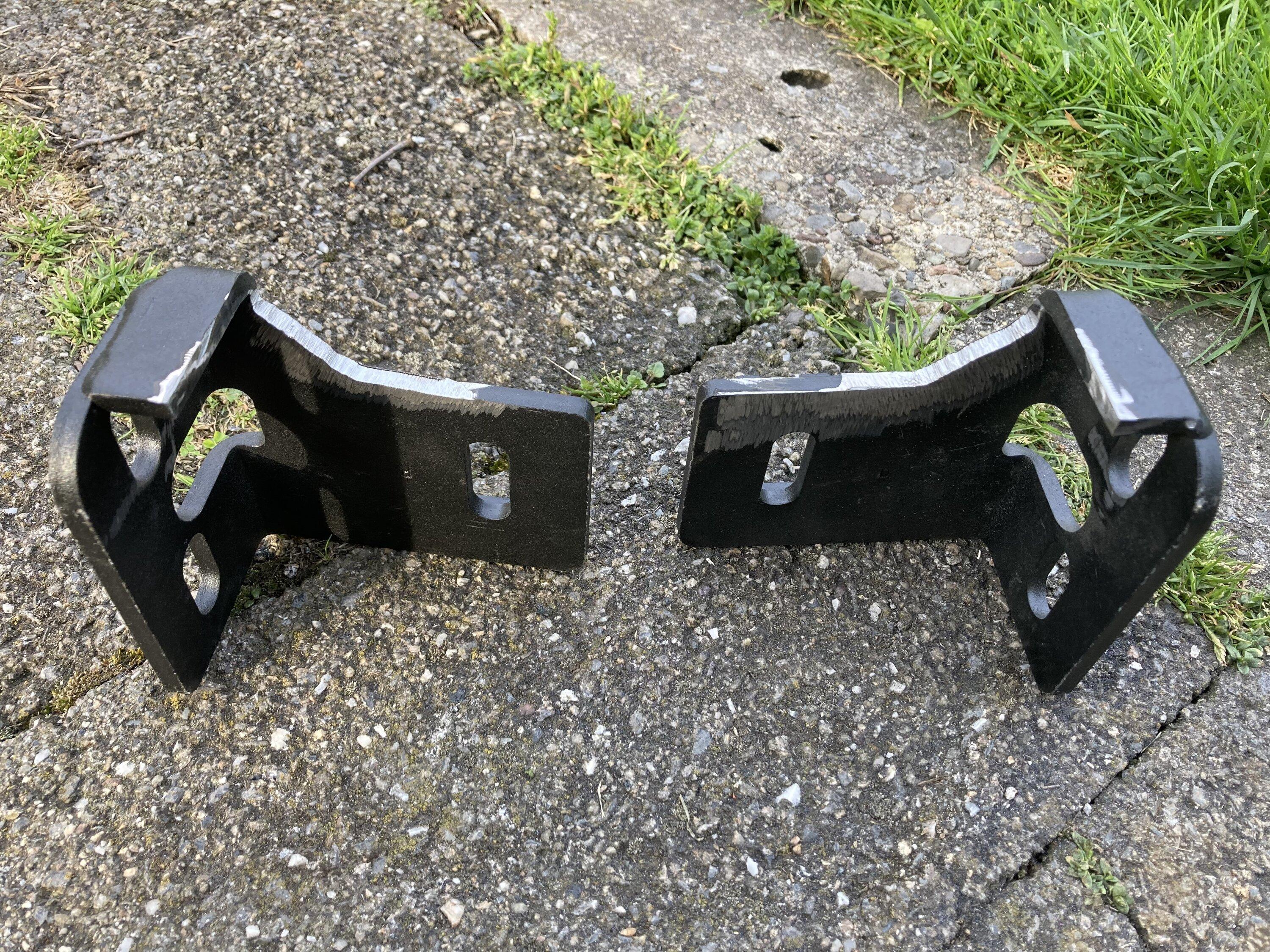

So I went to install my front bumper now that my IC is on so I can get my winch mounted and found out my cheap ass bumper has some pretty solid brackets to reinforce the factory bumper pads.

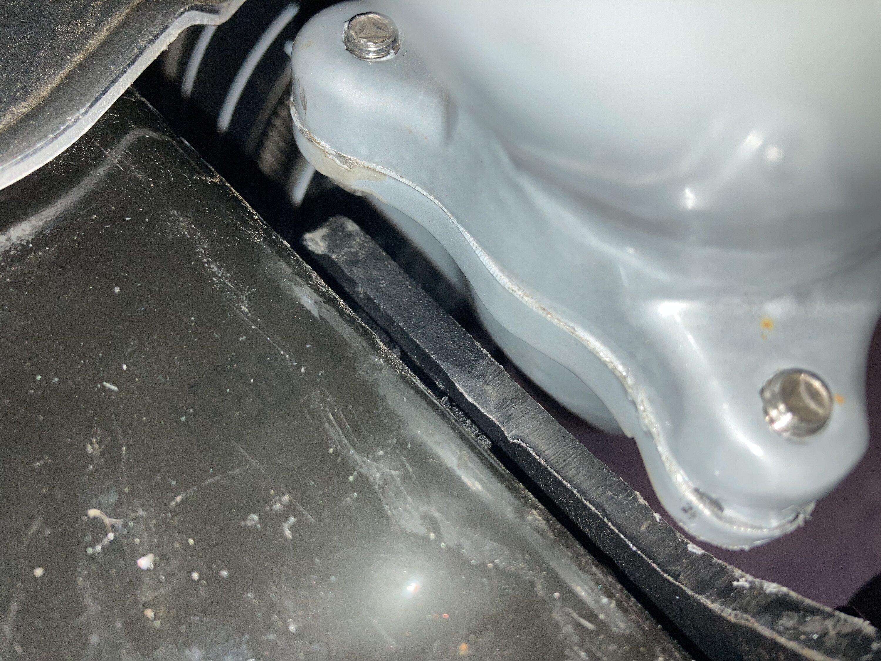

And of course, typical for me, I could not find a way to get these on without removing the IC from it's mounts. So I proceeded to tear it all back down to get the IC "loose" enough to get the bumper brackets on. Mine use a bolt tough the frame and not individual bolts like the LOD brackets. But first I had to trim the inner brackets so they would clear the IC.

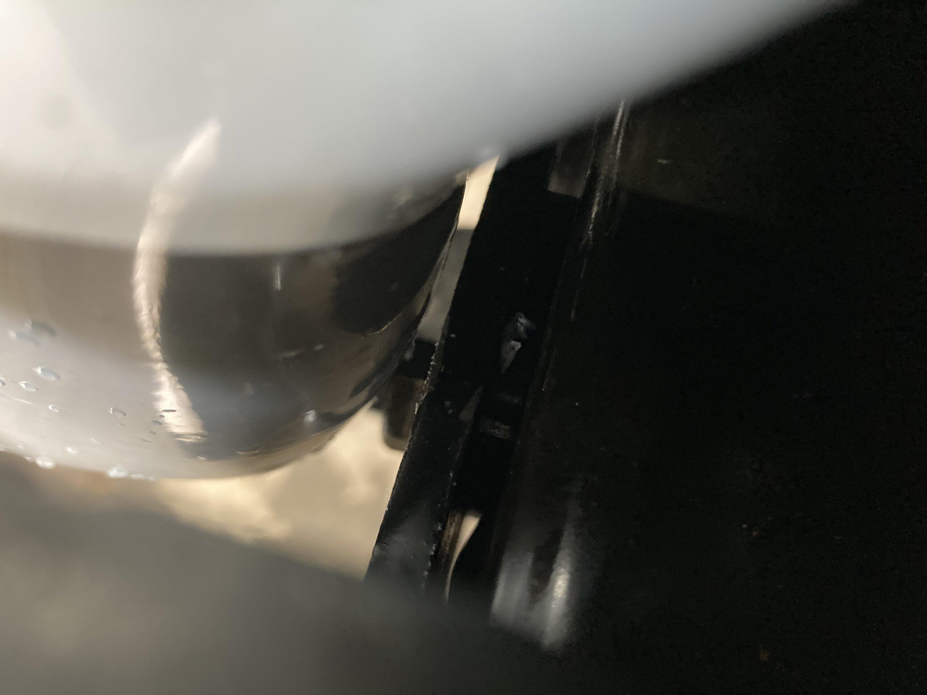

And boy let me tell you what ........... it is tight!!!!!! I had to use some swivels and twist things the right way but I got the 4 bolts in without cross threading them. But it all fits. 😁
I was going to do an inside frame mount for my winch but now that is a no-go so I am working on the outside mount now. :unsure:
Looks kinda funny with a big hole in the middle. 🙃
