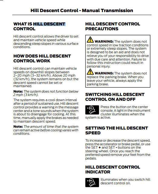

70, 71 & '21 Broncos
Thanks for posting this. I don't think it actually says anything about modulating traction control though, only vehicle speed. And apparently it's only tool for doing that is applying the brakes automatically. Which, as I theorized in a previous post in this thread, isn't a great way to descend hills. You should pick a lower gear, not ride the brakes all the way down. It seems Ford understands that, as it says it will disable the system anyhow if the brakes heat up too much, in which case you have to set down your cup of tea and go back to driving it :) Also note that it states "The system does not control speed in low traction conditions or extremely steep slopes".
Good info though. Just confirms that it's not something I would find useful. Others might.

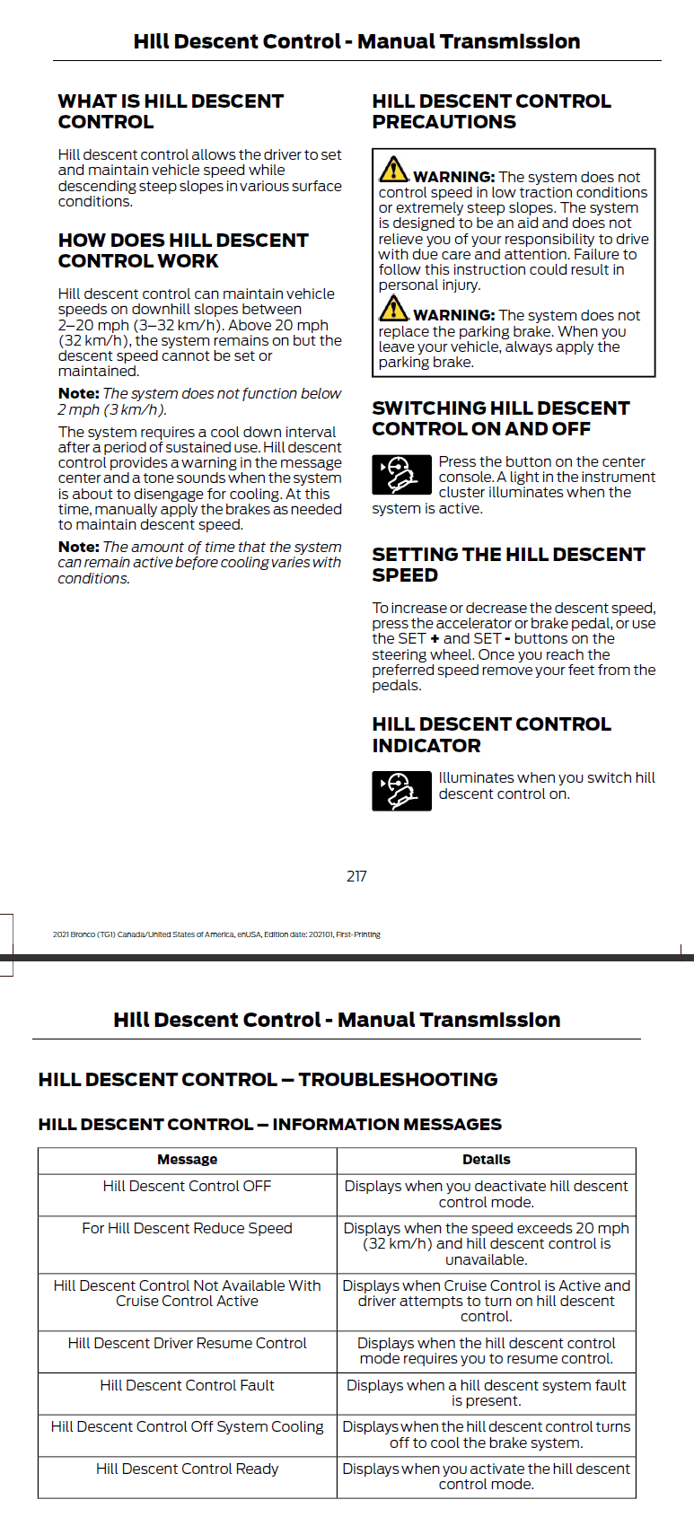

If it is actually modulating the brakes independently in order to manipulate the open diff while descending loose, rocky sections, that is indeed a feature that would be worthy to have (engine braking already happens, and applying brake or throttle just to slow down or speed you up is superfluous). Finally a good answer to this question. Does it explain this in the manual?
One caveat, differential braking cannot occur if all of the lockers are engaged.
Owner's manual page.

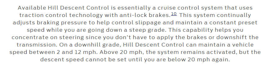

Ford Promotional info:
