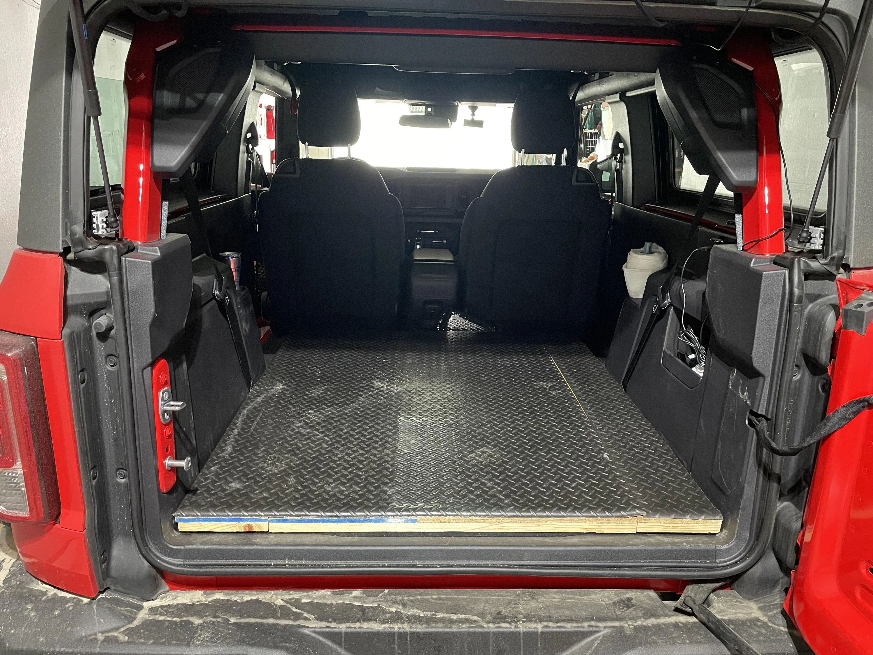

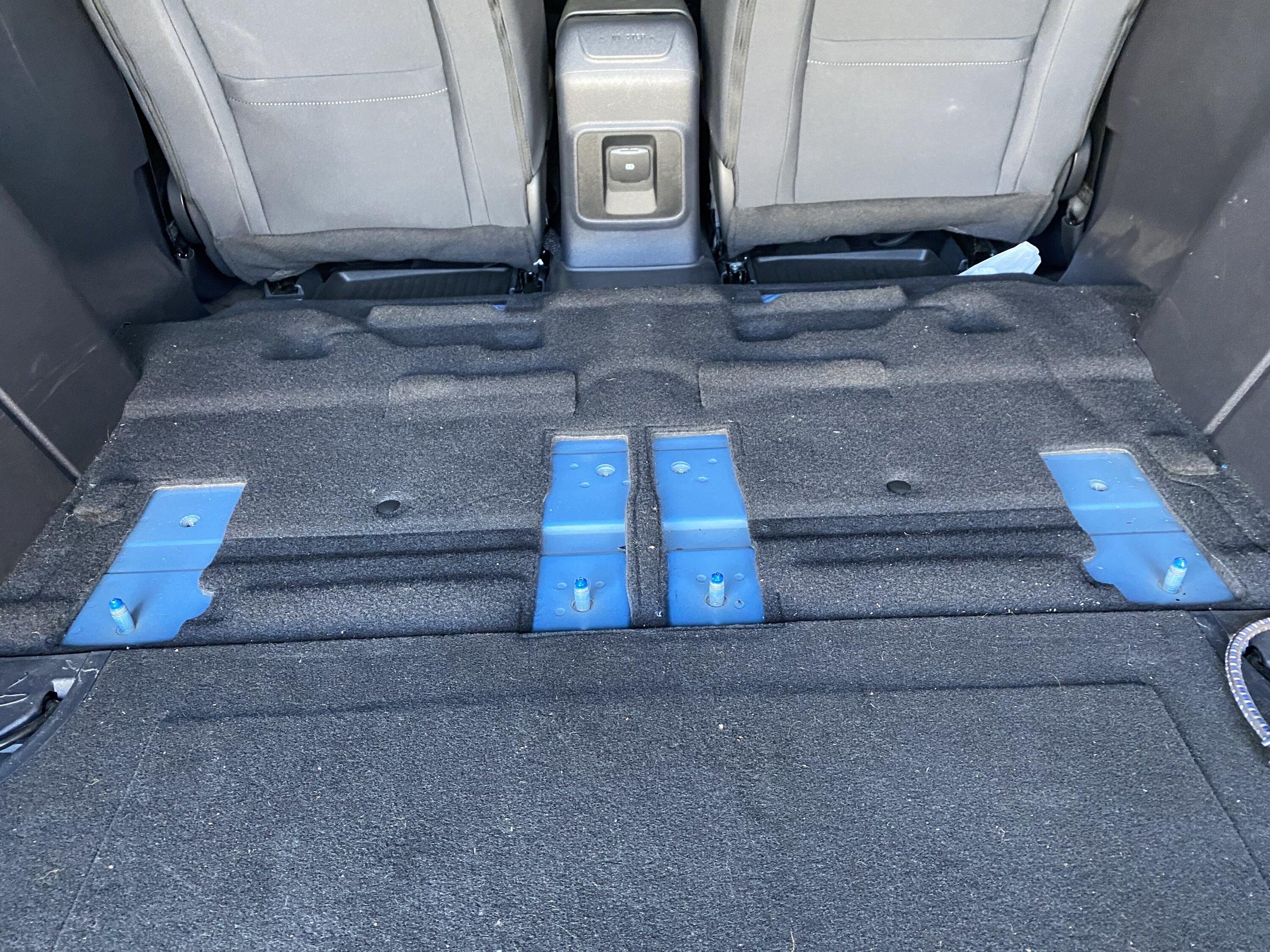

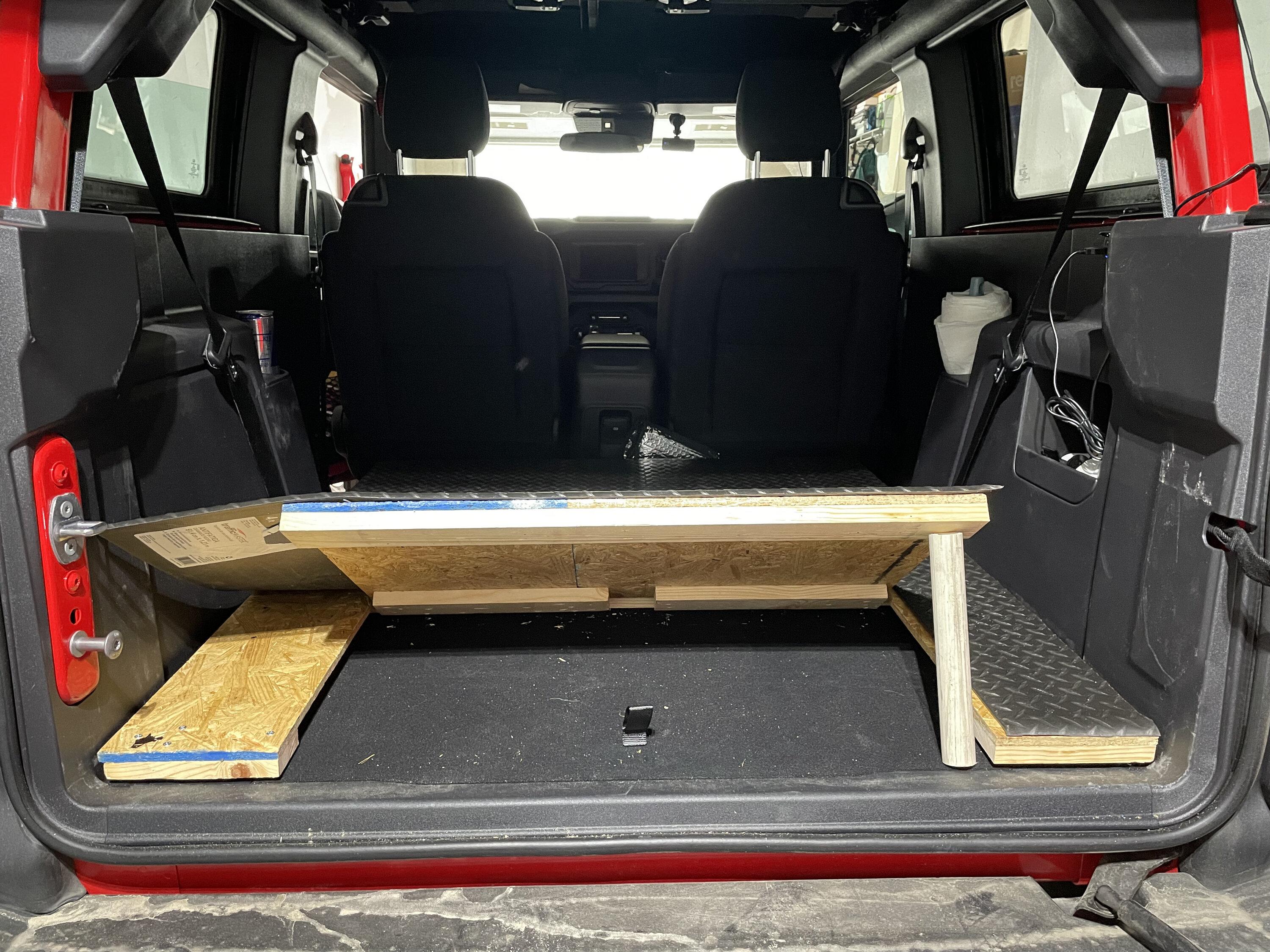

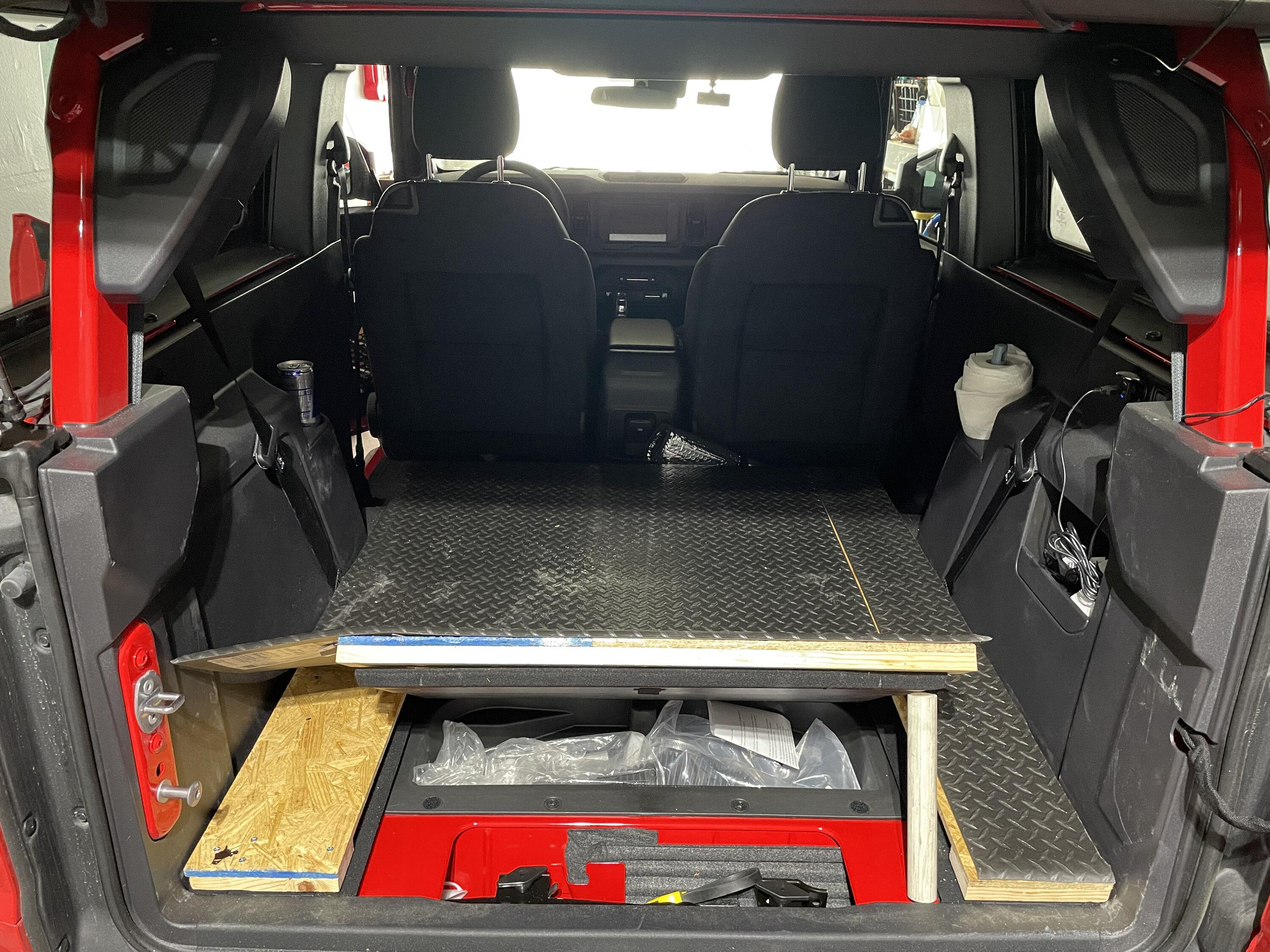

I use the rear seats folded down more often than I have anyone in the back seat so I figured I would take them out. Used a piece of plywood I bought and had cut at Home Depot as the base, used 4'x3"x2" pieces to reinforce the base and allow room underneath so the board doesn't rub on the bolts that stick out. Added a foam mat that I stuck on top and secured it in place with 3M double sided molding tape so it doesn't slide around. I also added hooks that aren't in these pictures so I can tie cargo down with tie-downs and bungee chords. I added a hinge and cut out the area to access the tire changing gear and tiny cargo area underneath where I keep the spare tie rods. I was going to get the goose gear rear seat delete but all the parts were pretty expensive and I feel I didn't need it to be that fancy. I figured if other people have done it (definitely better than mine) then I could do it since I had the tools (drill, driver, circular saw). Everything cost me about $100. Just useful enough to have an area to store snowboards, inflatable paddle board, off-roading gear, camping gear and any other large items that I needed to fit back there from time to time. The plywood did smell so I ended up coating it in a water based polyurethane and that has gotten rid of the odor. I will end up painting that edge in the back so it all matches.

For the seatbelts I just plugged and folded them back in so they don't set off the seatbelt alarm every time I drive. They just barely fit.
The large bolts actually sit between two support pieces that leave enough vertical and horizontal room so they are not pressing or rubbing against the platform.

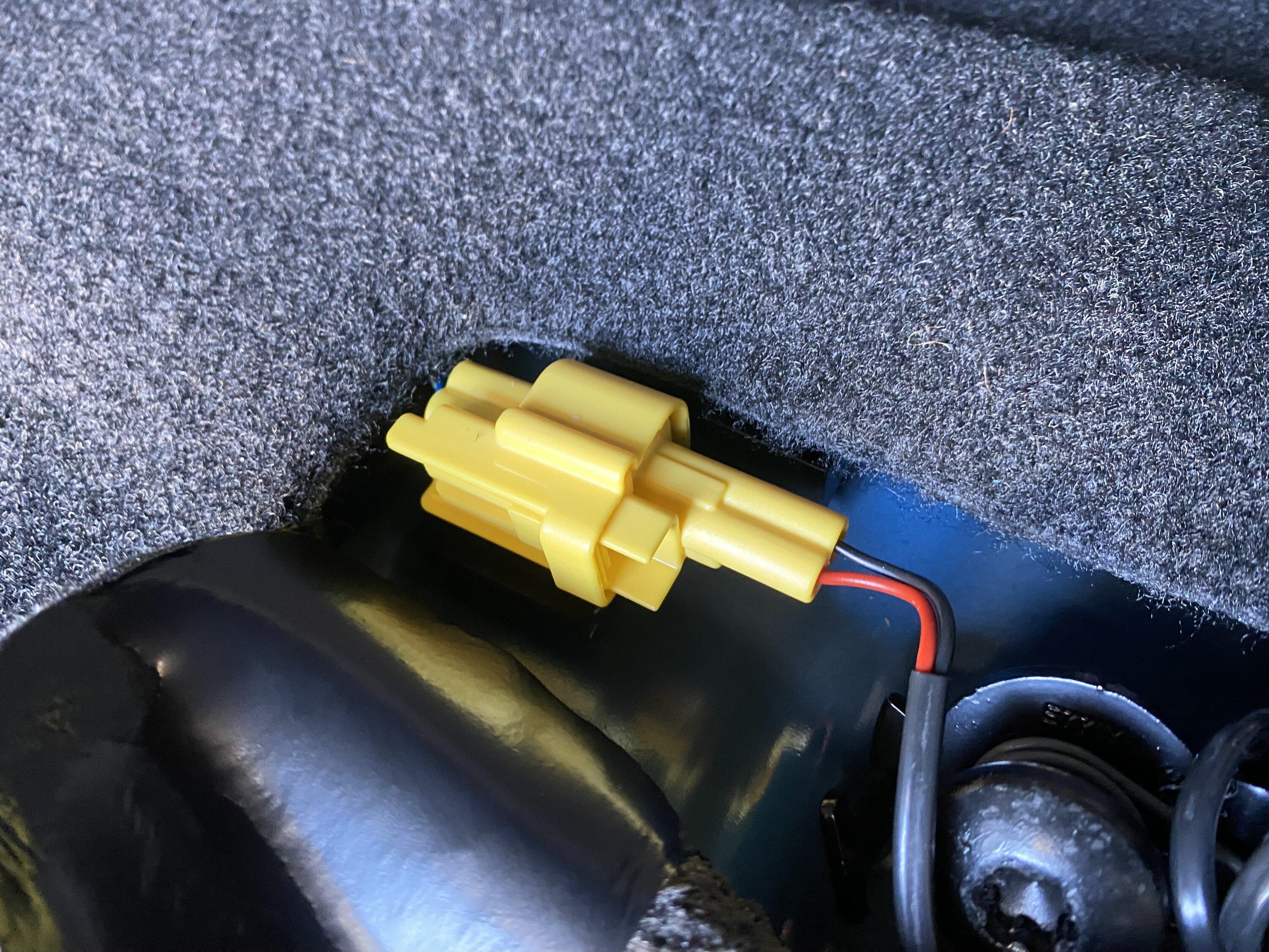

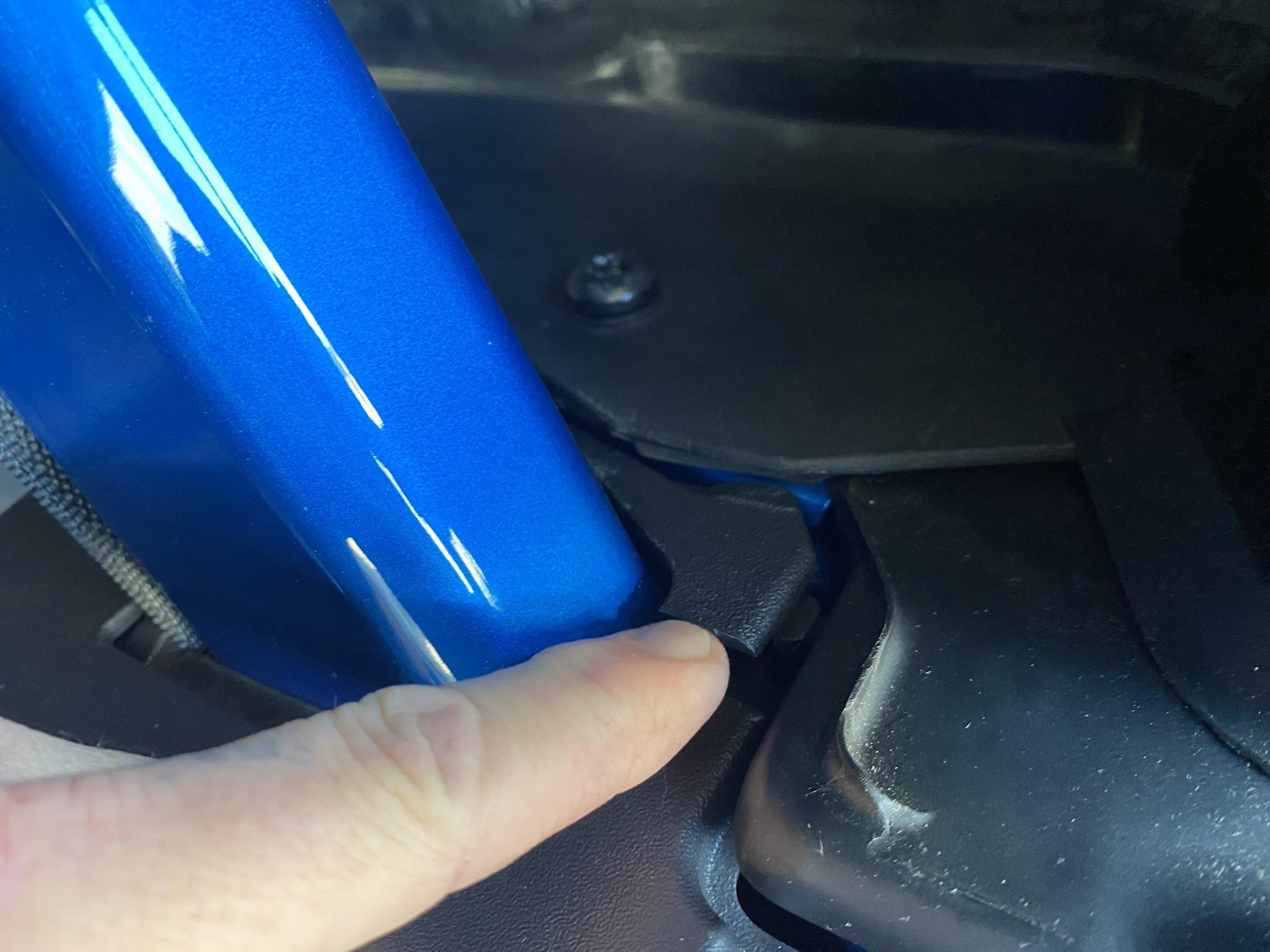

I bought a bunch of 2.4K ohm resistors for six bucks on Amazon. so I’ll let you know how that works out.

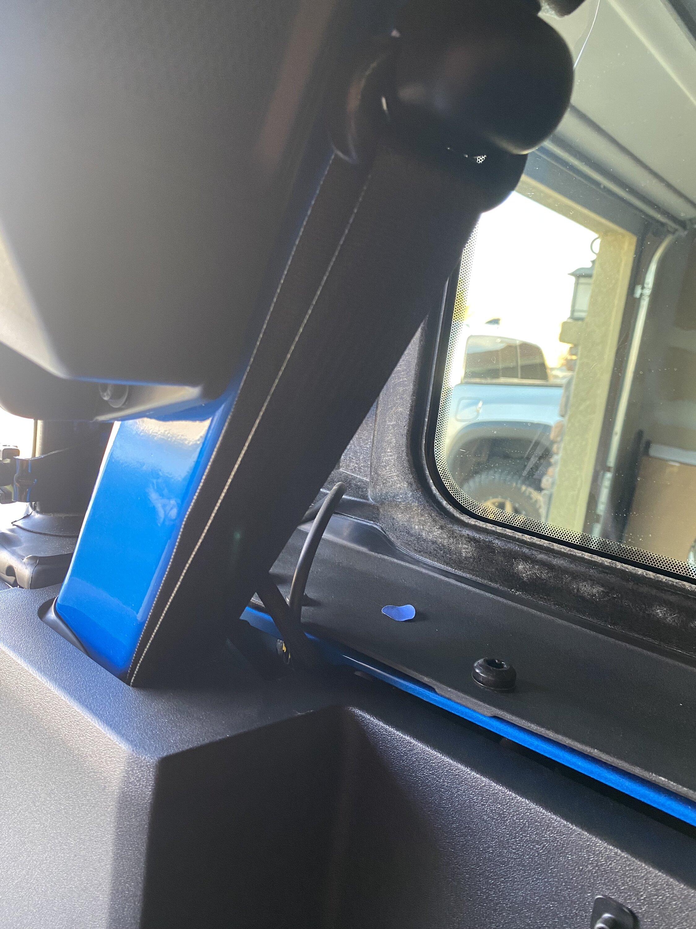

I am going to just plug them in the female end of the plug, unclip them from the floor, and then tuck them behind the side panel.
I already did that for the upper part of the seatbelt where it’s attached to the roll bar.
Just popped the top part of the panel and then rolled it up and tucked inside.
As far as the studs sticking up from the seats, I think I’m just gonna cut them off flush. and then if I need to put the seats back in later, I’ll just drill and tap it for bolts like the front part of the seats.
We will see.

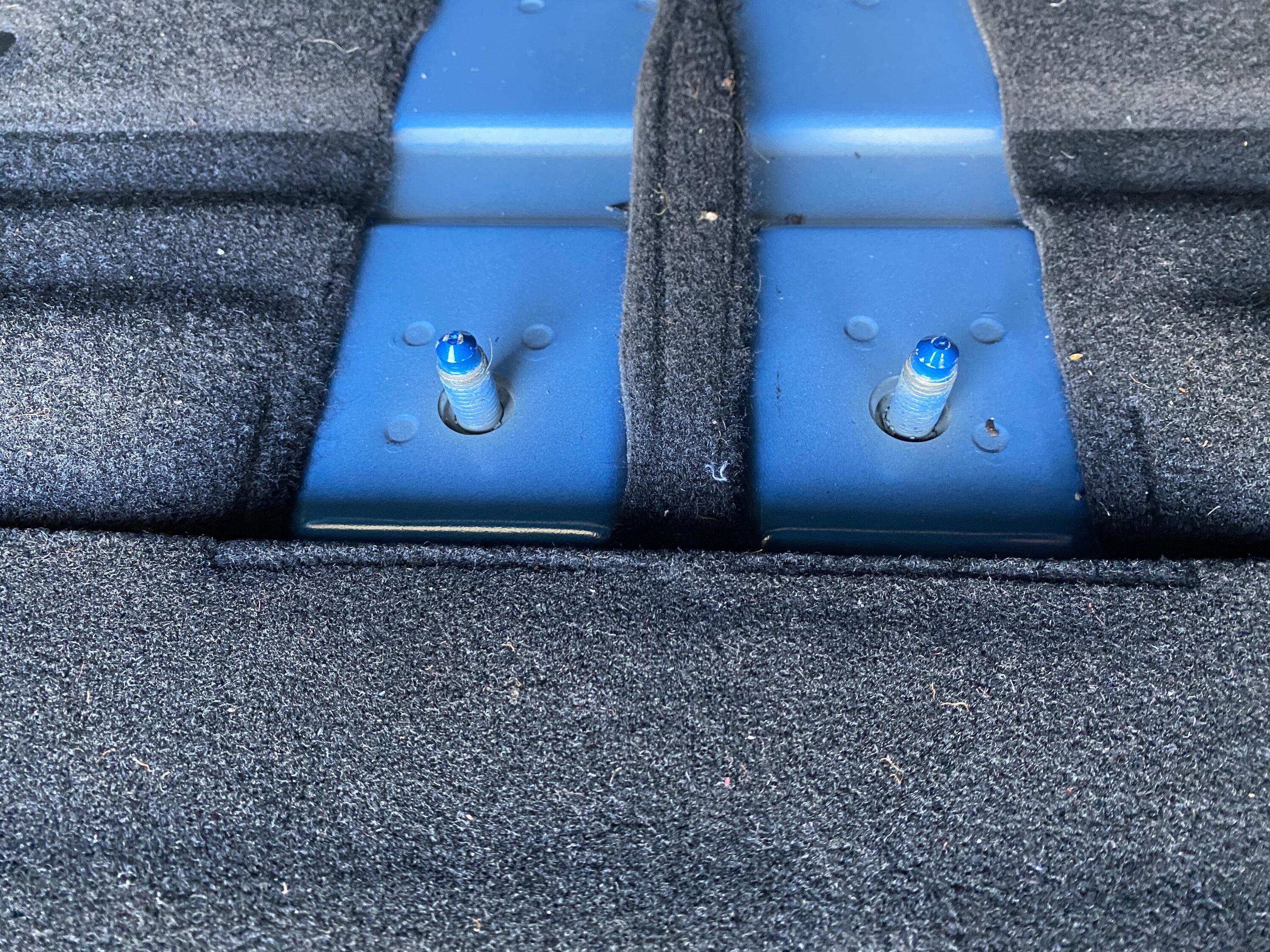

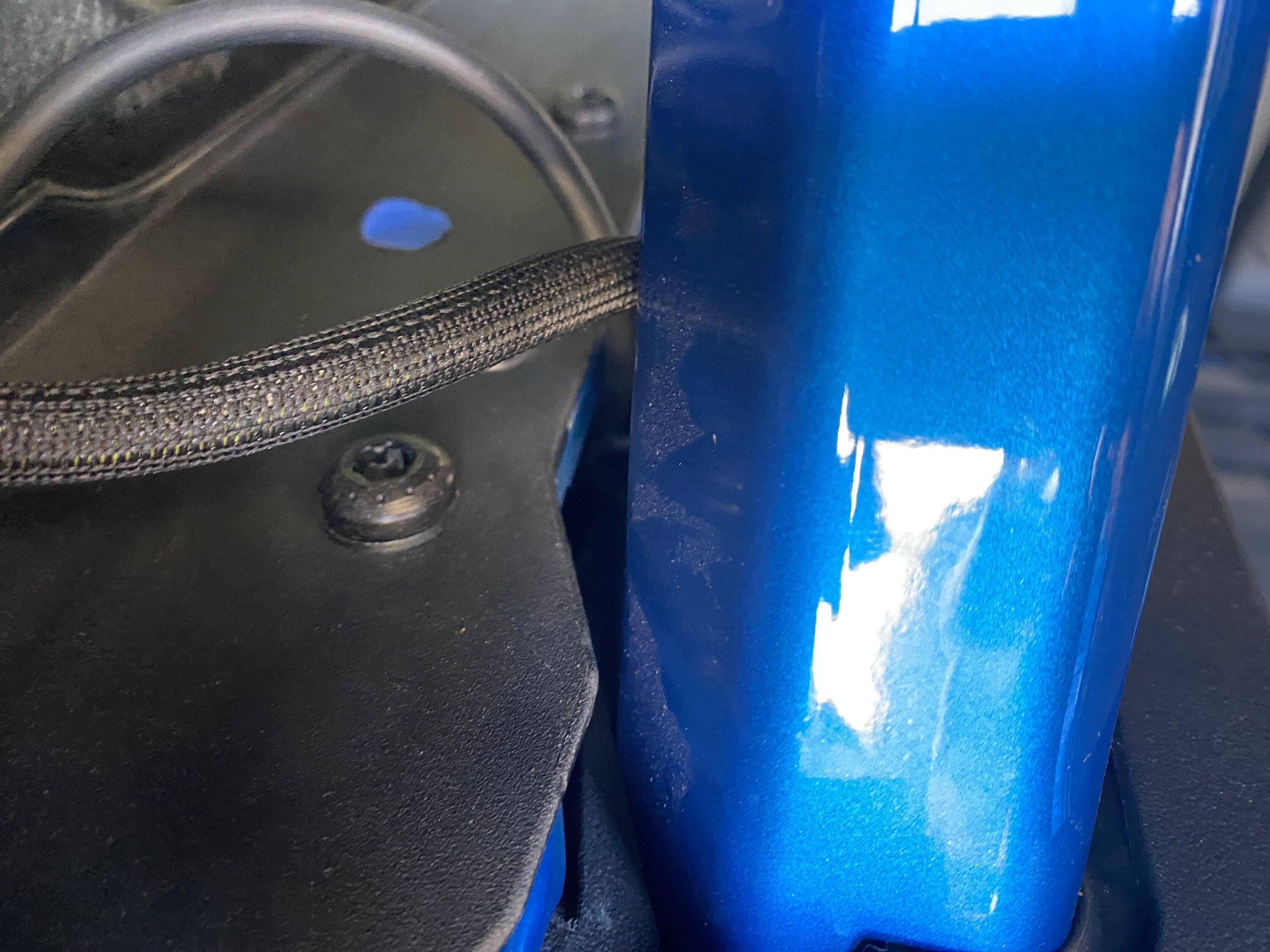

(a couple of things to note, see pictures, the little Spacer behind the rollbar, my fingers pointing at be sure to pop that off first or you lose it behind the panel!
And then the studs I’m talking about cutting flush, and also the female plug everybody’s talking about unclip it from the floor and tuck it behind the side panel with a resistor in it!)
