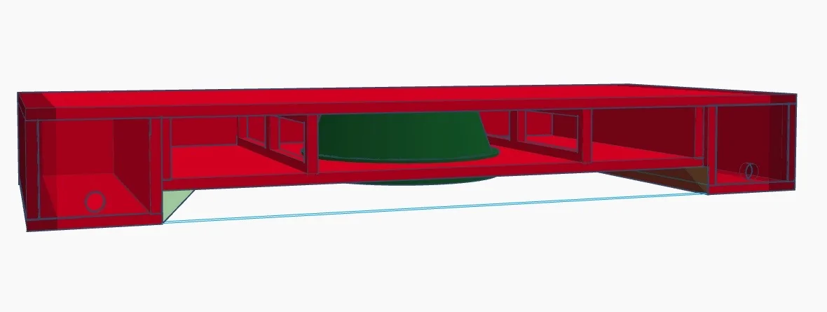

Now for the fun part, the subwoofer enclosure. I spent a couple of weeks designing this enclosure using Tinkercad, and I decided to go with half inch birch plywood instead of three-quarter inch MDF. I wanted to see what kind of performance the half inch birch would give me and at the same time yield an enclosure half the weight.
Why did I design this particular enclosure? I didn’t want a typical box taking up much vertical space, nor did I want something someone could look into the window and see a subwoofer to steal. Therefore, I decided to go with the down firing design. The challenge was to keep the enclosure around the same height as the seats when folded down and at the same time, find a shallow mount sub that would accommodate this while ensuring there is enough clearance for the sub and the airflow coming out the bottom.

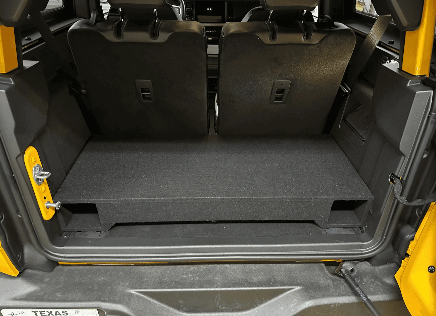

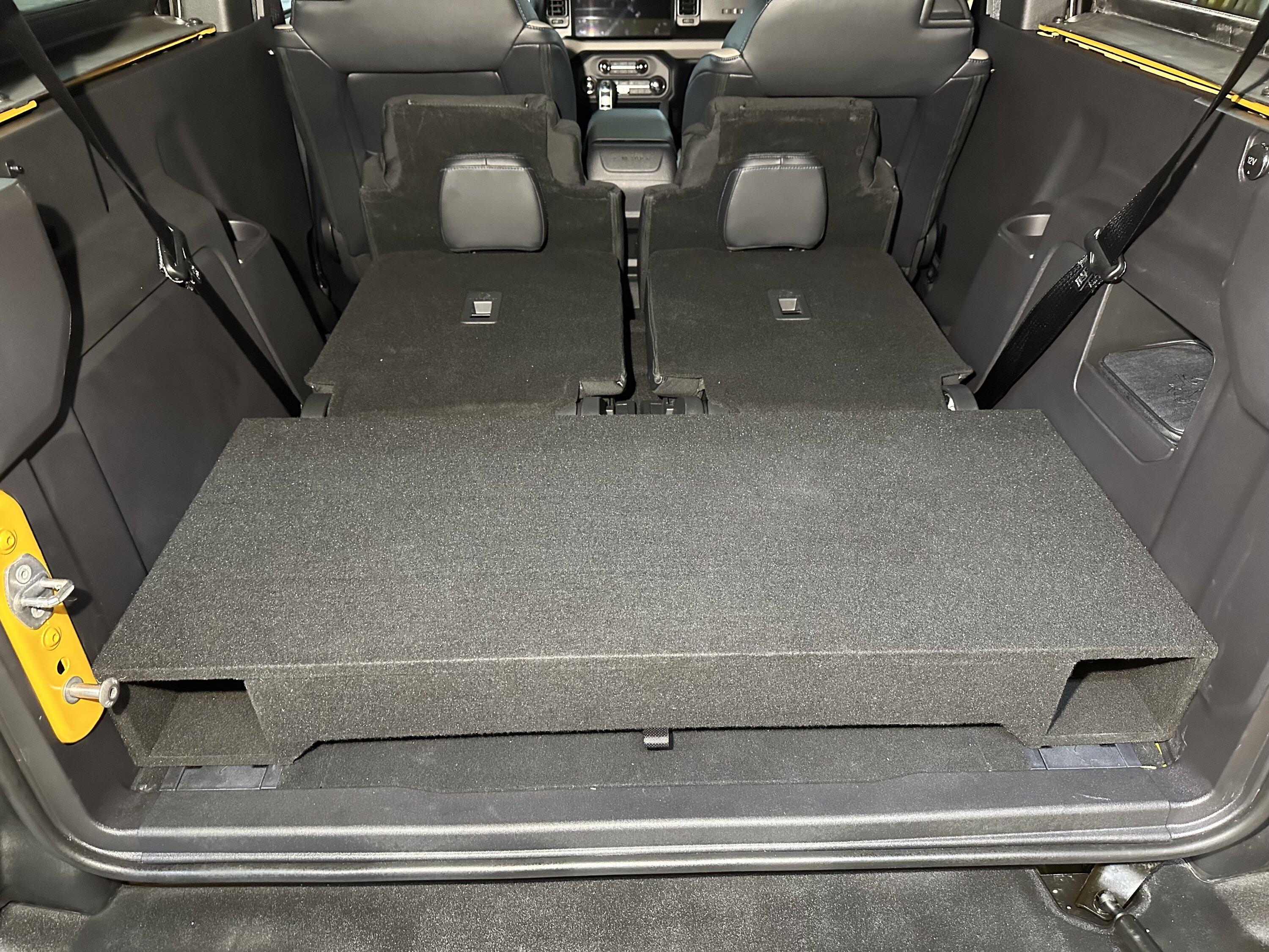

After a couple of weeks of design, I settled on what you see. I put it together, using wood glue, screws, liquid nails, and special gaskets to seal up a 12 inch sub. I decided to go with JL Audio’s TW3 12 inch shallow mount sub, wired it down to 2 ohm. I followed their recommendations of .8 ft.³ of volume, by giving it .9 then subtracted the volume of the braces and sub itself. Science. I found self-adhesive color-matching carpet for the enclosure, wrapped it up and was astonished at how well it fit. Of course I measured a million times and is a reason why it fit like a glove, with one exception. The rear seat mounts get in the way of the back part of the enclosure. To fix it, just use a router to carve that part out, allowing the sub's sound to come out the front as well as the rear. The open slots on each side are simply for storage and have nothing to do with the sound.
The results? Crystal clear bass. Turn it up to level 5 and you have a perfect balance and blend of sound filling the cabin, but turn it up to 15 or more, you feel the air pressure moving you. My neighbor two streets could hear it!! 😏 Country songs kick extremely hard and tight while hip-hop literally feels like air is being sucked out of your lungs. I’ve never had such amazing acoustical success, but I guess in a two door bronco, one can expect such things. I honestly didn’t expect anything near the power and the feel, it’s really amazing. I giggle every time I turn it up.

Here's the design, and cut list.
PDF File: https://www.bronco6g.com/forum/attachments/bronco-box-12-jl-audio-12tw3-d4-pdf.453622/
Ford Bronco Hardest hitting subwoofer enclosure I’ve ever made (w/ design image and cut list) Image 1-23-23 at 8.36 AM
Tinkercad Copy: https://www.tinkercad.com/things/jYcYAT8yeg5?sharecode=dikVLvVWAKdxF2TbDtn-TGnIP87V2l5aDtuae_EqHuA

Birch is actually considered better but MDF is cheaper so most people use it. Great job, looks great, I assume it's downfiring into that little slot in the middle?

Looks great, is the enclosure bolted down?

Thanks - saving any vertical space was paramount, hence the 1/2" birch. There are braces built inside. And yes, down fires from the absolute center.

I plan to bolt it somehow to the rear seat, via a hinge of some sort. Still want to access the storage compartment.

Looks great! You think a trunk mat would fit and make it disappear?

Not too sure. If the mat is deeper than 17 1/2", then I don't think it would be good.
