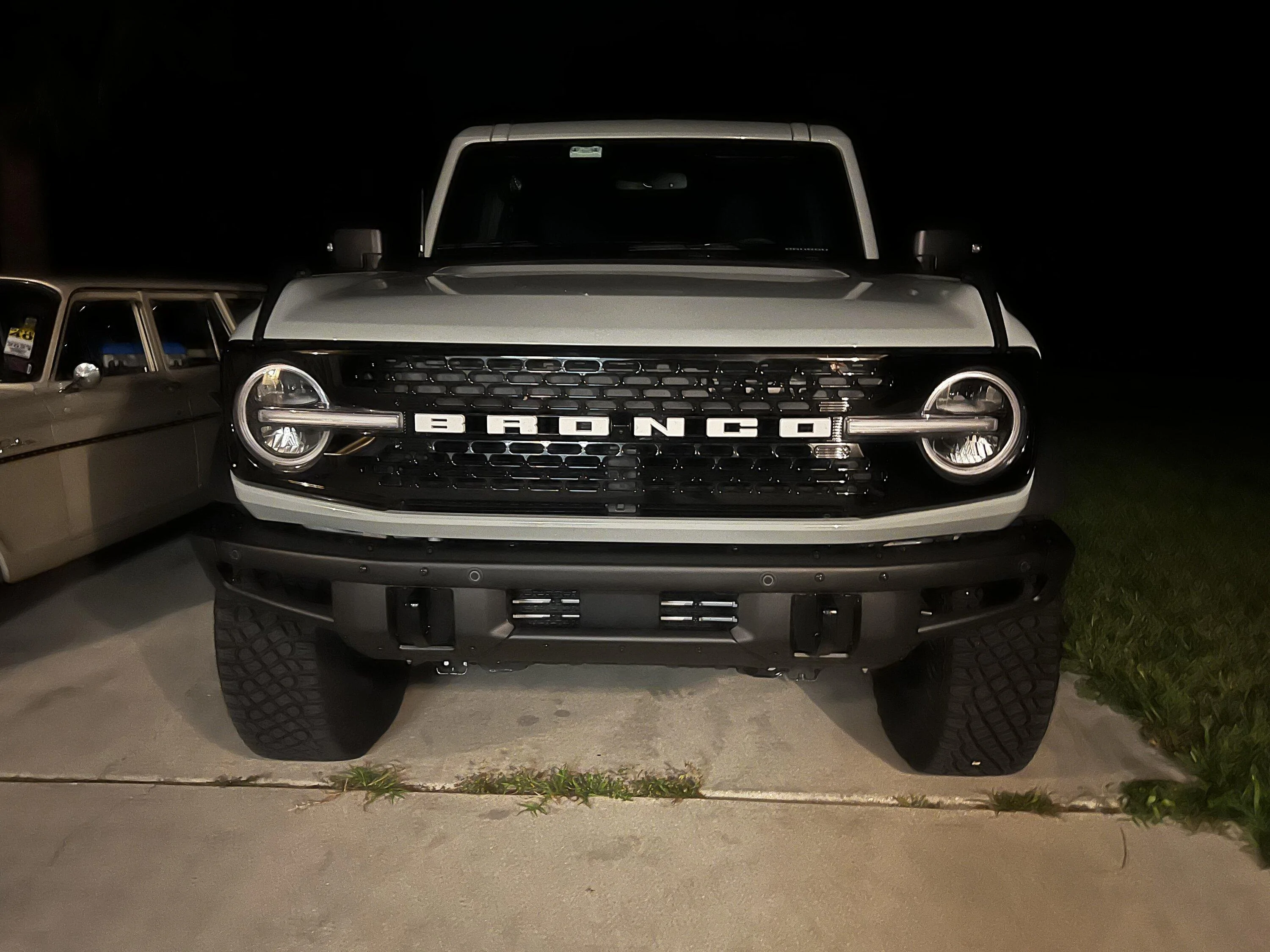

Took delivery of my Bronco on 7/18. In a little over a month, it now has around 2600 miles on the odometer. So far I'm really enjoying it. Just installed a leveling kit (not pictured), and put a modular (factory) bumper on it. Next up, running boards, window tint, skid plates, and fog lights.

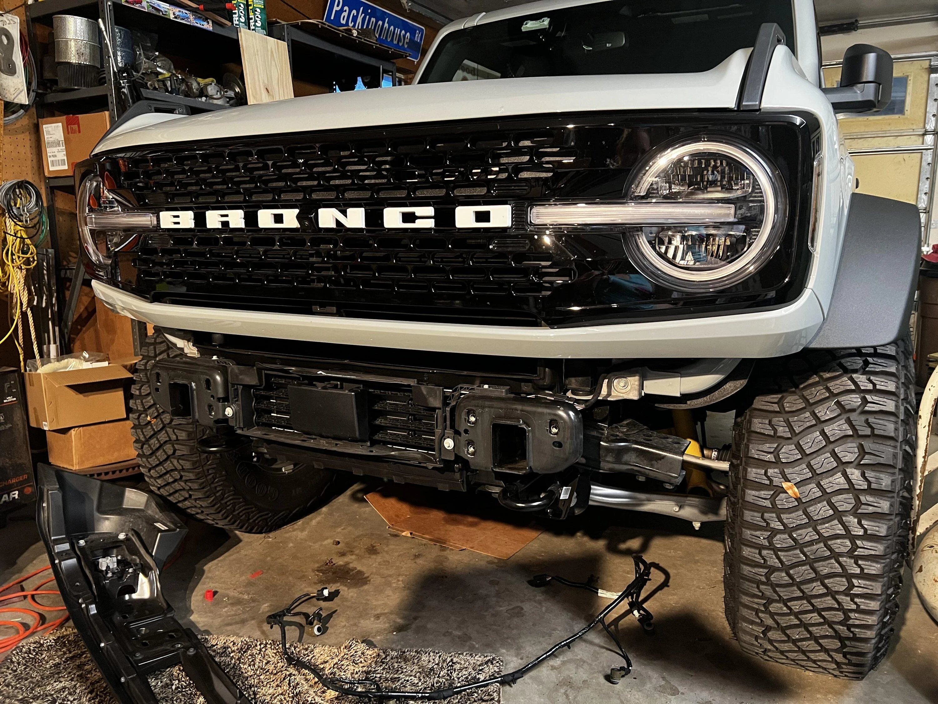

I purchased the bumper complete (minus sensors and retainer clips) from a seller on eBay. The biggest hurdle for me was to find the part numbers for the retainer clips for the sensors (they're not the same from bumper to bumper). Luckily the take off bumper I purchased had a VIN and I was able to find them. Other than that, the install was pretty straight forward. The loops for the tow hooks needed to be cut off (I cut them off and painted the ends). I was able to reuse the same harness from bumper to bumper. I'm hoping to use the factory fog light plugs on my aftermarket fogs when I buy them.

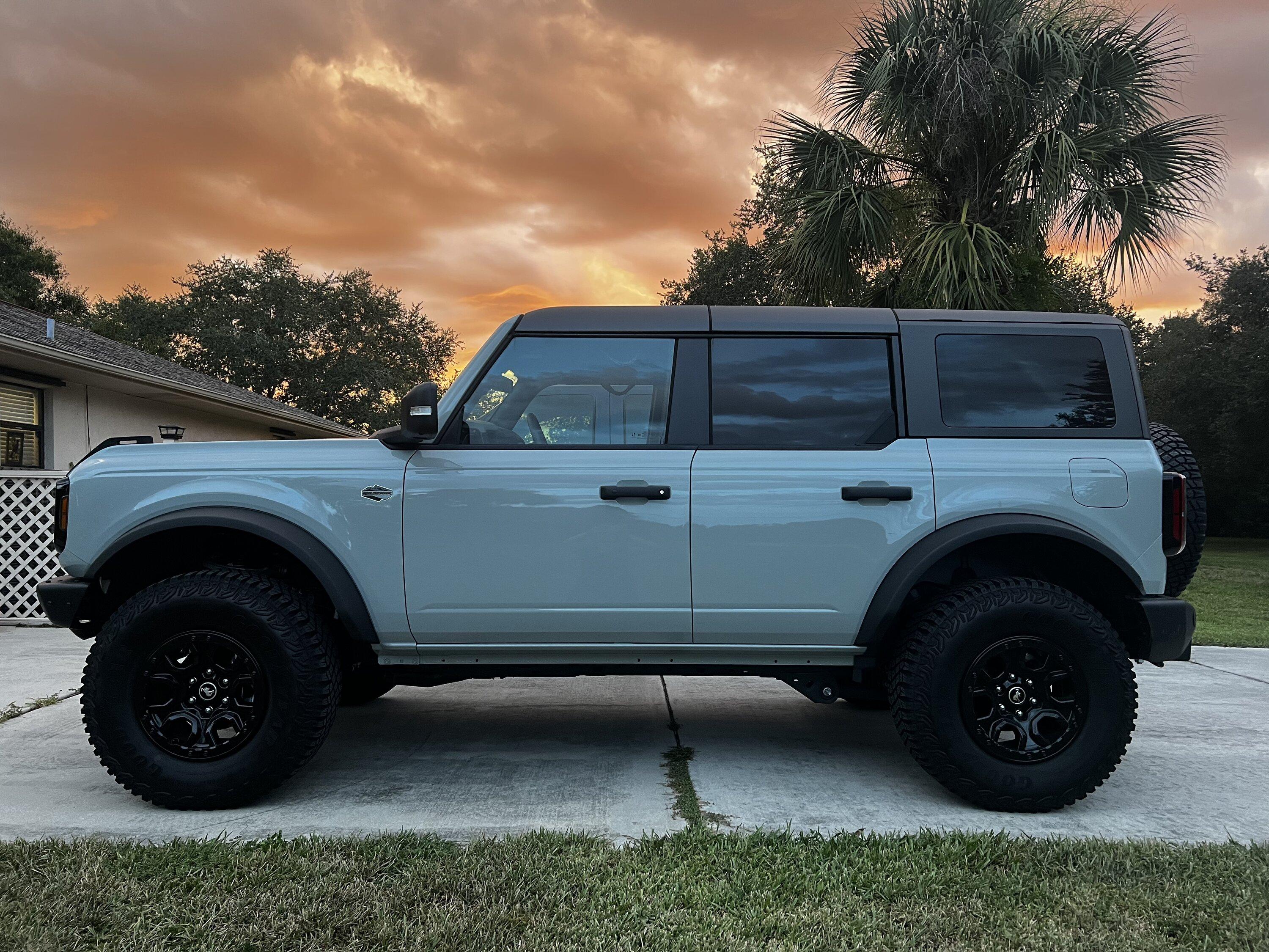

Here's a picture of my Wildtrak with the leveling kit installed.
I went with the 1.5" leveling kit from Fabtech.

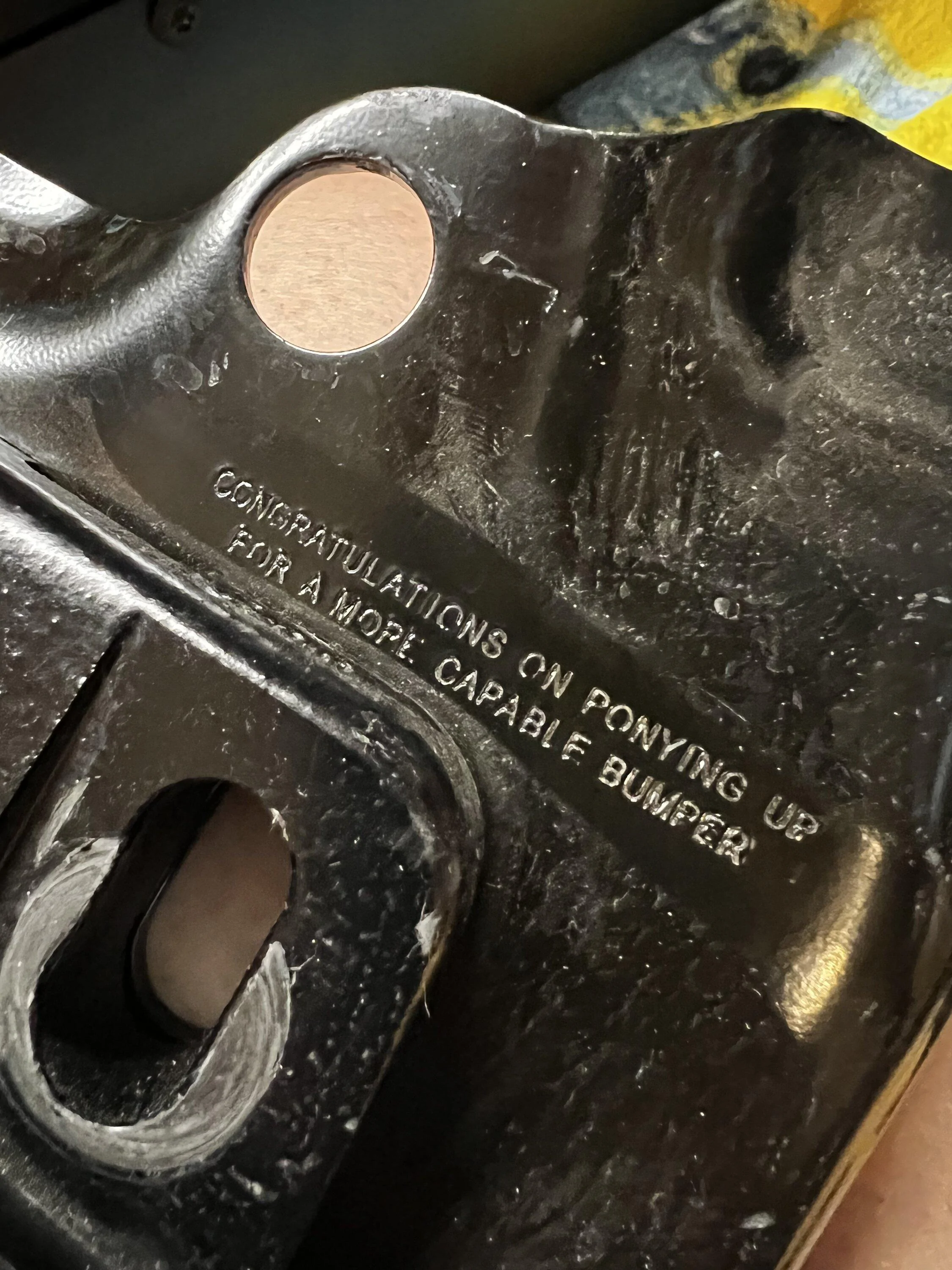

Love the easter egg text in there. Thanks for the pics. If I find a good deal on one I'll probably pull the trigger. Otherwise, I'll be looking in the aftermarket. The idea of taking a sawzall to a new Bronco doesn't sit very well with me but it is what it is.

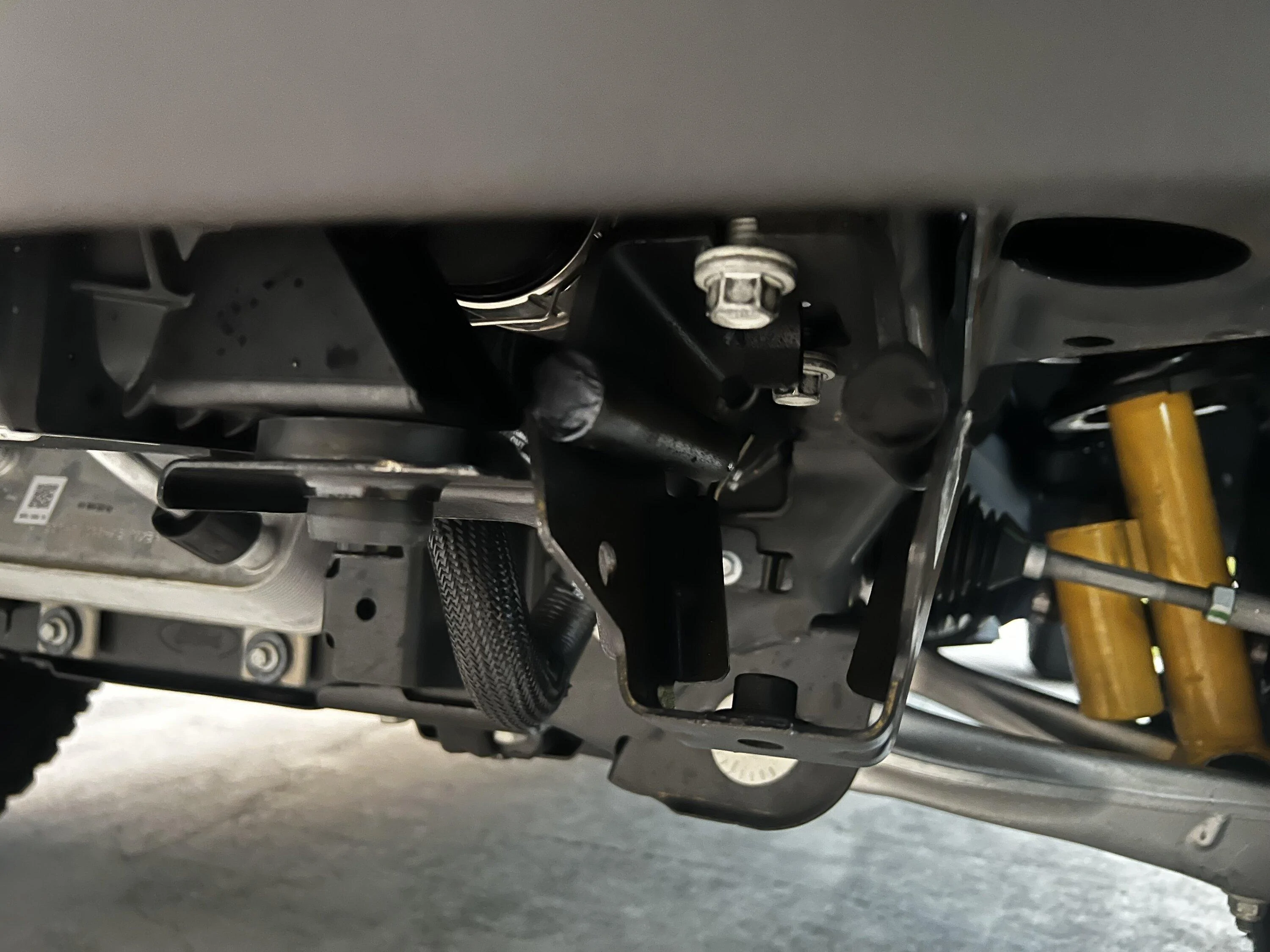

You could source new brackets, but availability may be an issue. They're not part of the frame of the vehicle, so you're not exactly cutting into the bronco since they're a bolt on bracket. The bracket holds the intercooler in place, so until I source OEM brackets, this works. most skid plates, including the OEM Ford skid plate would require them to be cut or replaced as well.
