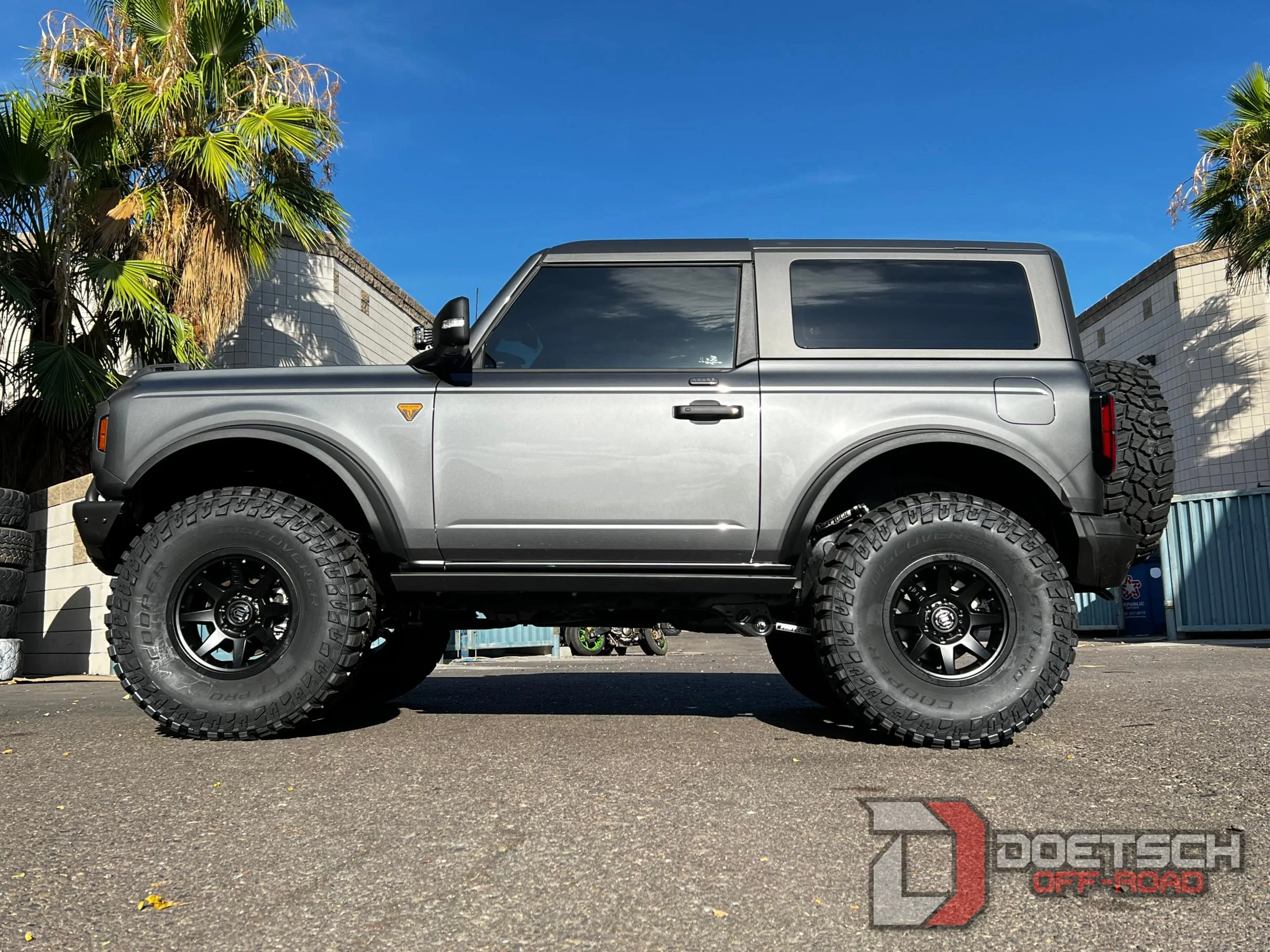

Brian's brand new 2dr 2022 Ford Bronco Badlands is stunning in Carbonized Gray, and our upgrades feature a strong list of performance and functional changes.

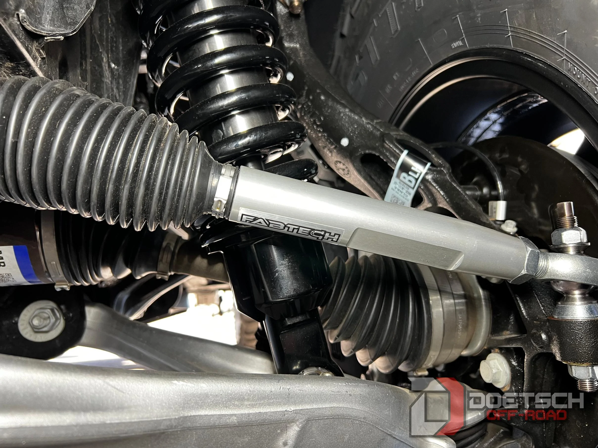

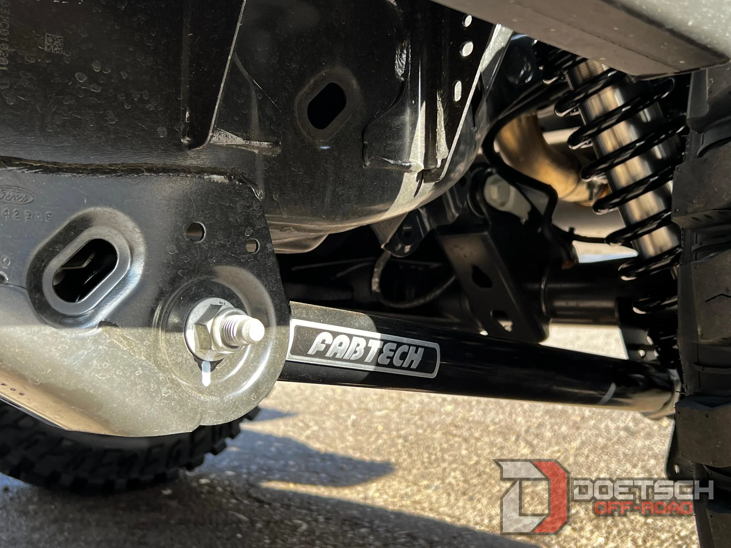

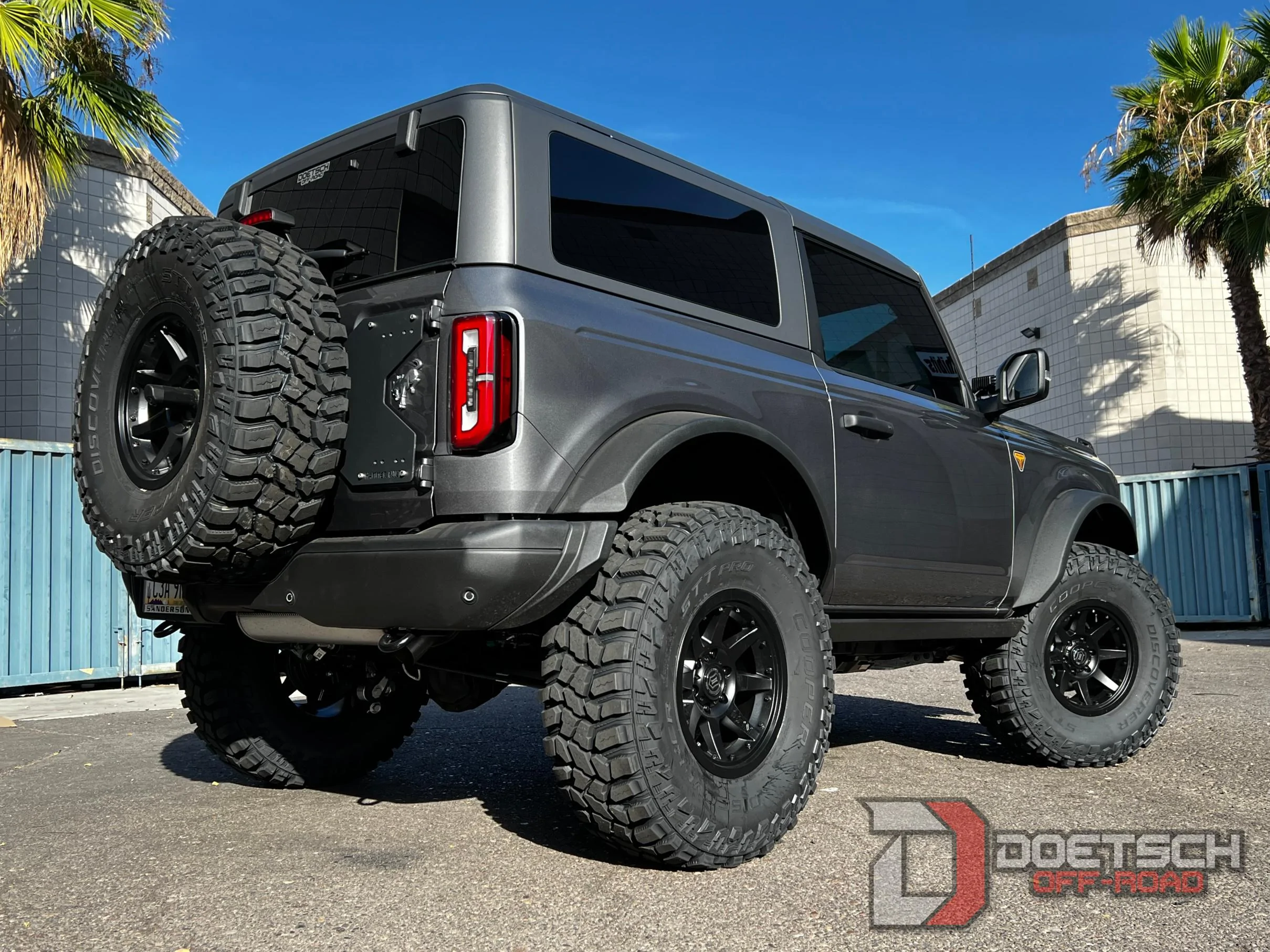

We started with a Fabtech Motorsports 2.5 Resi Dirt Logic front and rear coilover system that includes new front upper a-arms and rear adjustable lower control arms. After tuning the suspension, we easily fit a set of 37" Cooper STT Pro mud tires on 17" Icon wheels which feature "bead locking" bolts that help keep the tire from separating from the wheel at low air pressure. A set of Fabtech's aluminum tie rod ends featuring HEIM joints, as well as a BroncBuster bushing kit, will ensure the front end stays together while riding the Bronco on rough terrain. To keep the spare tire in check, we installed a Hammer Performance reinforcement bracket with holes for future accessory mounts.

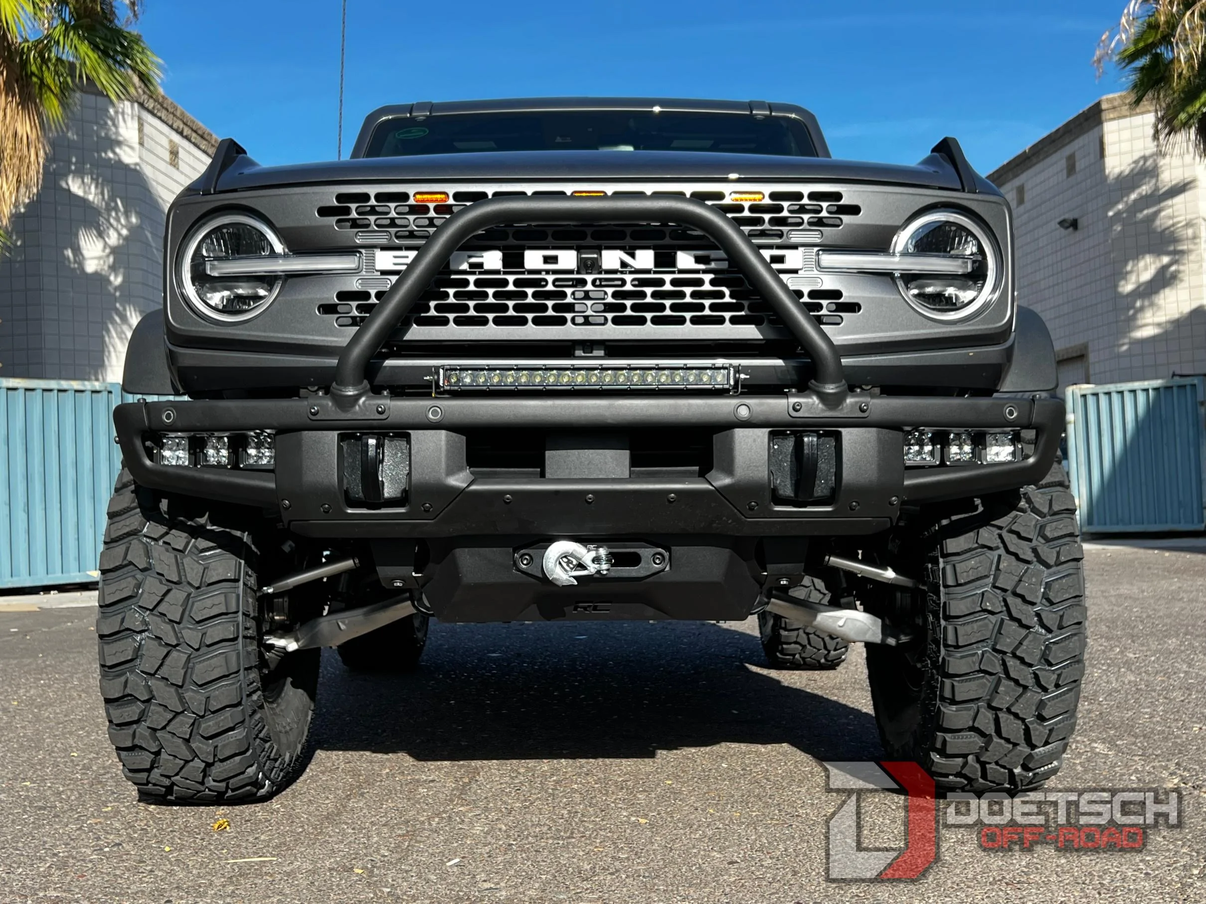

Up front, we installed a Rough Country hidden winch mount which utilizes the factory steel modular bumper, but allows for a trick spot to get a 9500lb winch installed where the factory lower skid plate sits.
For lighting, we used a set of fog pocket brackets to mount the customer supplied Rigid LED lights, as well as a new 20" Rigid SR-Series Pro Midnight Edition light bar under the overrider bar, as well as a pair of LED Sideshooter lights at the a-pillars. Finishing off the wiring was adding a set of "Raptor Style" amber LED lights to the grille.

Wowzers, beautiful! Those front axle shaft angles look cra-cra, am I just stupid or will all be well in half shaft land like that? 🧐📐

That shaft angle is within spec. A bit more lift and its time for diff drops. We do sell upgraded shafts to those who wheel hard.

I’m with you, not a fan of those CV axle angles. Especially if those are stock shafts.
