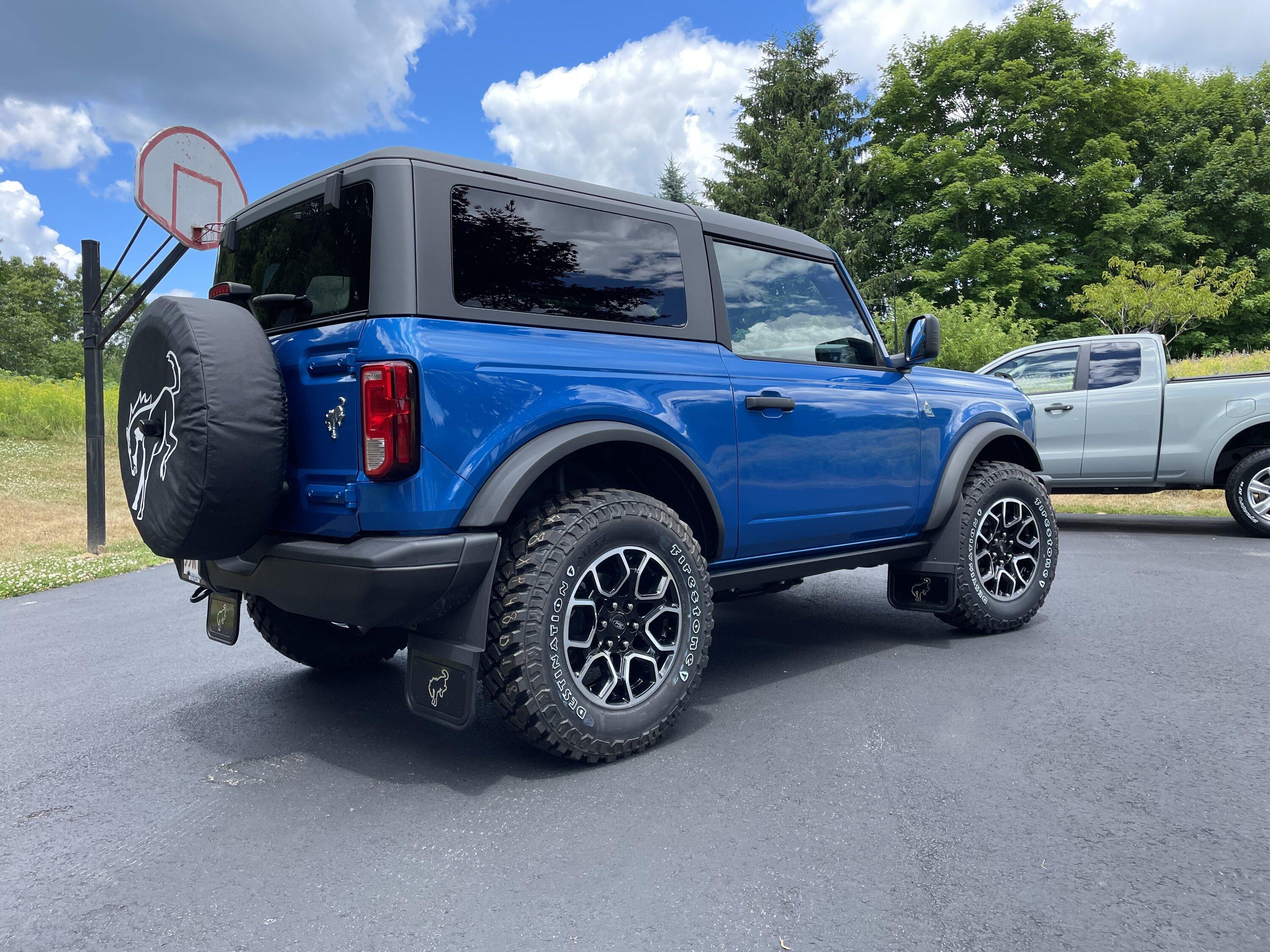

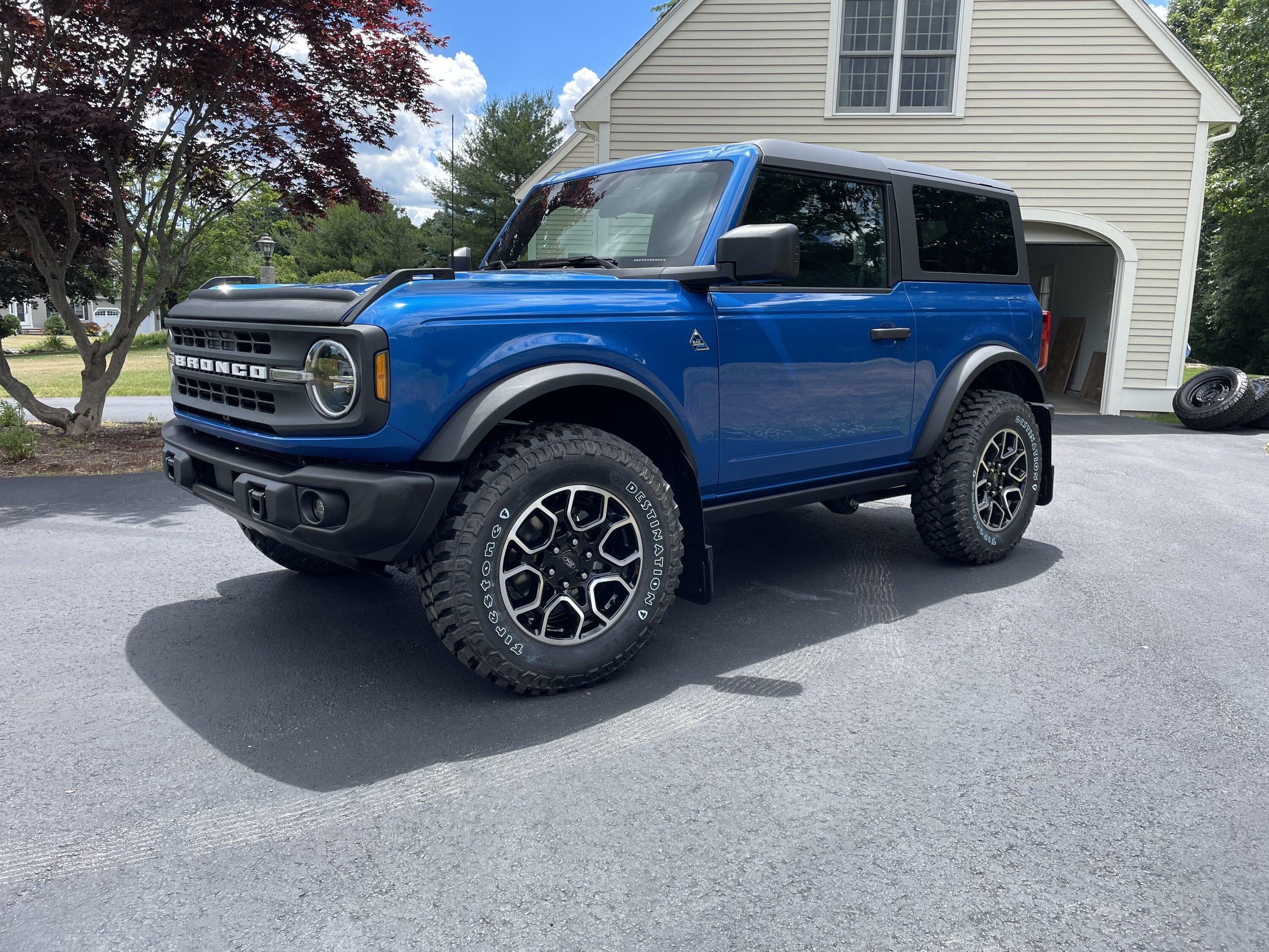

Thoughts. Only parts I’m waiting on are the ArchType Racing magnum steps. Also have bestop soft top for it. Not sure I’m keeping it though as I’ve incurred a lot of expenses recently and this seems a little frivolous in hind sight. Located in north shore of MA.

Really dumb question here, but aren't the F150's bolt pattern 6 x 135 and the Bronco 6 x 139? I'm guessing those 4mm don't make that much of a difference?

Yeah, what’d you do to get those to work?

There are hub centric wheel adaptors on it. I took the extra 1” of spacing in to account when determining if they would work. not cheap but US Wheel Adaptors do a nice job on custom adaptors.
Very interested in this as well...I tried to fit my Badlands wheels on my wife's 2021 F150 tremor and it wouldn't fit.

Looks great. But hoe did you get them on? I tried to fit my Badlands wheels on my wife's 2021 F150 tremor and it wouldn't fit. The bolt spacing was just a few mm off.

if i'c correct you need to get spacers from 135 > 139.7. it will push it 1" out but would allow them to fit.

Well damn. Looks like this is now another option. Can you get us a picture of the poke with the adapters? Also, what years of F150 wheels would this work with?
Edit... Completely spaced that all of the F150 wheels will be 18" or larger. Looks like a great option, but I definitely want to stay with 17s.
If you go this route don’t forget to get a new set of deep M14-1.5 lug nuts.

F150 take off wheels are readily available and cheap on eBay. More than made up for the cost of adaptors.
Those adapters are super affordable. The BroncBuster adapters are super price but Tyler sold me on getting what he considers the best materials. You guys have found a new "honeyhole" for wheel mods. I can't wait to see what everyone comes up with different combos.

Tire specs?
275 70 R18 Firestone Destination MT2
I actually did some renderings with the F150 20” wheels and they didn’t look bad. The black six spokes on the ford racing website look pretty good with a chewy tire. On the smaller side wall I would opt out of the white lettering though.
