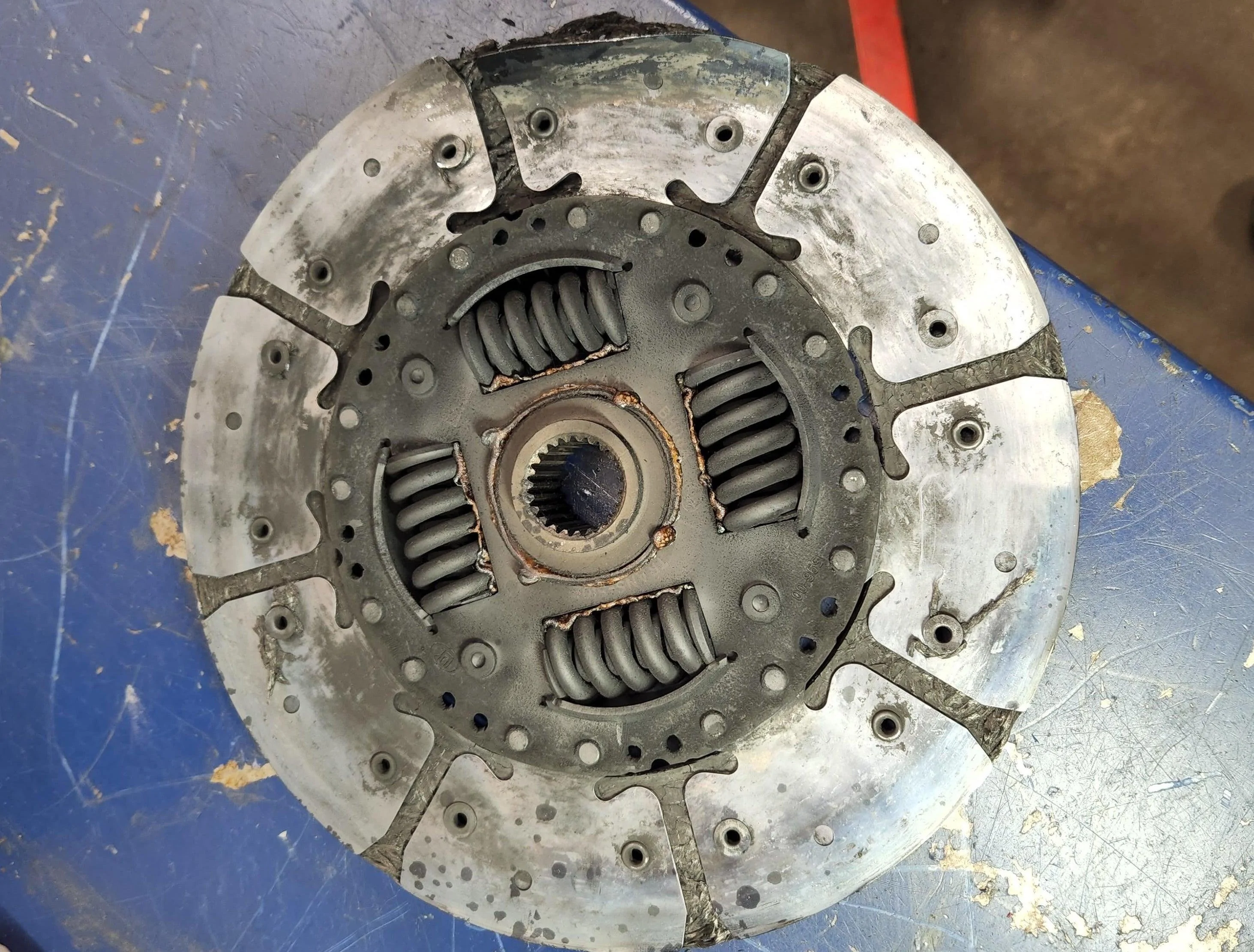

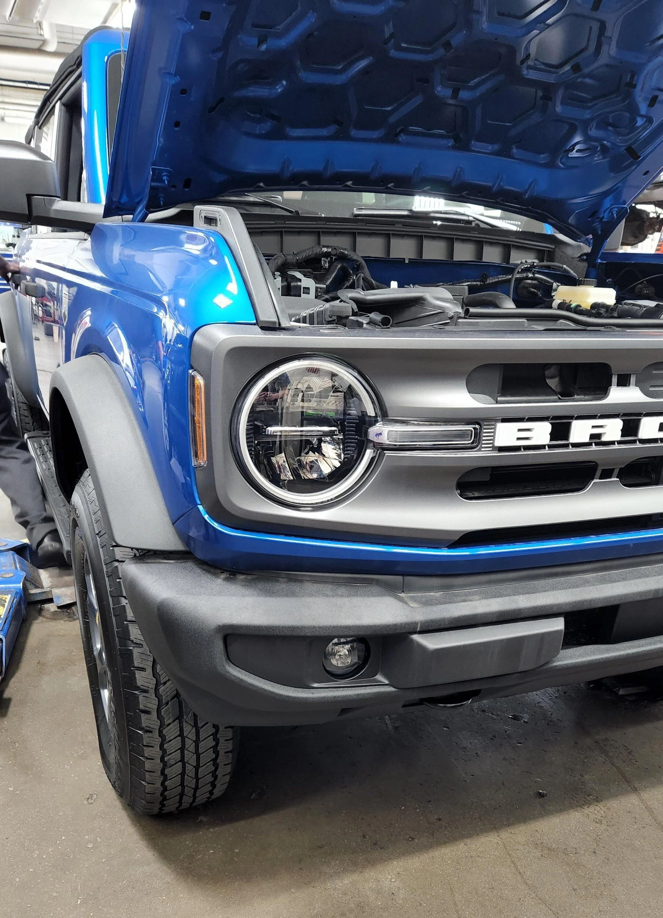

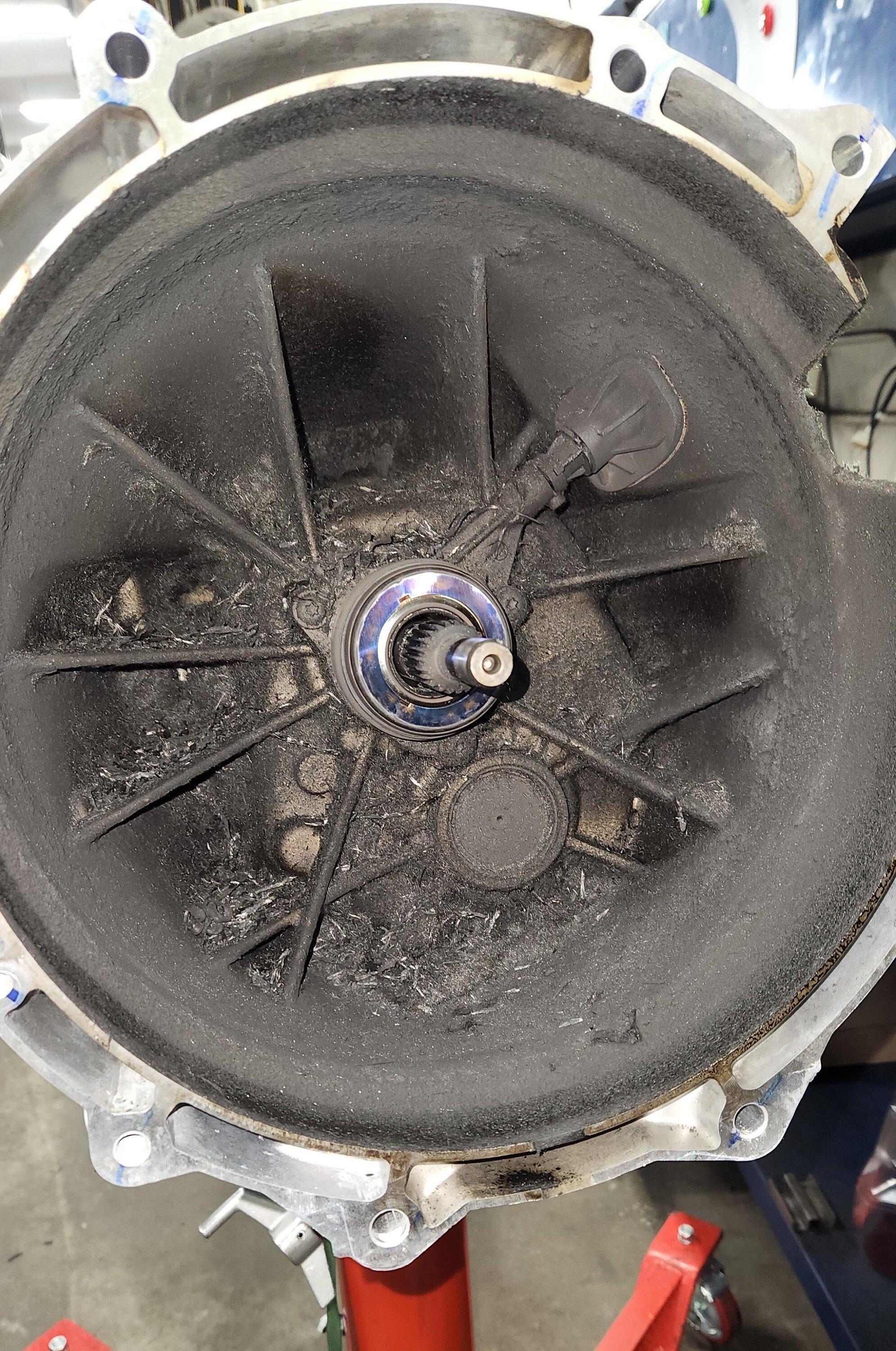

Cross post from this reddit. Looks like a 2022 big bend where someone attempted to do a burnout right off the dealer lot. Absolutely annihilated their clutch with only 10 miles on the drivetrain.
The comments indicate that the flywheel was blackened, so that means things got really hot! My guess is that it was a clutch dump at high rpm, but it isn't a heavy enough clutch to hang on. He probably saw smoke and thought he was doing a burn-out, but was dumb enough not to be able to tell the difference between burning clutch smell and burning rubber smell.
These Broncos aren't race cars. I would be surprised if it is possible to do a burn-out at all in one.
