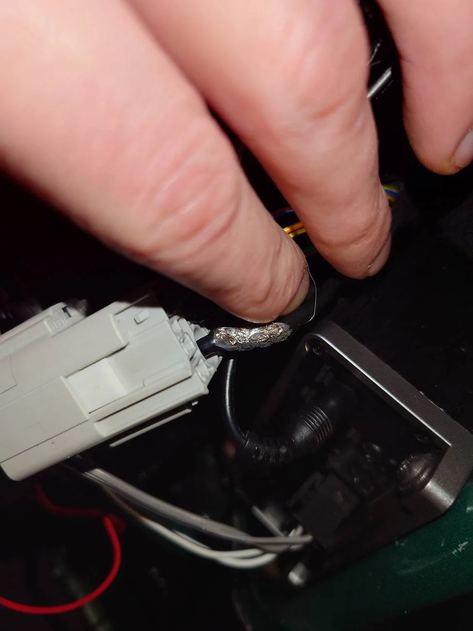

Alrighty I found the problem. The thicker black cable looks like it got caught under my drill when I drilled a mounting hole for the amp the rear frame. It did not go all the way through. Just shredded the outer set of wiring and the inner core of the wire looks fine. Anyone know how I can go about fixing this?

It's a shielded video cable... It's definitely possible to fix, but takes some soldering or some good splices. Given how close it is to the connector, probably need to repin that as well. There is a tool that lets you pop the pin out without destroying it.
I'd say right now, ask the part gods here for the P/N of that harness/cable bundle and maybe you'll get lucky and that's less than the pin tools you'd need to repair. Certainly would be less hassle.

I've been staring at horrible pictures from Ford part sites for 4 hours - does this look like it?
https://parts.donnellyford.com/p/Ford_2023_/Cable-Assy/141153647/M2DZ-14D202-CA.html
I don’t think that’s the right cable, it looks way too long and is called a USB cable in the illustration.
It’s hard to tell for sure from the pictures but it looks like Connector 404 which goes between the 14A005 and 14B562 harnesses. I’m not sure which side of the connector the damaged cable is on, but hopefully the one going towards the camera. The other side of the connector goes all the way to the right side kick panel.

It is the one right before the connector that goes into the tail gate unfortunately.

If it’s the half of the connector that’s going towards the swig gate, you’re good, if it’s the half going towards the front of car, that’s going to be tough.

It's the part going towards the front.

@BadlandsA51 @Brian_B Thank you guys for the input! So I went ahead and cut that center part open and found (what I think)is a few strands ofthe outer grounding wire had made way into the center copper core. I isolated the center core and sealed it and the camera works fine now. I will be soldering the outer strands this weekend to just feel extra good about it then seal everything off with heatstrink and wrap it.
