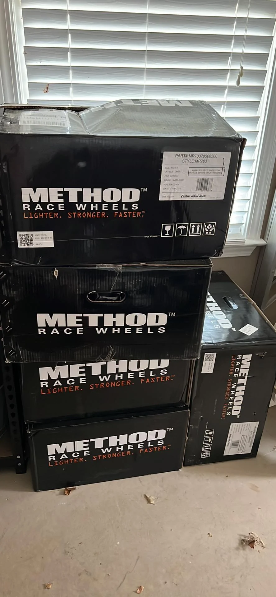

I have brand new set of Method 703 matte black available if interested. 17x8.5 0mm
Too much poke for me. I'm going +25
Thanks though. I saw your post on another thread and was considering it.
Bummer…0mm places the tires flush with Sasquatch flares
