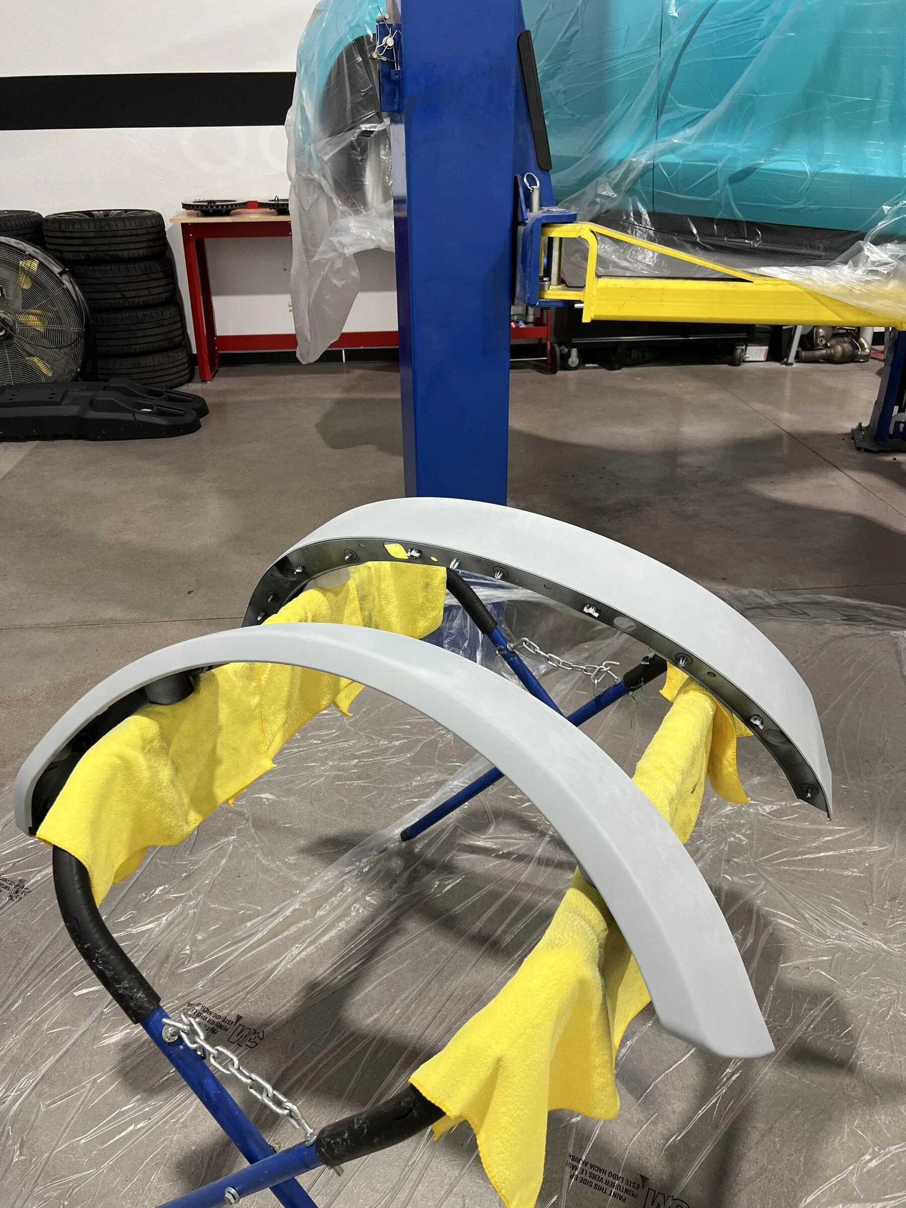

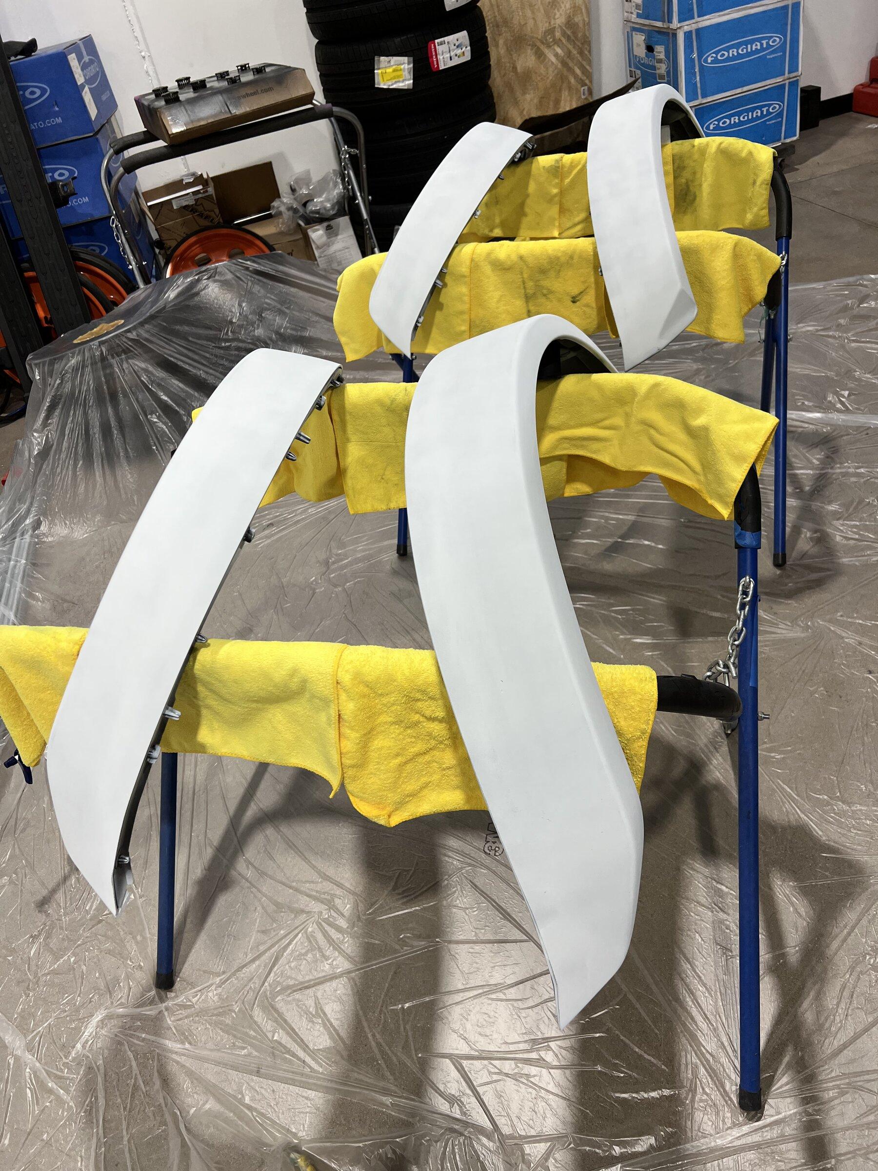

After this i hit the flares with adhesion promoter and some high build primer. Once the primer dried i sanded it back with 220 grit to get as much of a smooth surface as possible.
Ford Bronco DIY Paint Color Match Sasquatch Fender Flares F7EDDFFE-41BA-4239-A535-2CBE61CFBC02

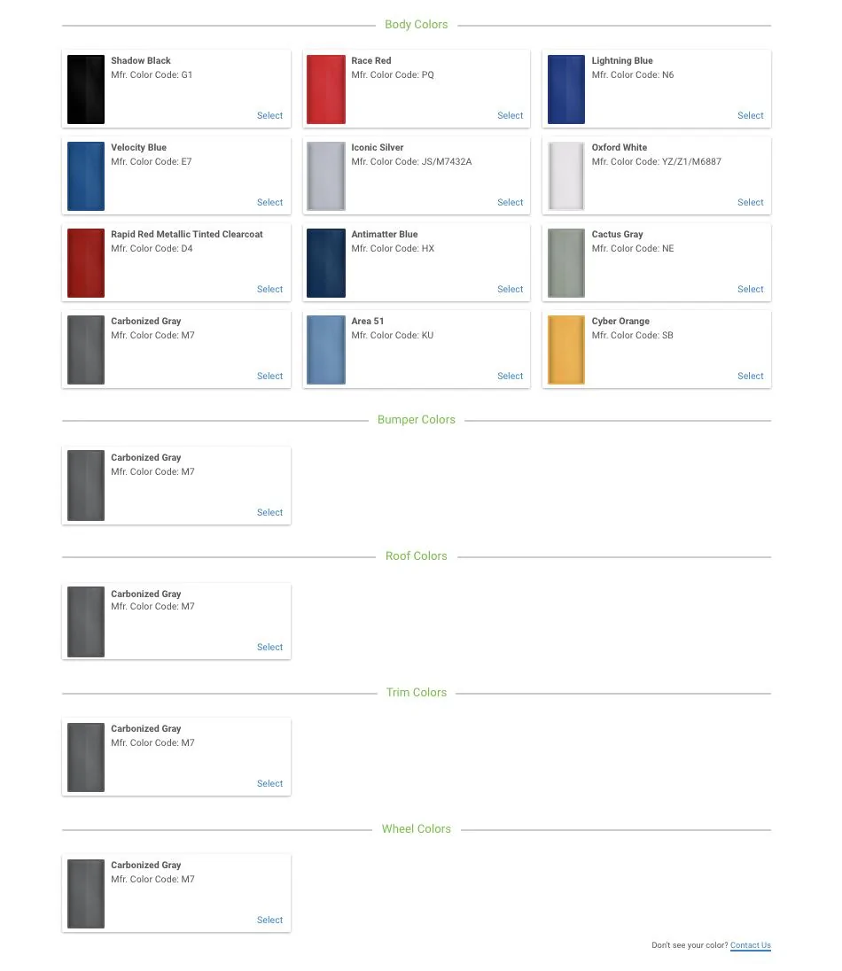

Next i sprayed down a grey primer as that’s what the cactus grey base coat called for.
Ford Bronco DIY Paint Color Match Sasquatch Fender Flares 9EE290F6-3E64-4136-AE0A-681E47F514CE

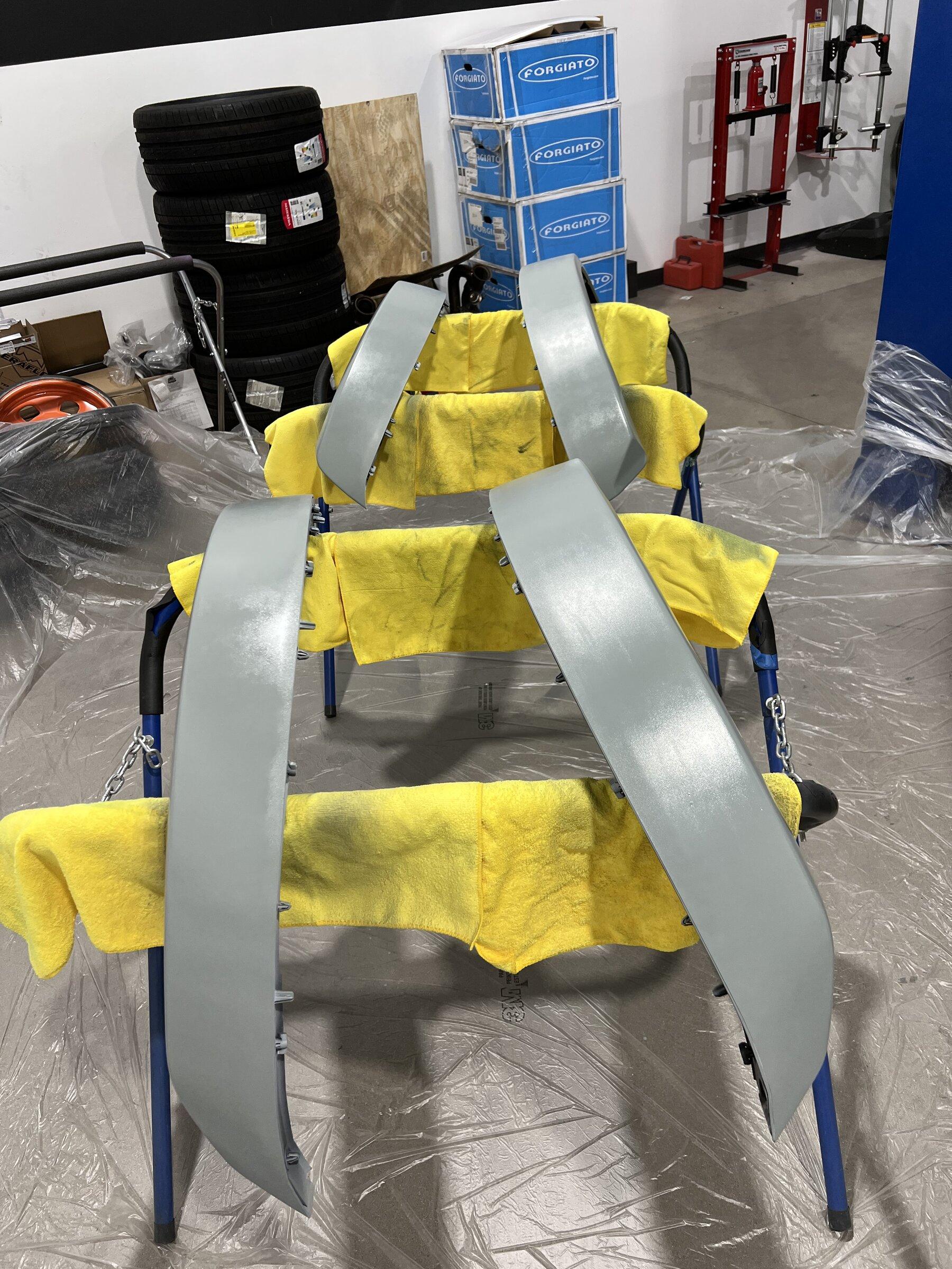

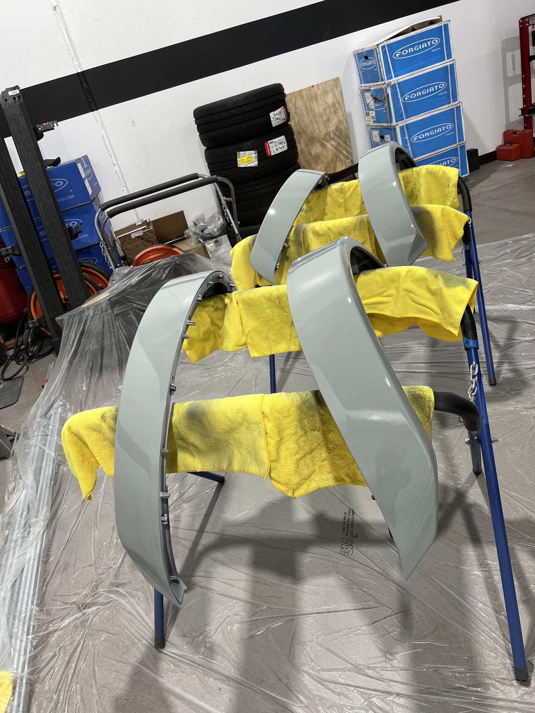

Then came the cactus grey base coat i did 4 coats to try and get it as even as possible.
Ford Bronco DIY Paint Color Match Sasquatch Fender Flares 0A09C318-95ED-4C3F-B63A-A195A486D68B

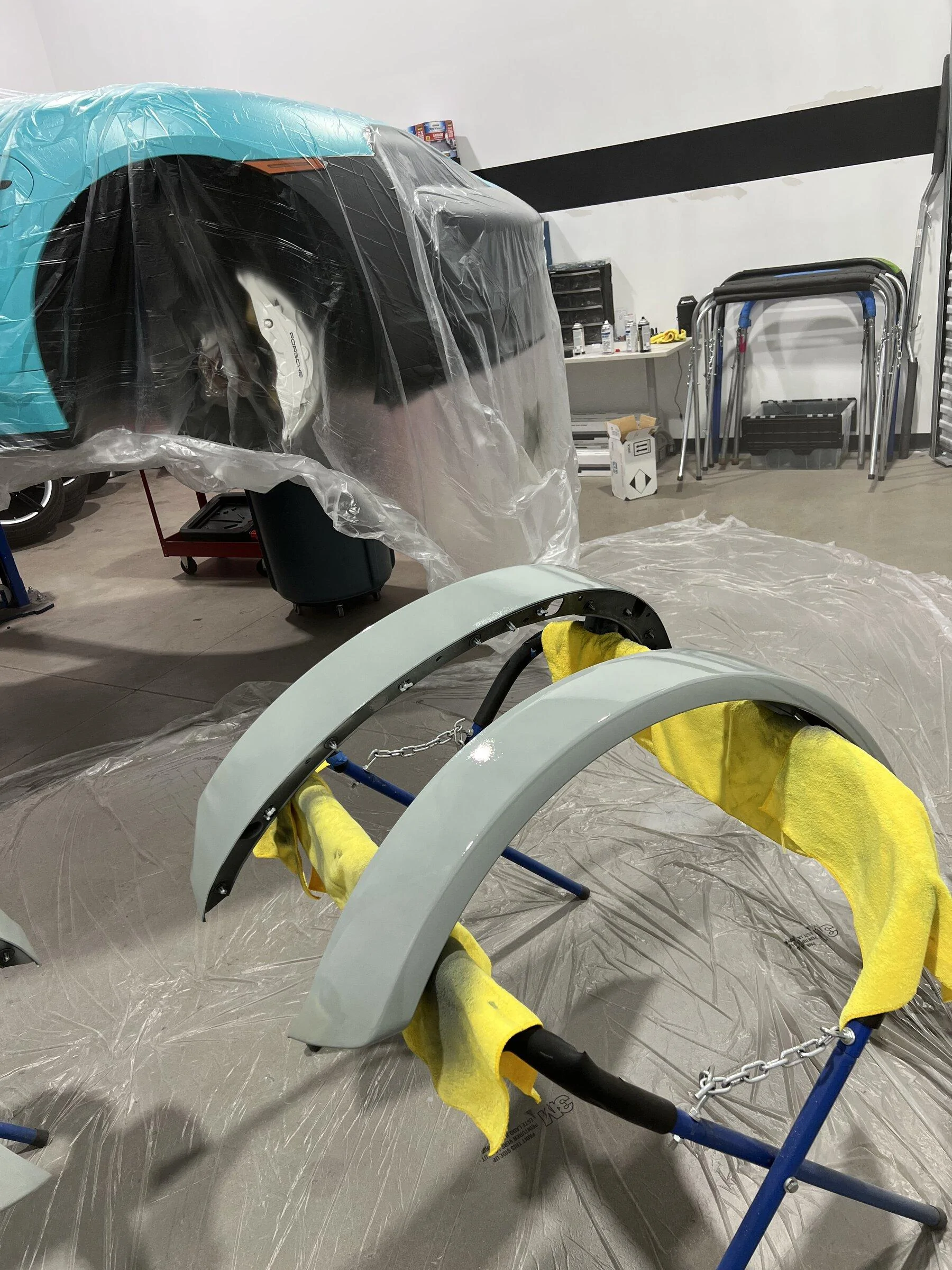

Finally i did 1 light coat and 3 heavy wet coats of 2k glamour clear coat.
Ford Bronco DIY Paint Color Match Sasquatch Fender Flares 2CC585A1-9A21-4CAE-9F73-1CED61F074F3
Ford Bronco DIY Paint Color Match Sasquatch Fender Flares C2B3ED9D-9826-4032-B6F5-5E47DB4AE6E1

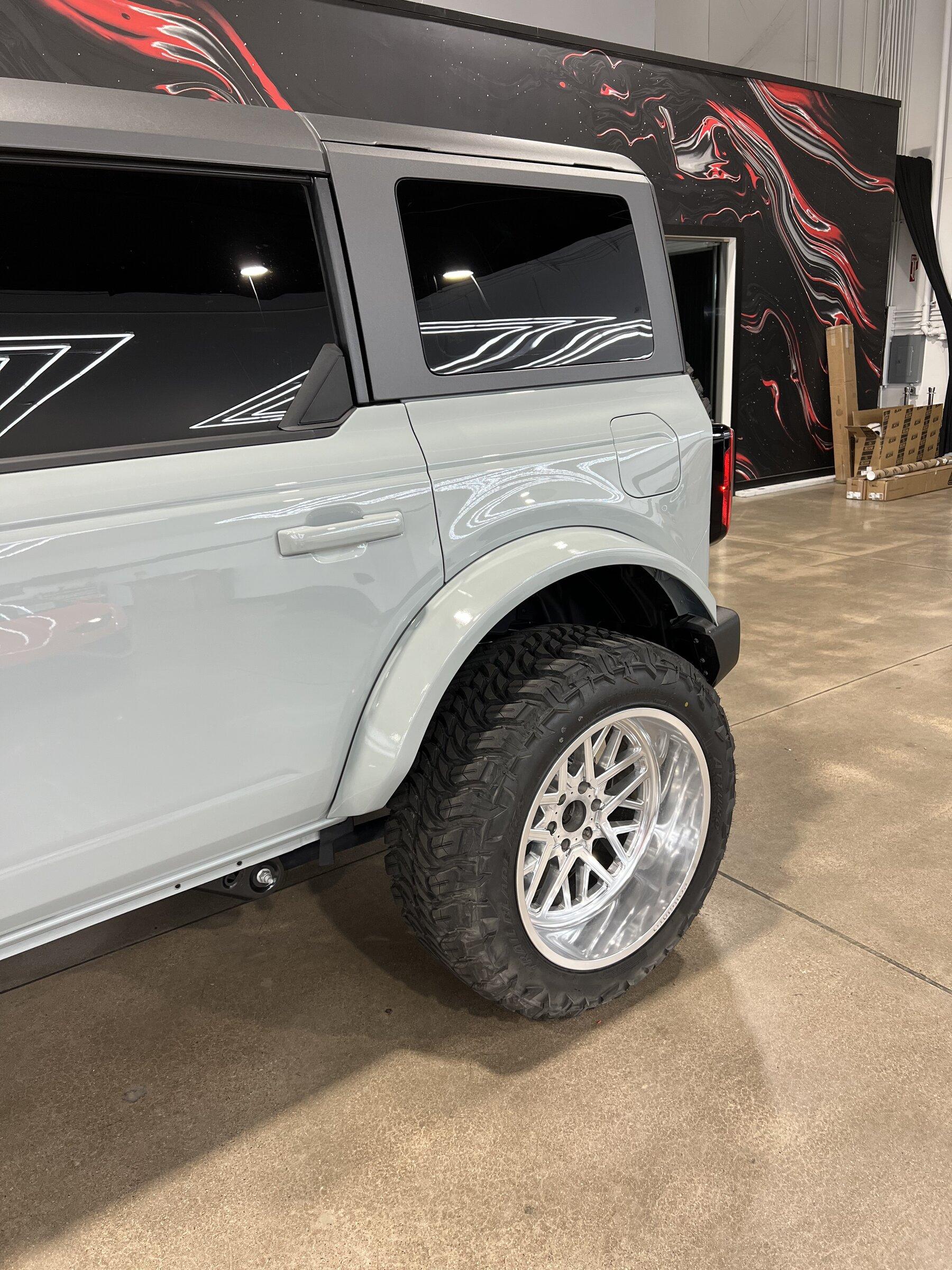

Here is one flare mocked up on the car but it’s not dry enough to install just wanted to see how it looked
Ford Bronco DIY Paint Color Match Sasquatch Fender Flares AB6D1D54-A645-4857-9510-81C4C34E93DC
Ford Bronco DIY Paint Color Match Sasquatch Fender Flares 4450baf7-4f56-4a53-ad9b-d82471f575e8-jpe
Ford Bronco DIY Paint Color Match Sasquatch Fender Flares ea20fe32-22f3-497f-a398-b14eb924ce0b-jpe
Ford Bronco DIY Paint Color Match Sasquatch Fender Flares e4cac143-5fd1-4329-80d3-e0795a5f30c7-jpeg

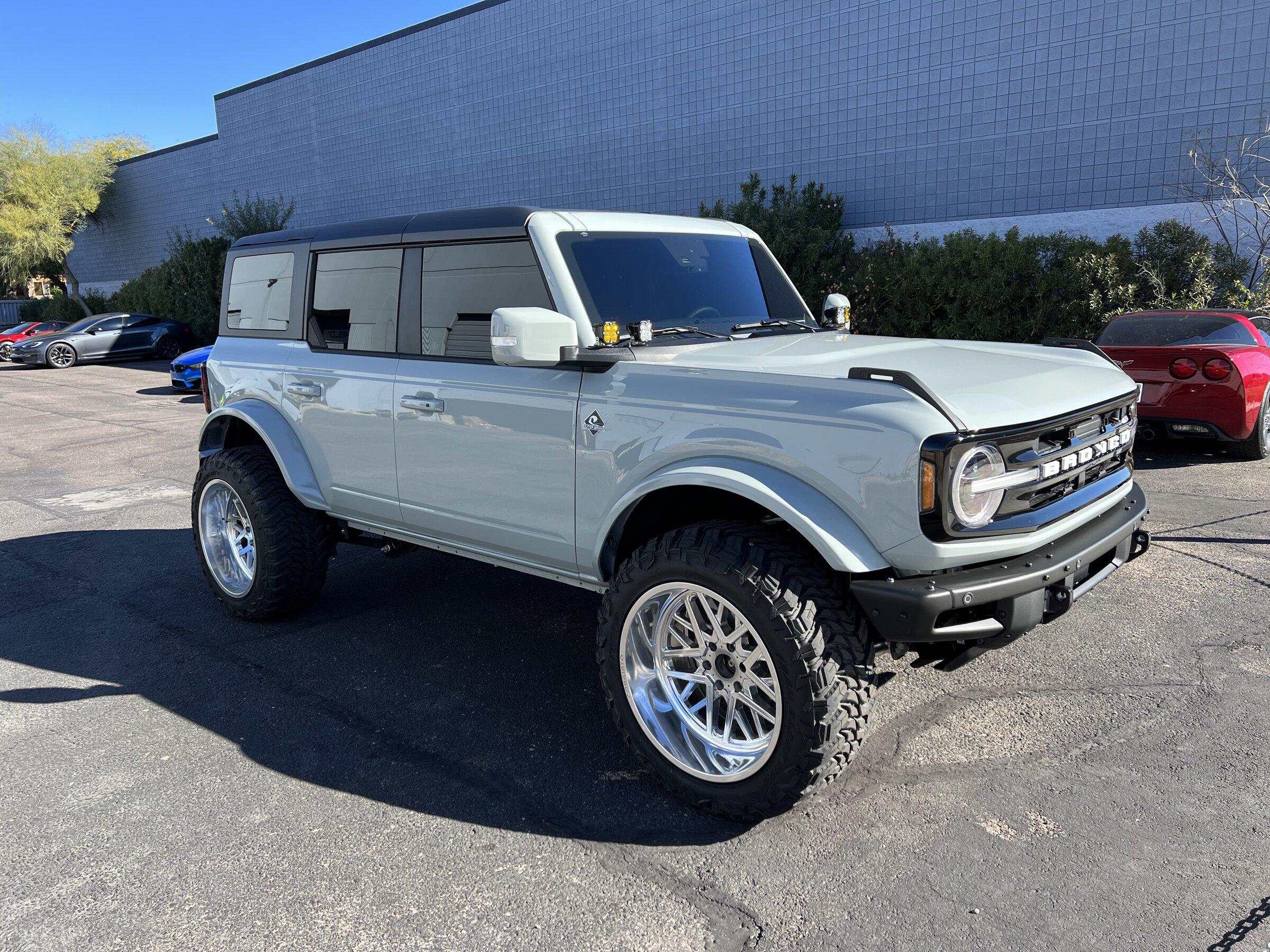

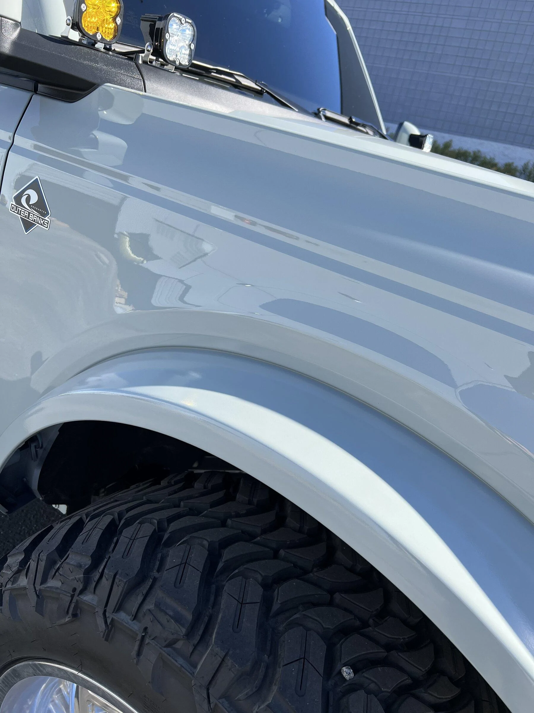

Here they are mounted up just need a wet sand and buff later today.

WOW did not think i would receive this many replies so fast lol. For those of you looking for spray cans of cactus grey or whatever color you may need there are many local automotive paint supply stores all you have to do is walk in and tell them the color you need and they can mix it and load it into an aerosol for you! This project used 1 can of adhesion promoter, 2 cans of SEM high build primer, a can of SEM grey primer, 2 cans of cactus base coat, and 2 cans of 2k clear glamour.
That looks good. Did you have to do anything special with regards to the paint and flexibility when applied to plastic?
I've only done a limited amount of automotive DIY paint. Some on my FJCruiser and the plastic adhesion promotor and keeping things clean gave me plastic parts that lasted for 8 years that looked as good as new.
I used an adhesion promoter to help it to stick to the plastic that was it so time will tell how that holds up.
