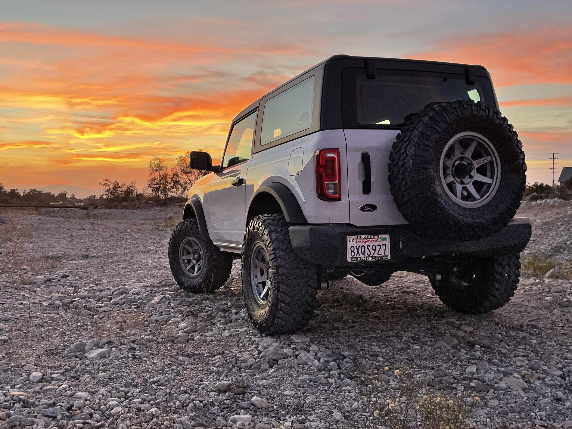

Any concern with adding 35 to tailgate for Bronco without Sas package? Understand brake light and camera may be impacted but any concern with added weight and bending or affecting tailgate function?

It's hard to see in this pic but on my non-Sasquatch Base the brake light just peeks out over the 35" Nitto. No affect to the camera as it's in the center of the wheel. And there is no difference in the tailgate or spare tire support structure between Sasquatch and non-Sasquatch.
