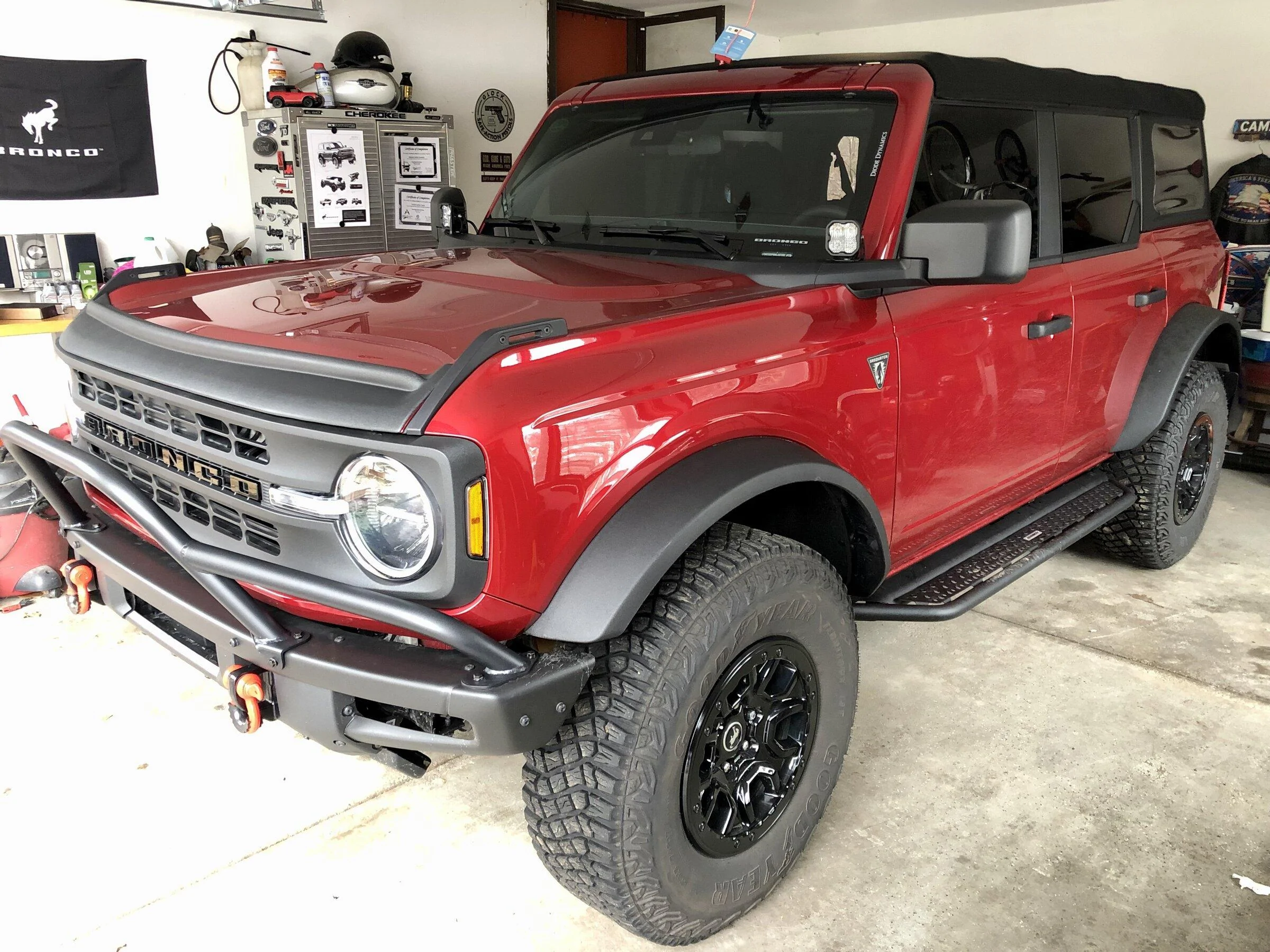

looks way better, nice job I plan on doing the same when I get my BL

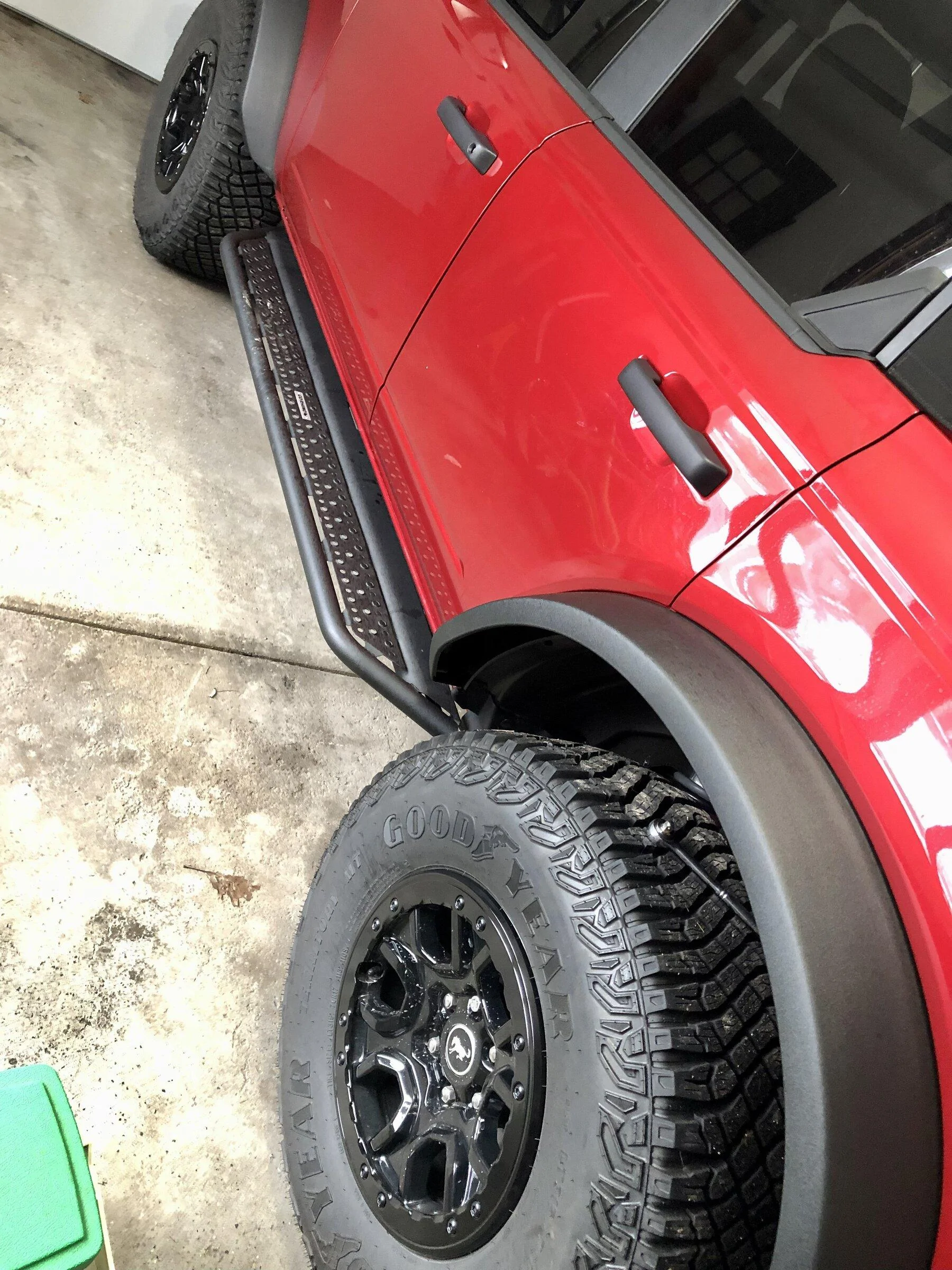

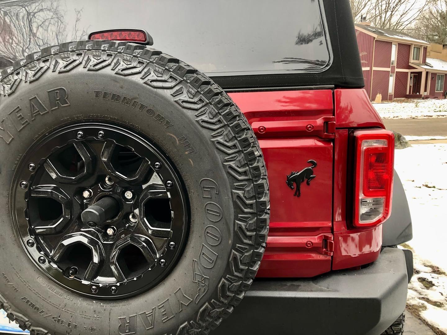

PIcs of Bronco doesn’t do it justice. However in person everything looks better. Same goes for the rims/rings. Blk rings So much better you will love it.

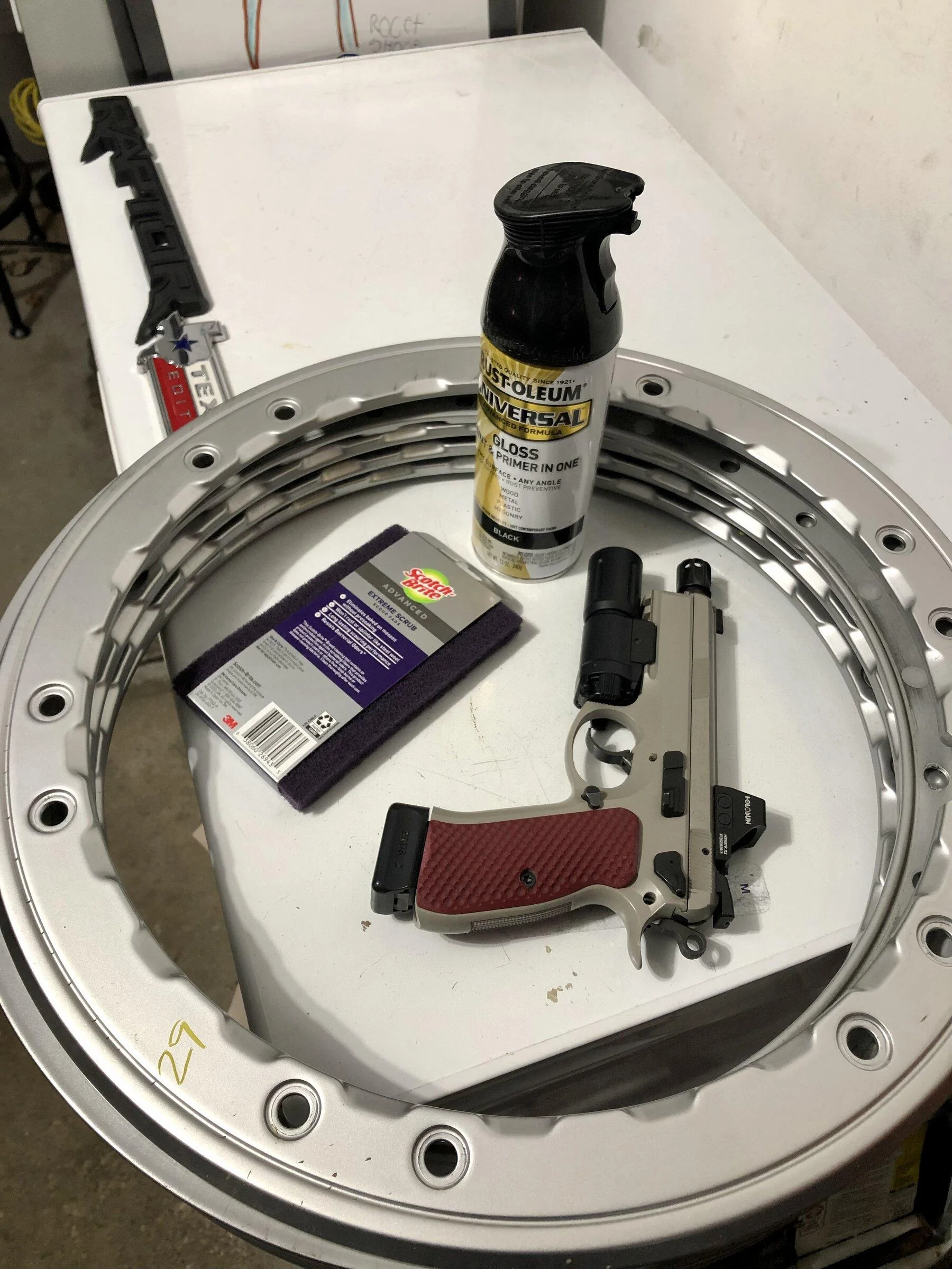

how much sanding did you do? i'm going to attempt this next week. any tips?

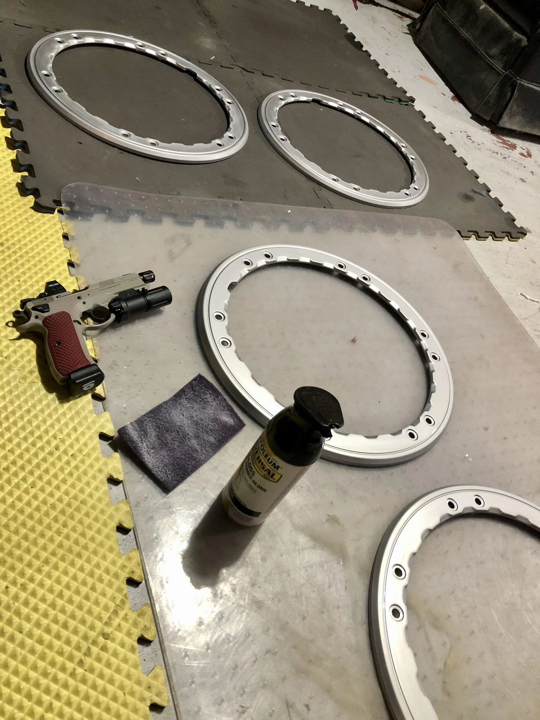

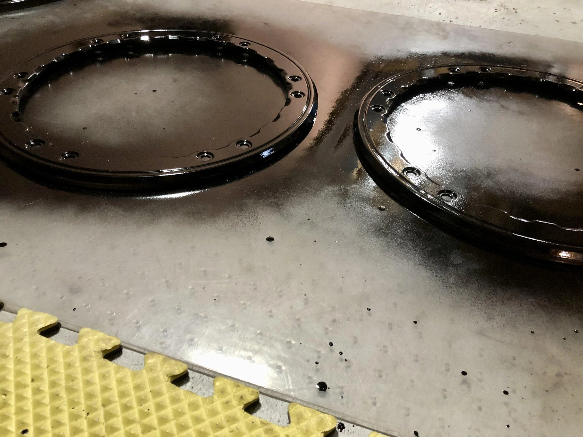

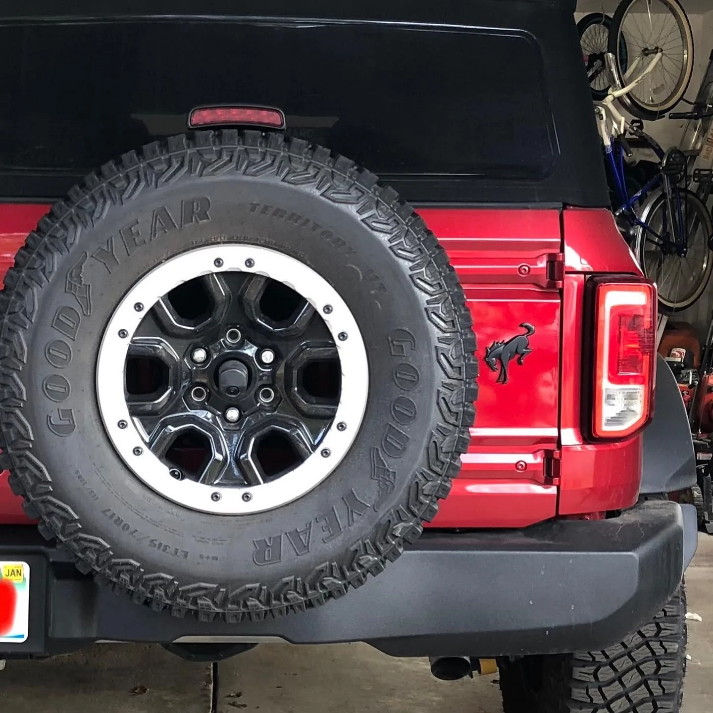

So after an early AM blood pump workout Today. I had nothing to do so I went to Homedepot grabbed the T45 hex, rattle can BLK. Gloss. And the Scotch bright extreme scrubber.
Removed all rings. Took to basement because it’s 20deg outside. Grabbed a bottle of alcohol & microfiber rag. Cleaned good. Used extreme scrubber to rough up the rings a bit, a lot actually. Cleaned off with alcohol & clean microfiber cloth. Cranked up heat. Allowed to dry. Then used the entire rattle can on 5 rings. Opened small basement windows to ventilate basement. Let dry for 4.5 hrs then reinstalled on rims. Easy peezy. So much better 🤙🏽
